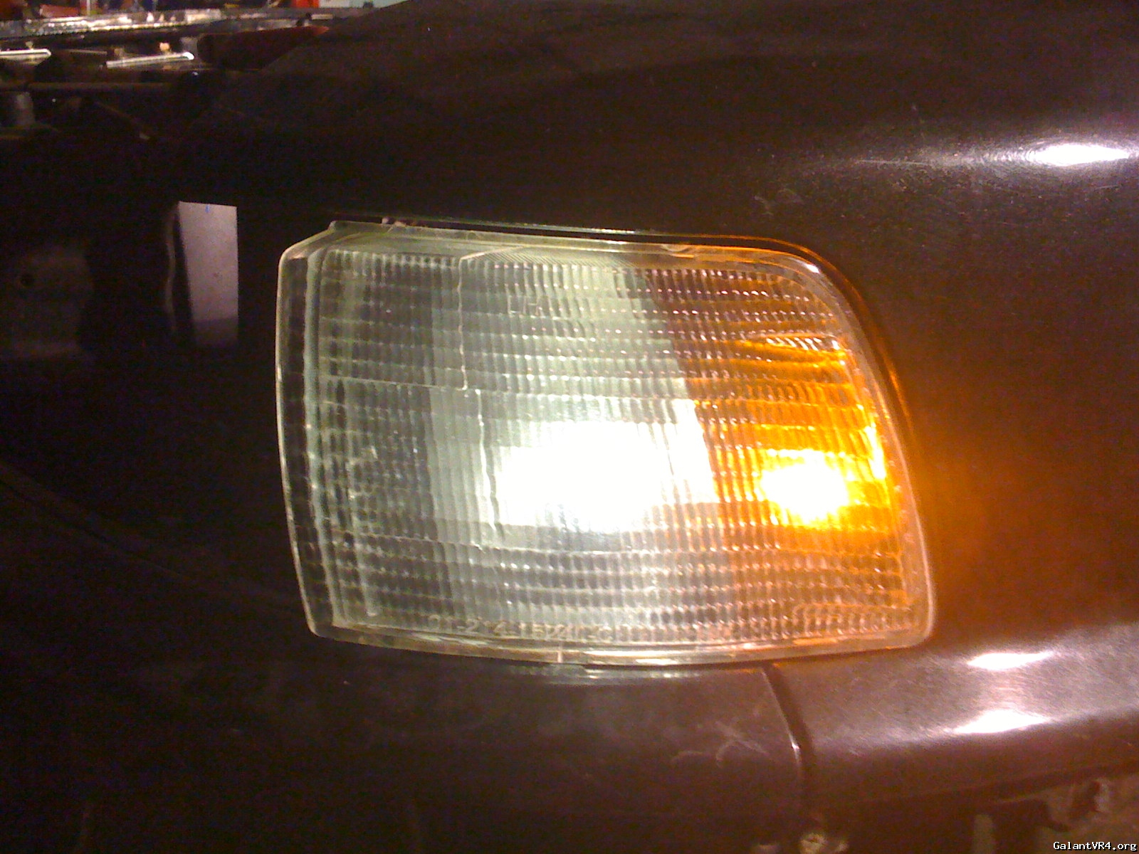

Here's what I did with LED's, I didn't convert one to turn, but it would be easy to do. You'd just have to break the copper trace, and solder wires at the back bulb.
