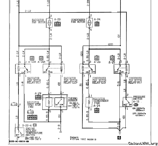

According to the diagram, #4 is for the cooling fan. I thought the sensor in the lower end tank of the radiator was for that.
ktmrider
Sep 10, 2007
3,128
Tempe, AZ
^^ #4 turns on the A/C fan, not the main PS one, if the A/C is not engaged ( when A/C is on the second fan runs regardless ).
This is the one called the "Engine Coolant Temperature Switch":
It kicks the fan onto HIGH if the temperature reaches 102* C.
It appears that you only have 2 duplicate colors to worry about:
1) Yellow/Green striped - You should probably just ground this one and see what happens. Its either going to peg your dash temperature gauge, or make the coolant temperature on your logger read very, very high.
2) Green/Black striped wire - I would just ohm this one out to ground with oyur meter. If it is the sensors ground from pin #24 of the ECU to the ECU coolant sensor, it should read continuity to ground, through the ECU. If it is the A/C switch, you will get a much higher resistance to ground.

^^ Ok thanks Jeff, so that switch controls High/Low fan operation instead of On/Off like I assumed.
