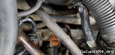

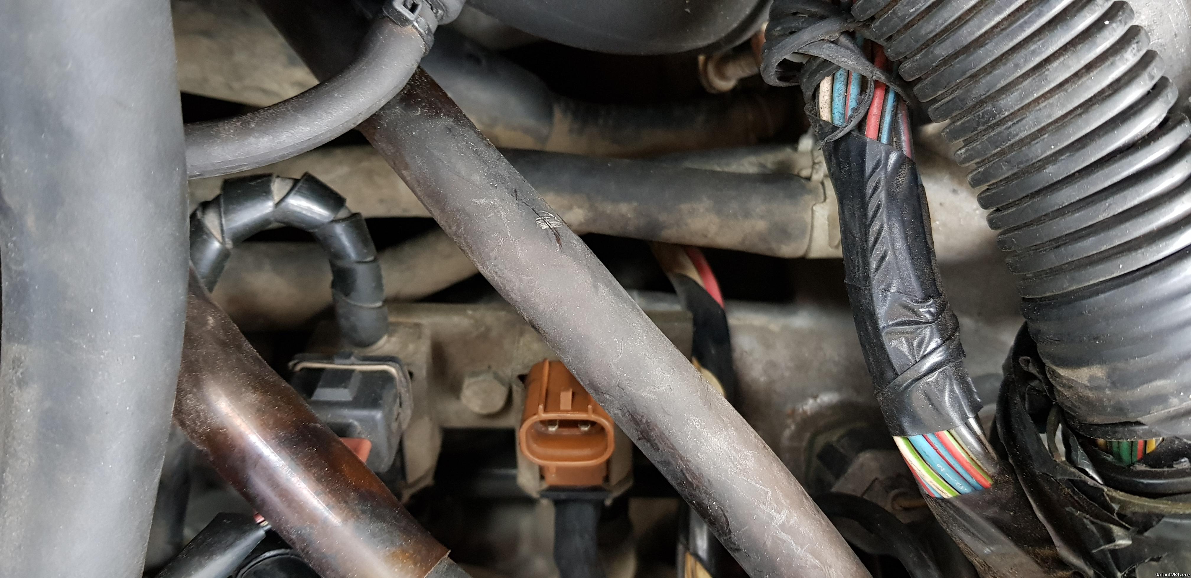

Help #2: Where is the coolant sensor located? I did find this lonely sensor but cannot find a connector to go on it....
