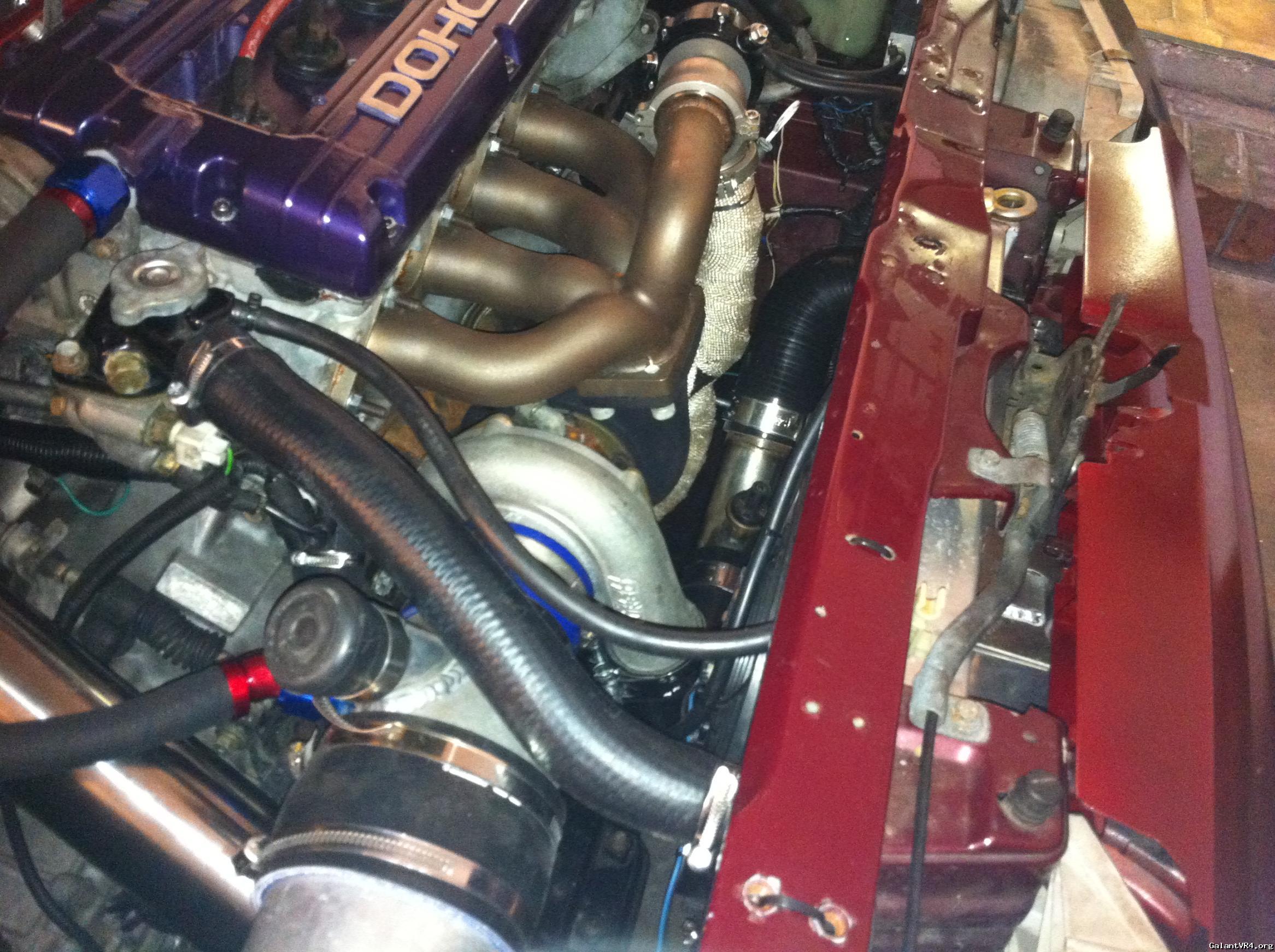

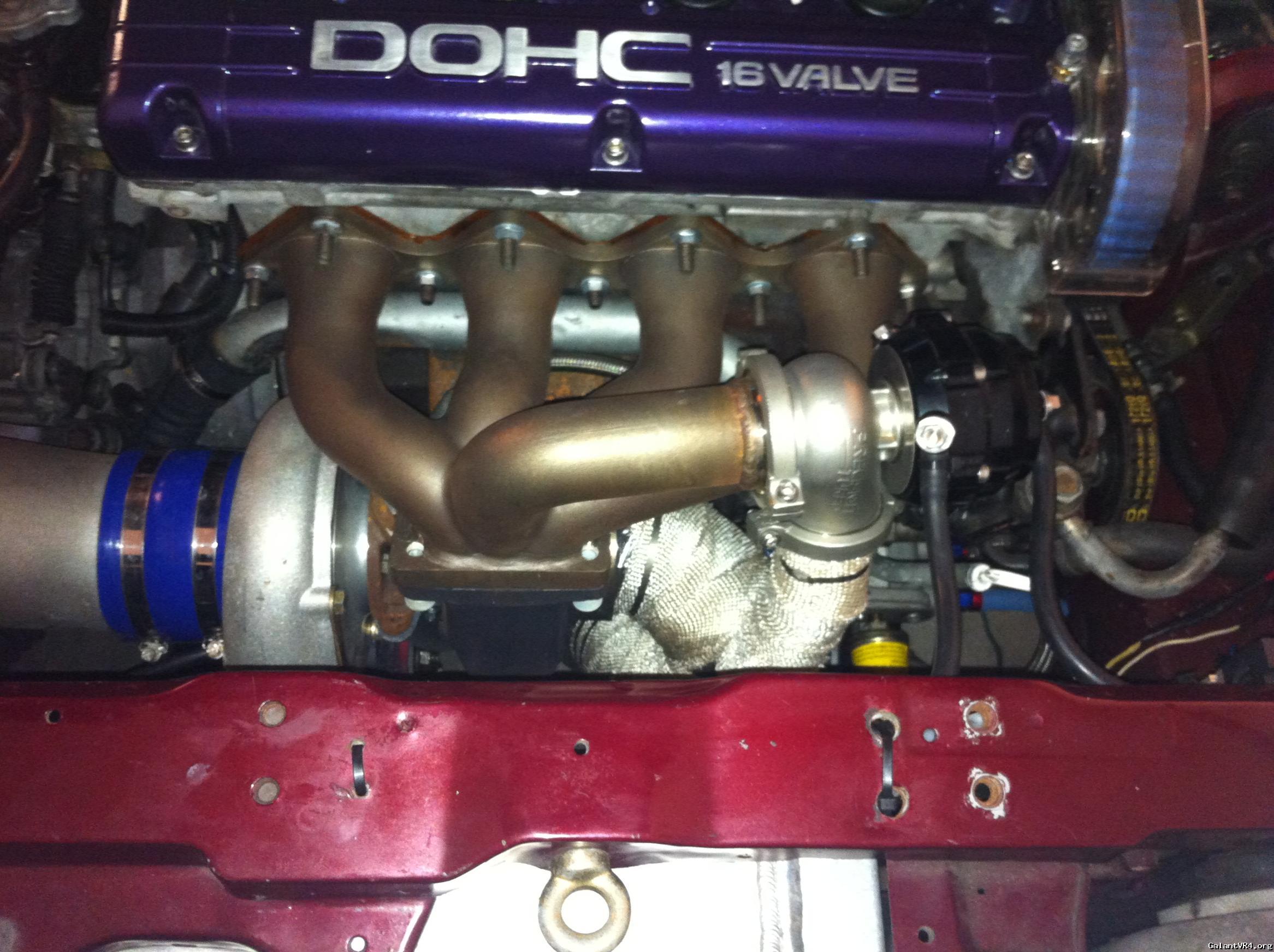

Here's a few of my pics. I'm running a Afco Scirocco style radiator. I think it would be a pretty tight squeeze with a stock unit in there though.
Let me know if you want any shots with measurements.
Seeing the manifold pic that 1qkfwd posted in his thread convinced me to get one /ubbthreads/images/graemlins/grin.gif
PTE 6262 with .82 rear and new ERL manifold
