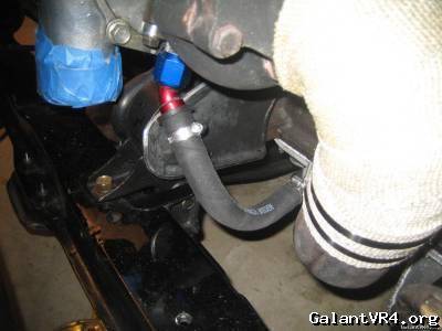

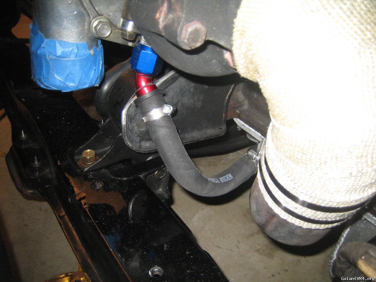

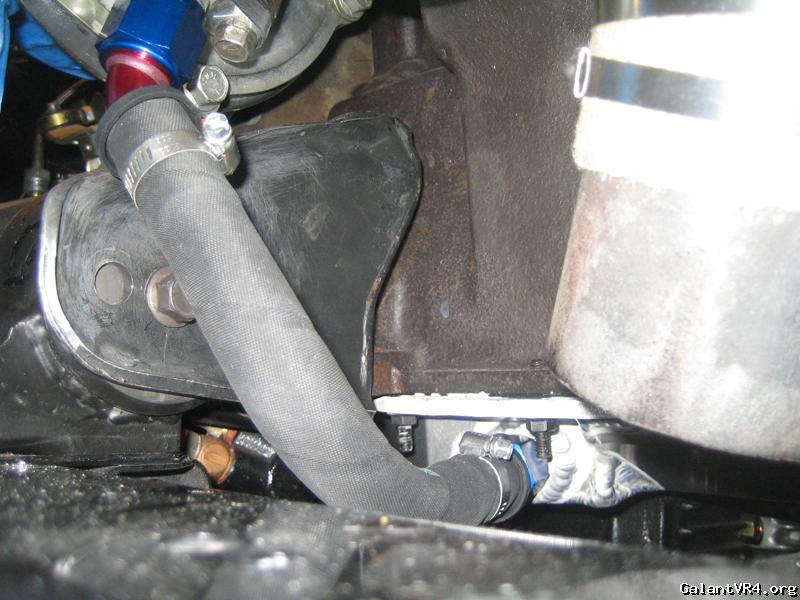

I didn't have any clearance issues with the manifold hitting the water pipe. There is plenty of space behind it. I have an old 60-1 turbo and the comp housing does not touch the pipe. It was close but no touching if I recall. If your comp housing is bigger than that then you will have to dent the pipe or fab a new pipe to curve around it.
The only issue I had was the turbo oil drain tube sits real close to the motor mount. With a straight -10 fitting bolted to the center cartridge and a 45* -10 fitting screwed to that I had to take some material out of the motor mount so they do not touch when the motor shifts. I also used poly mount front and rear to eliminate shifting.

Nice, is that the 'enlarged' oil drain to stop oil from backing up in the compressor housing?
What fitting did you use at the oil pain?

Quoting 3of1000:
I am going to look into a fp cast mani next.
yeah thanks for the pic. Well I'm certain my comp housing will be close to if not larger than your 60-1.
Cheeky, I don't recall what diameter the stock hose is but all my research had most people recommending a -10 size. I had a -10 bung welded to the oil pan and just used a straight -10 off of it.
