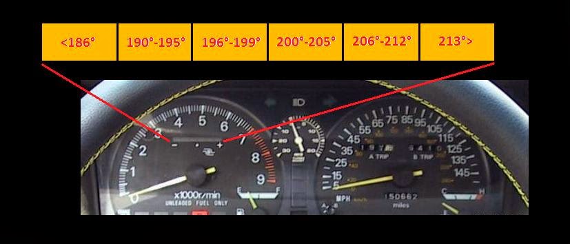

I just wanted to post an update. I've been driving the car quite a bit in the nice weather, and my coolant temps have been great. Now that the fall weather has started to set in, ambient temperature is averaging around 75°. At cruise on the highway, I'll see 186° to 190°. At idle and after sitting, the car never gets anywhere over 206°. In the peak of summer, the car would average 5° hotter than it does now in the cooler weather.
For you guys with ECMlink, you know you can configure the stock boost gauge to read coolant temperature. After previously having so many issues with my car running hot, I've watched that gauge to the point where I see it in my sleep. Currently, I have it on the low coolant setting. I wanted to post up the switch points for each LED. I know everyone with link can easily figure this out for themselves, but I figured it would be helpful none the less:
U_HZpxmbDwOsfX_WBoRhSy5pUVGyeGQkJiAqzelyGL0=w827-h354-no
Basically, I've found as a good rule of thumb, as long as the car never pegs gauge on the low coolant setting, the car is cooling as it should be. I'm running a 180° T-stat, so results may vary. I'd venture to say decent operating range for any 4G63 is from 180° to 215°. Anything hotter than that, and it may be a sign you have some cooling issues.

sweeeet thanks, im going to set my stock boost gauge to this now as i had been also having cooling issues a while back and i just recently think i resolved it and have been driving around with link in the car all the time watching the temp and it will be nice to not need the laptop. thank you!!!

My temp gauge stopped working(cluster failed) so I switched to the coolant lo setting too. I think it's the best and most useful of the link settings.
