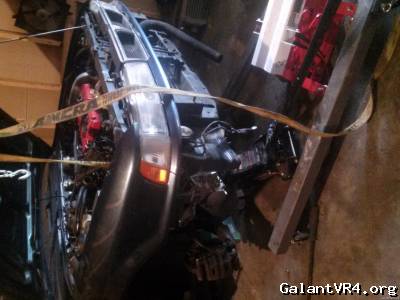

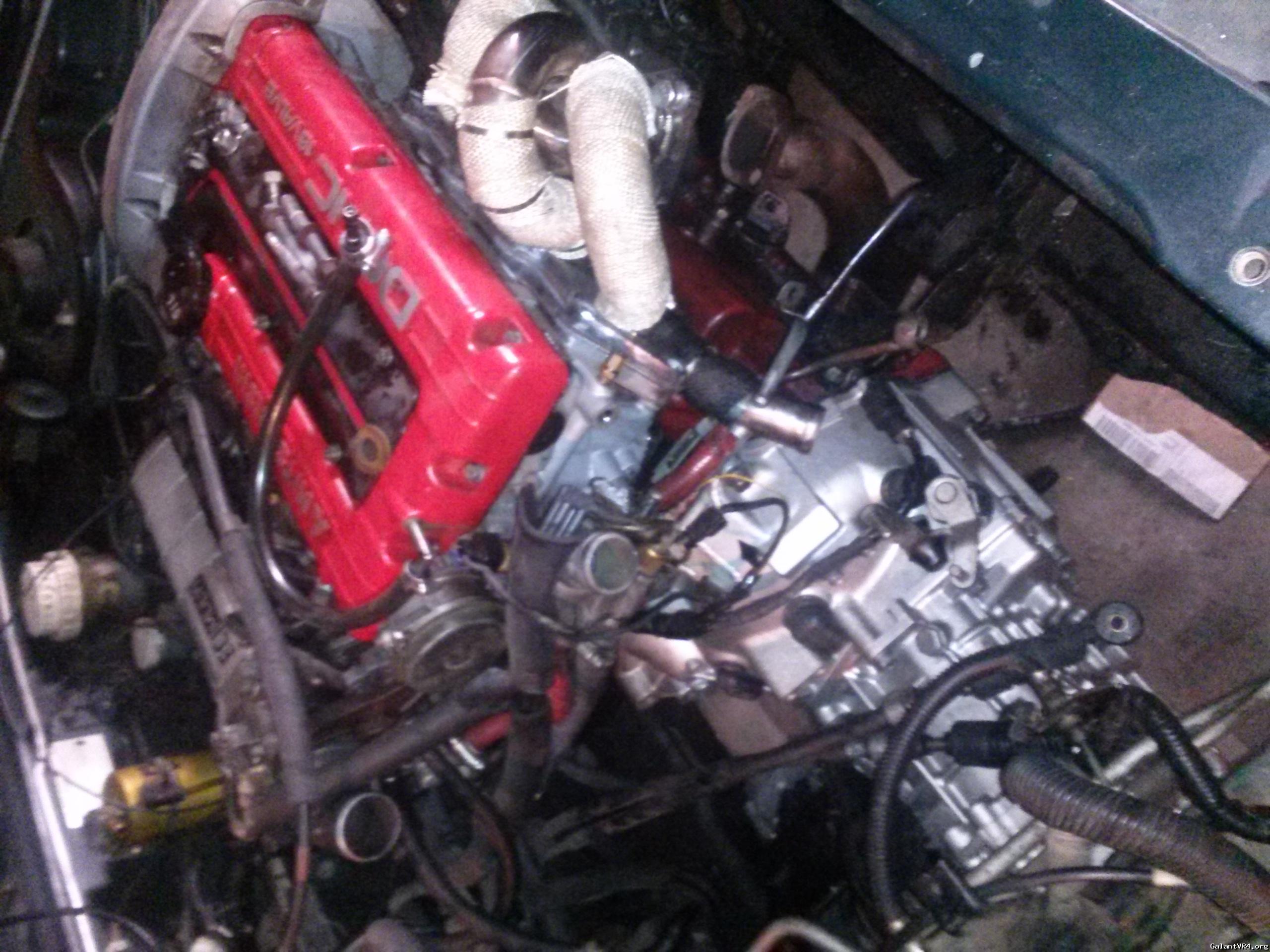

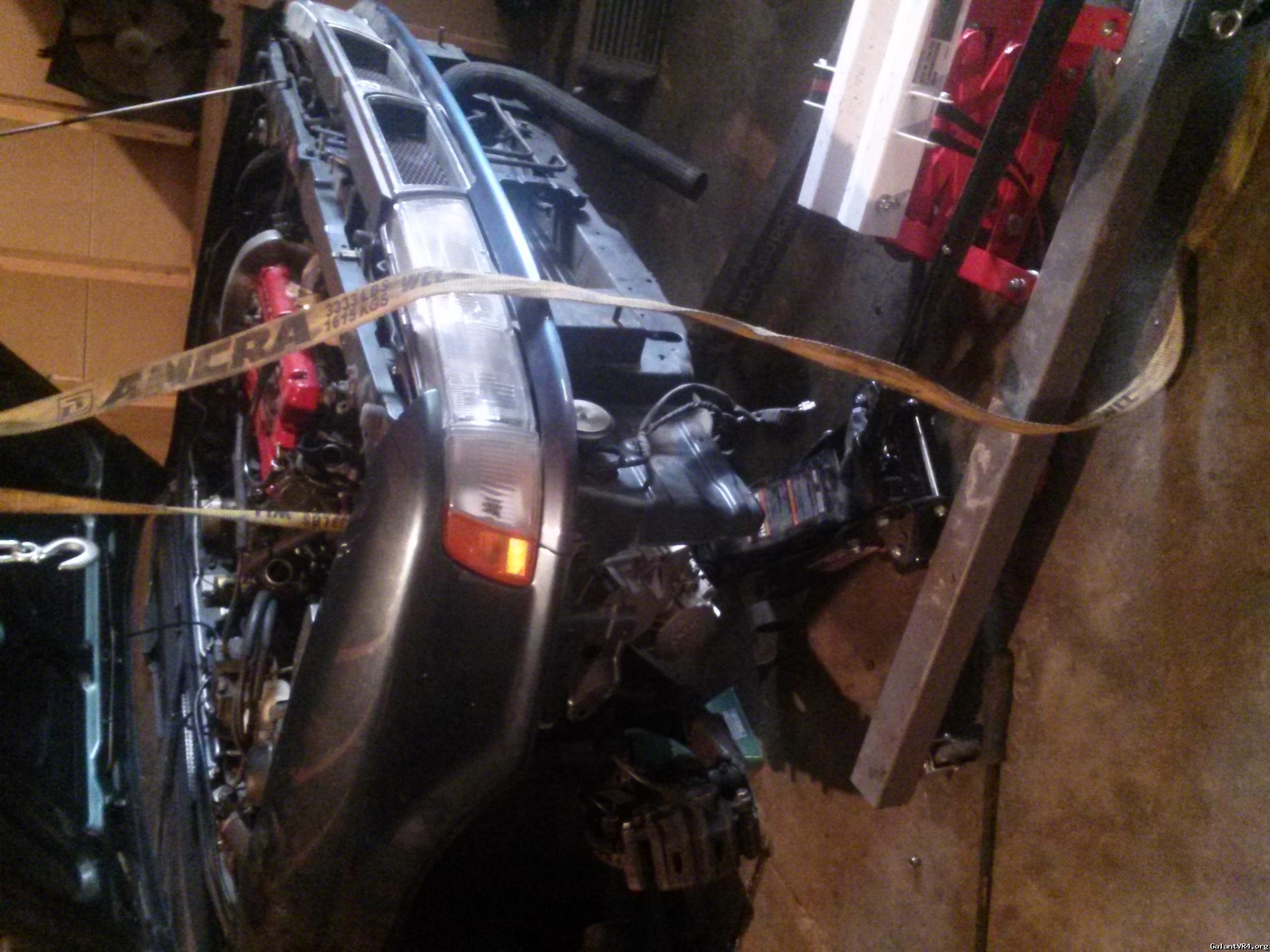

Okay guys got to work on my car today and i got it..! I ended up using a jack and a enigine lift with not too much effort. Thanks for all you suggestions guys i really appreciate it.
