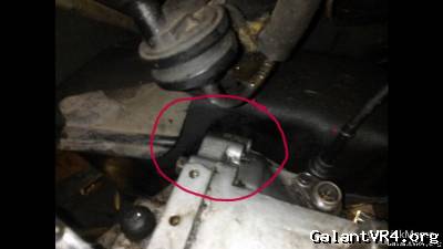

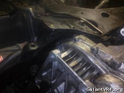

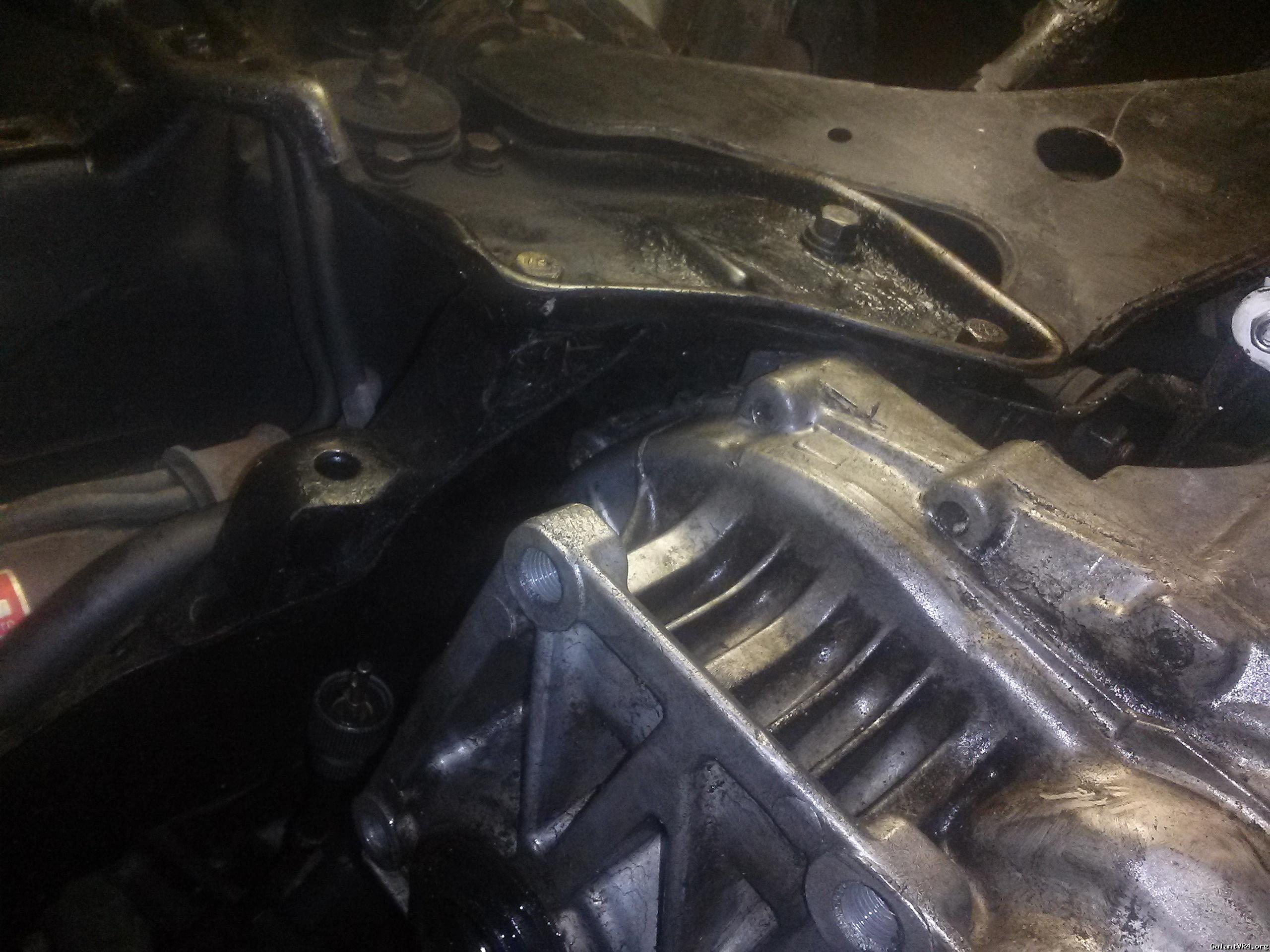

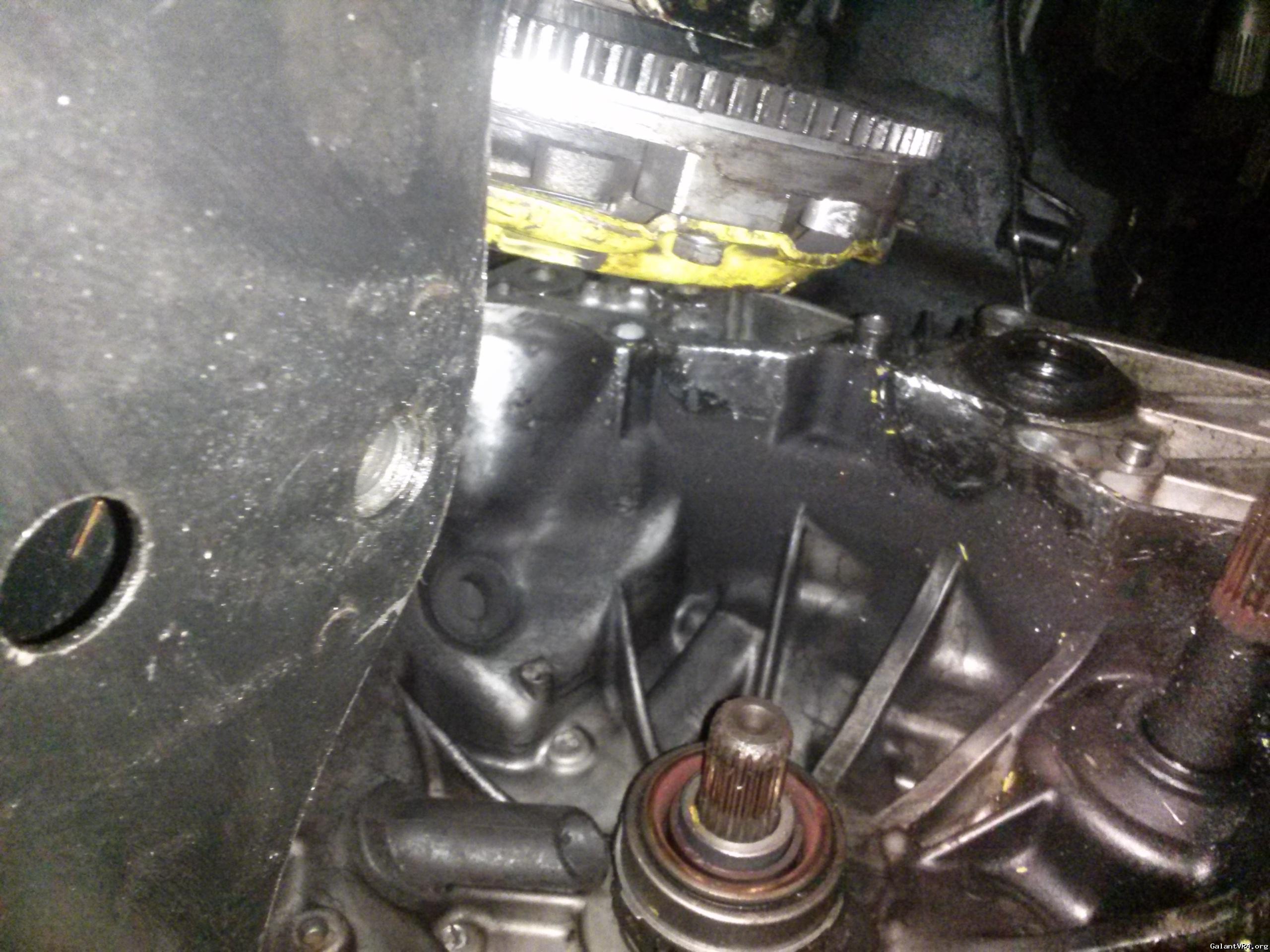

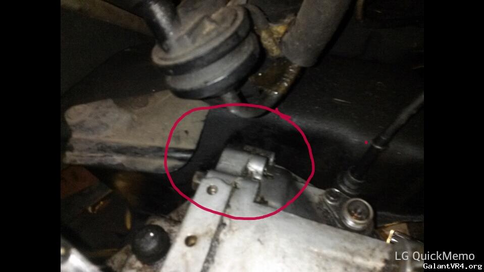

Im having trouble wiggling the tranny out. I removes transmissions before on dsms but never had this problem. Trying to slide it out straight but i keep hitting this bracket. Any tips..?
11,982
Remove the gusset (bracket). It's like five bolts. /ubbthreads/images/graemlins/dunno.gif
manikbastrd
Nov 19, 2009
660
Yeah, pull the bracket, also the whole rotate the tranny thing usually helps. Counter clockwise if you are looking at it from the wheel side.
xuberantz
Mar 29, 2014
47
Northern VA
It's possible to remove/install with that plate still installed but it's a royal pia and requires a lot of twisting, lifting, and cussing. It's so simple to remove the five bolts and get it out of the way it makes removal/installation 100x easier.

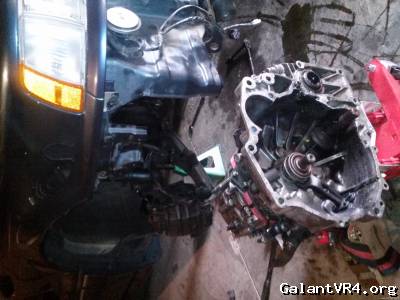

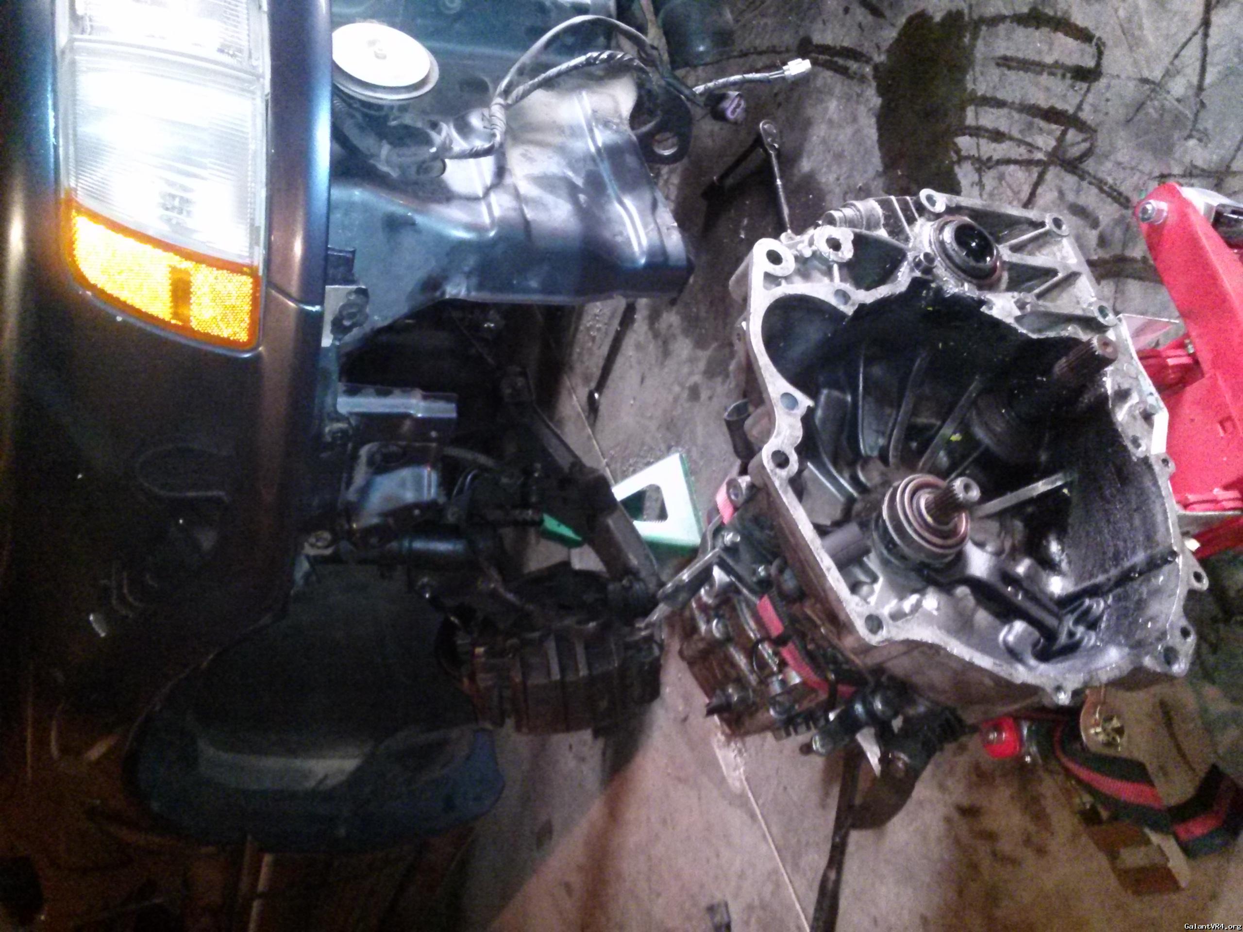

xuberantz lol that was me yesterday i swear i almost had it but it was getting late. Also that passenger axel was a pain it popped out at the boot.

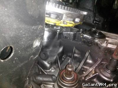

Well guys im trying to get my shiny new tranny mounted but i cant seem to get it in. You guys have any tips to help? I have a tranny jack but should i just try to get a second person?
coyotes
Nov 15, 2013
1,544
Seattle, WA
I think a transmission jack is a pain in the ass. I've always put them on my chest and stuck em in. Done many that way, even by myself.
gvr4144
Jan 26, 2014
170
loveland Colorado
How strong are you..? lol im 200 pounds and know im stronger then most. Seemed like i was going to get it but the throw out bearing popped off and my shoulder got pinned under it /ubbthreads/images/graemlins/crazy.gif lol
