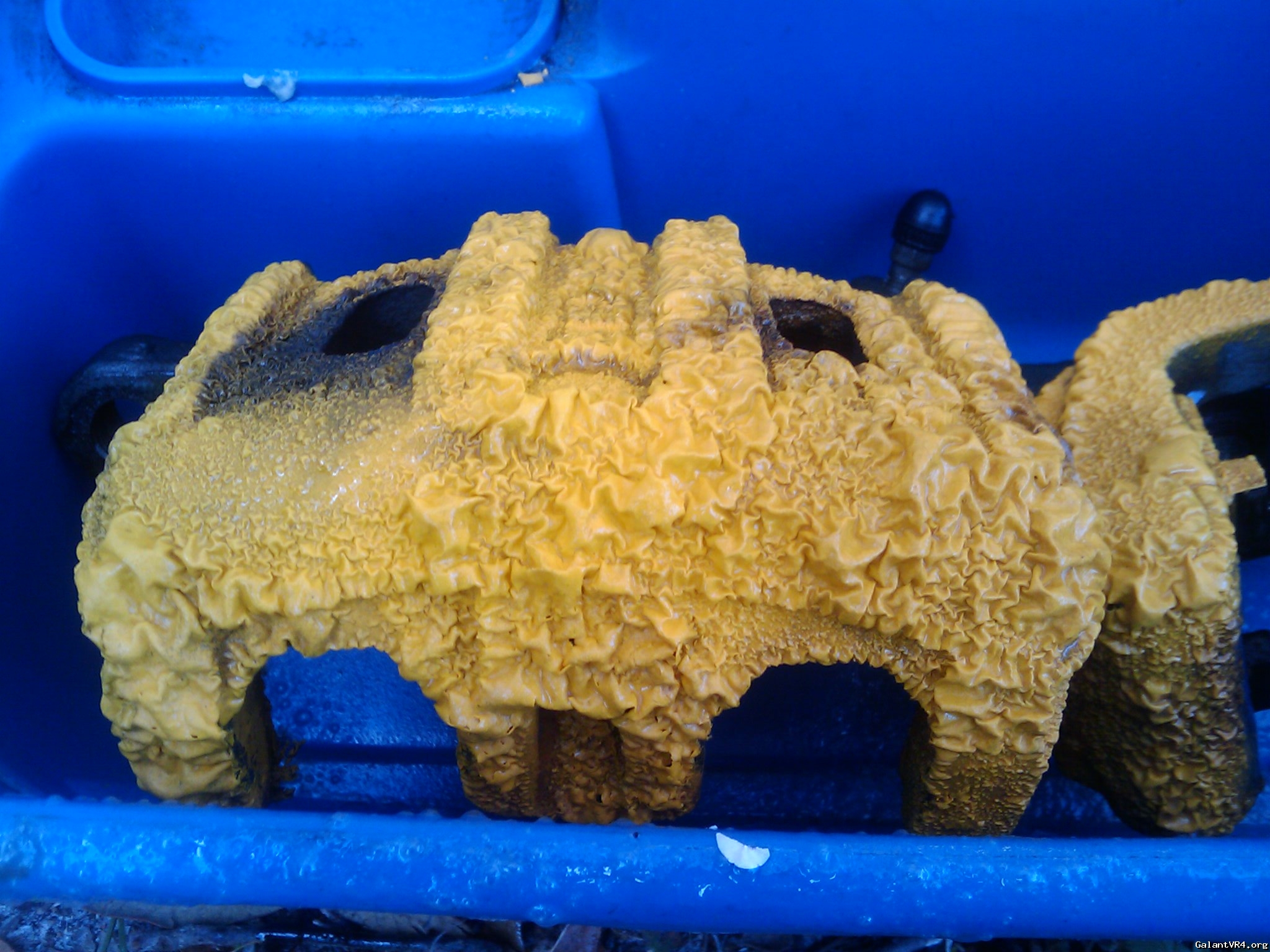

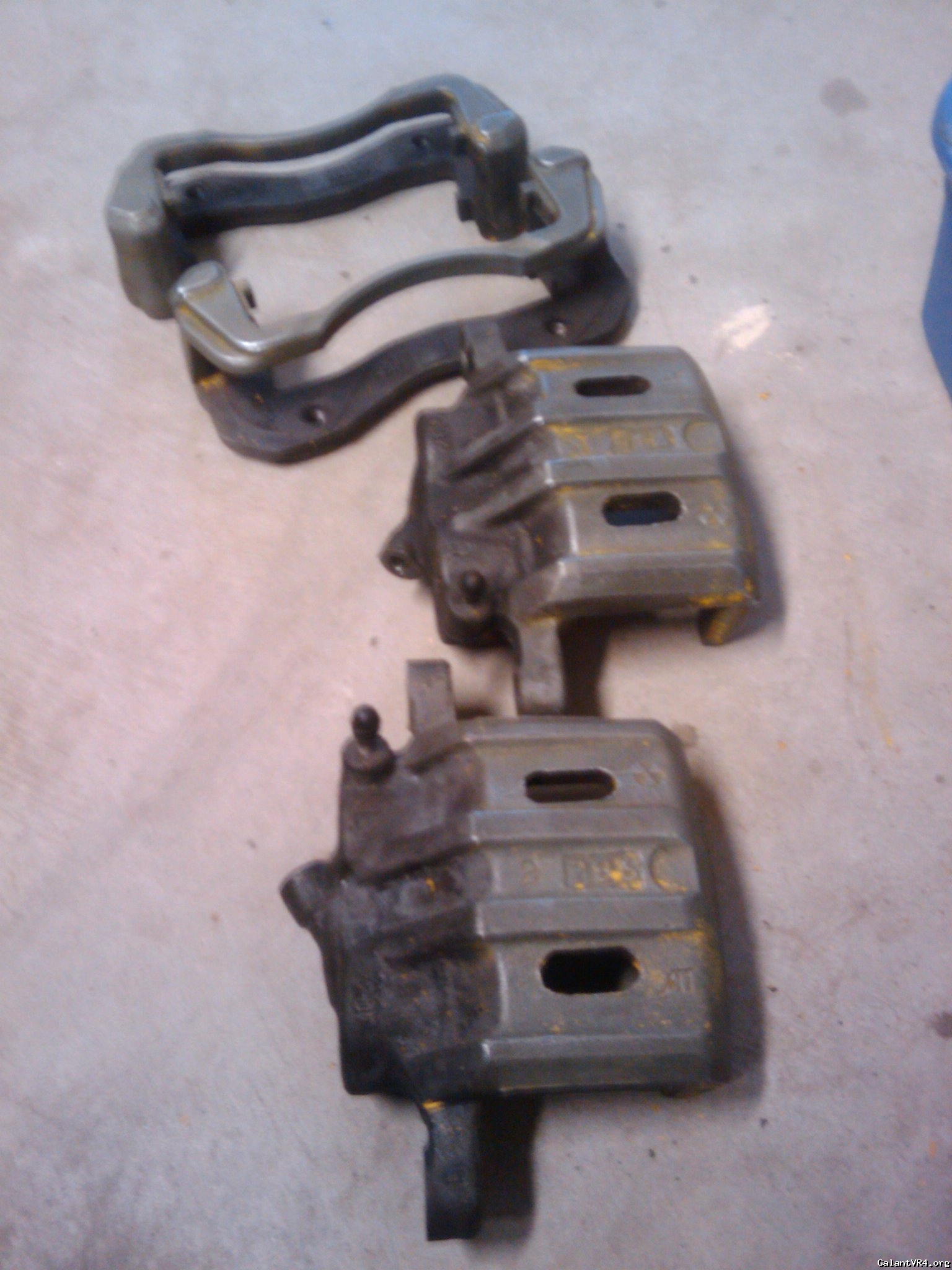

I decided not to rebuild them because the seals looked fine. Here's the results of the aircraft stripper. Works pretty well, but if you get it on your skin, it feels like sticking your hand in a fire ant pile. Not recommended. After I was about 90% done using it, I had the bright idea to find some gloves. /ubbthreads/images/graemlins/shocked.gif
There's still a yellow tinge to the calipers, and I couldn't get all the paint off. I think I would have to take a wire wheel too it. So I picked up some black caliper paint because I think that will look the best.

that's the crushed velvet caliper mod, all the cool guys are doing it.
Make sure you clean that stripper off with carb cleaner, or something similar, if you haven't already. Also, I blasted and powdercoated my calipers chrome, with all the internals still together and it held up fine. They were new, but I'm sure used ones would be fine too. If they can withstand the blasting/carb cleaner/oven, I'm sure they can withstand some stripper and cleaner. /ubbthreads/images/graemlins/wink.gif
