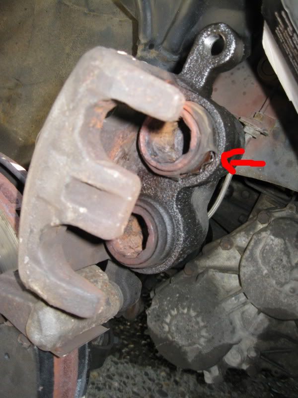

I would get a rebuilt over doing it yourself, have you checked the condition of the calipers overall and which ones fronts or rears? I know mine were pretty rusty when the last time I did the brakes before my right front caliper had one piston sieze up on me. It also had the tear in the boot and any water that got in there really didn't help that situation out anymore. I believe NateCrisman has a set of fronts for sale.
