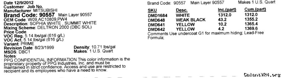

I've been doing some digging and I'm confused on what I thought my car exterior color was summit white. Even the 91 color code brochure shows sophia white. A nudge in the right direction would be greatly appreciated.

So its the same..... both Sophia white and summit white share the same code. I knew something was up and thank you sir. I'm already trying to track down a sata 2000.

You will find that in most places you look for the paint as well, there can be several names for the paint and as long as they share the same paint code you are good.
