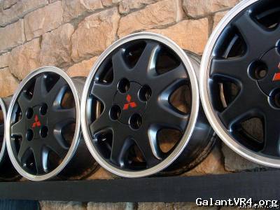

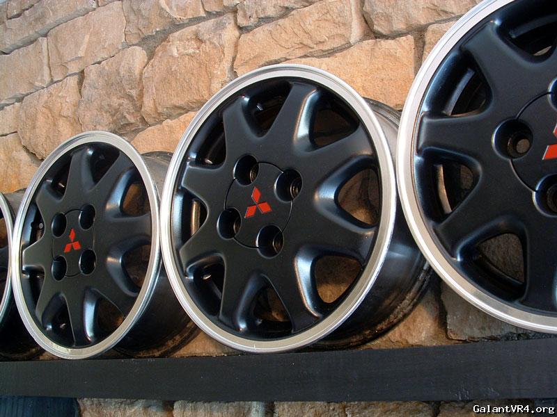

I have refurbished several sets of wheels. I use paint stripper and a pressure washer to strip them down. Get the gel type and paint it on, let it sit and then blast it off. Repeat for any stubborn paint. All GVR4's should have the machined lip. I use 1/8" fine line masking tape to mask off the lip because it turns easy. Then use thicker tape/paper to mask off the remainder of the lip and the tire if you don't remove them first. If you want them to match find someone that sells the oem paint in the spray can, like you said regular white wheel paint will not match exactly. For the center cap I stopped by a sign shop and asked for a scrap piece of red vinyl, cut a small section and place it on the mitsu logo, heat it with a hairdryer and use a toothpick to get it pressed in good. Then use a sharp hobby knife to trace the diamond and peel away the excess. This is a lot easier than painting them for sure and holds up well.
It's up to you on the clear. For a stronger finish they will need to be cleared, especially if the paint you buy is just a base coat. I would take the time to polish the outer lip, paint the wheel and clear the whole thing. It'll look much better. Here is a set that I did for a member on 4g61t a few years ago. They just wanted a satin finish.

The only reason I prefer stripping them is because a quart of paint stripper at Lowes is around $10. Most places would charge $10+ per wheel for bead blasting and you'd still need to strip the plastic center cap I believe. Regardless, getting the wheels down to bare aluminum is what you want. It's up to you how to get them there.

89, those wheels look amazing.

Matt beat me to it. Agreed those wheels do look great 89Mirageman!
