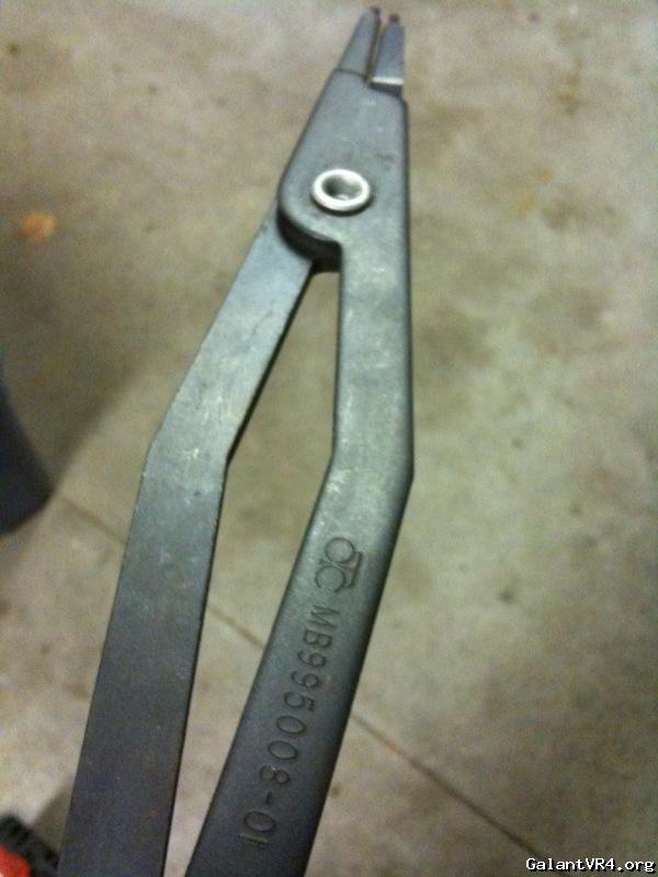

I just use the Mitsubishi pliers that come in the complete set of Mitsubishi Speciality tools. Sorry, it probably doesn't help, but it made me feel better for owning these damn things.

jepherz
Aug 8, 2004
7,878
KC, Missouri
I ended up having to buy a set of these and drilling two small holes in the snap ring for removal. The snap ring pliers worked awesome!
