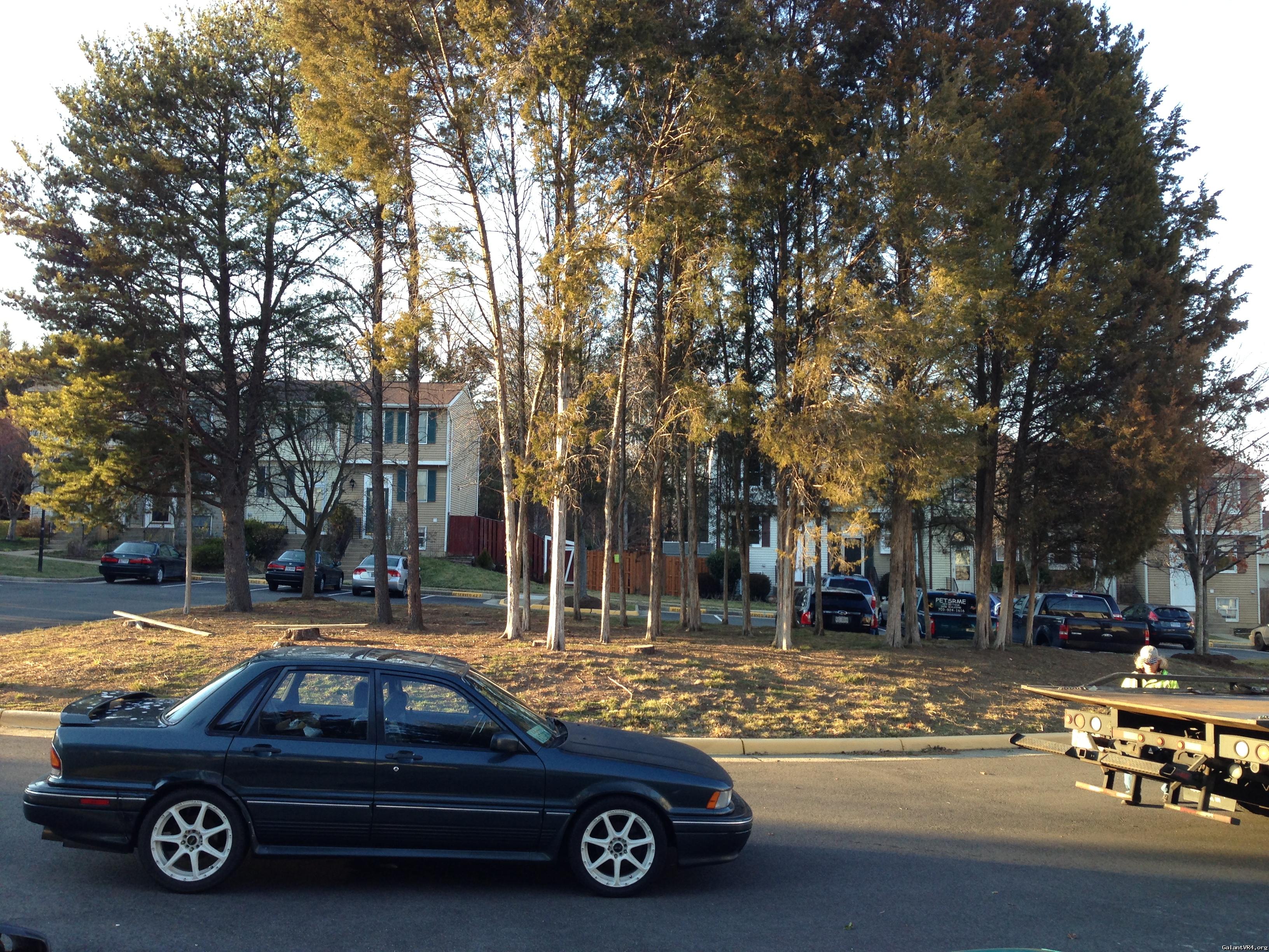

Bored so i decided to post up my work thus far. I never really introduced my self i just kinda lurk here and buy parts. Most of my parts i bought here or tuners. So yeah check it out and feel free to comment! /ubbthreads/images/graemlins/tongue.gif
Head
BC springs
HKS 272 cams
Arp head studs
Evo 8 retainers
New NGK spark plugs & wires
Evo 8 Injectors
Mitsubishi composite head gasket

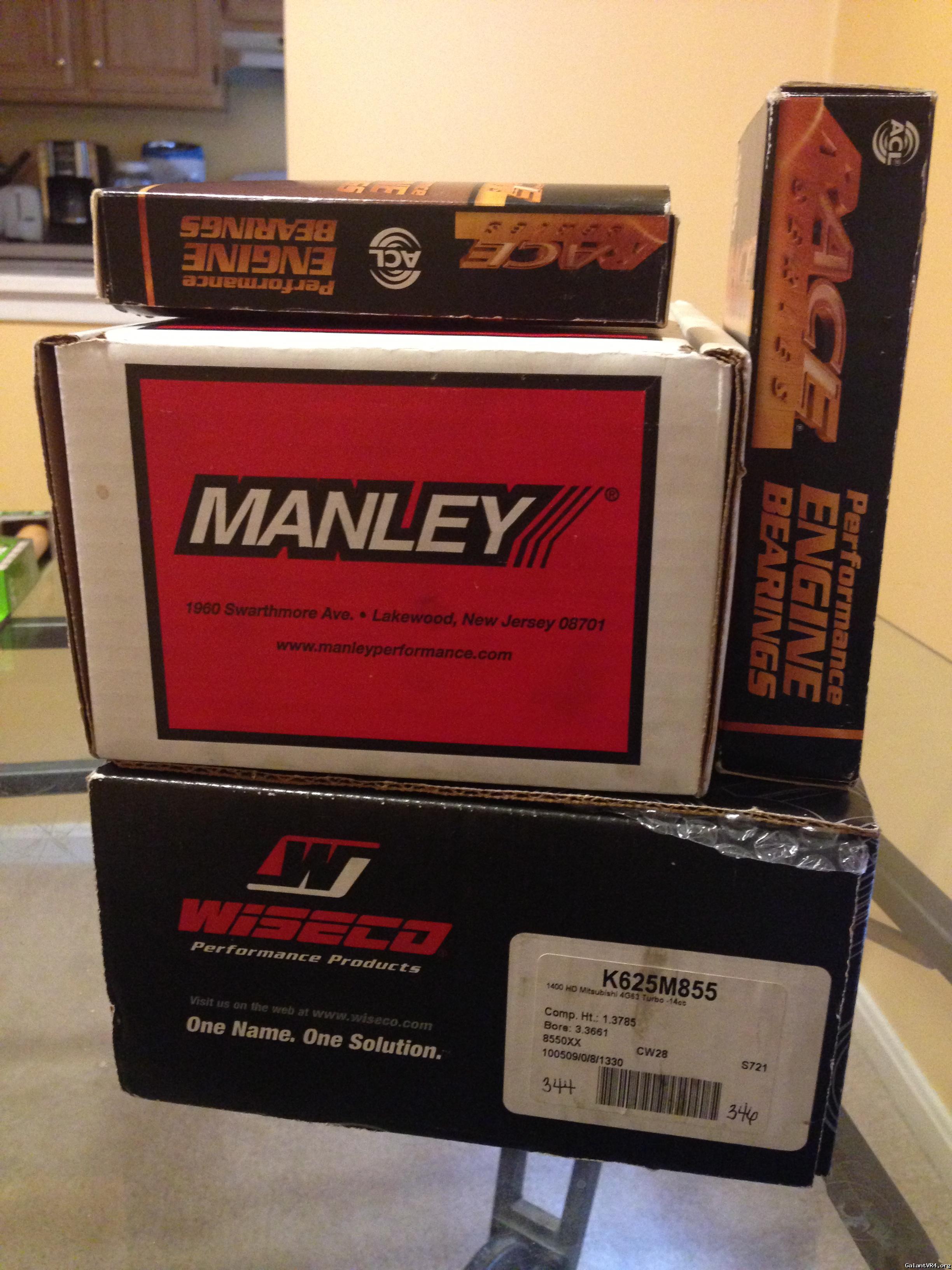

Short Block
Wiseco HD's 8:5:1 .20 over
Manley Turbo tuff I beam rods
Stock crank inspected polished and straightened
ACL race bearings stock size
Brand new Mitsubishi Oil Pump with new Straight gears
Brand new Mitsubishi Water Pump
Brand new Mitsubishi timing components with Evo 9 timing belt
Fluidampr pulley with ARP balance bolts
Brand new Mitsubishi oil strainer
Brand new Mitsubishi oil pan bolts
Balance shaft delete
Brand new stock clutch with ARP flywheel bolts
Cometic full gasket set
Fp 4 inch intake for speed density
Genuine MHI Evo 3 16g
Greddy black sleeper front mount intercooler
Exhaust
Fp manifold
Punishment racing 02 housing
Tial 38mm 2 bolt ext waste gate
Full 3 inch slip fit exhaust
Electronics
AEM ECM
Trigger disk for AEM
GM SD 4.5 bar map sensor
AEM Boost gauge
AEM Oil pressure Gauge
AEM Wideband gauge
Battery relocated to trunk
GM IAT sensor
ABS deleted
A/C deleted
Power steering deleted
Extra goodies
APR FPR
Brand new shifter cables & clips
Walboro 255 fuel pump re wired
Prothane motor mounts
Mishimoto Coolant over flow can
Catch can
Racing steering wheel
AWS deleted
4bolt rear
5 lug swap
AFCO racing radiator with brand new radiator hoses and clamps
Engine bay painted black
Evo 8 wheels
Evo 8 suspension with Tein springs
Stainless steel brake lines
Stainless steel clutch line
Brand new Mitsubishi Clutch master cylinder
Brand new clutch slave cylinder
Redline shock proof in transfer case
Redline mt 90- MTL cocktail mix in transmission
10-30 Advance auto conventional oil (for break in)
10w-30 Mobil 1 synthetic oil

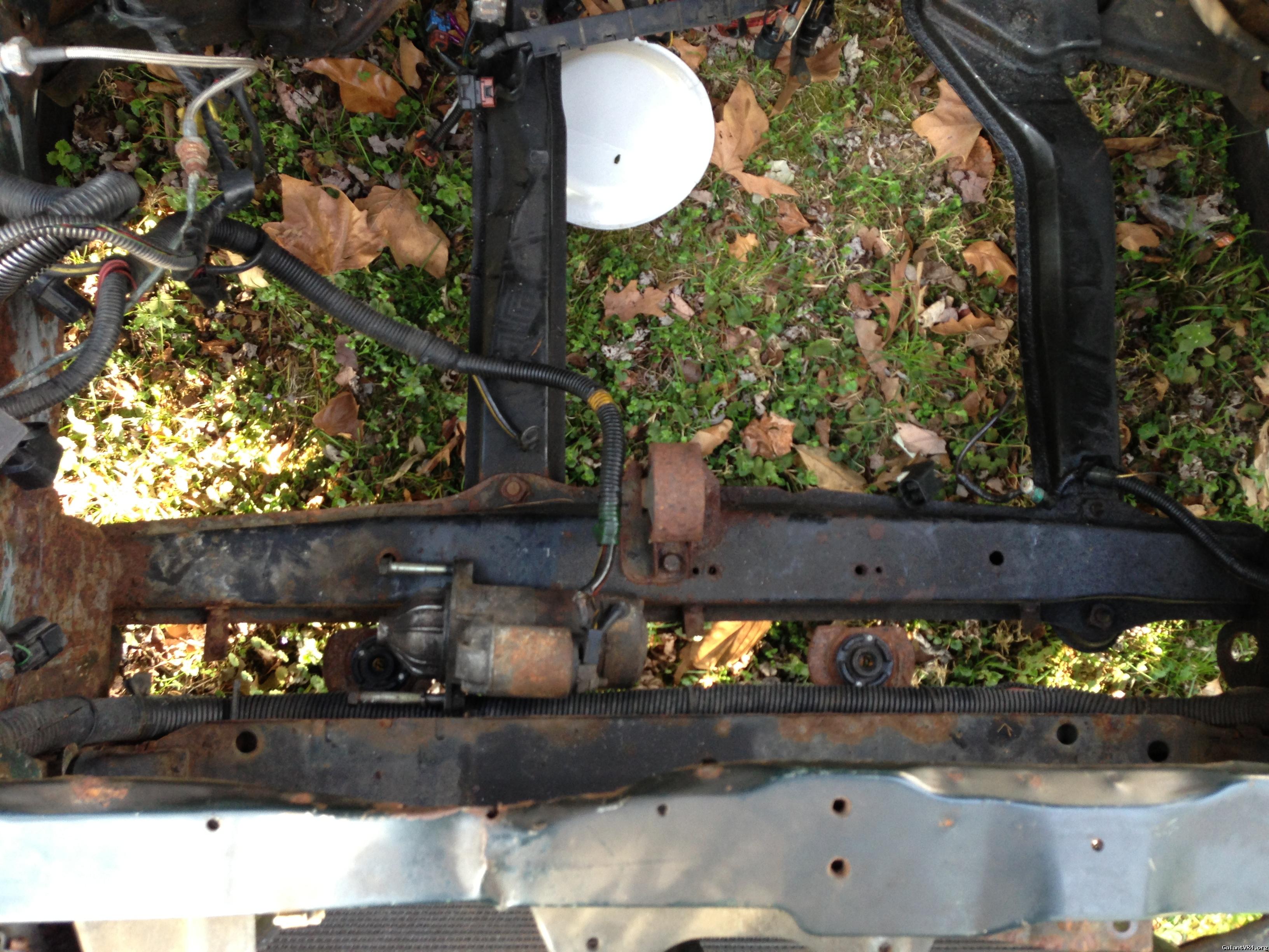

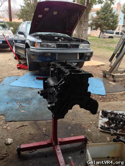

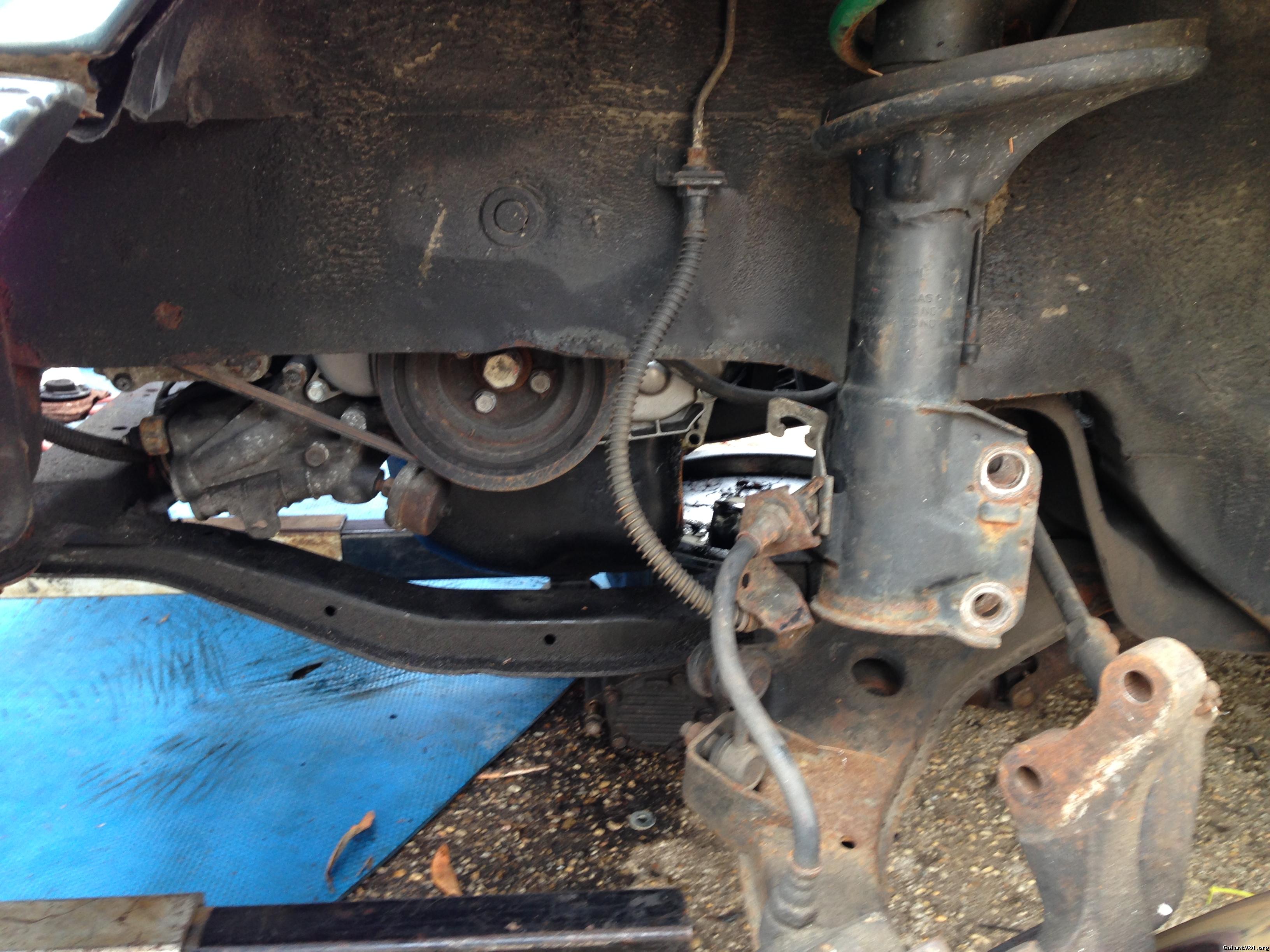

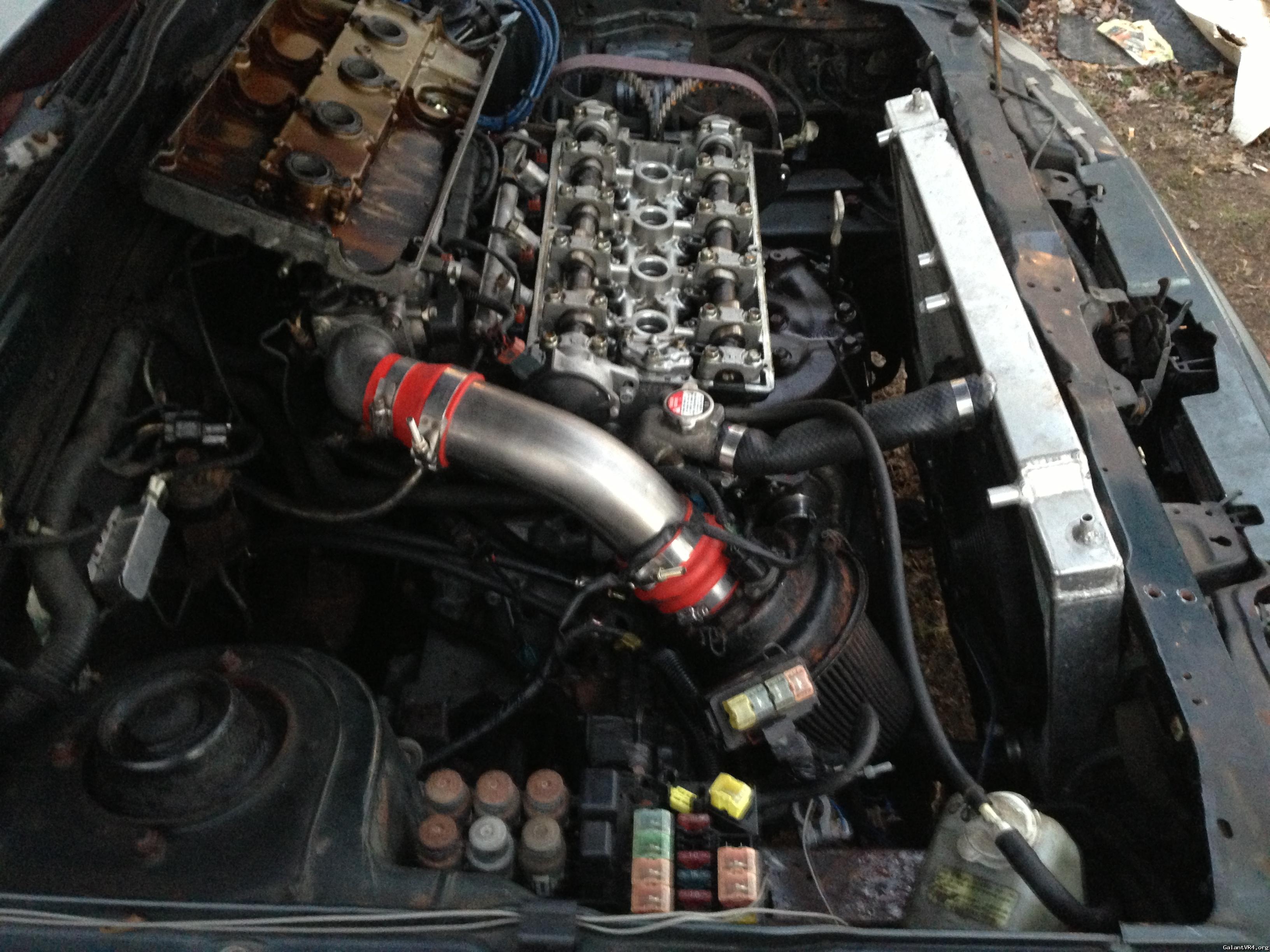

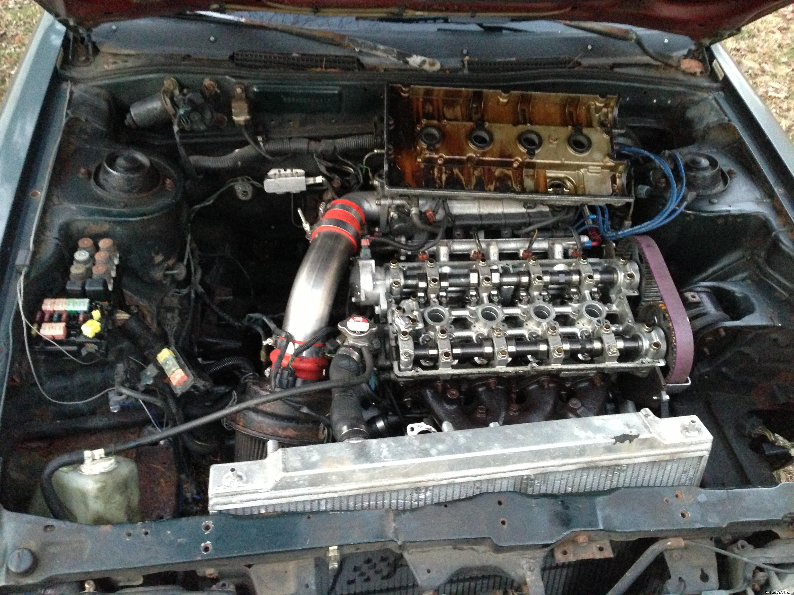

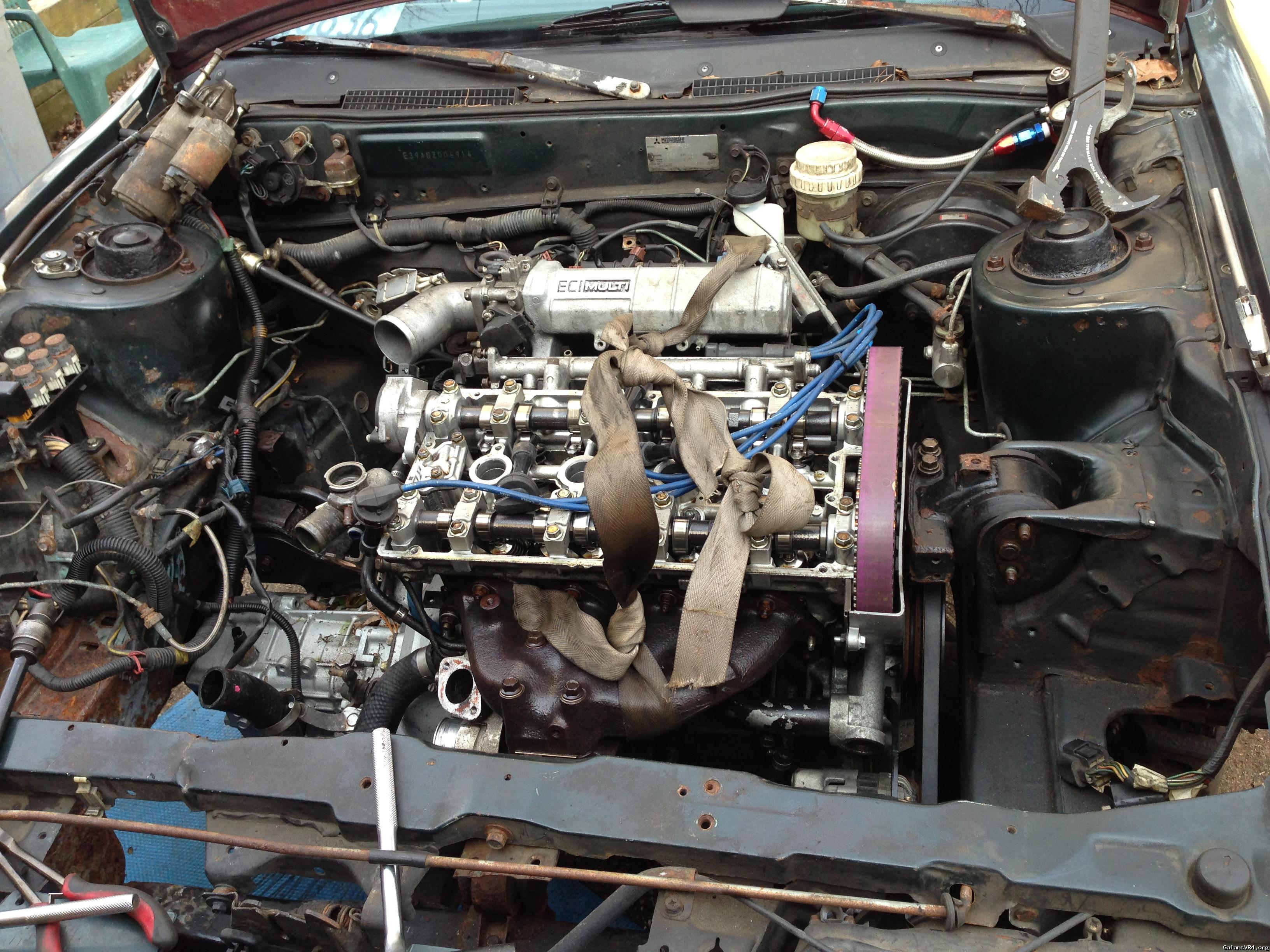

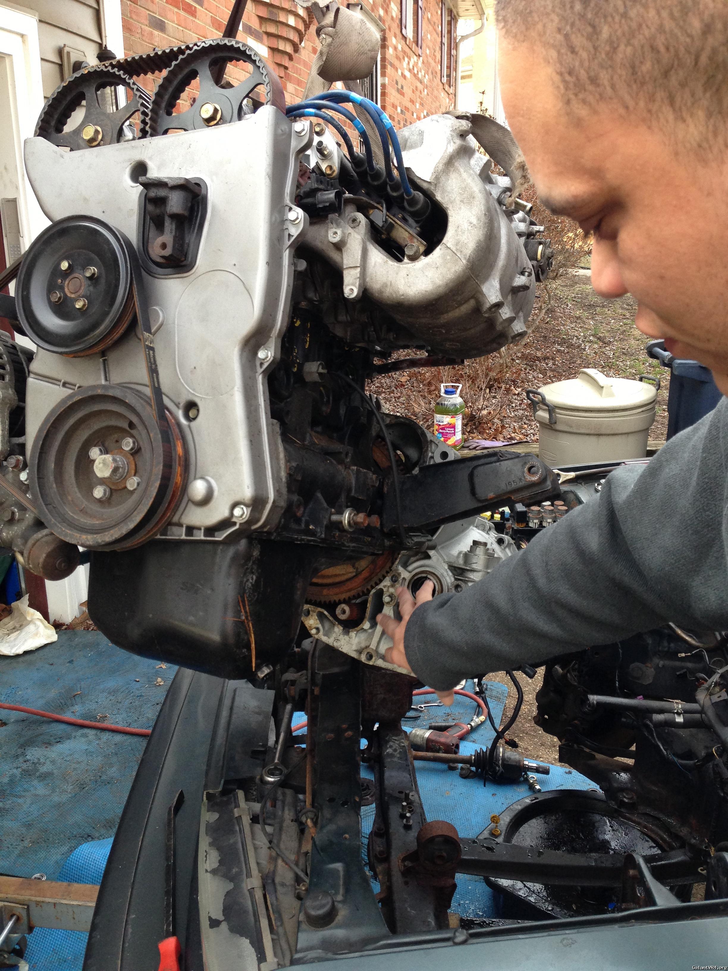

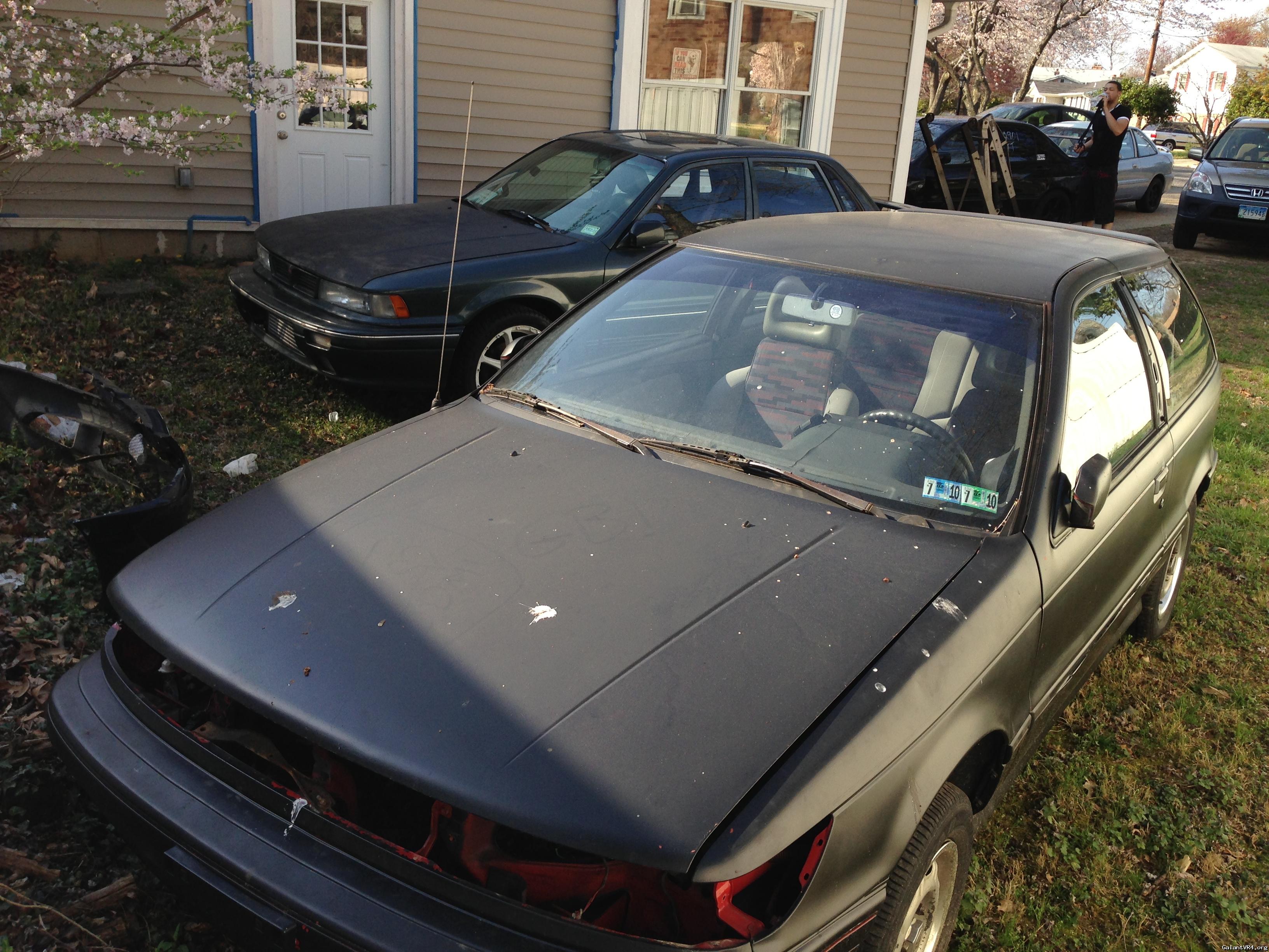

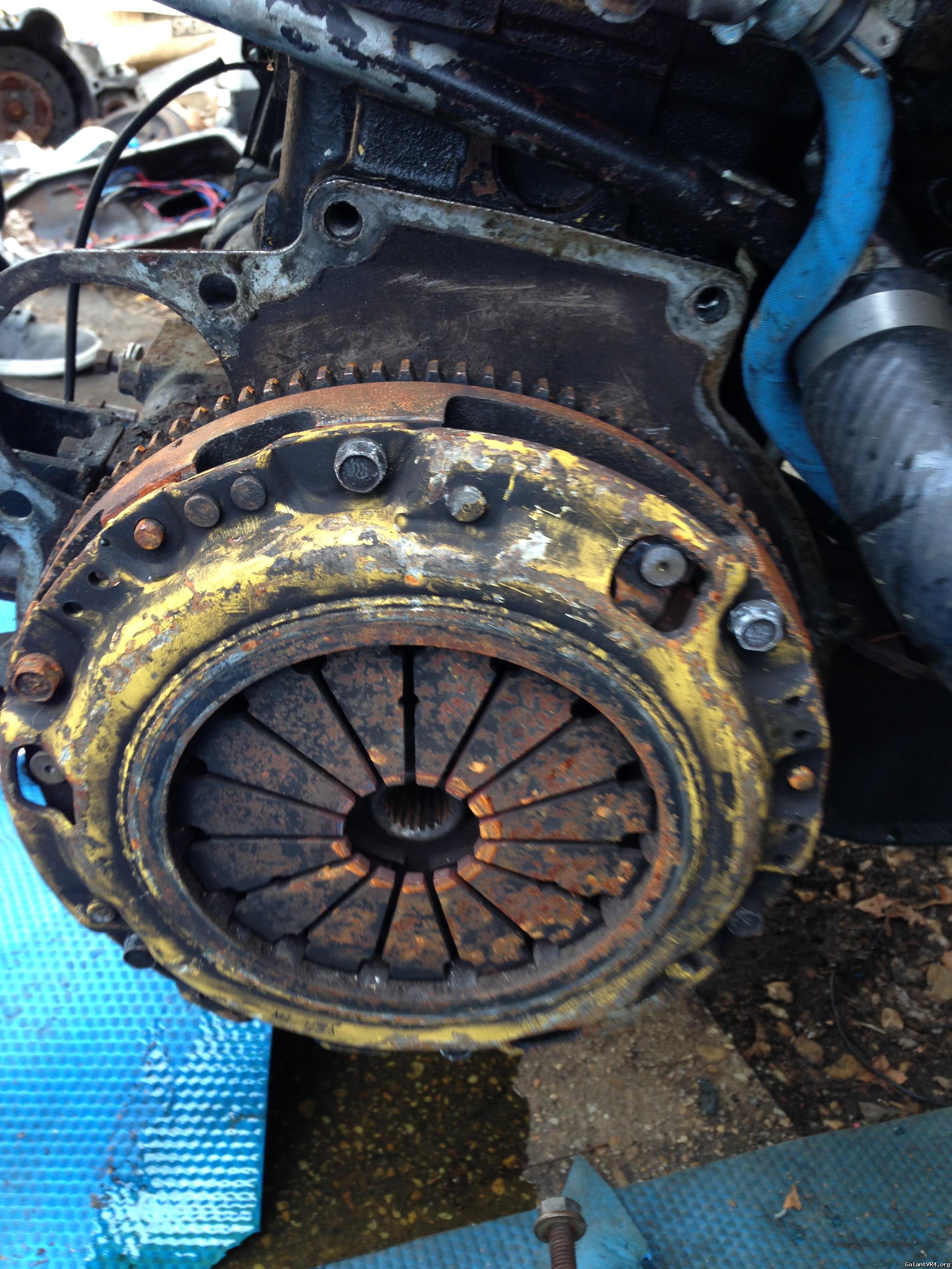

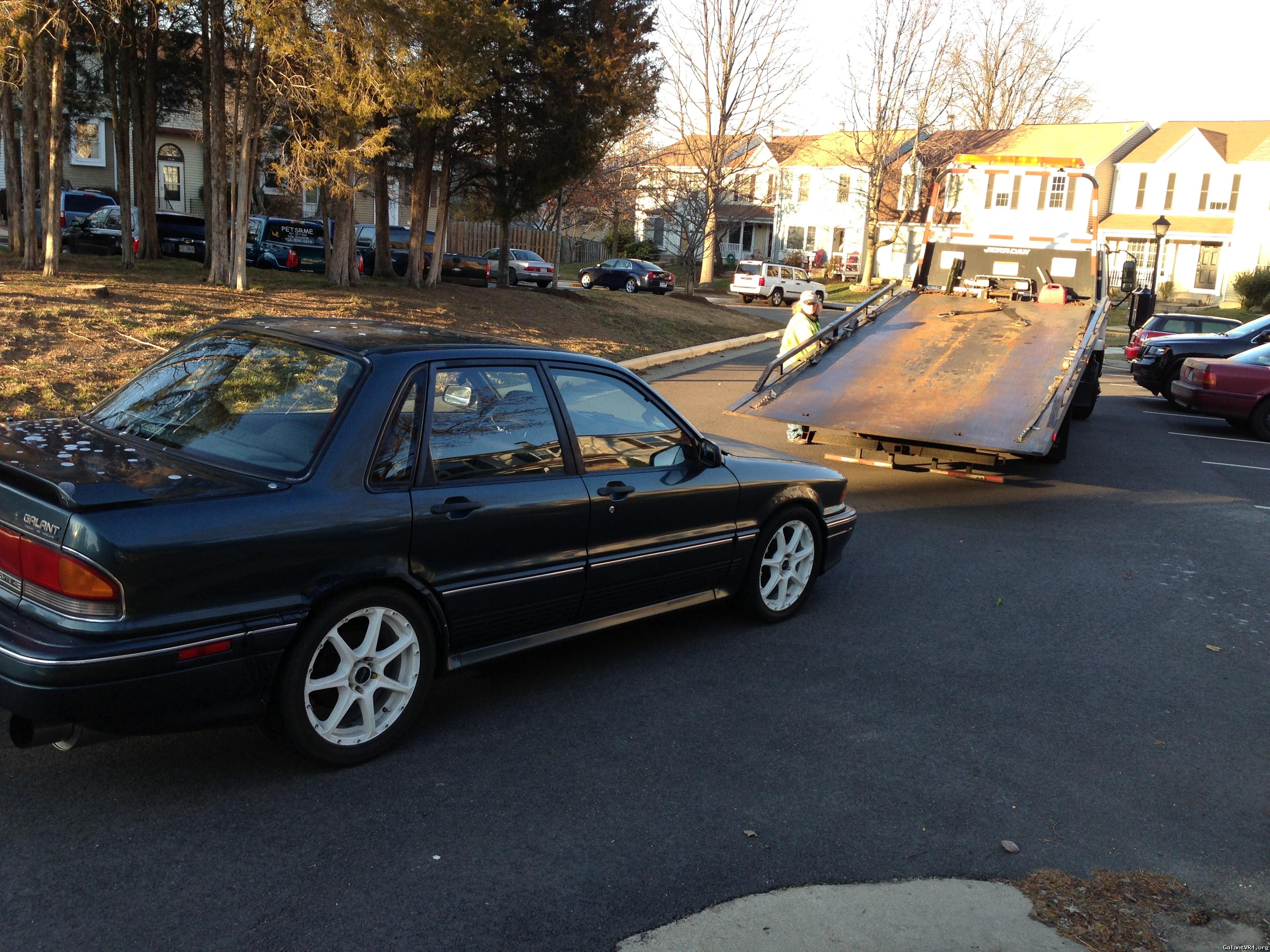

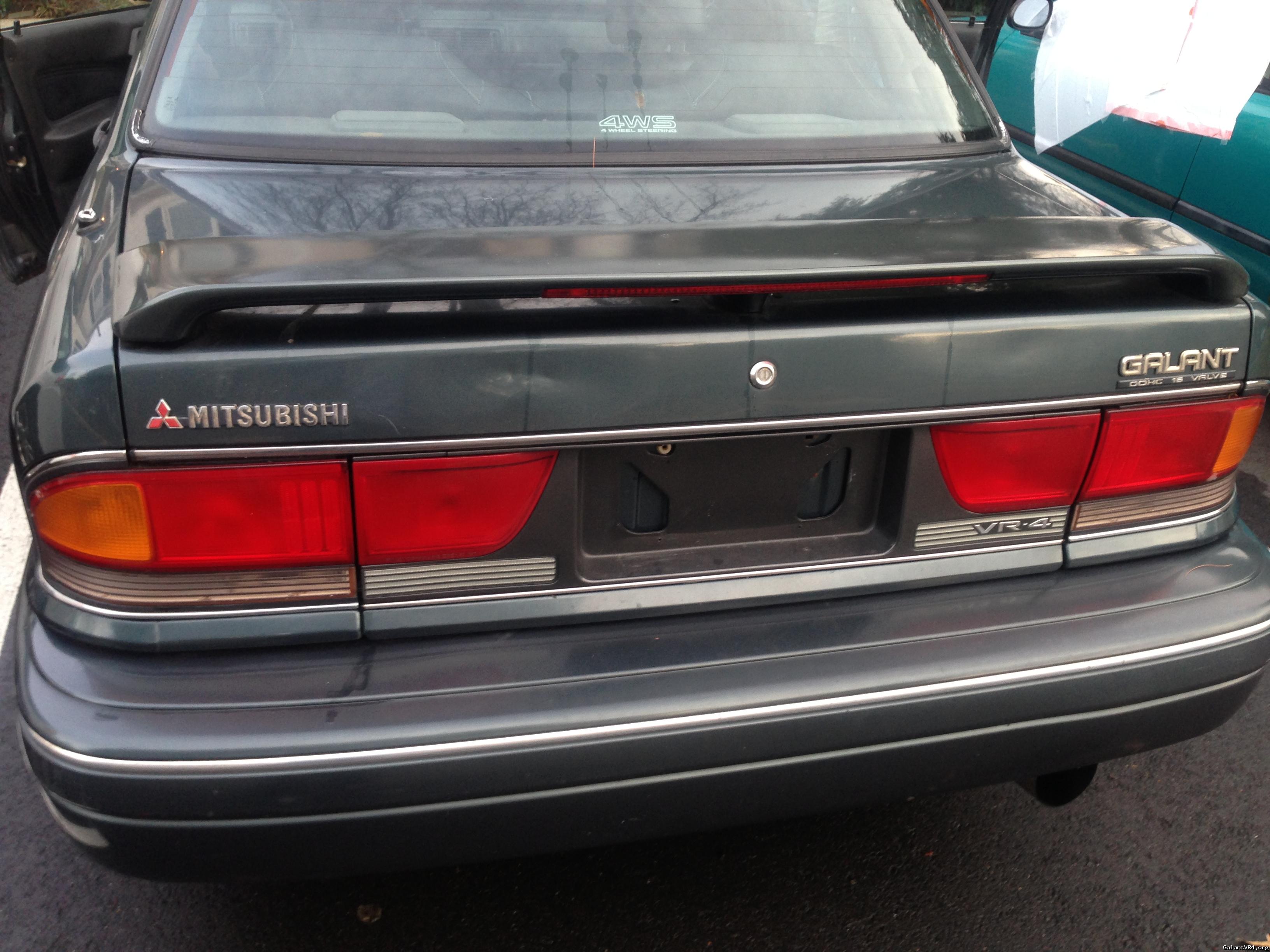

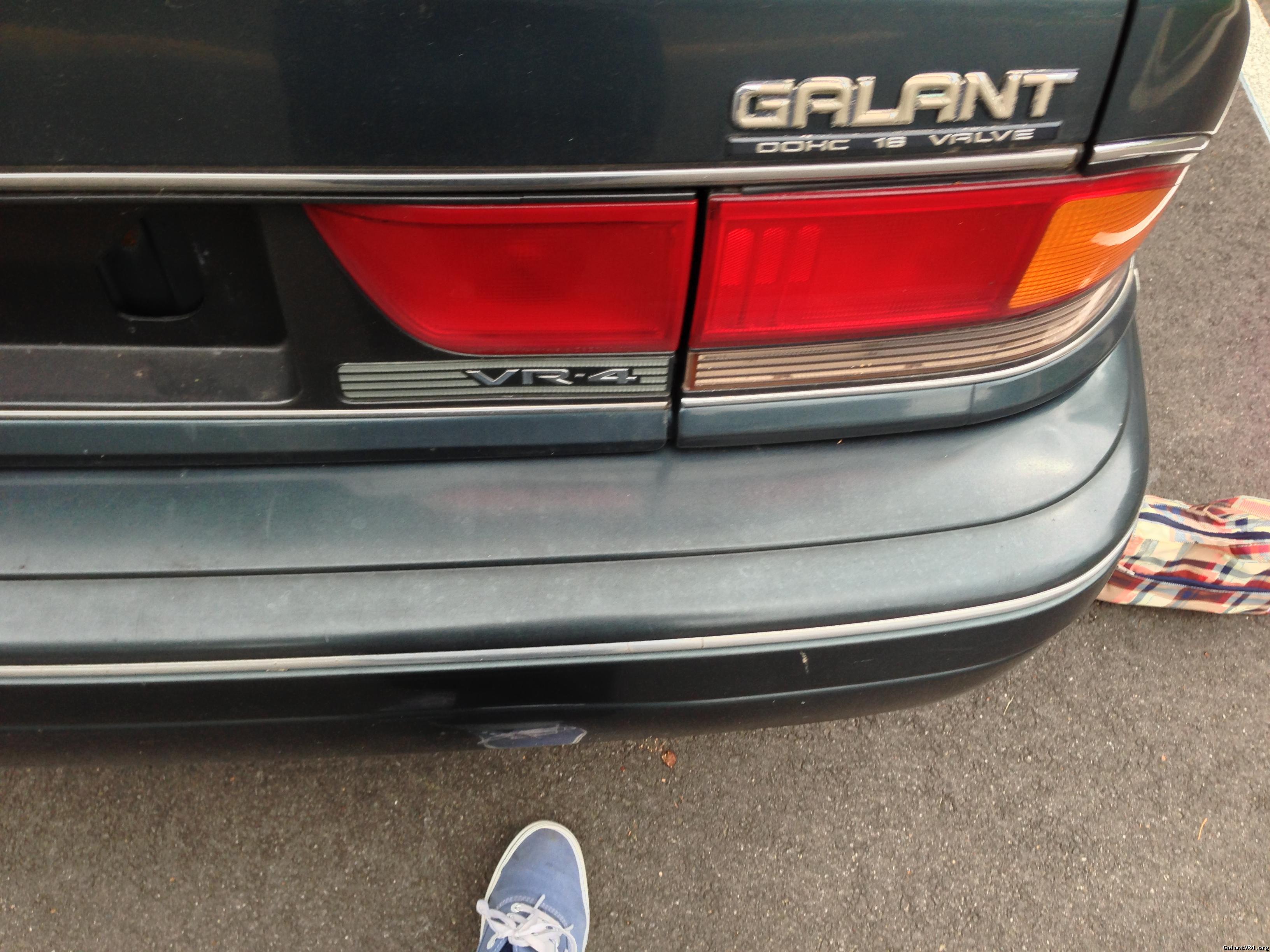

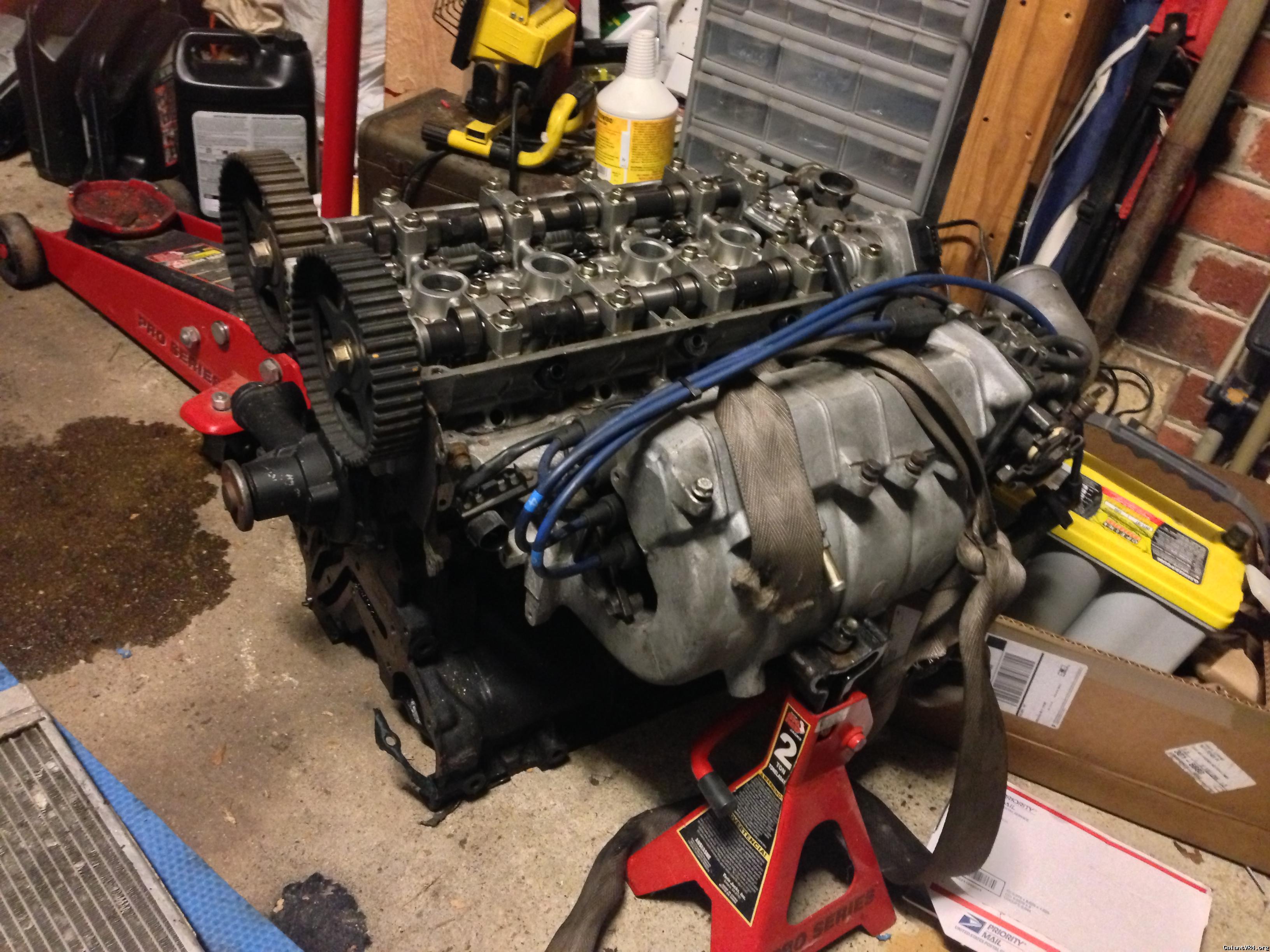

stripping it down for the take out
Pointing out the ghettoness
Buy this car he said. It has a ACT 2600 he said

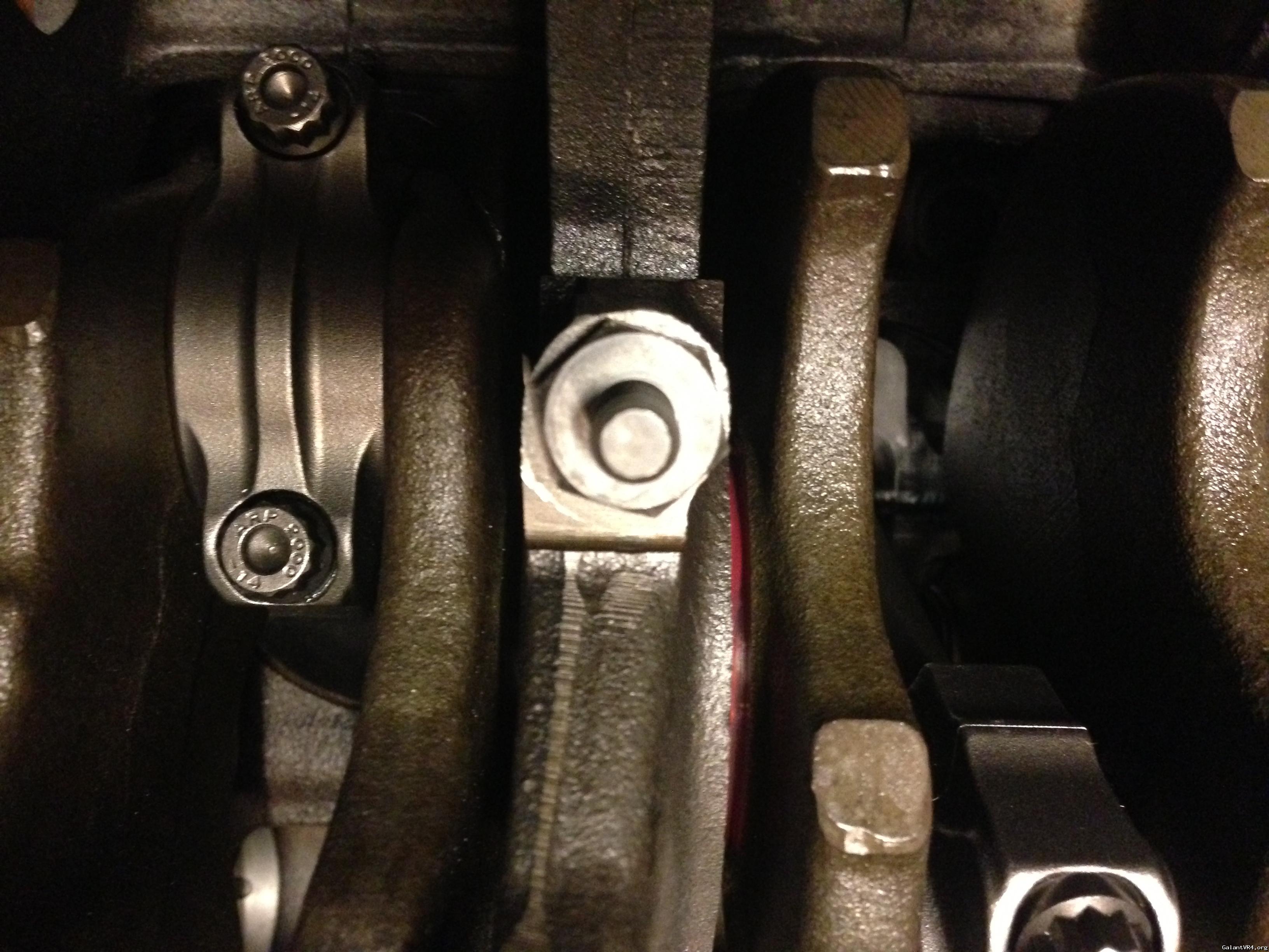

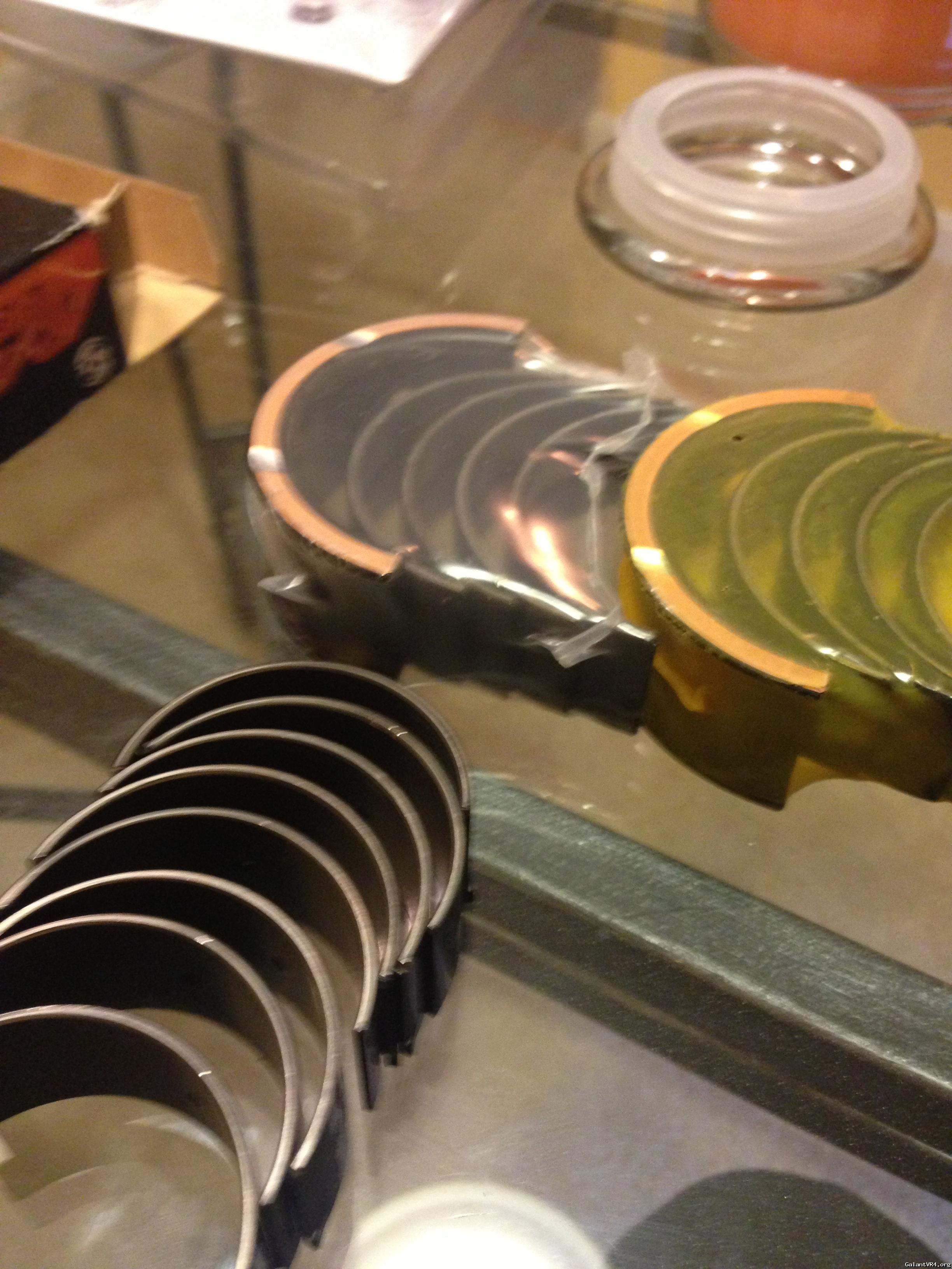

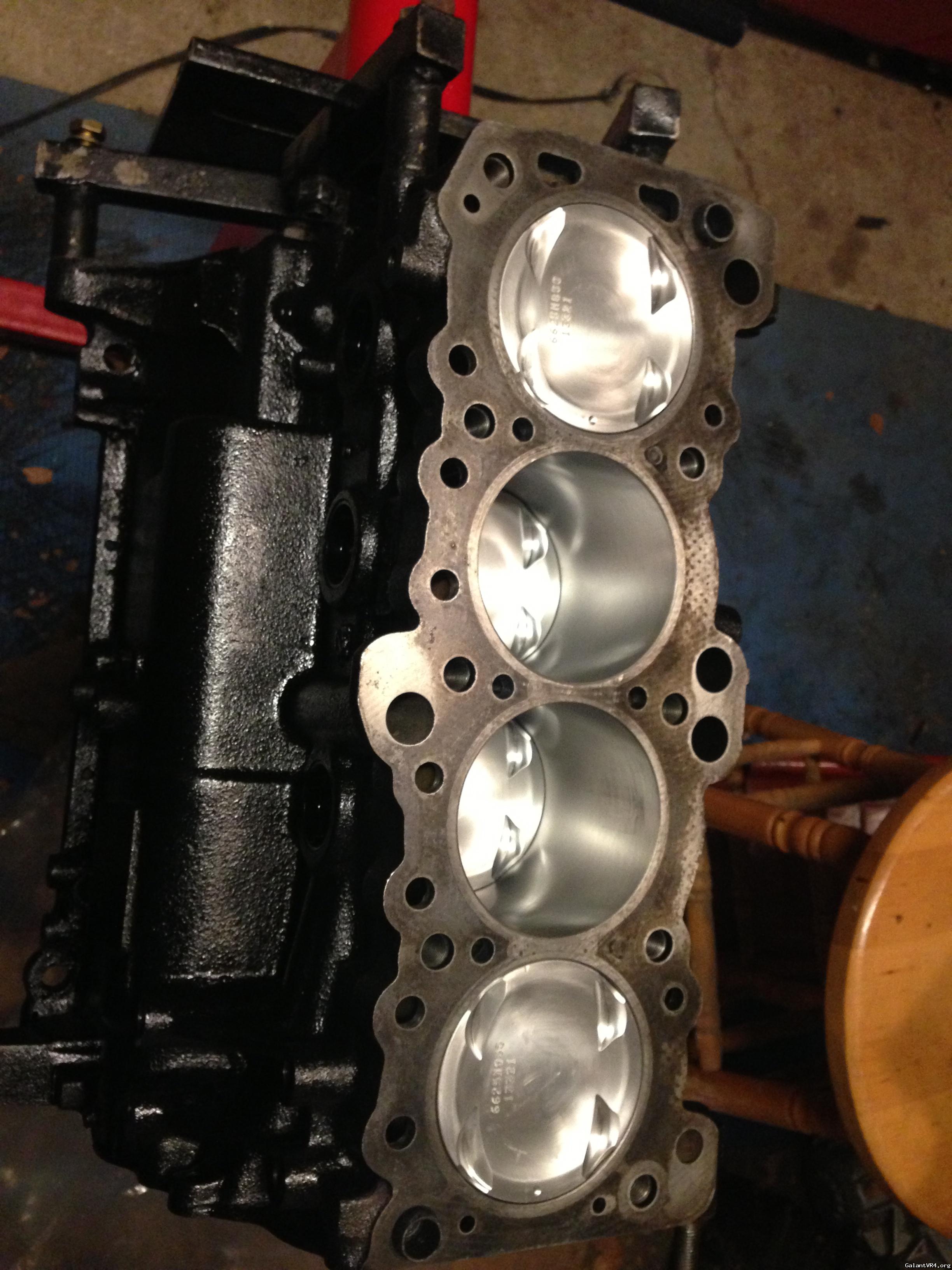

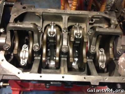

Parts
Tri Metal goodness

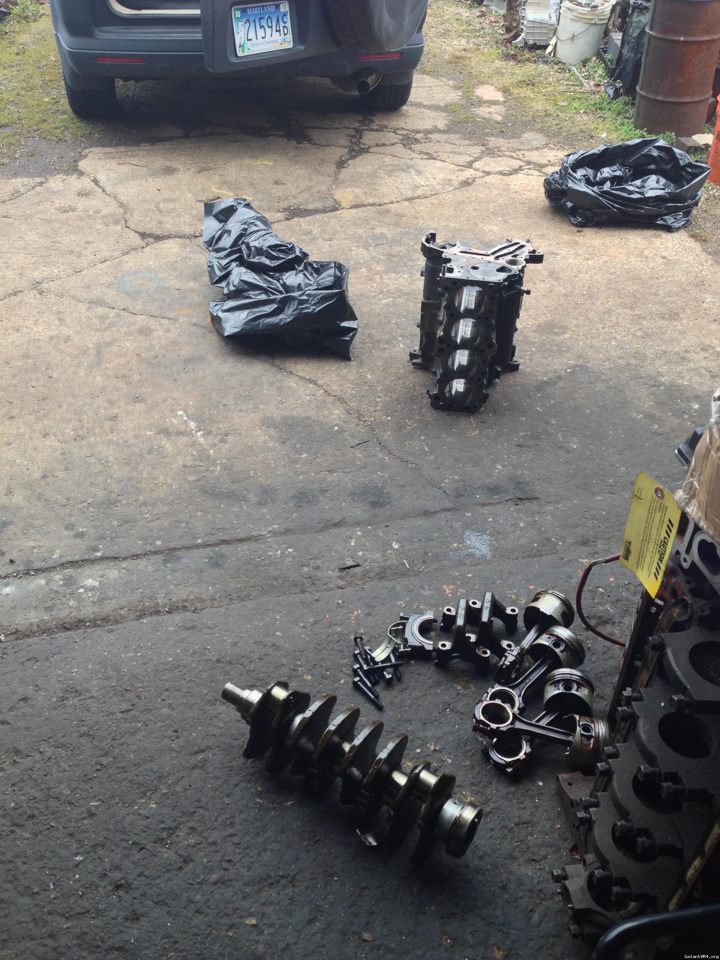

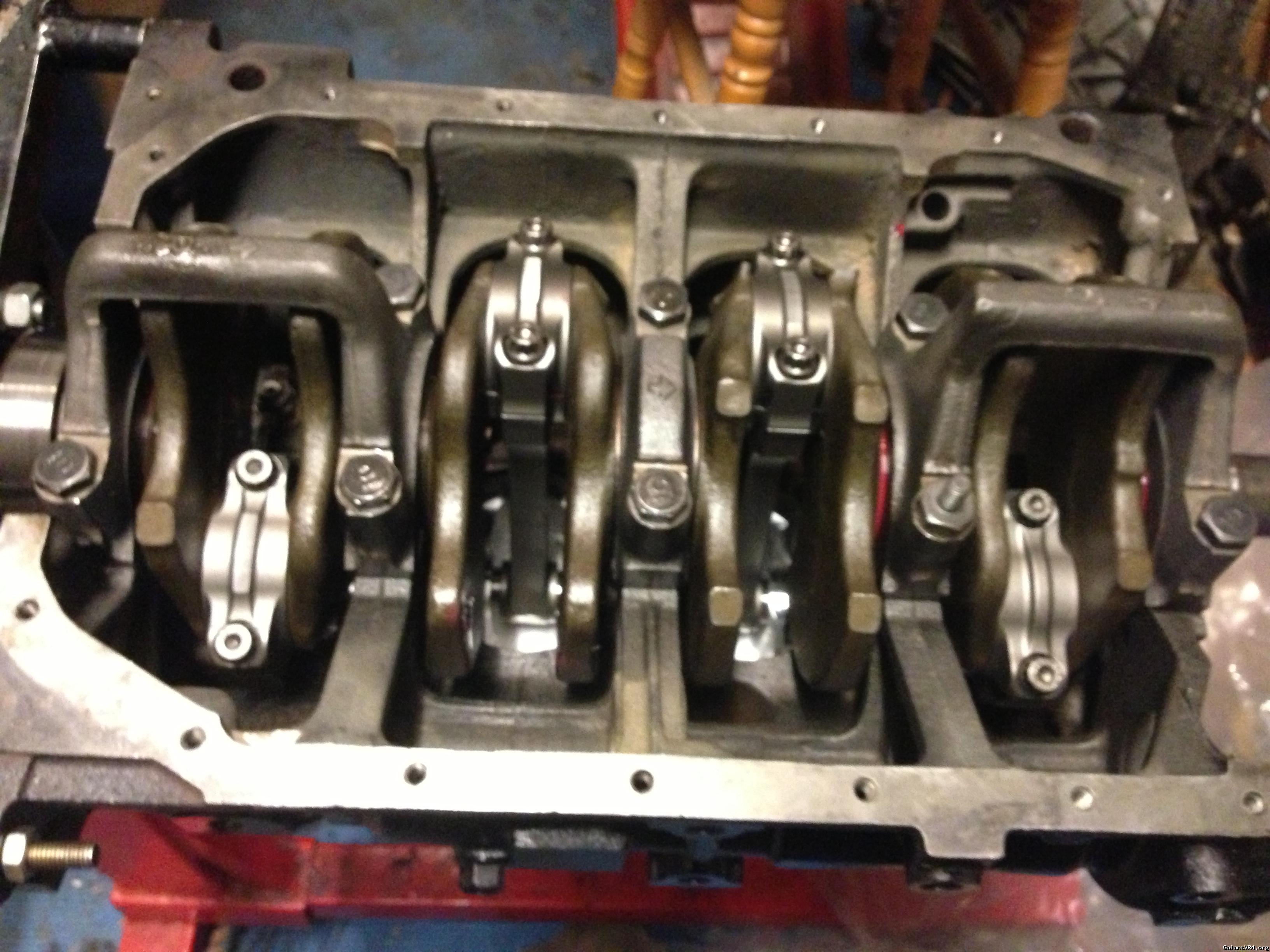

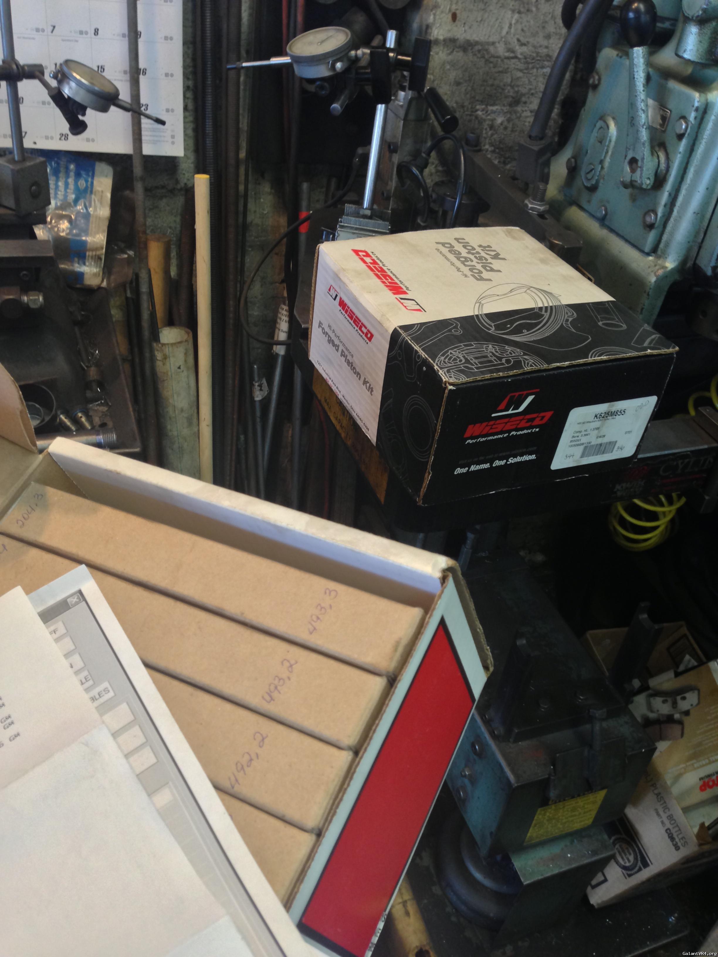

Machine shop
balancing the rods
Back from the dead
All shiny /ubbthreads/images/graemlins/ooo.gif

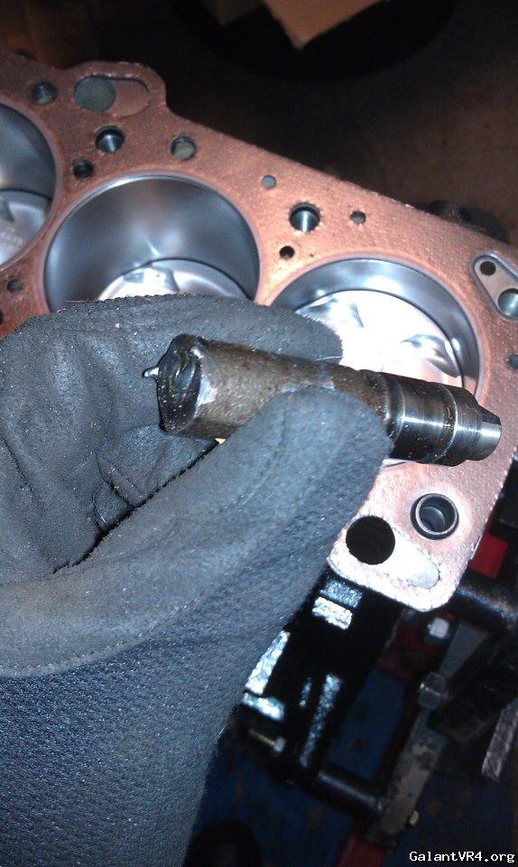

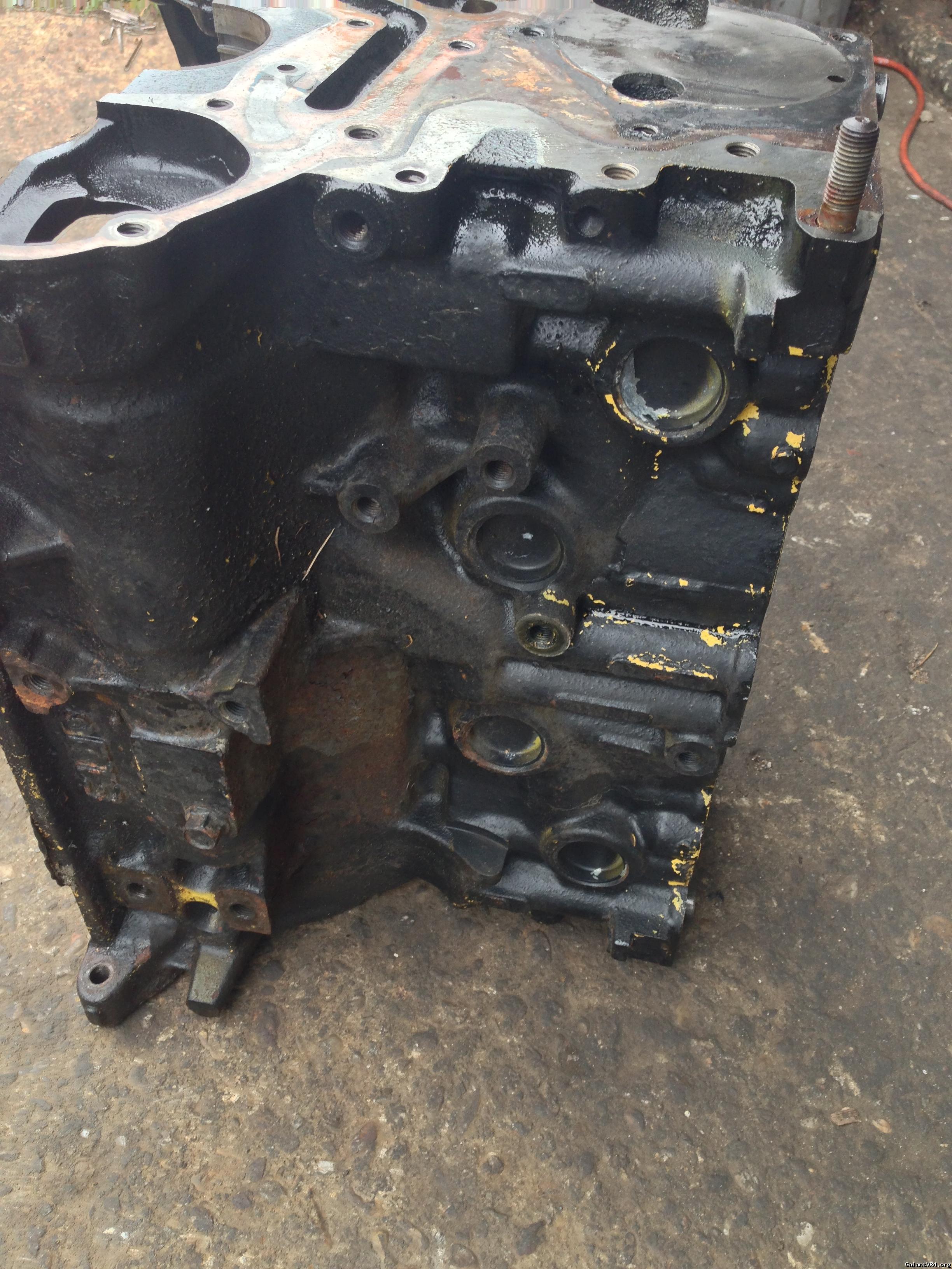

Previous owners idea of a balance shaft delete... /ubbthreads/images/graemlins/idea.gif /ubbthreads/images/graemlins/dunno.gif

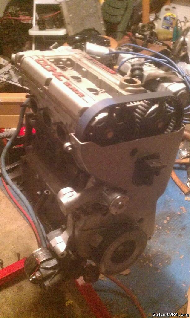

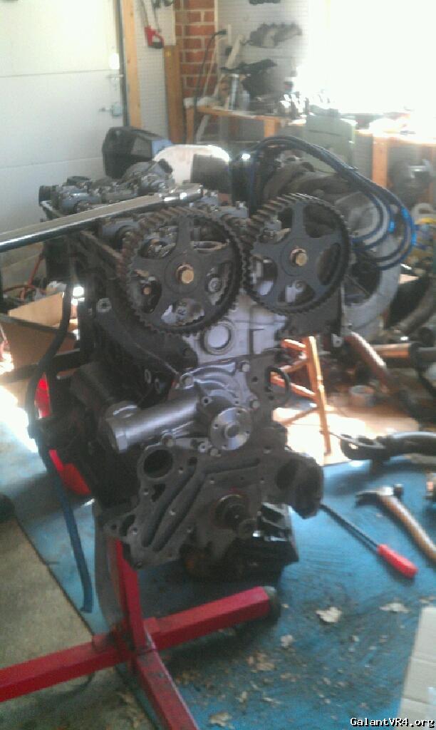

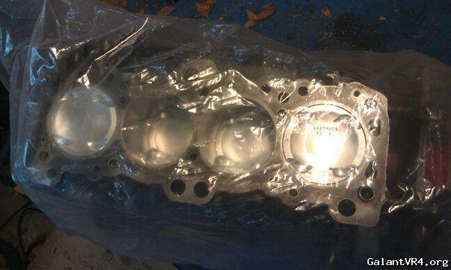

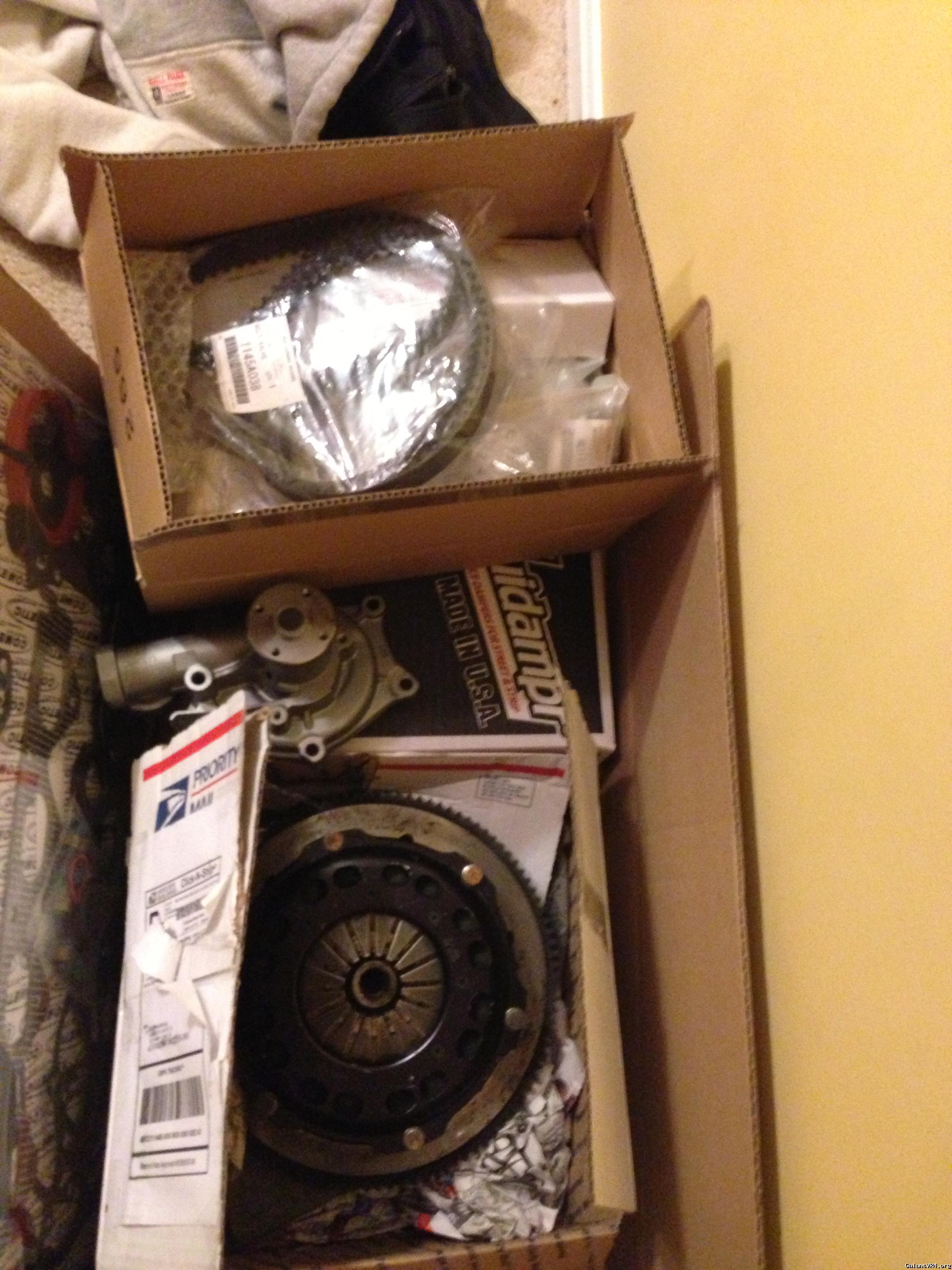

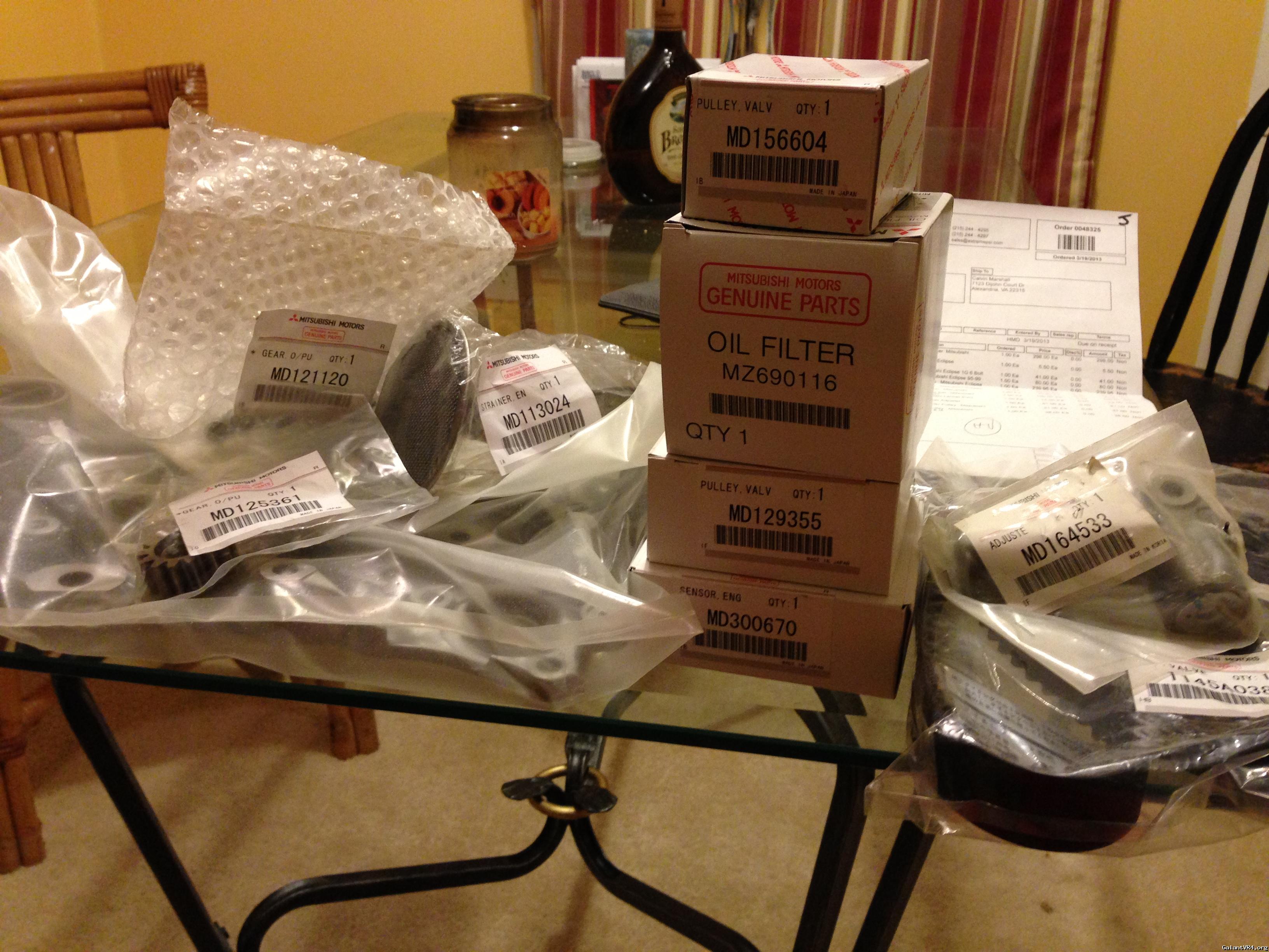

Every thing brand new OEM from Mitsubishi. Oil pump water pump, Oil pump gears, A real stubby shaft. All timing components blah blah blah 2g knock sensor. Oil strainer yahh
PTT twin disk for 9 grand shifting on yo bittch asss

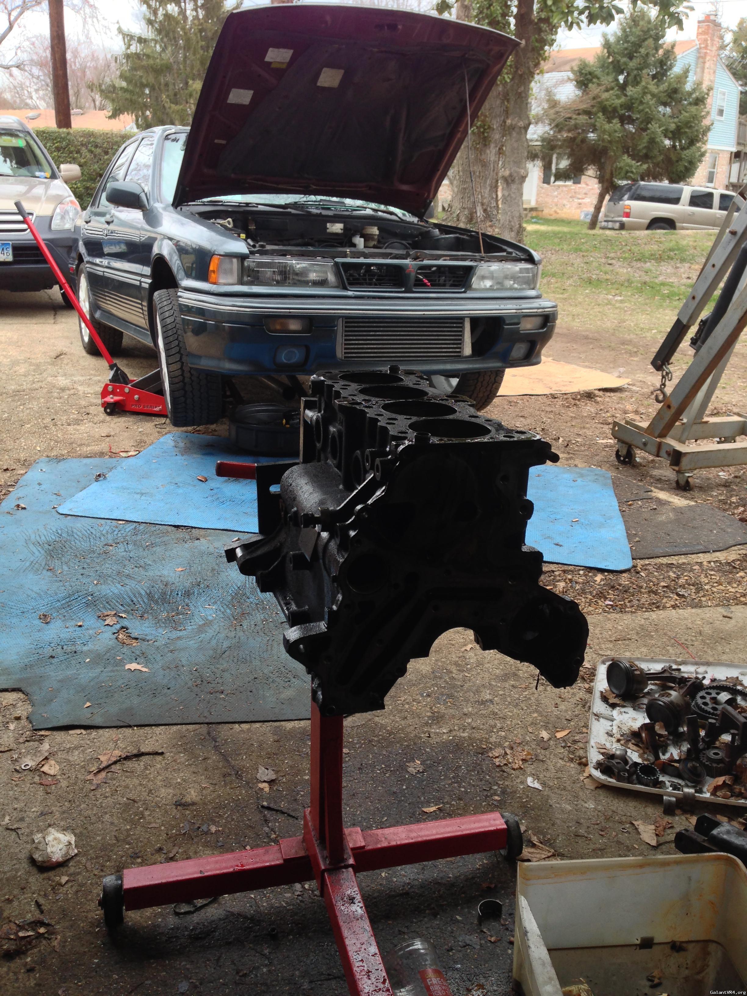

Reassembly time...

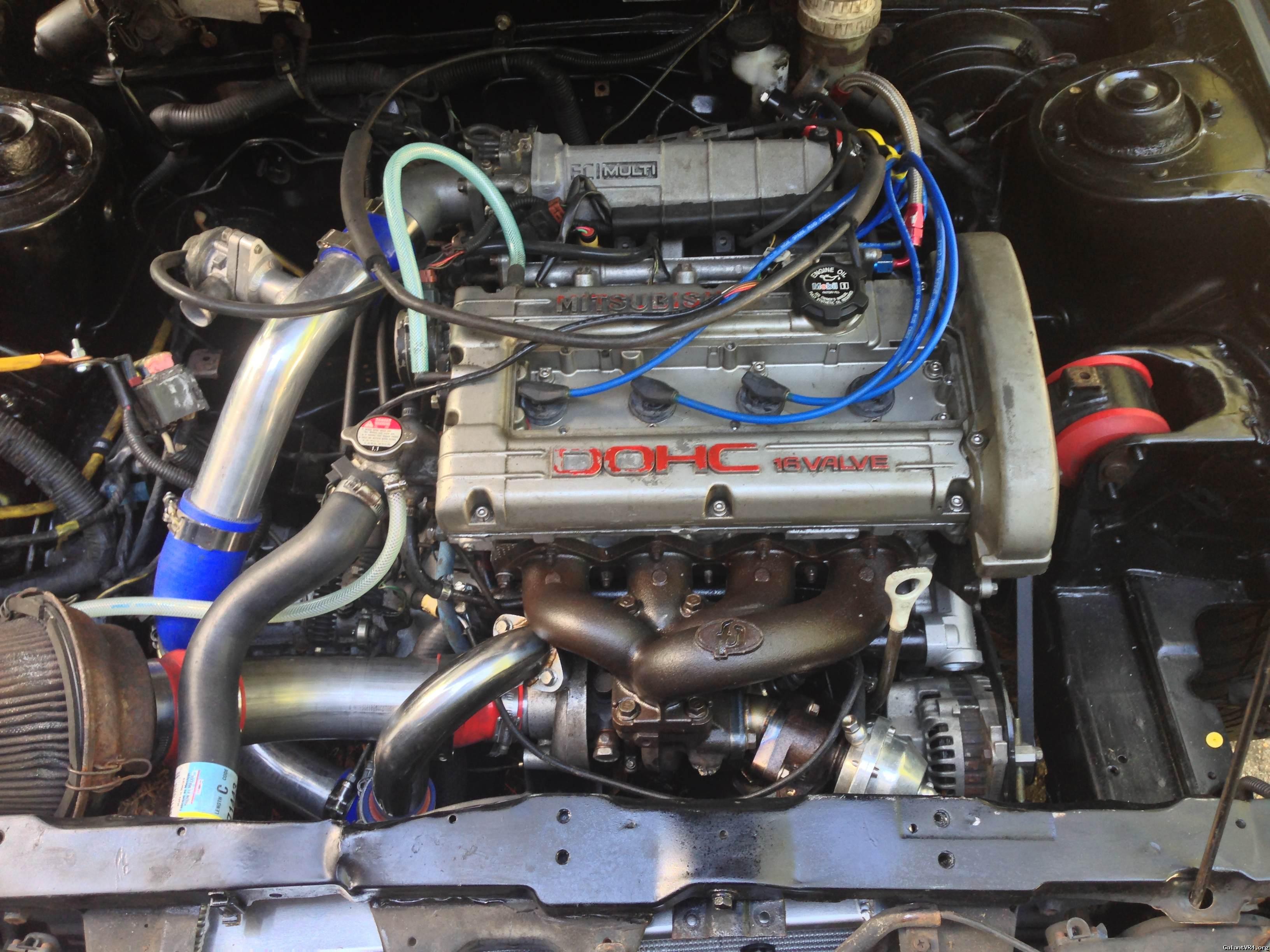

Current status as of 4/7/13

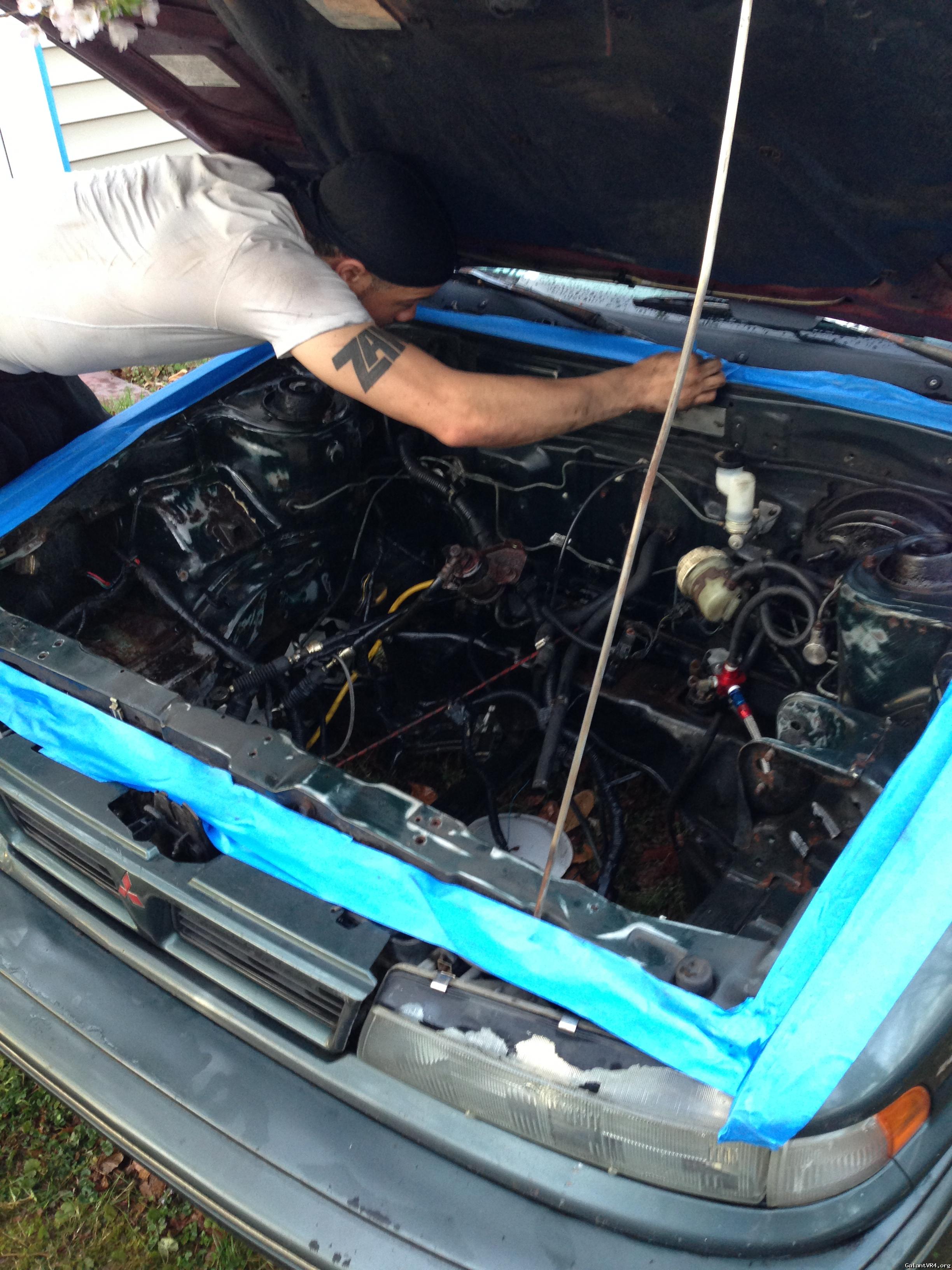

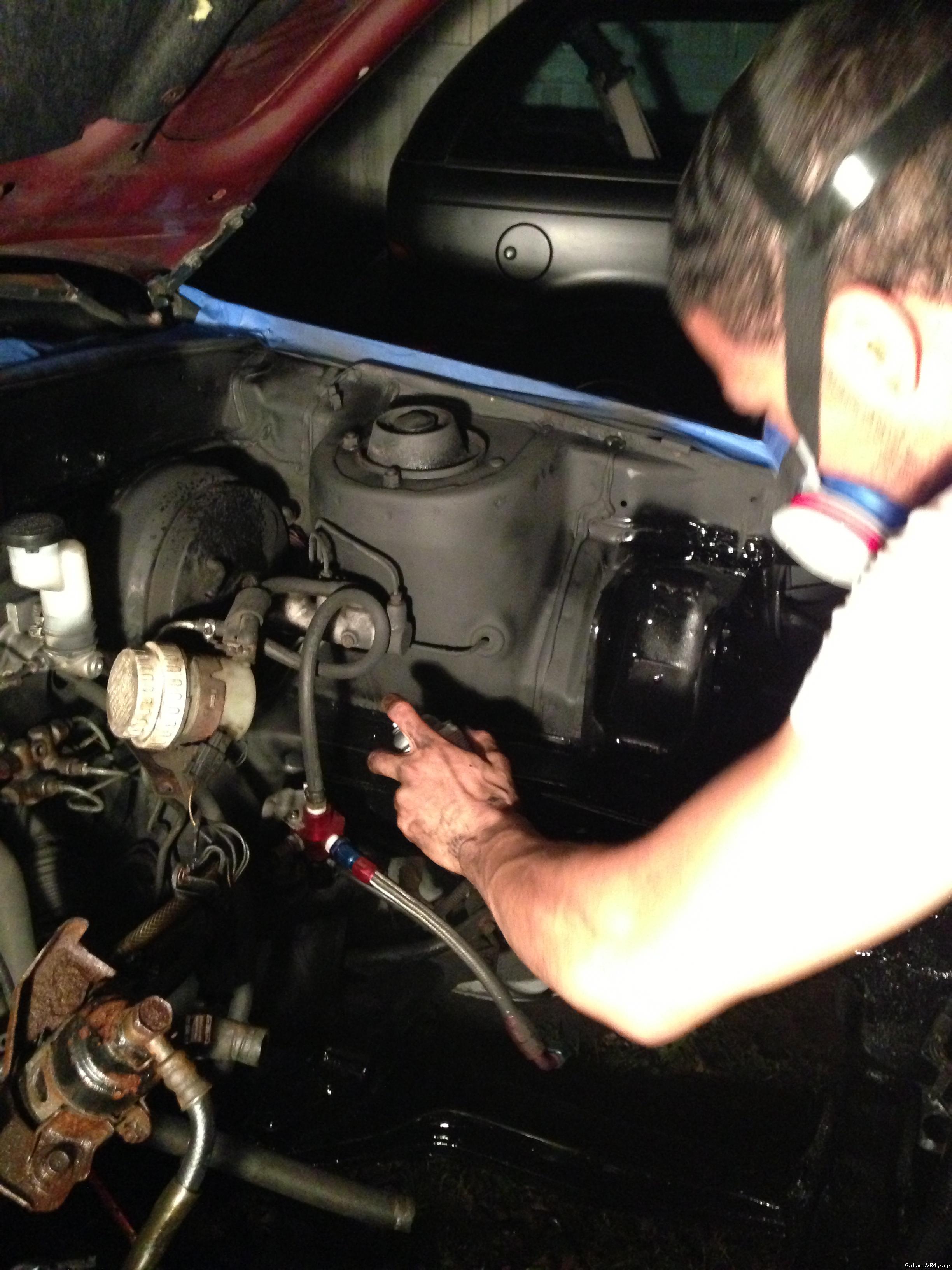

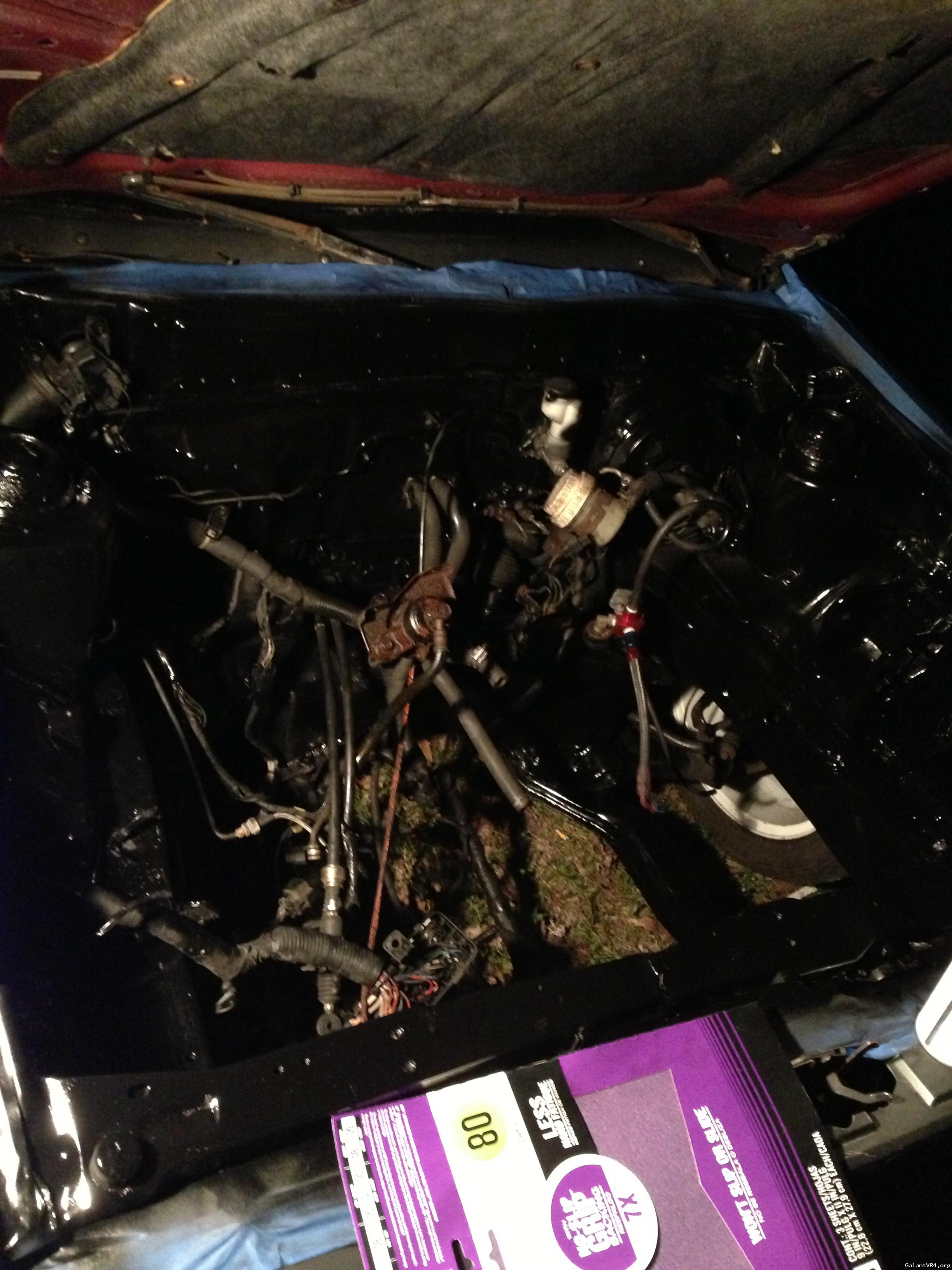

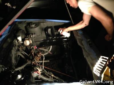

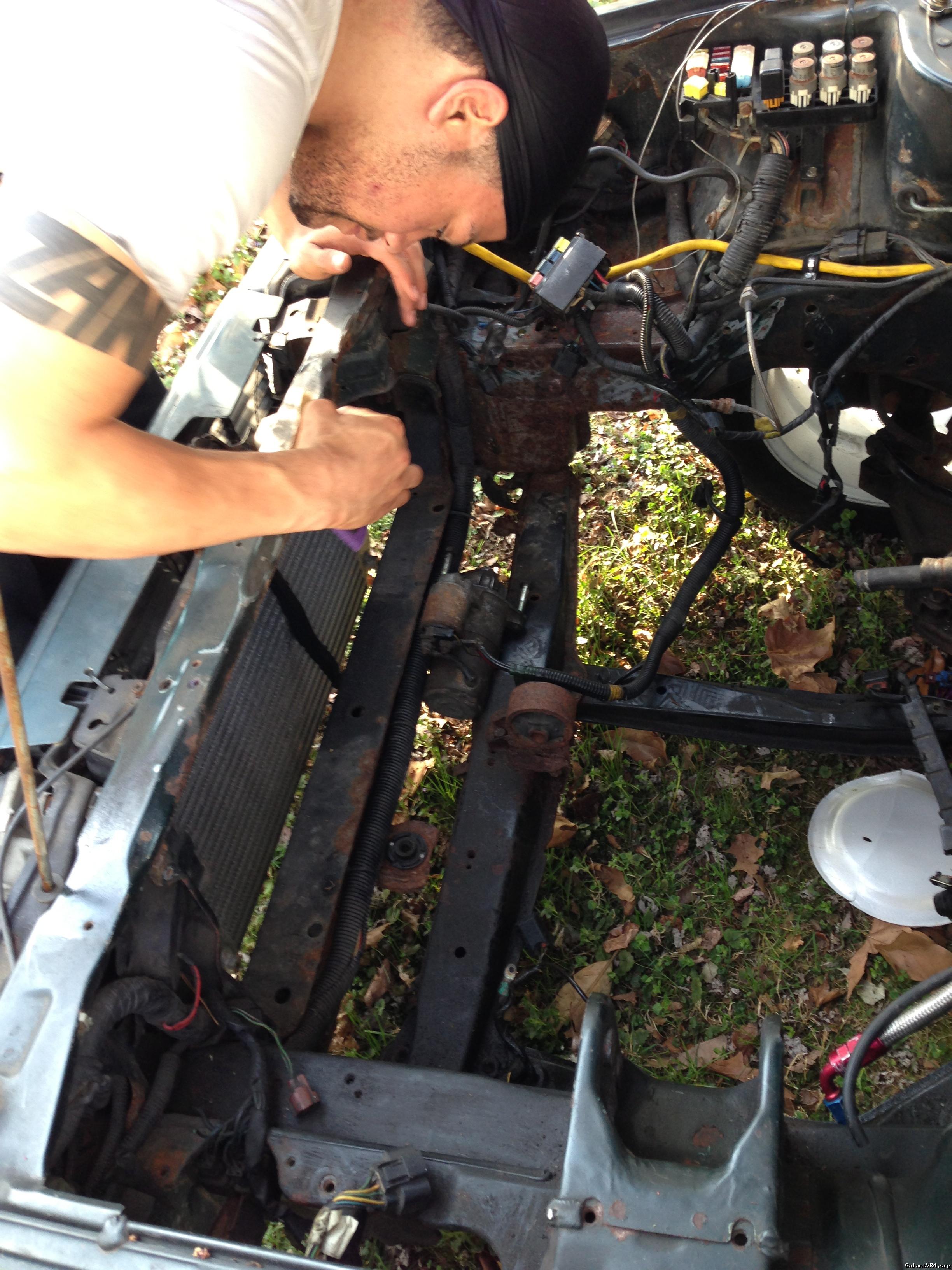

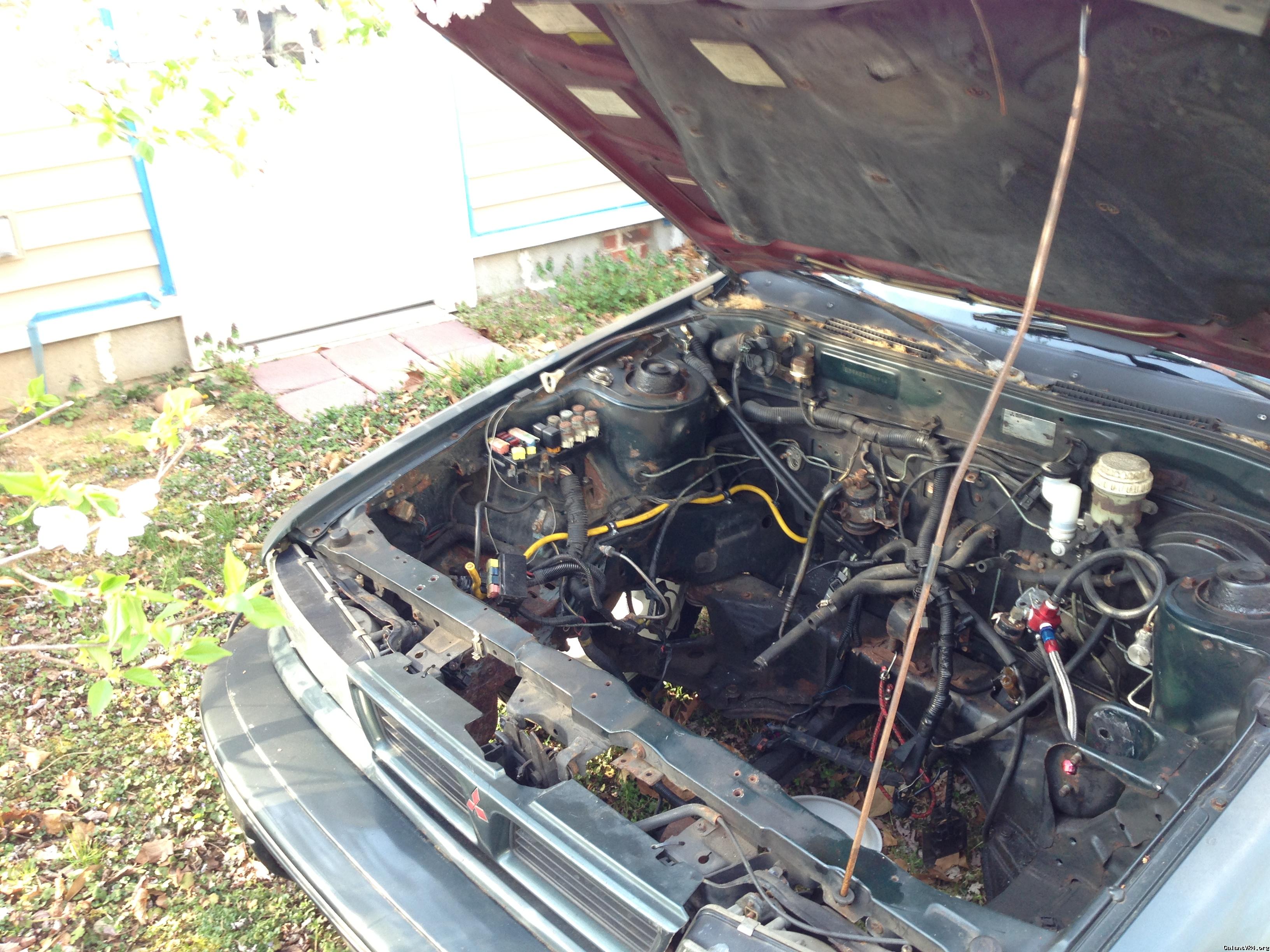

So i decided to go ahead and paint the engine bay while its out of the car. And my bay is rusty as fuckkkkk
Some Colt action a Black Evo 8 and a Mirage in the back
My buddy Avery helping me sand and sh*t
[/url]
Started getting dark out side so we hit it with one coat of gloss black paint for the night

Everything looks great! Oh and by the way a 2g knock sensor will not work with the 1g ecm. It will show way different values.

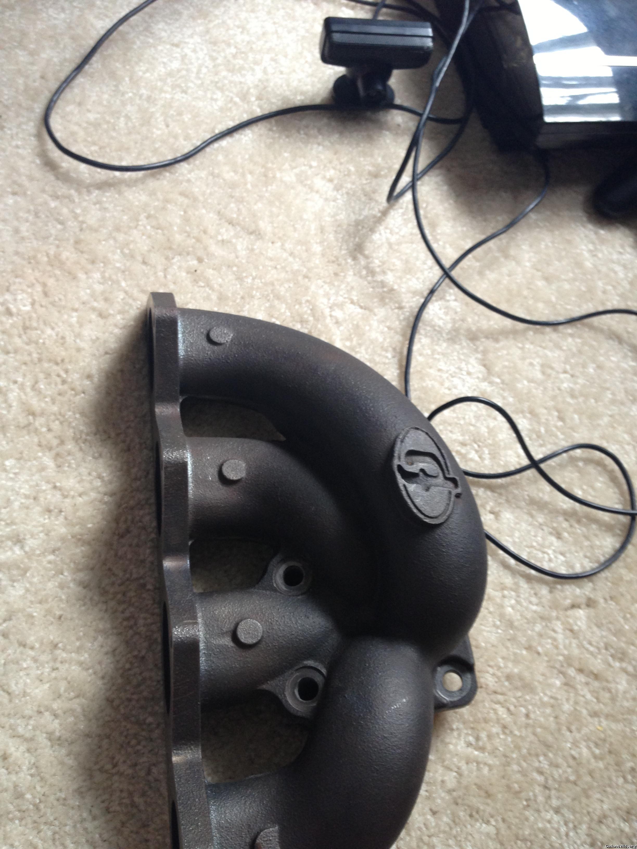

Got the car running! Just ran into a few snags tho. /ubbthreads/images/graemlins/bawling.gif The radiator was leaking but i didn't care i just wanted to see if it would start and it did. And there was a lot of smoke coming out the tail pipe. It was from the turbo it has a blown seal. Probably wasn't used to all that pressure from my new oil pump and gears. So i Bought a AFCO radiator and a MHI Evo 3 16g. I didn't want to buy a turbo just yet because i wanted to save some cash and buy a 6262 down the line but after i buy a trans. Then the clutch would not go into gear, so i was pretty bummed and i pretty much wanted to drop a grenade in my engine bay and torch it. But i didnt...i bought a new clutch master cylinder and that didn't fix it. /ubbthreads/images/graemlins/banghead.gif WTF!??! So i said screw it and bought a stock clutch and dropped the trans again and put that in. So tonight i will bleed the clutch and hopefully i can drive off. /ubbthreads/images/graemlins/uhh.gif My buddy is going to let me borrow his 14b in the meantime. But i definitely got big plans for the car and its come a long way. The turbo will be here tomorrow and I'm pretty excited. I'm going to hold off on big power for a while just because i want a built transmission and the costs involved with switching my whole exhaust setup. But i definitely feel my short block can take some abuse.
