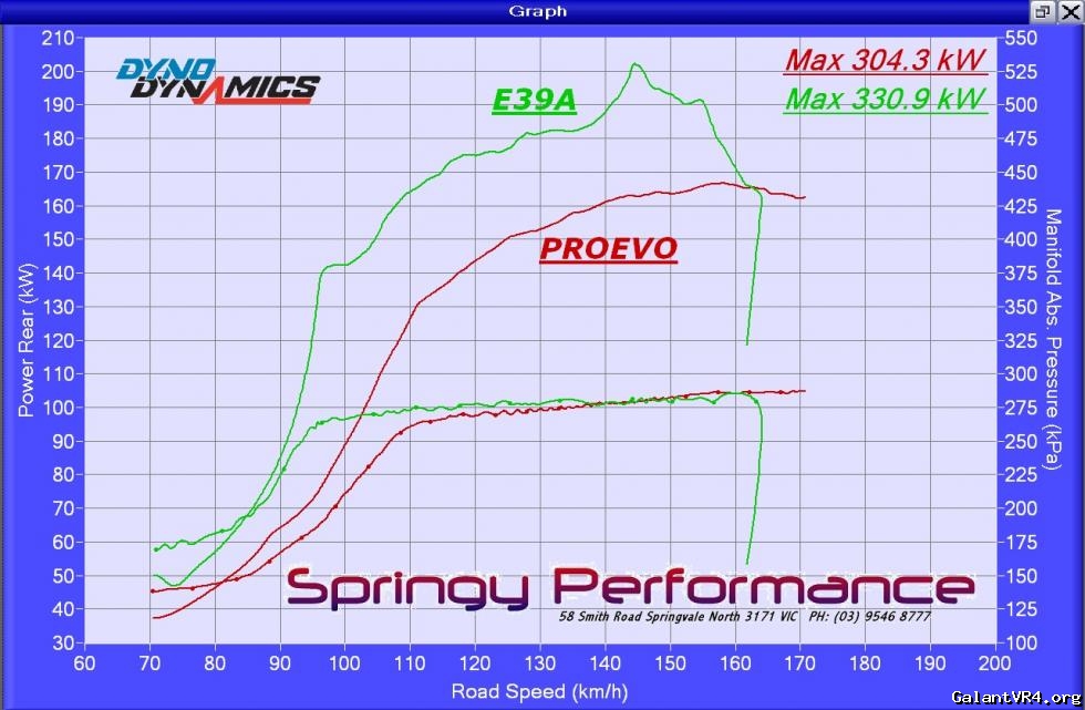

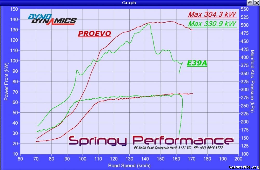

I'm not actually sure if it is 50/50
I have had my car on the dyno and here is the power difference between front to rear with a TRE spool.
E39A is my car making 330kw's at the wheels
Proevo has a viscous centre making about 310kw's at the wheels.
The dyno was set on locked 4wd..
I'm thinking that our cars when locked are more rear biased.... as the dyno displays
11,983
It is 50/50 with a welded diff and with the stock viscous coupling. If it weren't 50/50, with a welded diff, you wouldn't be able to drive the car on pavement as it would tear apart the drivetrain from the front/rear wheels spinning at different speeds.

bazeng
Feb 6, 2003
2,520
Melbourne, Australia
I'm running a TRE spool without a viscous coupling.
If you look at the dyno graph, it shows that the rear makes quite a bit more power than the front wheels.
I'm not sure why, I would have thought that if it were 50/50, I would have exactly the same power front to rear.
Anybody have access to a dyno who can dig up a old run with a locked centre, and set the graph to show front and rear power?
