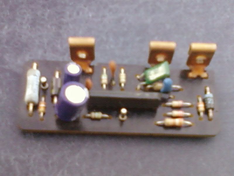

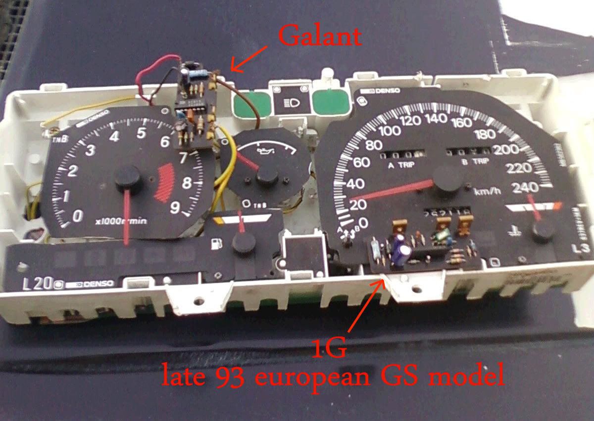

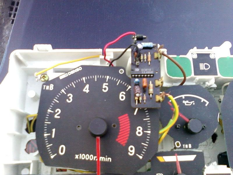

I got another problem. I cant make 1G tacho to work in my galant. I used 1G rpm unit with calculating thingie in it. But it just doesnt work. /ubbthreads/images/graemlins/banghead.gif Tryed every wiring combination but it still doesnt move. Any ideas between 1G and Galant RPM wiring?
P.s. Stock galant tacho works just fine.
Got a picture? You need more info than "thingie". What year DSM did these parts come off of? There is a compatability issue with our 1990 DSM's and the rest of the 1991-94 1G DSM's when it comes to the tach circuit.
Fever
Sep 8, 2007
9
Lithuania
There:
Hmmm...don't know. Never saw those boards before. /ubbthreads/images/graemlins/dunno.gif
