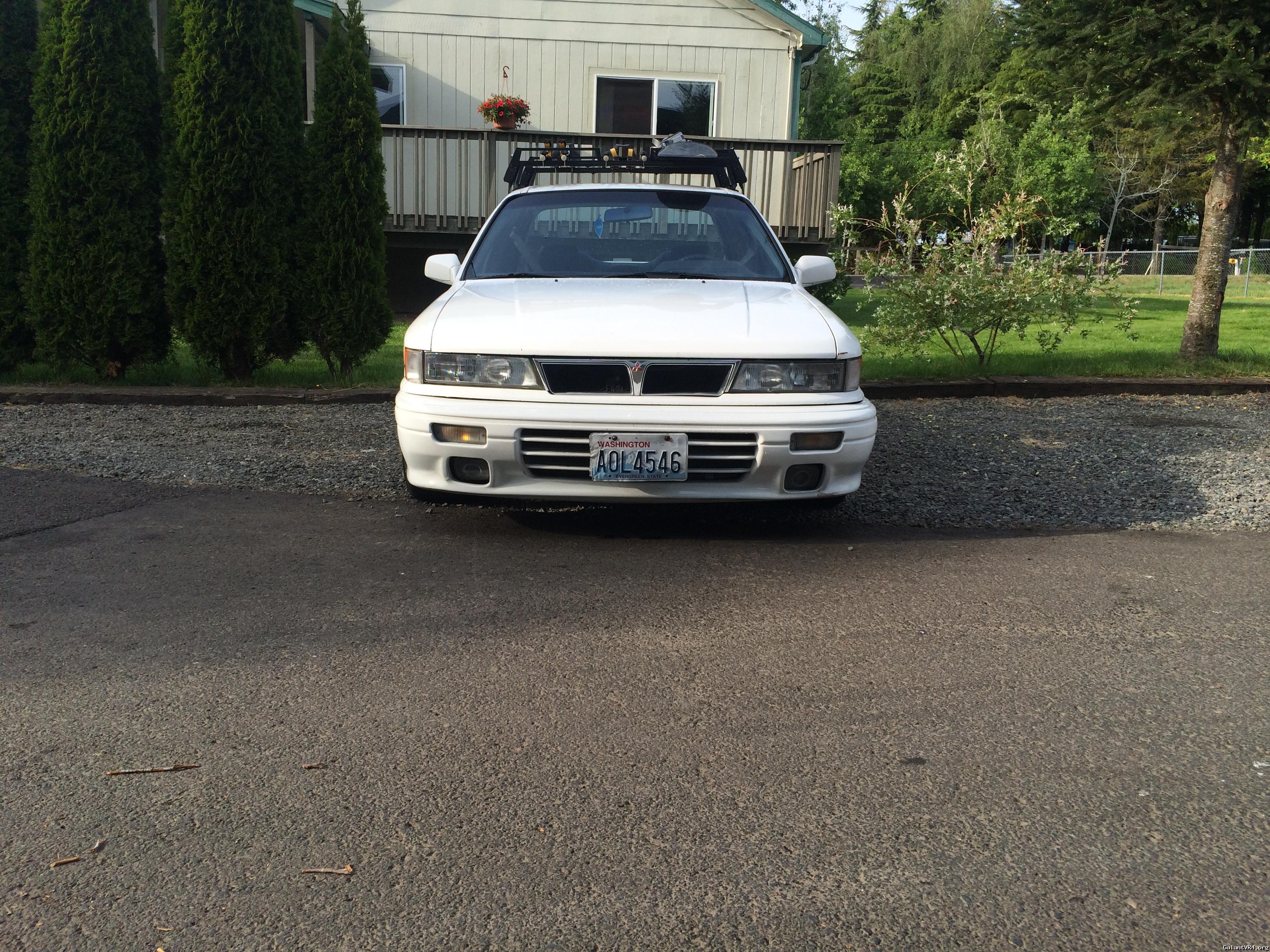

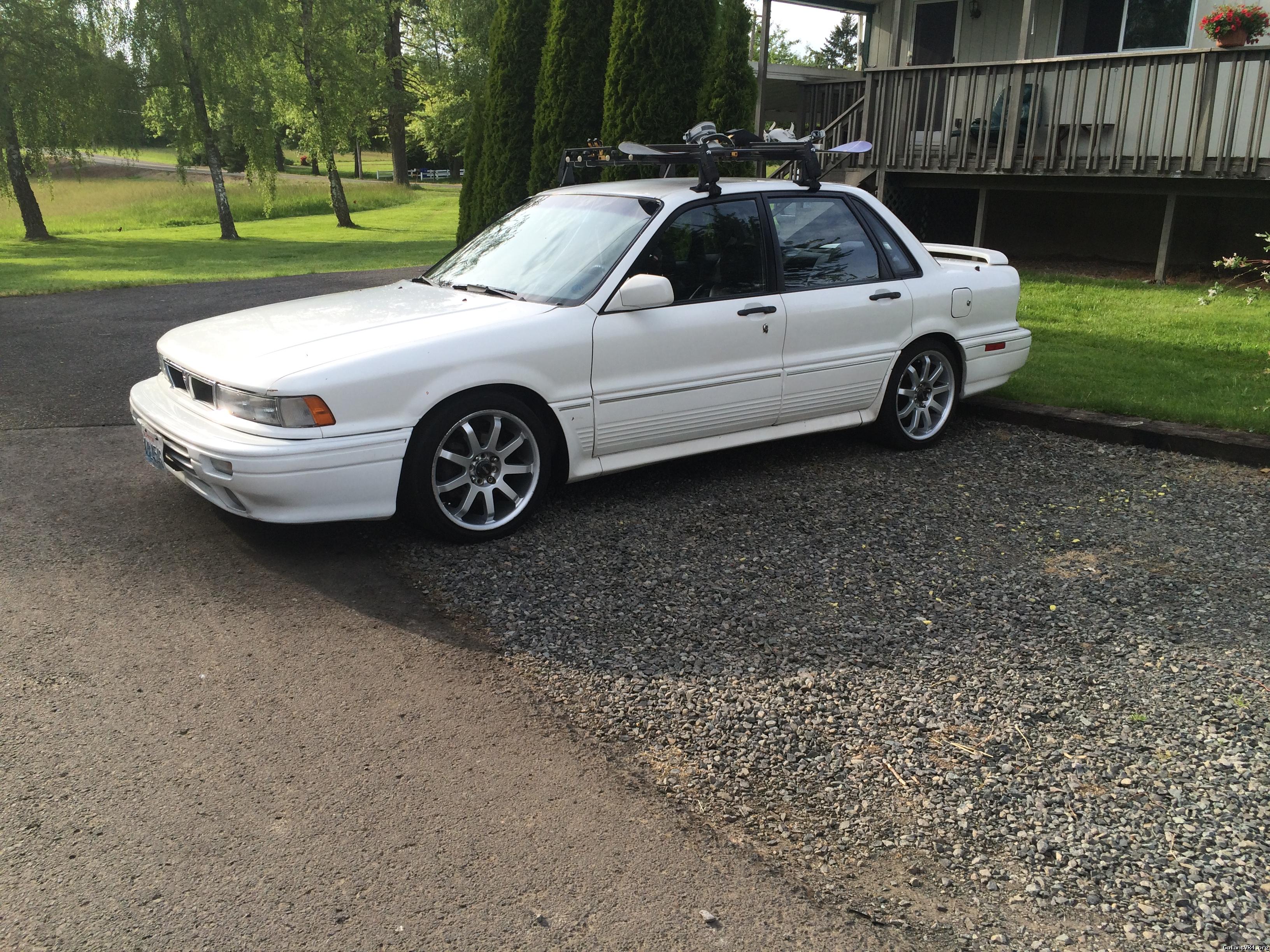

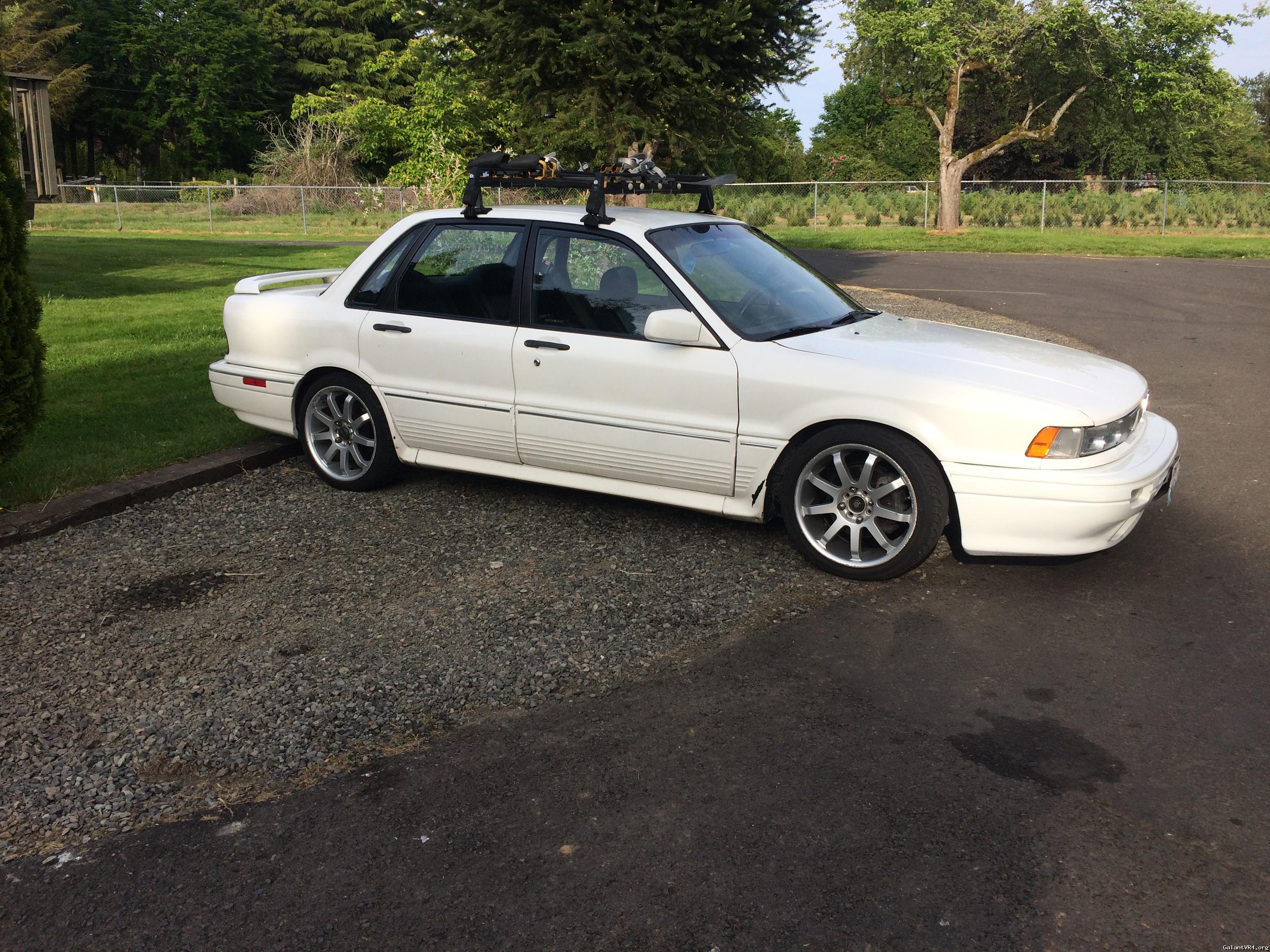

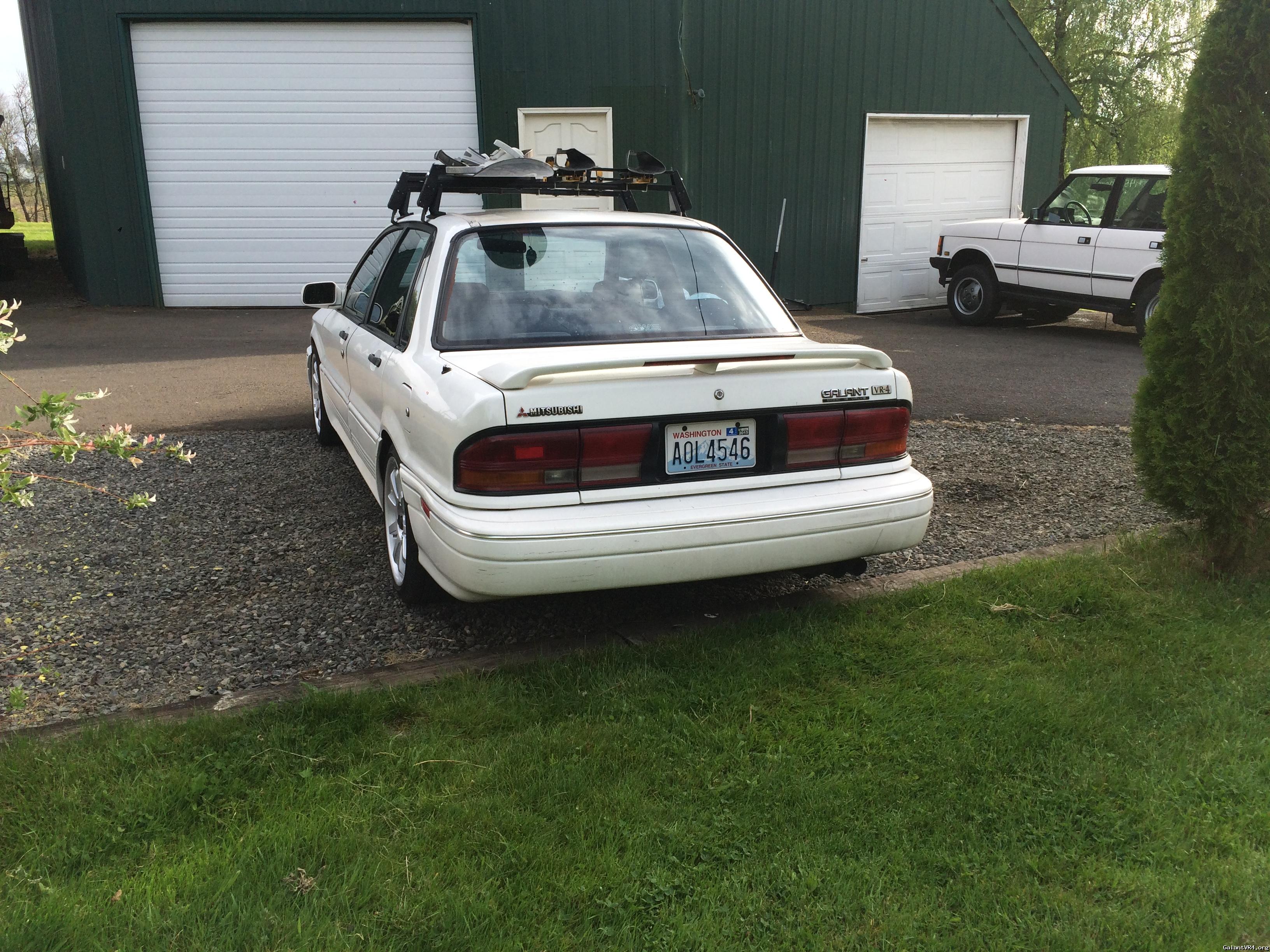

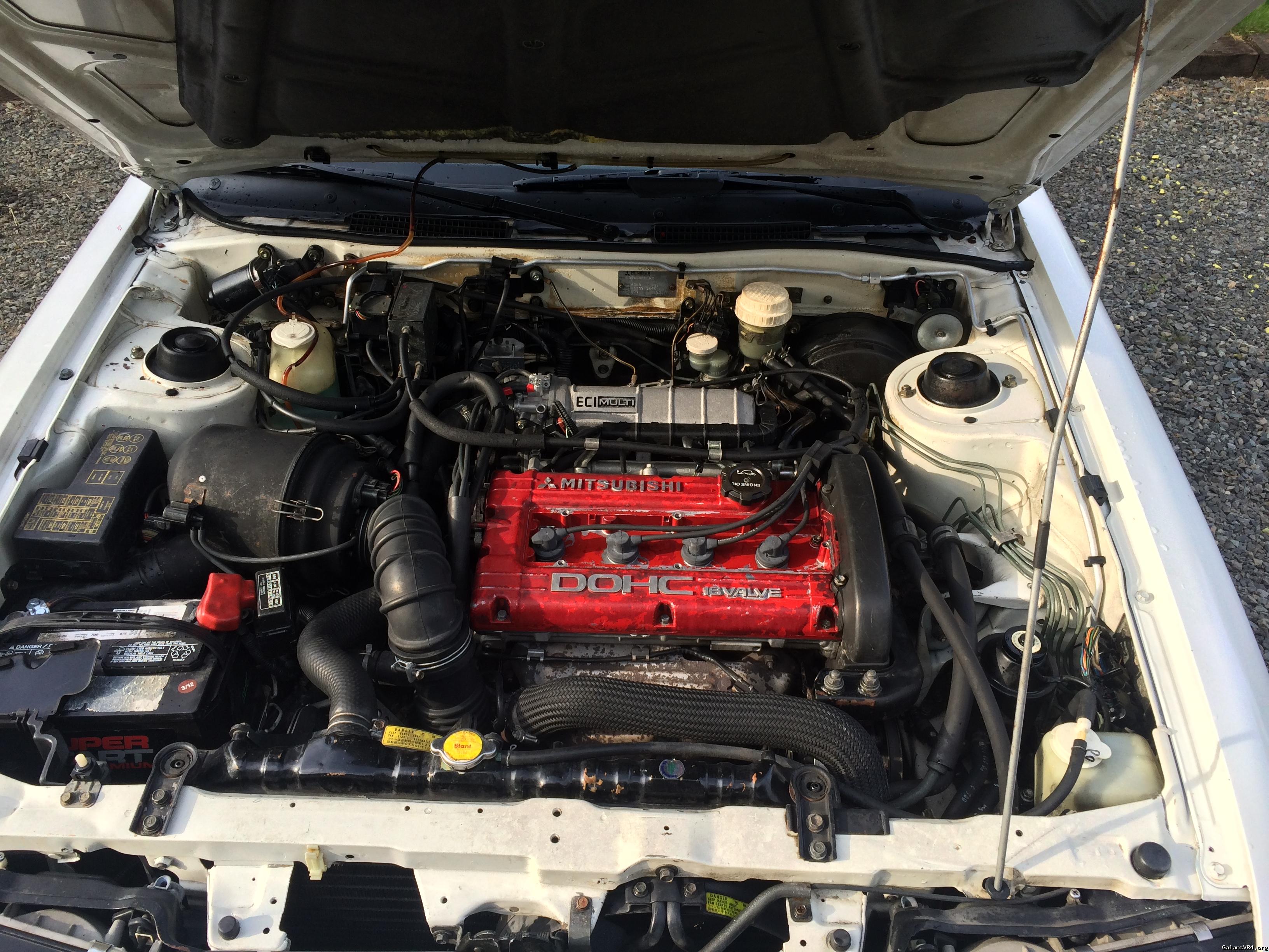

Well, as of yesterday i am the new owner of the 1137 1991 VR-4 Galant /ubbthreads/images/graemlins/grin.gif
I drove it almost 300 miles home, on what seemed like a little more than 3 cylinder but definitely not all 4. After some pressure washing and a soapy bath i decided to do a compression test. Only to find out that 3 cylinder have about 90psi and one cylinder is at 0...its safe to say i am after a healthy stocker to toss in until i can complete a full rebuild on this motor.
The car needs shocks, they are completely wasted, so i am in the process of researching to find out what i want to replace them with. I will also take a look at all the suspension and steering components.
My goal here is to get it driving properly, then clean up the body, and then a build for about 400awhp.

Before you chalk the motor up as trashed, do some diagnosis to try and isolate the cause of the low compression. A lot of things could cause shitty compression. You may get lucky and have crappy valves or a blown HG rather than worn rings. Just food for thought.

Leak down test confirmed bent valves in cylinder 2, which explains 0psi on the gauge, I haven't checked the other cylinders but the fact that they have 90 psi indicates the valves are not bent and the cause for low compression could be either rings, valves that aren't seating very well or headgasket. I will do a leak down on the other cylinders and record the results before yanking the head.
What is the general consensus for headgasket brands? Oem?
Cometic is out of be picture since I'm not willing to deck the block at the moment, but the head won't go back on without being resurfaced.

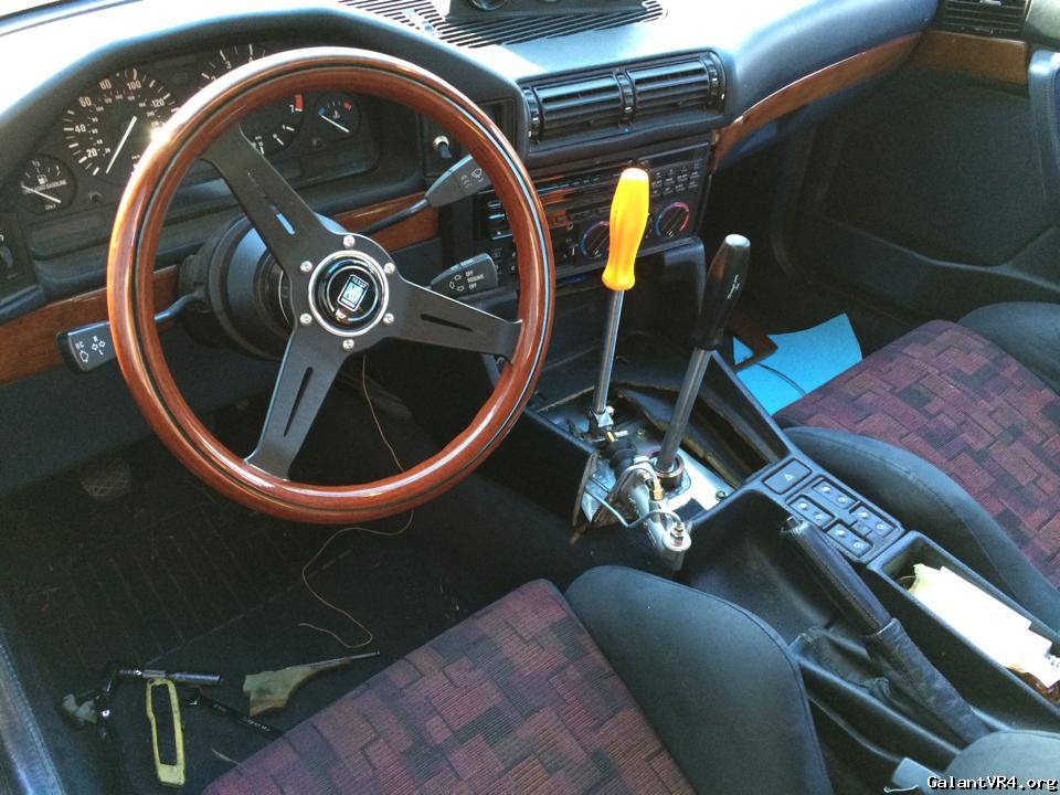

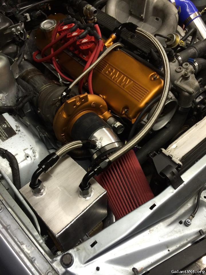

So the last car I built was a 1990 bmw 535i. It ended up with a holset he351cw, 750cc, vems standalone, etc...entire build and fab all done by me. Trap speeds indicate about 420whp.

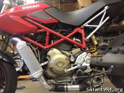

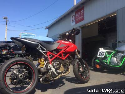

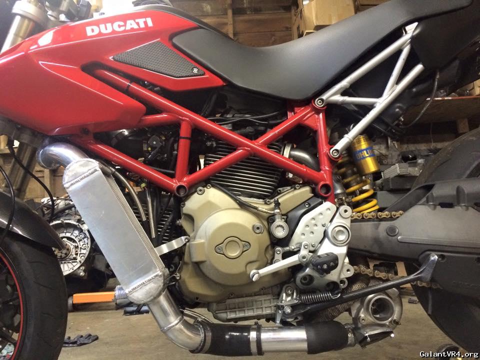

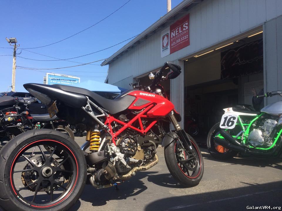

I recently just built a custom turbo setup for my 2008 ducati hypermotard 1100s, it uses a td04 15g and runs on microsquirt, it makes 115whp at 5.5psi...stock is about 75whp. I hope to make about 130whp on 8psi.

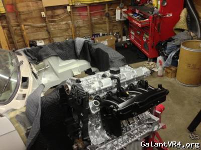

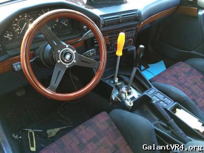

I have a long term bmw e30 project that is ongoing but wont receive any love until i move and build a shop where I can safely work on it. That car is getting a volvo 5 cylinder turbo 2.3l and a gt3582R and vems standalone. Heres a few pics for anyone interested. Just figured I would give you an idea of what I like to do. Ive done all sorts of other builds too, a couple 1jz s chassis swaps, some other bmw swaps etc...Looking forward to working with this VR-4!
