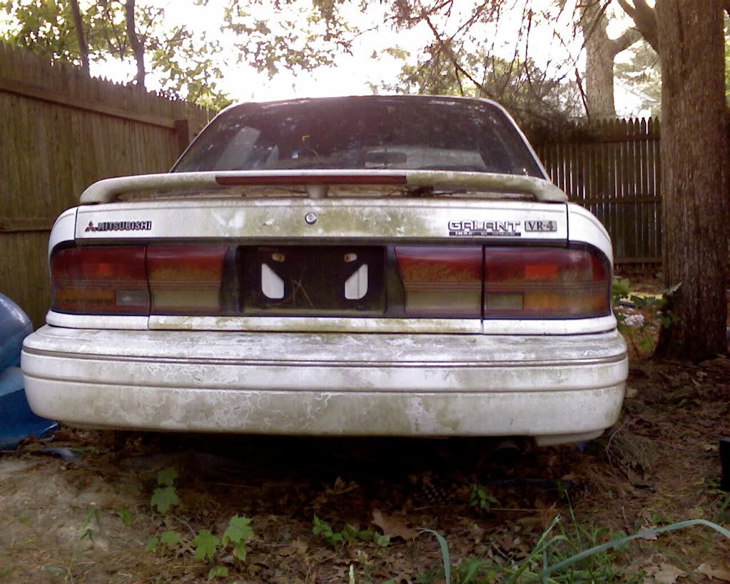

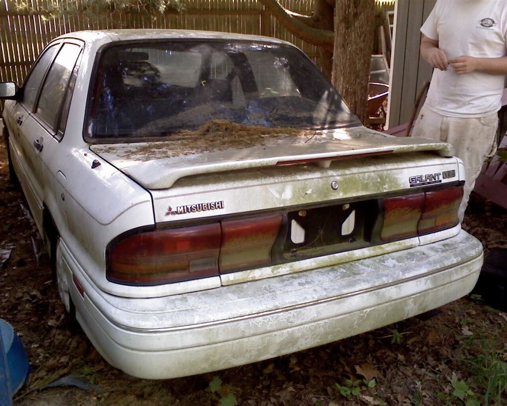

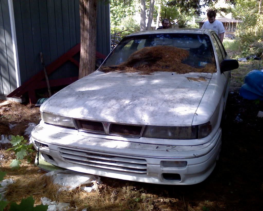

Hey guys just picked up number 1862. The story is, I know a friend who knows a friend whose house's backyard is directly inline with a backyard of another house where 1862 has been sitting for about ~18 months. Anyways I had a friend look at it, who doesn't know much about the galants or DSMs and it was too much work for him. Anyways I took a look at this one 2 weeks ago and I just knew I had to have it! so about 2 weeks later I have it!
here is some pictures of how the car sat in this guys backyard.

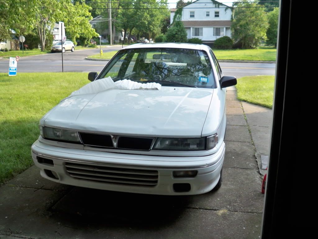

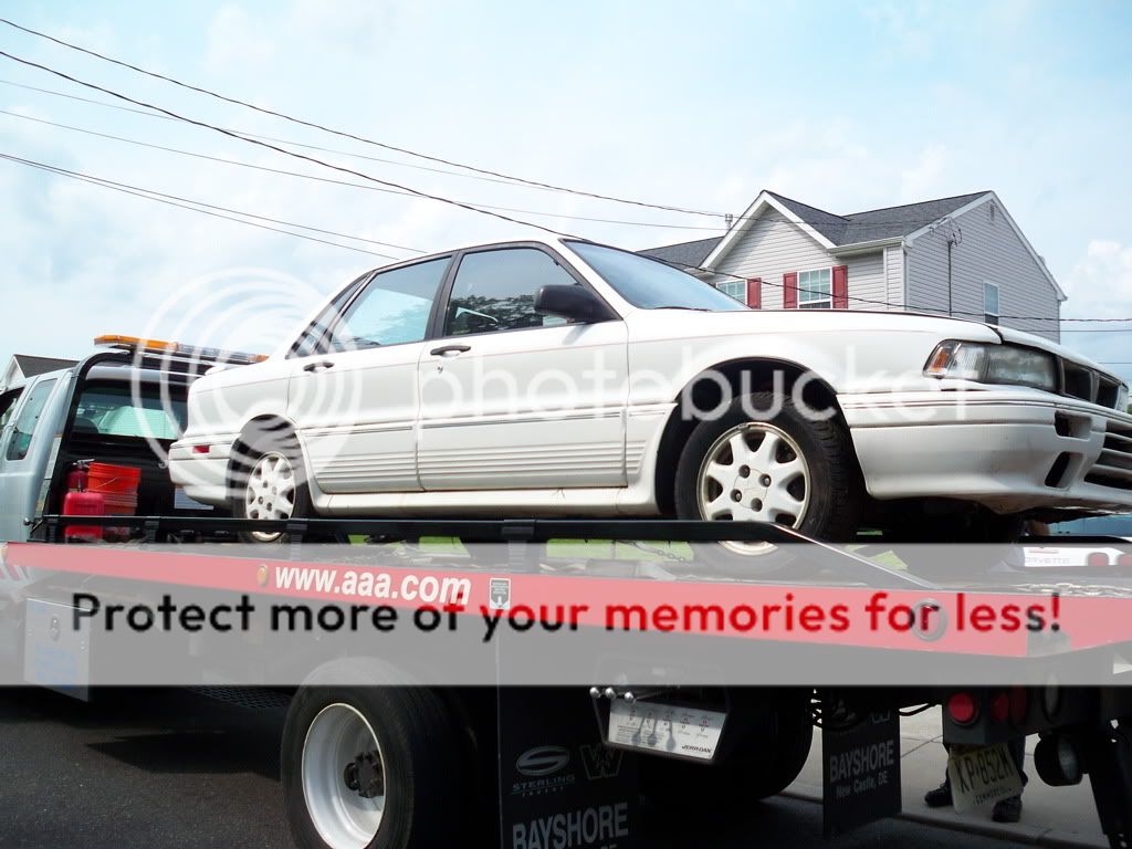

After I told him today that I'm going to pick the car up today he pulled the car out of the backyard and said he just rinsed the car off with a hose sponge, without using any soap or anything, here is how she looked when i picked her up today.

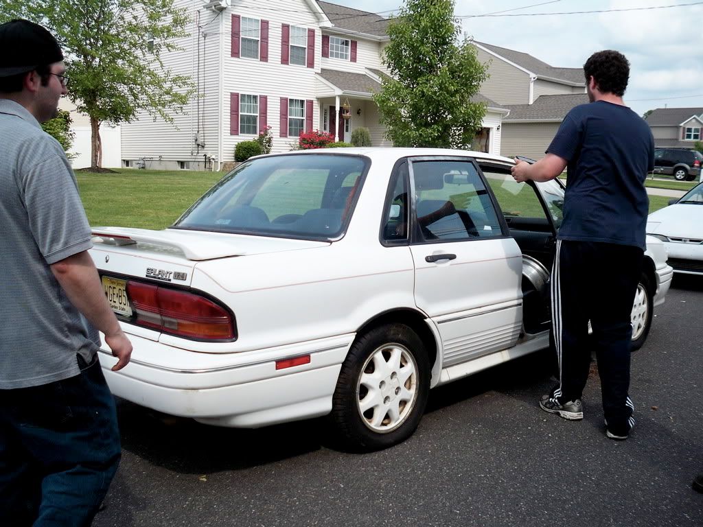

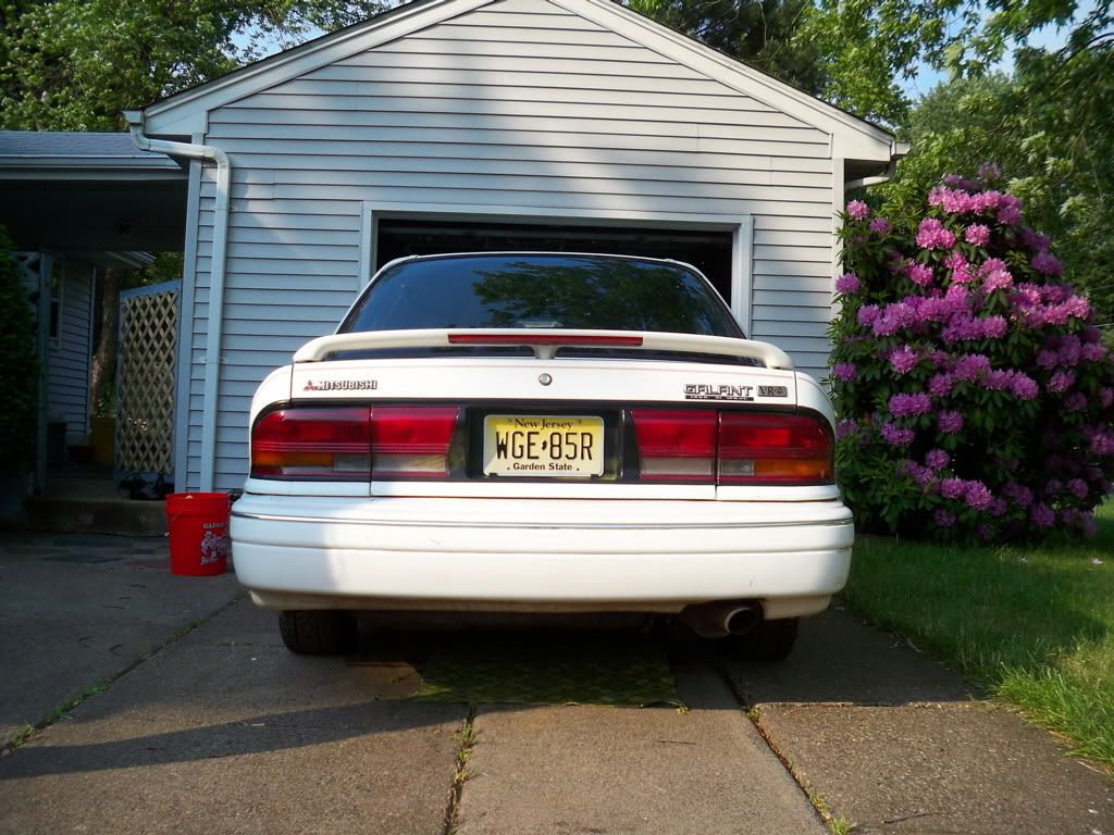

after we got her home
she cleans up pretty nice! but you can tell the clear coat is a little dull due to sitting and age of the car, Being that I don't have all my tools and my crane in this garage, I figured until I get a motor and get my tools to this garage, I might as well start trying to restore the clear coat, I purchased the mothers "clay bar" and started going to town on the body. It takes forever! took my bro and I 2-3 hours just to do the wing, rear quarter panel, part of the roof, and driverside rear door. unfortunately I dont have pictures, but the clear coat is starting to look really nice!!

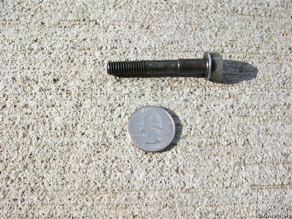

the tensioner bolts shouldn't need lock washers, but they are unique bolts. hopefully someone posts a picture of what they should look like for you.
11,982
I don't think those bolts being loose would cause a leak, but here is a picture of what they look like:
I use a little red loctite on mine for good measure.

Thanks for the pic, Mark! /ubbthreads/images/graemlins/smile.gif
The factory used shoulder bolts on the tensioner for a reason. The increased diameter on the shoulders help locate the tensioner, and reduce the tendency for the cyclic vibration to loosen the hardware.
For optimal performance, only shoulder bolts should be used in this application..
