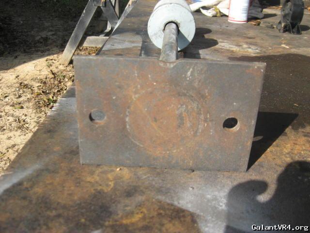

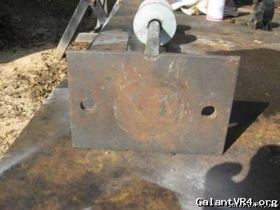

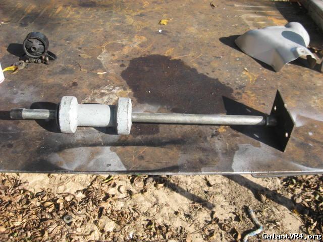

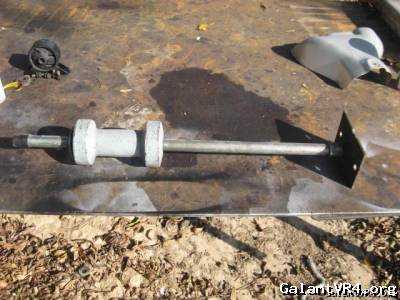

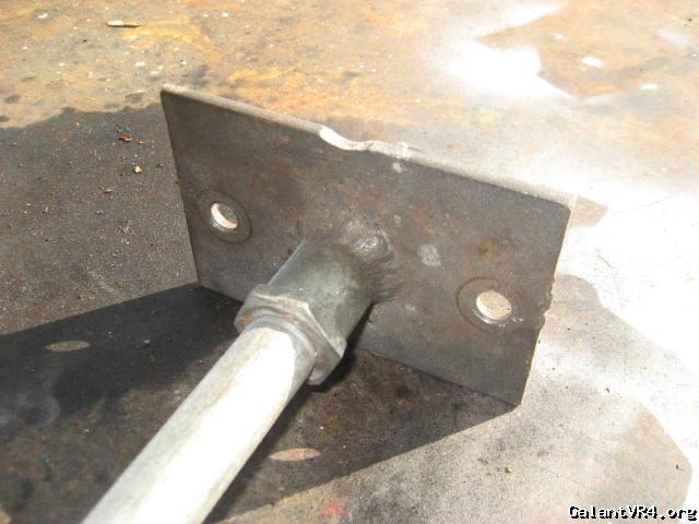

I rigged up a simple bracket for this. I just welded a piece of thick plate steel to a threaded nipple that screws onto my huge HF slide hammer. Bolt it up with two lug nuts and the hub will yank right off. You can use the axle nut to pull it back into place after you replace the stud. This way you don't have to bother pulling the knuckle and all that. Might be something to look into if you have a slide hammer and the means to fabricate a bracket.

I agree completely. If they're original tear it all down and replace whatever parts are worn. However if all that has been done and you just happened to break/strip a stud the slide hammer method is way easier.

Wow, thanks for the advice. That slide hammer is sweet!

Thanks for the props on the slide hammer adapter!
