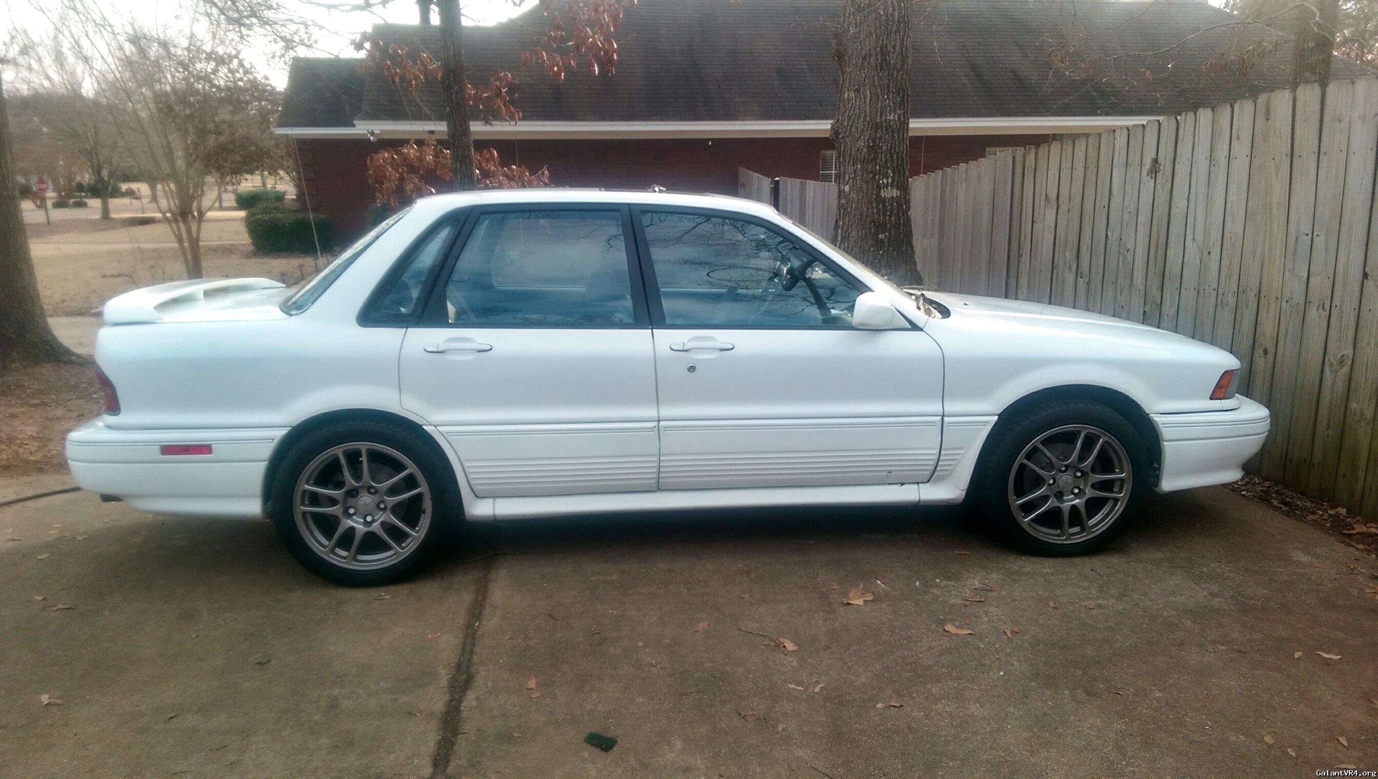

damnit, your car looks good. why cant i find someone to sell me some evo9 wheels?!?! thats all im waiting on at the moment for my 5lug swap.

I appreciate it guys!
The point was to do something with the evo wheels I already had while increasing traction and maintain the gvr4 by replacing the bearings....win win.
Guess I should tint the Windows now?
Evo steering wheel to be installed in ~2 weeks as well.
