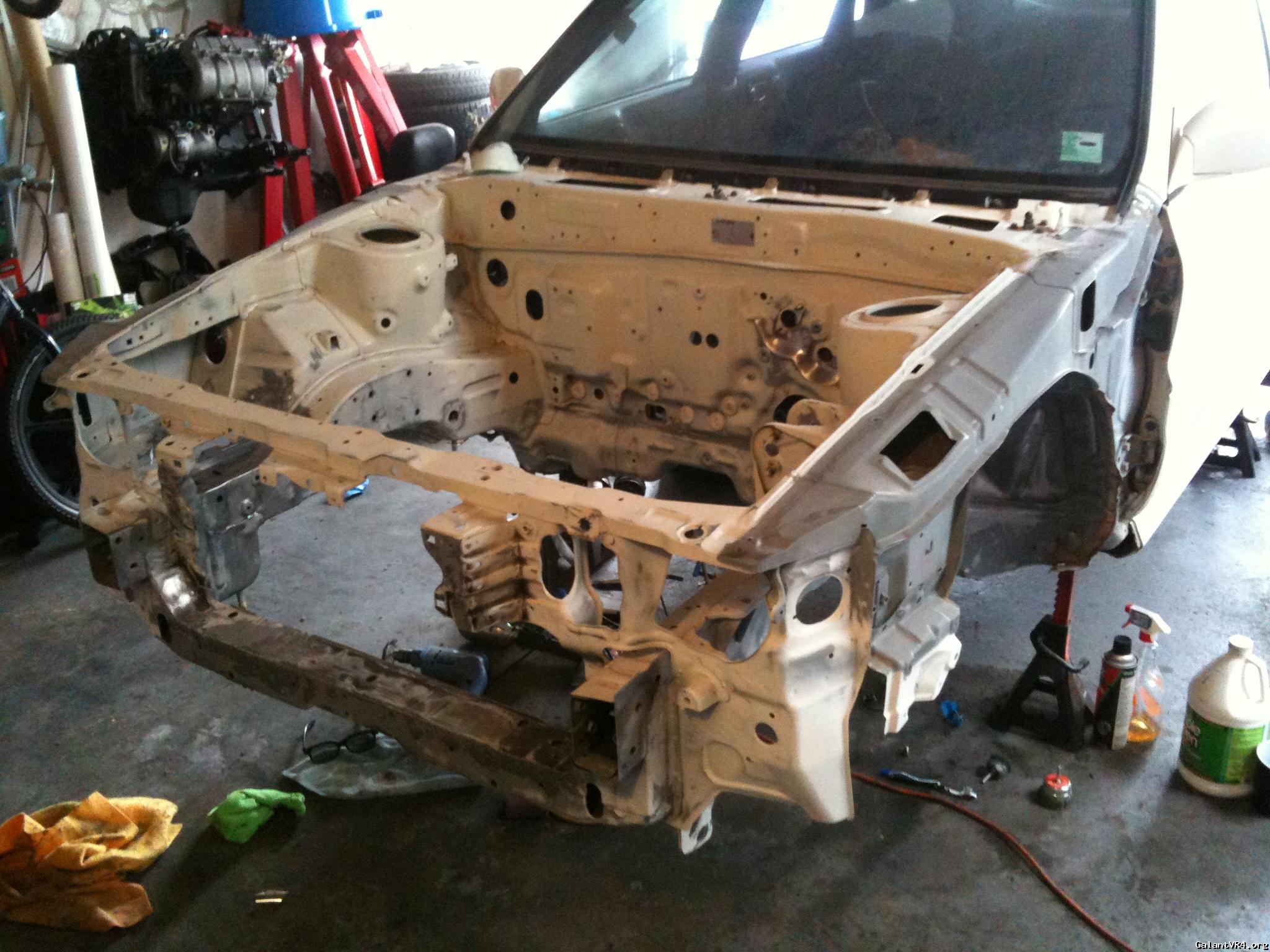

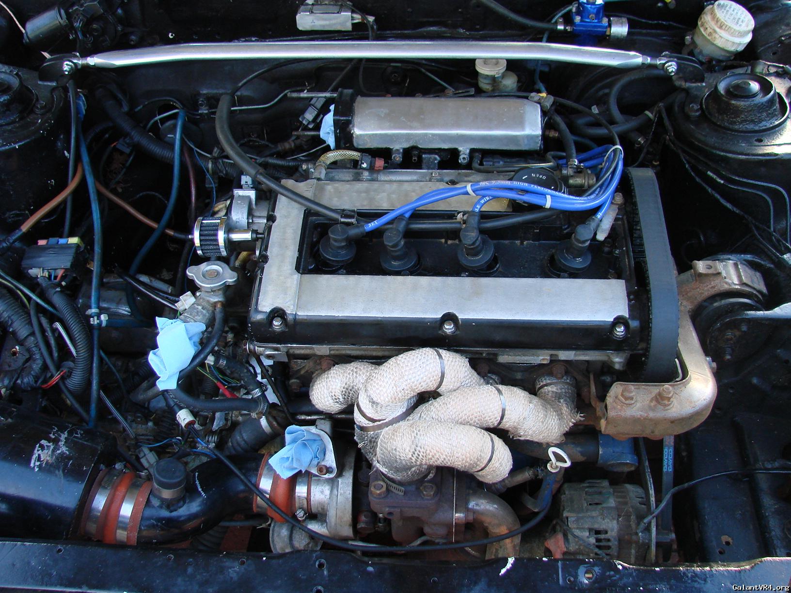

here's my summer's experiece:
IIRC that was just purple power and water and some brushing, no pressure washer. I later pressure washed and it got some more grime off of the subframe.
And then I sanded down and painted the bay, just all rattlecanned, but it helped out a lot:

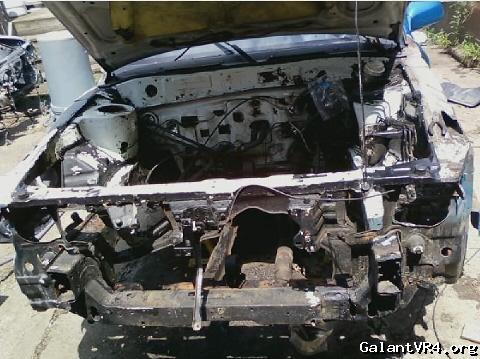

I actually used aircraft stripper and scraper at first to get it down to a cleanable level. That was because the previous owner had layed a thick layer of spray paint with no prep, so it never fully setup leaving a gummy paint finish /ubbthreads/images/graemlins/banghead.gif. Once I got most of that off, simple green with an angle grind that had the light brass wire on it cleaned everything else up really well (and reasonably quick). Once you get everything clean, go back and hit the rusty parts with a courser wire brush until you get it as clean as possible and then get it etch/sealed quickly so you don't have to worry about it later.
It took me the better part of 3 months to get mine fully cleaned, prepped, and painted (put in 20-30hrs a week on normally). It all pays off in the end if you take your time to do it right
Before (you can't tell but you can literally dig a fingernail into all the black paint like it was taffy)
At about half way through black paint removal
And after it was finally painted

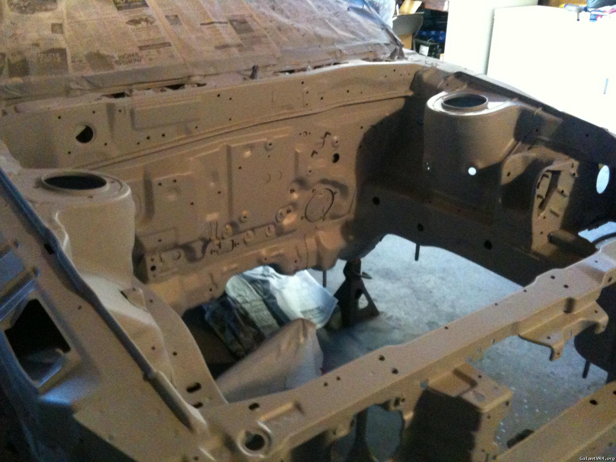

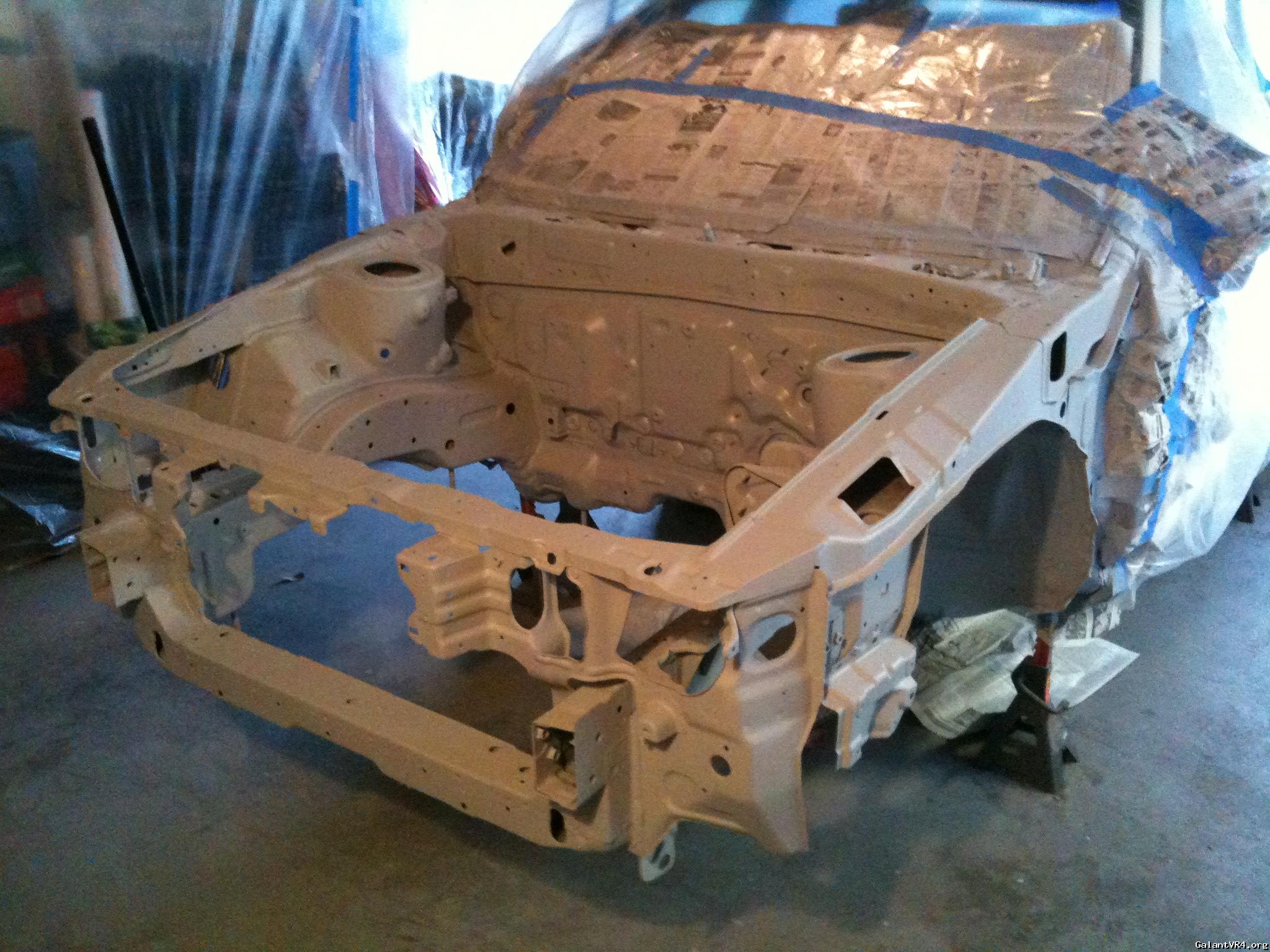

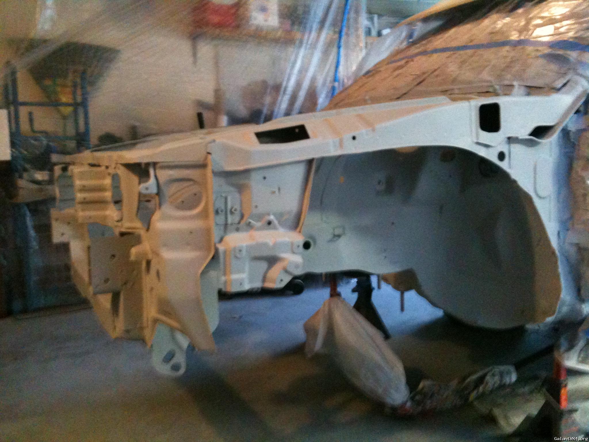

Well, I figured i'd update this - taking a break from wet sanding at the moment.
I finally got everything cleaned, and what a horrible job that was.
Sprayed primer this past Sunday...
Now i'm in the middle of wet sanding the primer since it didn't lay down perfectly smooth - kind of rough texture in some areas. I blame my technique, or lack thereof with the paint gun being i've never done this before. /ubbthreads/images/graemlins/tongue.gif ...and I thought the initial cleaning sucked. /ubbthreads/images/graemlins/banghead.gif ha!
Back to work!

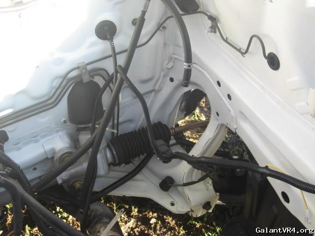

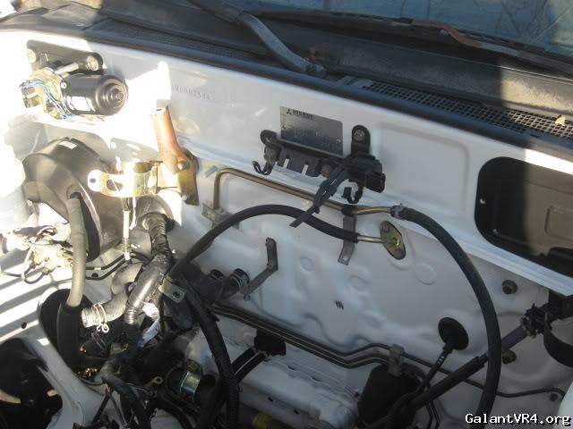

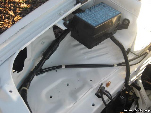

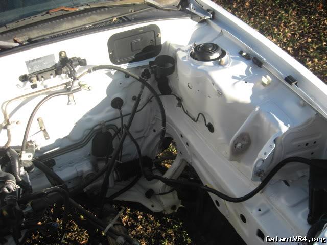

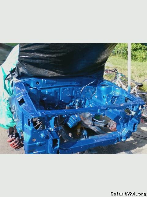

I just did this. I didn't remove everything from the engine bay opting to cover it with aluminum foil or bags. The wiring harness from the drivers side can be shoved out of the engine bay through the hole vacated by removal of the ABS pump. I taped off the front quarters and covered the rest of the car with plastic tarp.
This was the entirety of the drivers side harness. The other harness I simply bagged up tightly in a garbage bag and moved it where I wanted it.
Like this.
I did not paint match the color to the car perfectly because I honestly didn't care. I would have done it in black possibly but the color I found was fairly close to original. It looks very blue in the pictures but it is hunter green in person. I hit it with 4-5 coats of matte finish clear coat. I love it.

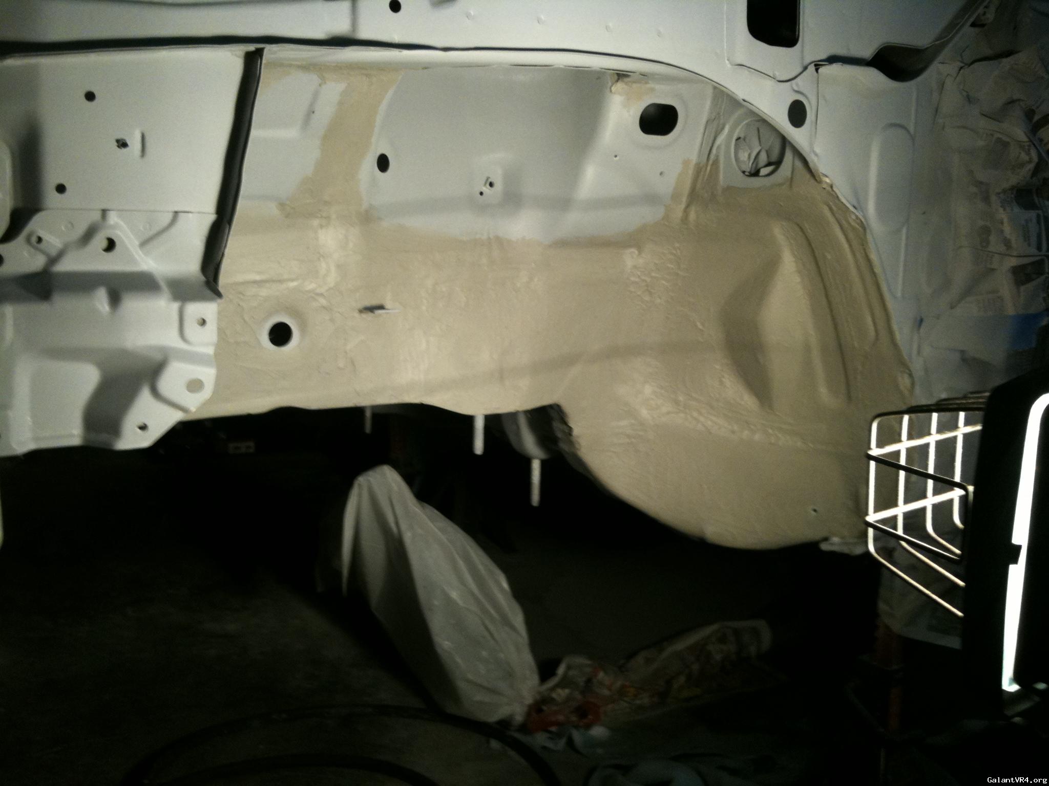

I should be spraying the paint and clear come monday (that's the plan anyway). Right now I just finished applying the seam sealer back into the fender/wheel wells. That 3M brushable seam sealer is some potent stuff. Eesh... this place reeks.
