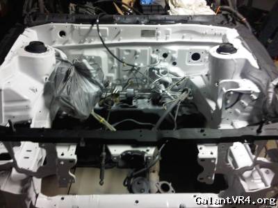

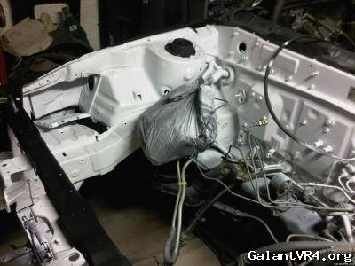

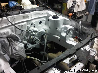

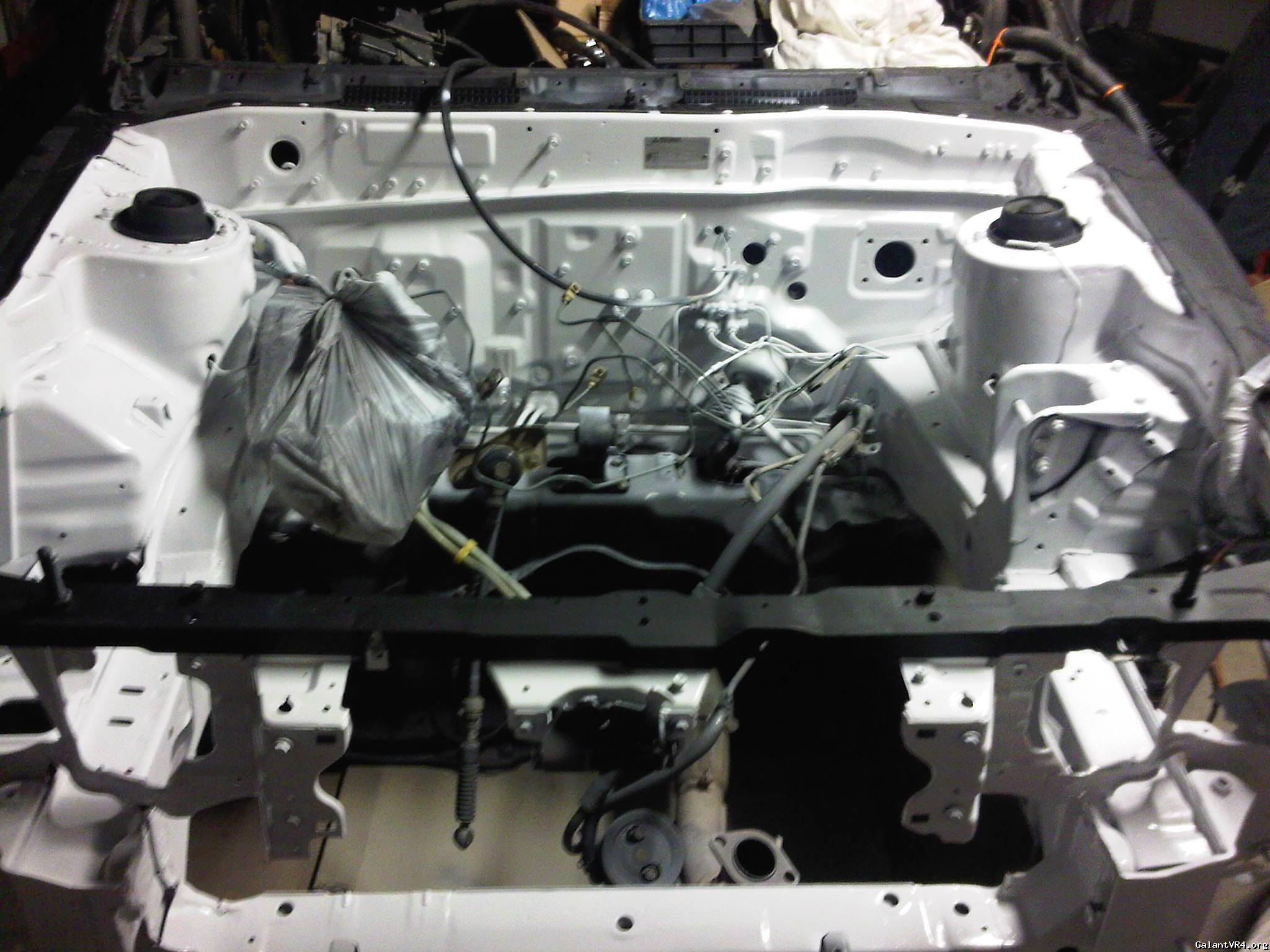

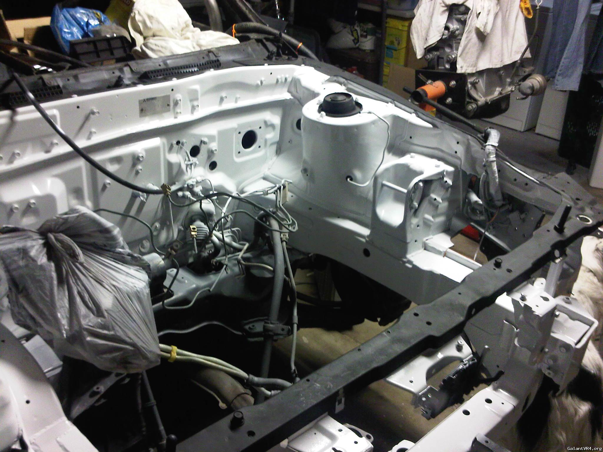

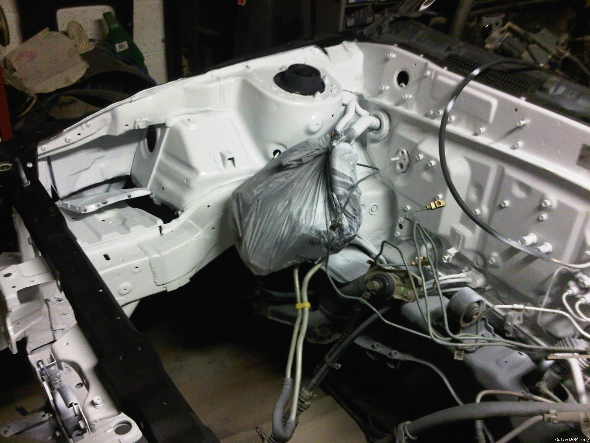

I'm sticking with flat black for the exterior on 195/2000, but spent a little time over the weekend spraying the engine bay with Rustoleum High Gloss White. I'm pretty excited at the results.

@fastfalcon: Yes. My engine bay is all white. The engine is pretty much all silver. If anything leaks so much as a drop, I want to see it immediately.
