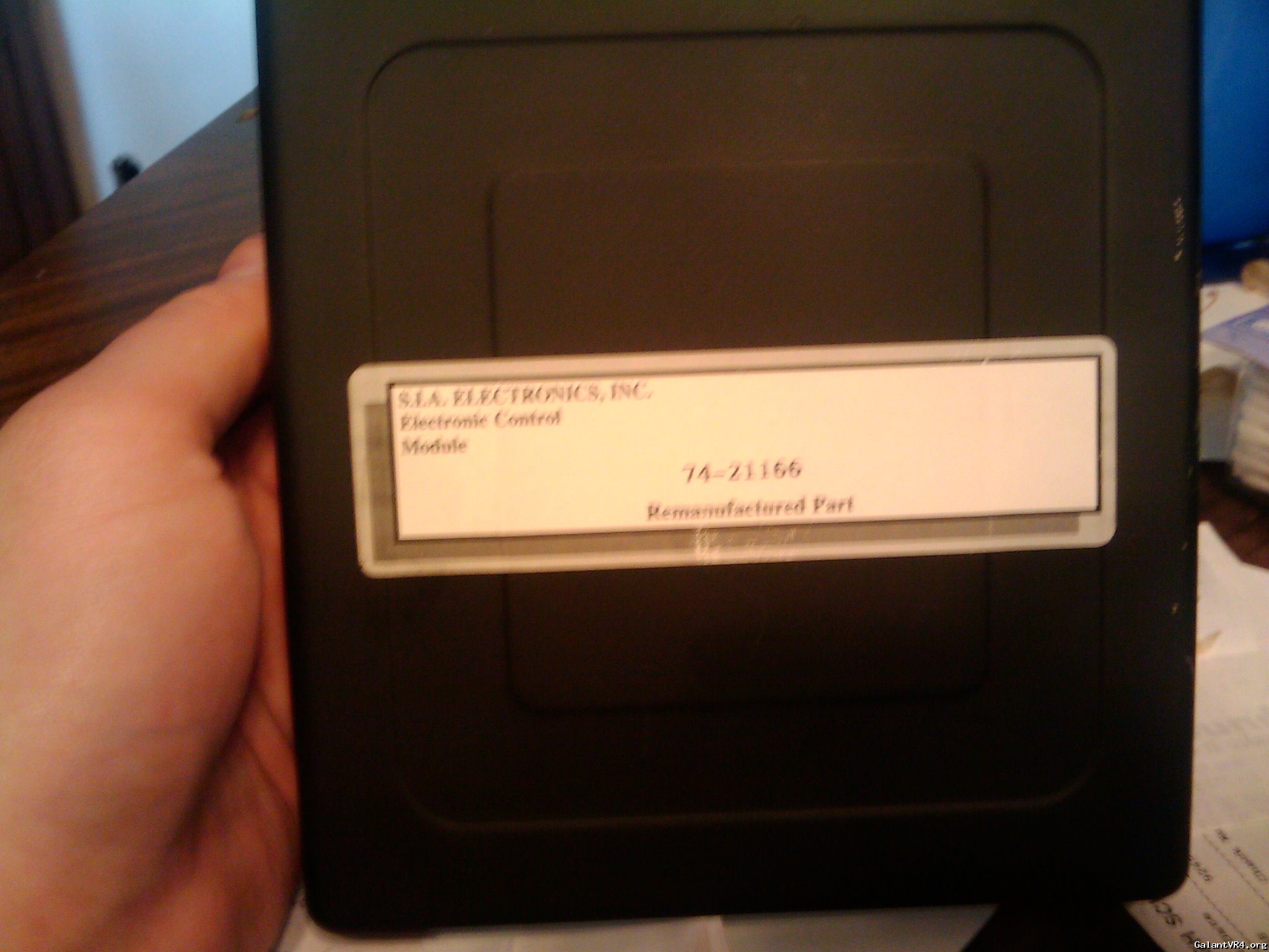

Hey I'm having the engine replace in my galant and while it was in the shop I went and grabbed the ECU out so I could inspect it and replace the caps if needed. I found that it have already been remanufactured by SIA Electronics. I'm the third owner of the car so it's very likely it was rebuilt be a previous owner.

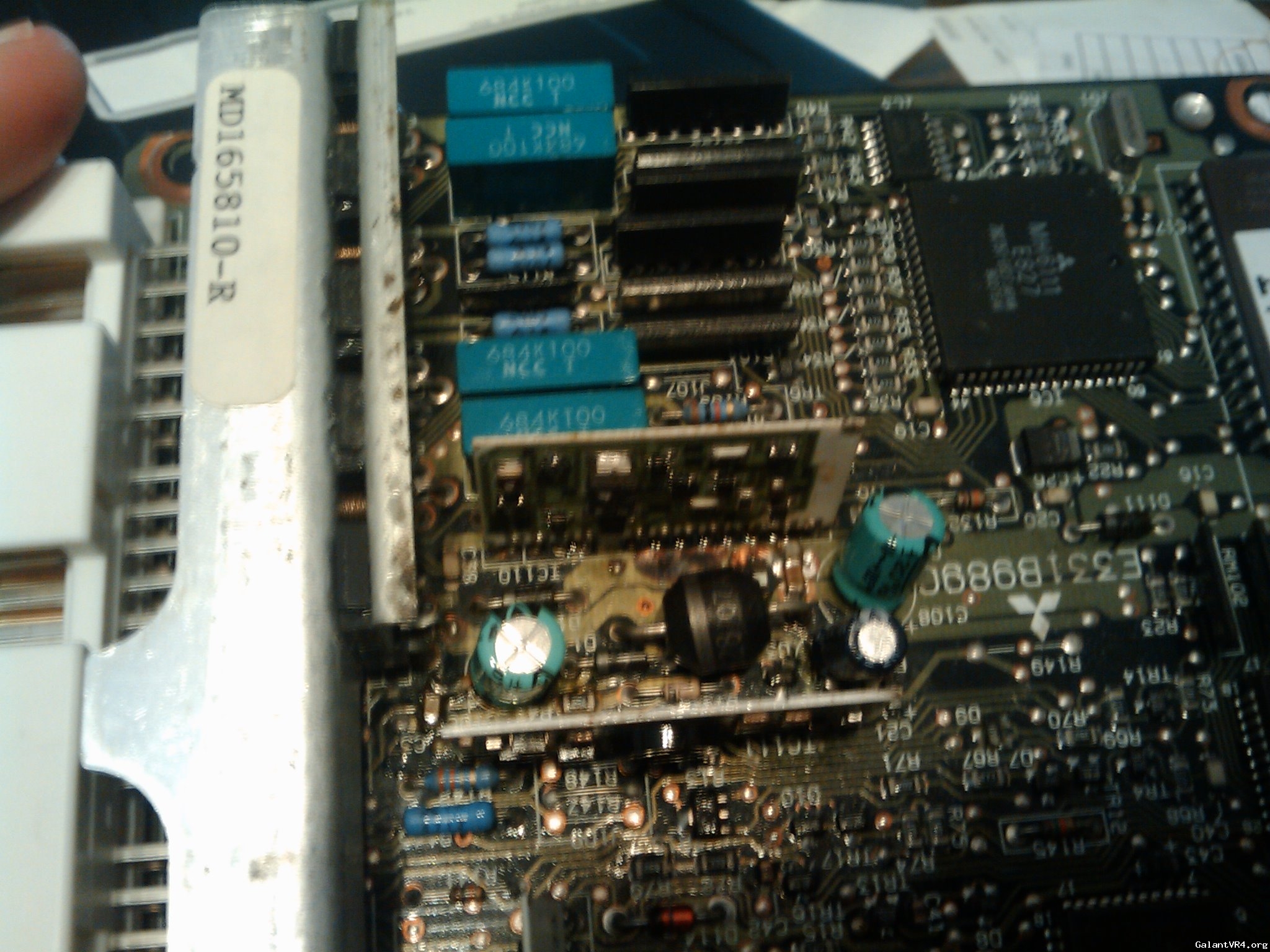

The caps are bad I had cleaned up the board before I took the photo. The one thing that worries me is the dark spot next to the riser board nere the caps (second photo). It is a definate discoloration of the board. Is this normal? Can I test certain points to make sure it is still good?

Well, that is one shitty job of "rebuilding". Makes us all look bad.
If it works, don't mess with it too much. Just clean the acid off the board with q-tips and alcohol.
I'm going to be pulling the caps off tonight and taking better photos of the top side. They shorted some resistors together too.

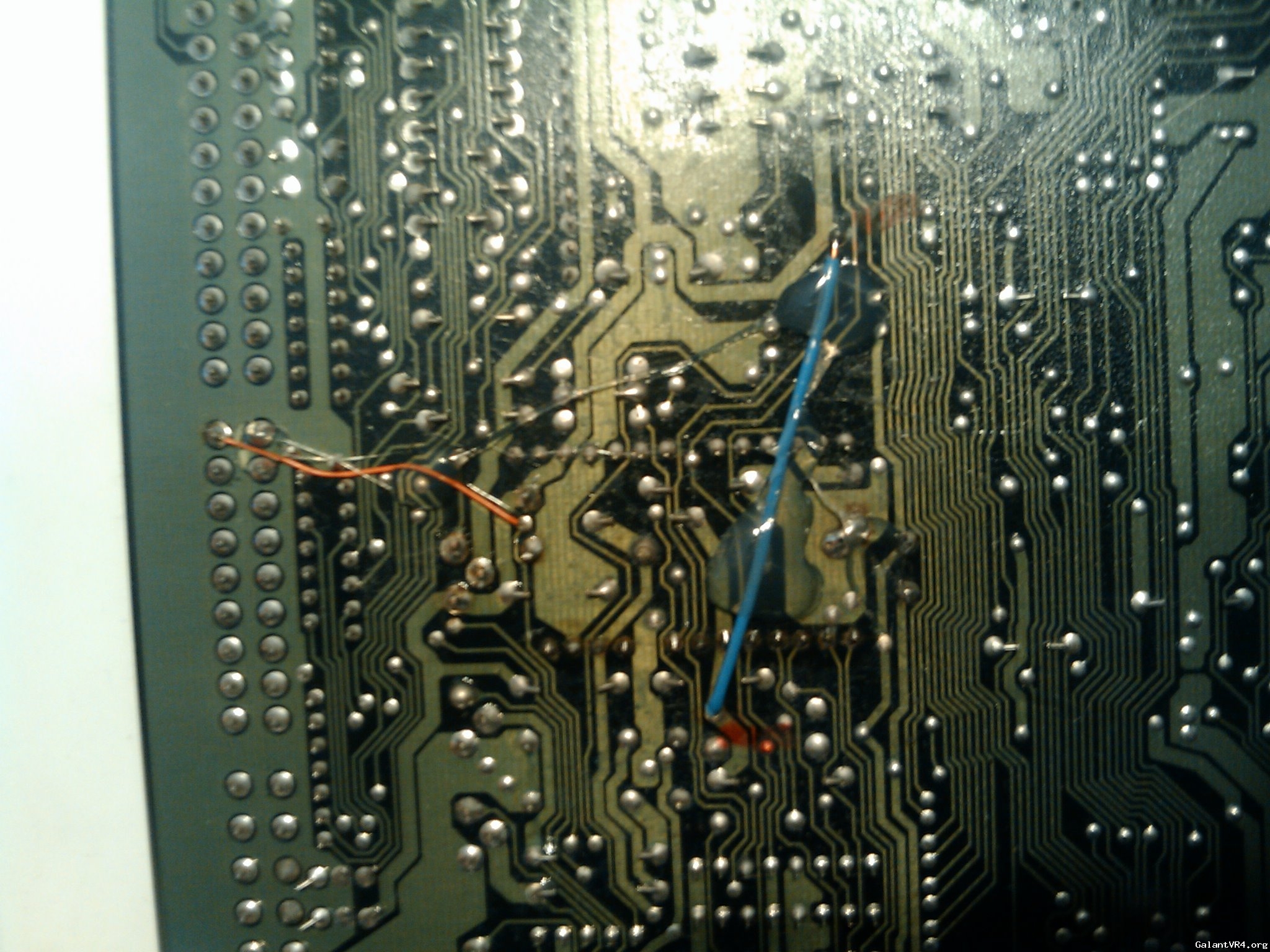

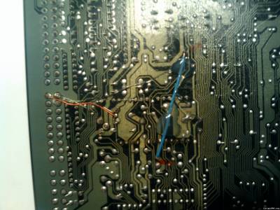

Whats the jumper wires on the back???
In about 75% of the ECUs I do, the acid has eaten traces off the board so you have to replace the traces with a jumpers.
The traces on the bottom looked fine, it was the top.
You MUST get all the acid off. Even if you have to remove the IC110 board, large transient suppressor, and more.
Then you have to replace the surface mount caps that usually fall off the board either from cleaning it or just eaten off. Then repair eaten pads and large runs, install new caps.

Quoting tredmkv:
That ECU is about par for the "professional" rebuilders. Just enough done to make it work for a while.
I call those stickers the "Keep out, we don't want you to see our hack job" stickers.
The long wire is unnecessary if they had fixed the damage at C104. The other wire makes me wonder if there isn't more problems hiding under the heatsink between the pins of CM104 and CM105. You don't usually need a wire from the ISC trace to the edge connector unless the electrolyte has gotten between the pins and eaten the traces under the EMI filters.
Well a trace was cut on top of the board near the capacitor closest to the plug. And a short was sodered in from the positive side to a resistor from the same capacitor. It all checked out though. I'll see monday if it runs. (crosses finger: please dont blow up new engine.)
Well 1030 is up and running. It likes to idle high though untill it warms up. I'll have to figure that one out. Thanks for the help.
