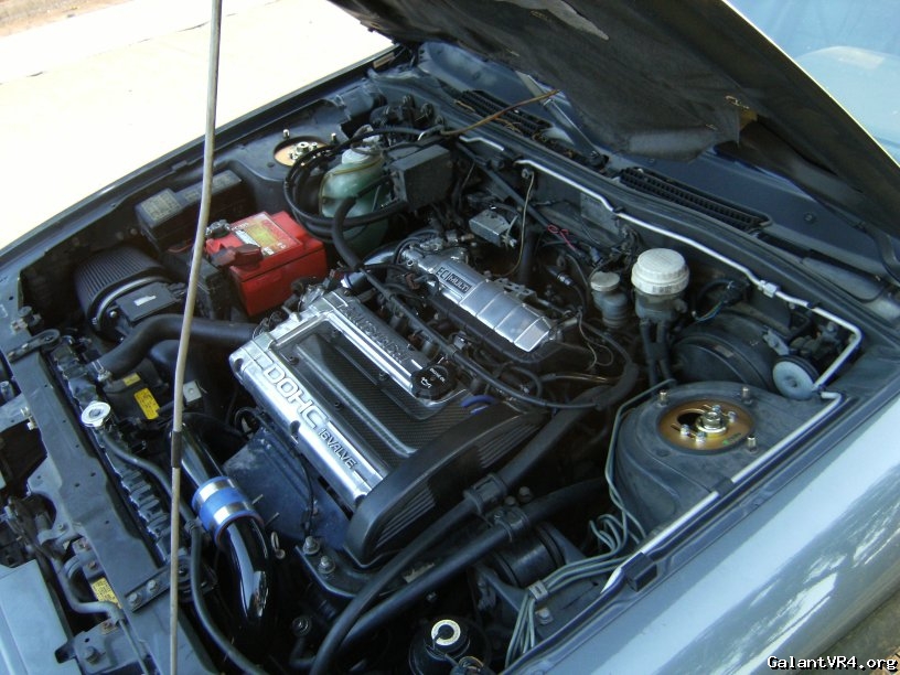

+1. Mine is in the trunk right now but that sub-frame location is my next plan. It'd be cool if somebody made a battery mount that attached to the bolt holes left by the removal of the charcoal canister.
Something like this:
Please excuse the use of MS paint. It's still my standby for quick drawings.

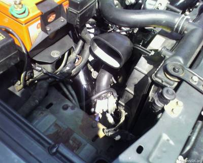

Here's a few of my pics with an Odyssey PC925 relocated to the old MAS location.. Very similar to what Lonewolf64 did, just not as nice looking as his. I'm using an ETS FMIC/Piping kit, and the pipes clear the battery tray with no problems. It also freed up room for a hard straight intake pipe.
