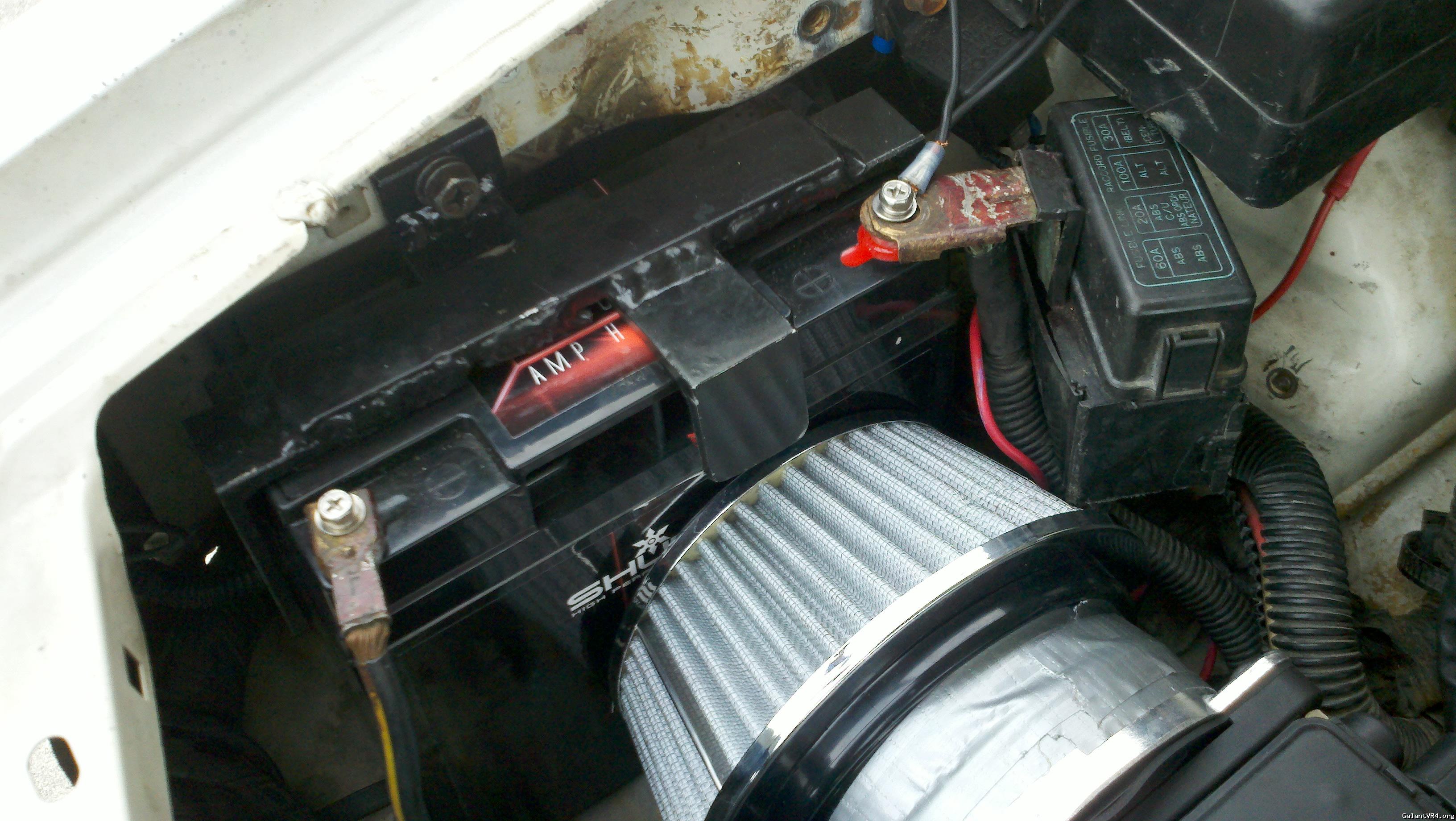

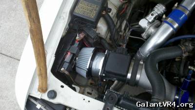

Hey guys sorry for the long delay. Alright check it out, I did some good research on which battery I wanted. After looking at odyssey, braille, optimas and a few other I came across a company called SHURIKEN.
The SK-bt20 is the one I bought. Be as it was on sale and it offered more cranking amps than any other small batteries I looked at. 850 cranking amps, no need to worry about cold cranking amp since I live in Florida. It is 20 amp hour battery and is only 13.5 pounds and it a 3rd the size of a regular battery. It also comes with a 1 year manufacture warranty and the company I bought it from offered a 3 year extended warranty which I obliged.
I put it in the same place where I had it before for now until I can do my relocate project. Thanks for all the ideas im taking a lot into consideration. /ubbthreads/images/graemlins/wink.gif

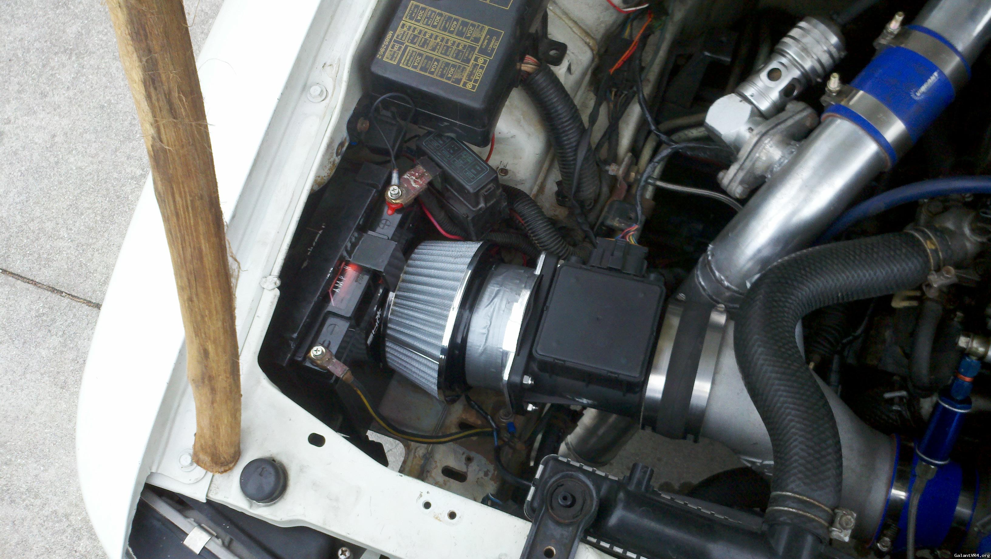

Bunch of pictures here .
It puts the battery where the stock aircleaner used to be. I haven't had a lick of trouble with it in this location. I did have to drill a hole in the front stock aircan mount and lower it a little bit so the battery sits level.

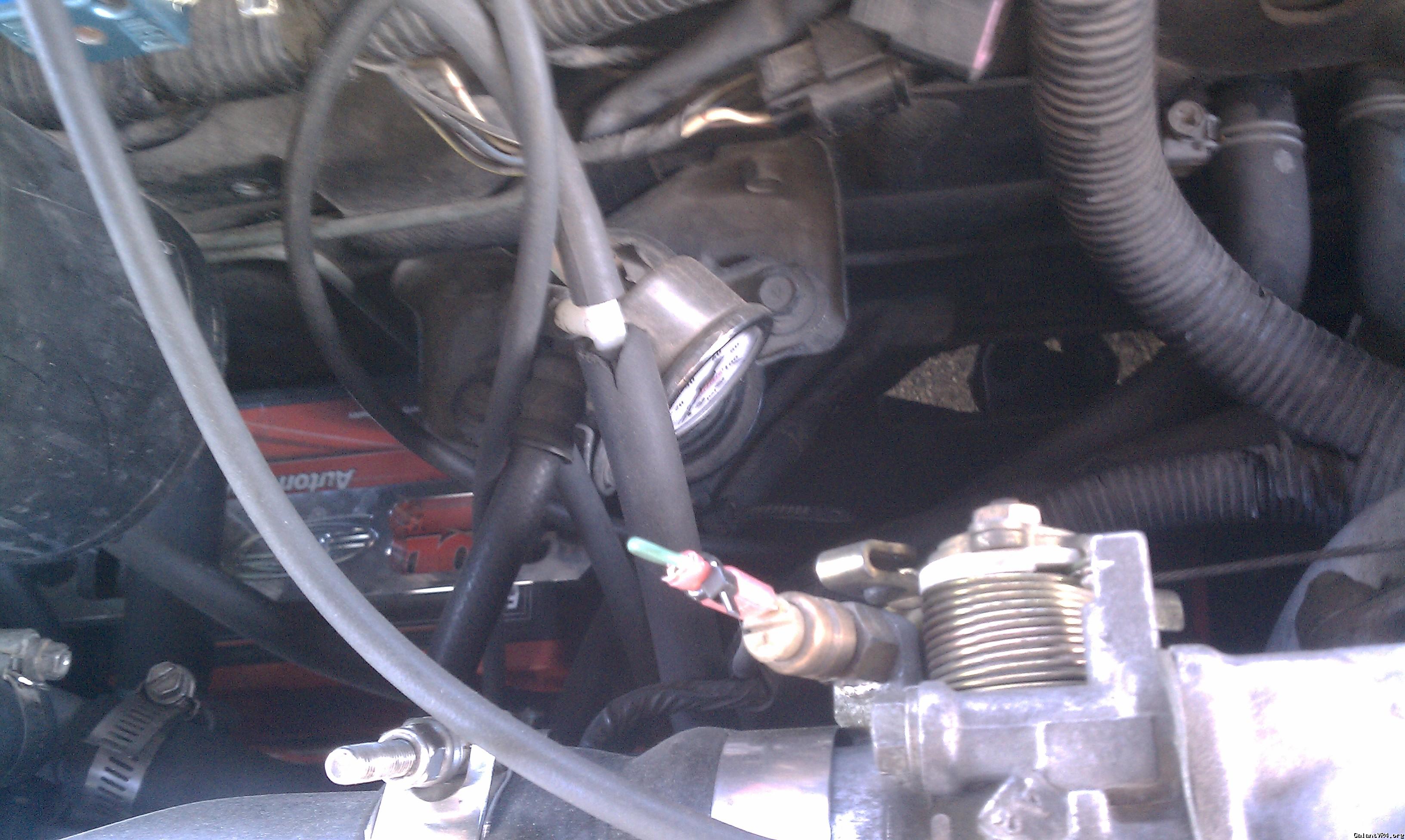

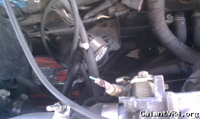

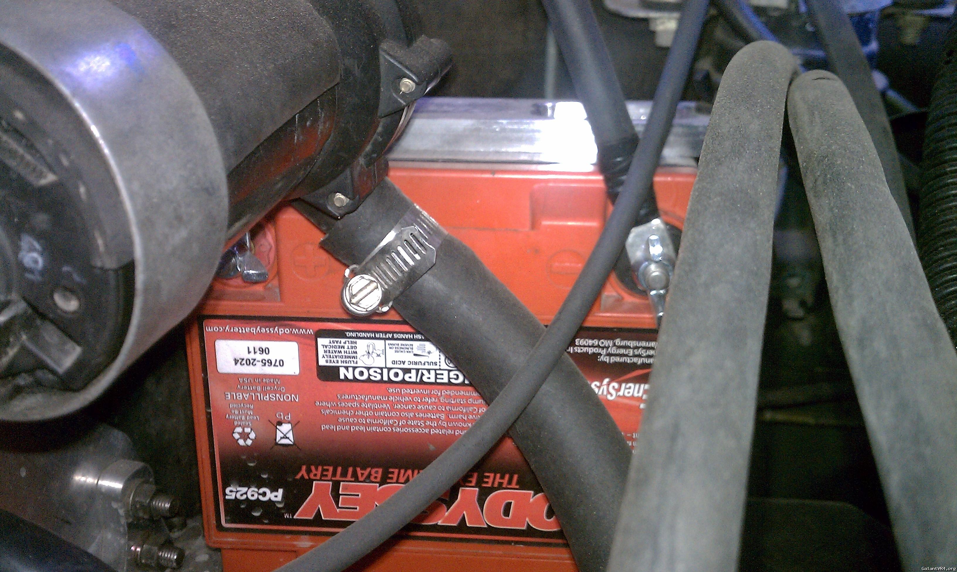

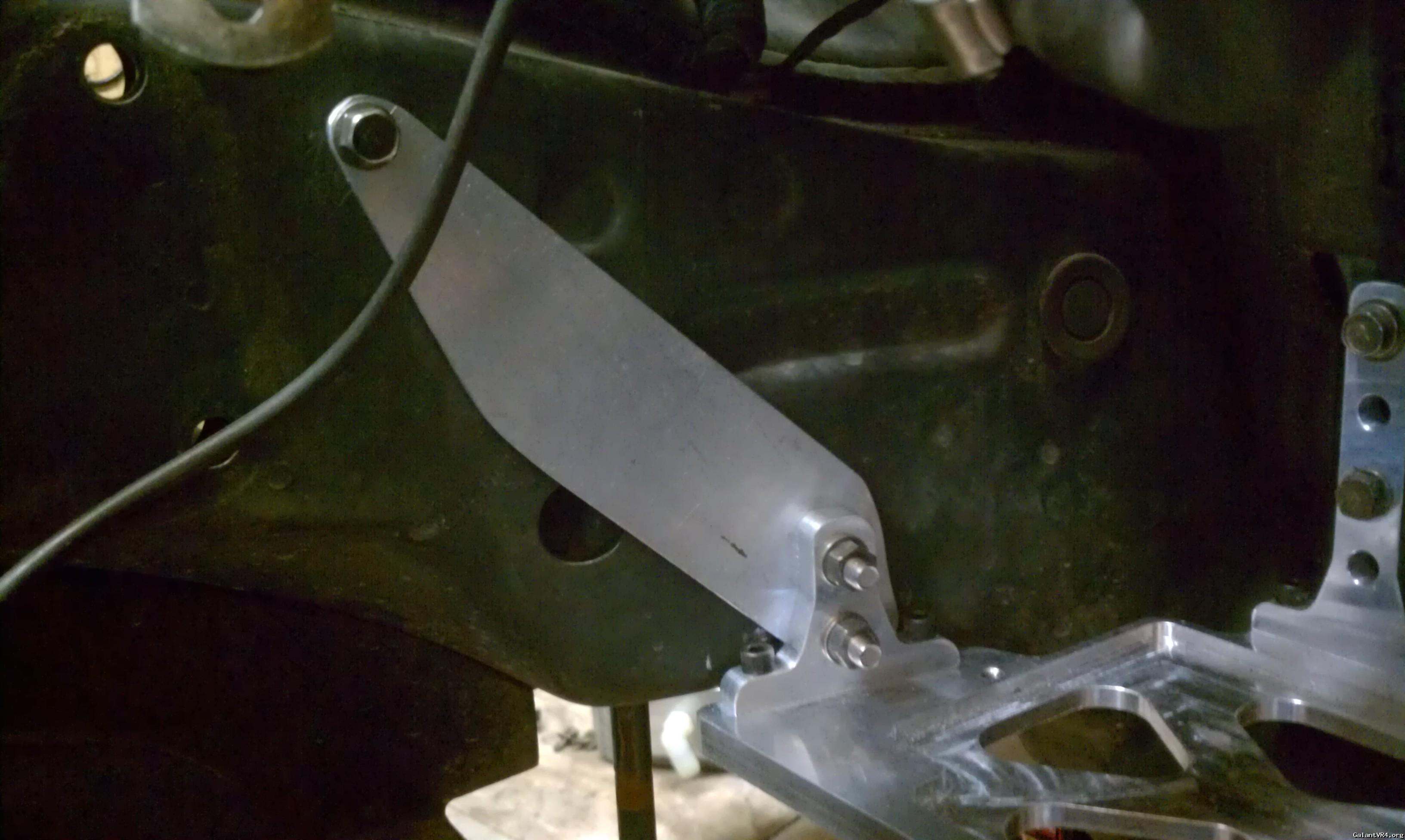

I got a JMFab kit for 1G dsm for the PC925. They say it doesn't fit, but it was really easy to adapt. Just get a piece of aluminum strap and use it to extend the lateral bracket up to the attachment point on the side of the strut-tower.
I'm going to be relocating the battery back under the hood soon and from all the searching I've done I like ths idea the best. Could you get some more picture with the battery installed ? Any clearance issues with the A/C line?
