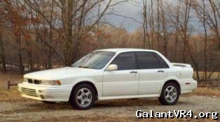

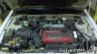

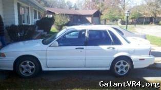

Well I get 1695//2000 back in October of 2011 after I going to my first year at the DSM/EVO Shootout. I had been looking to get a Talon TSI, but I saw a couple Galant VR4 there and was like this is the 4g63 car for me.
This is what it looked like when I first got it.
After getting it I checked at all out to find the good and bad in clean it up a little be more then what the guy that had it before he had done. With the regaler maintaince stuff.

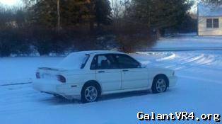

I didn’t have much plans for it at first other then it being my daily driver and keeping her clean.
First thing I had to do though was paint the door window trim I couldn’t take it being half white and half faded black. Ti turned out pretty nice for just a ratlle can job.
Didn’t do to much to it for a while but drive it for a bit, I did get the windows tinted nice and dark tho. these photos are from the day It back for the tint shop. I thought it made her look pretty damn nice.

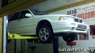

Then one day of running late to work I let her get a little to hot… and I blow up the radiator and put a 8” crack down the top of it. So I started to tear her down the next week. And that’s how she sites right now which makes me sad. But I have not been just sitting around doing nothing most of the time.

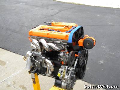

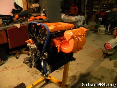

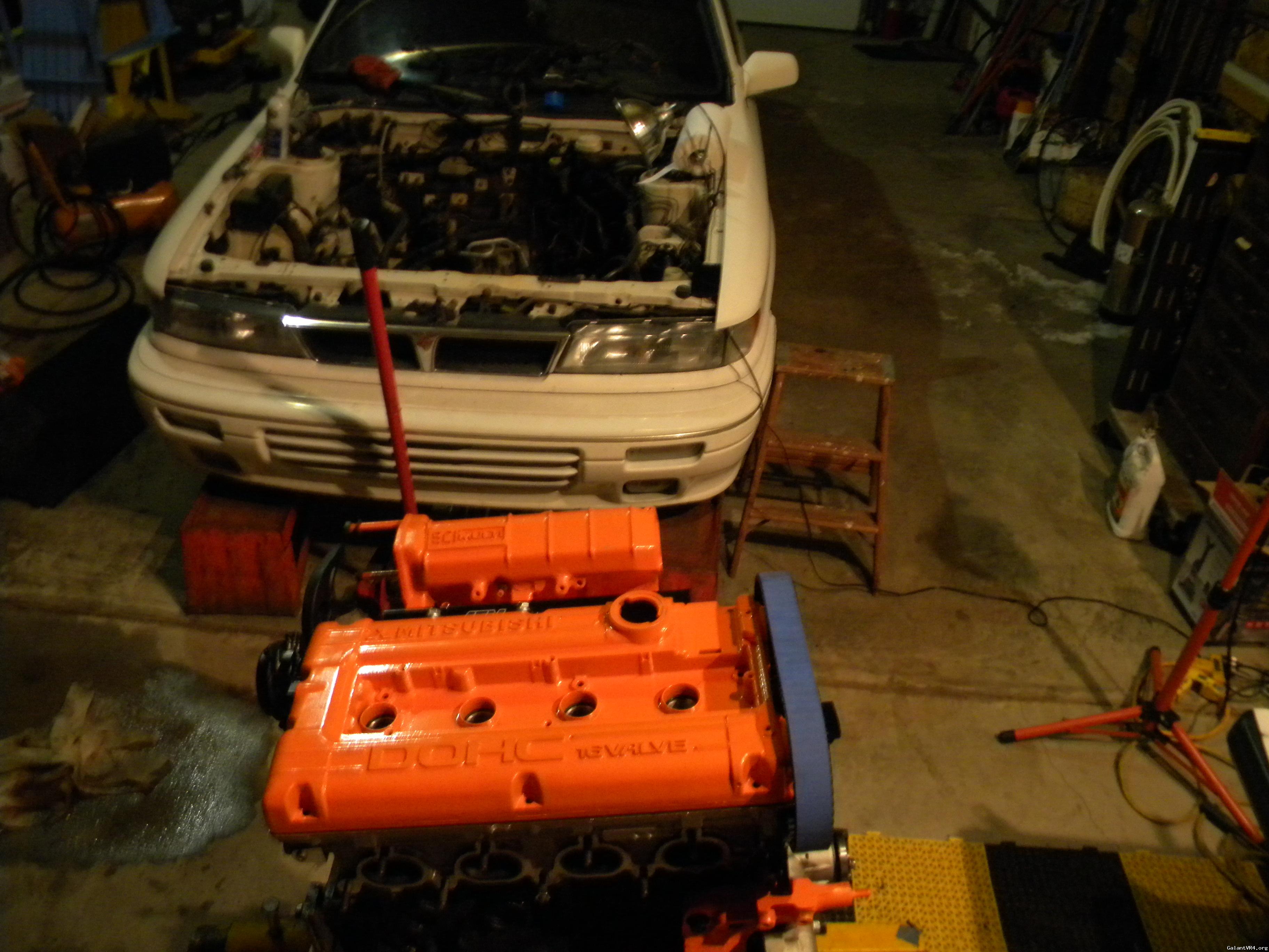

over the last week i have been putting in long nights of work on her and hopefully will be able to have the car ready for the tuning and dyno time coming up in the next couple of weeks.
this is how it the motor sits right now should have have the timing done up tonight.

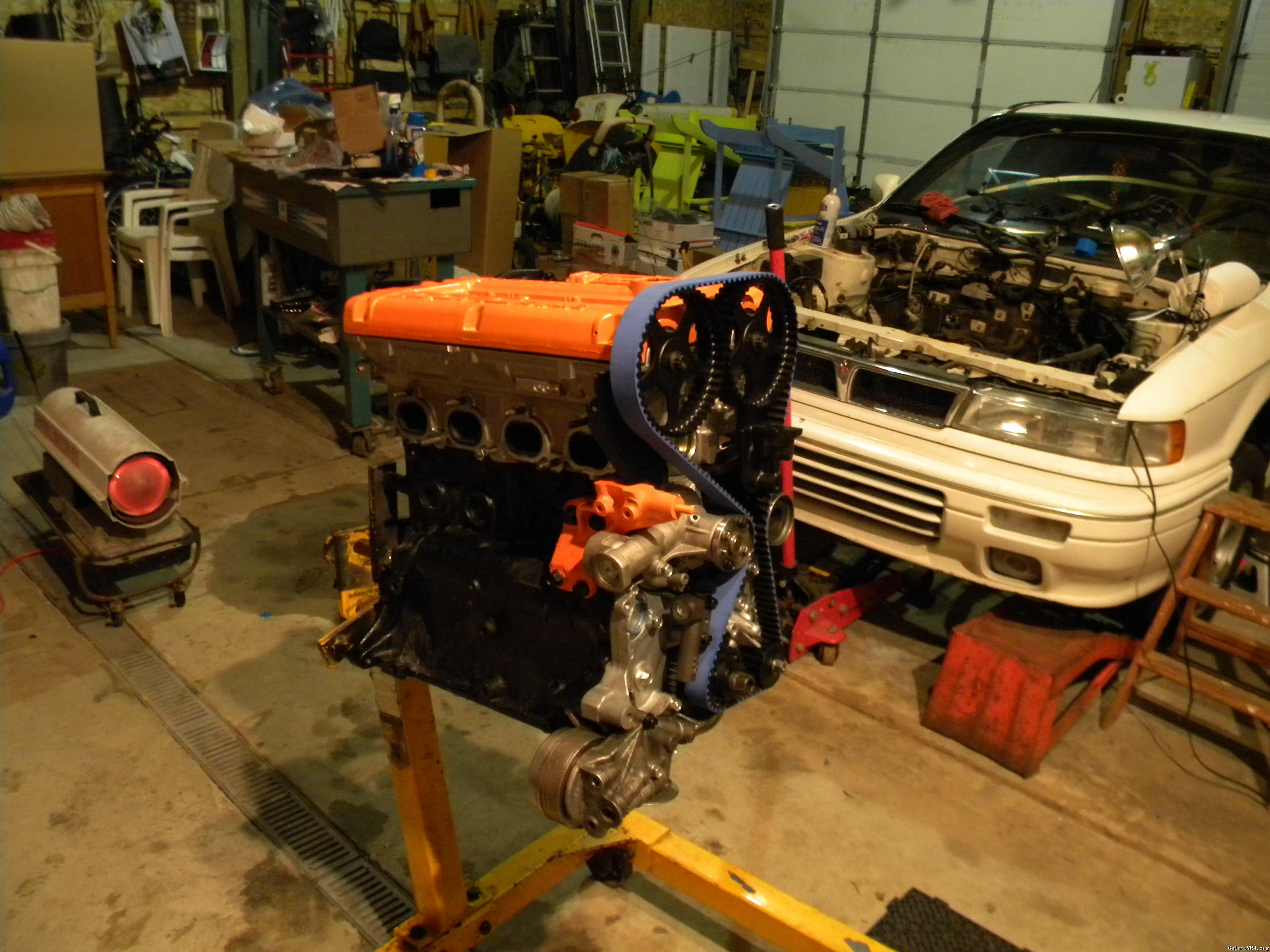

getting more and more stuff put on the motor. should have it all timed up tonight and start preping for manifold/ turbo mock up...

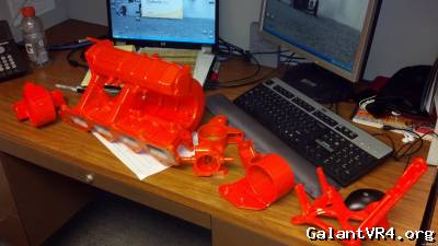

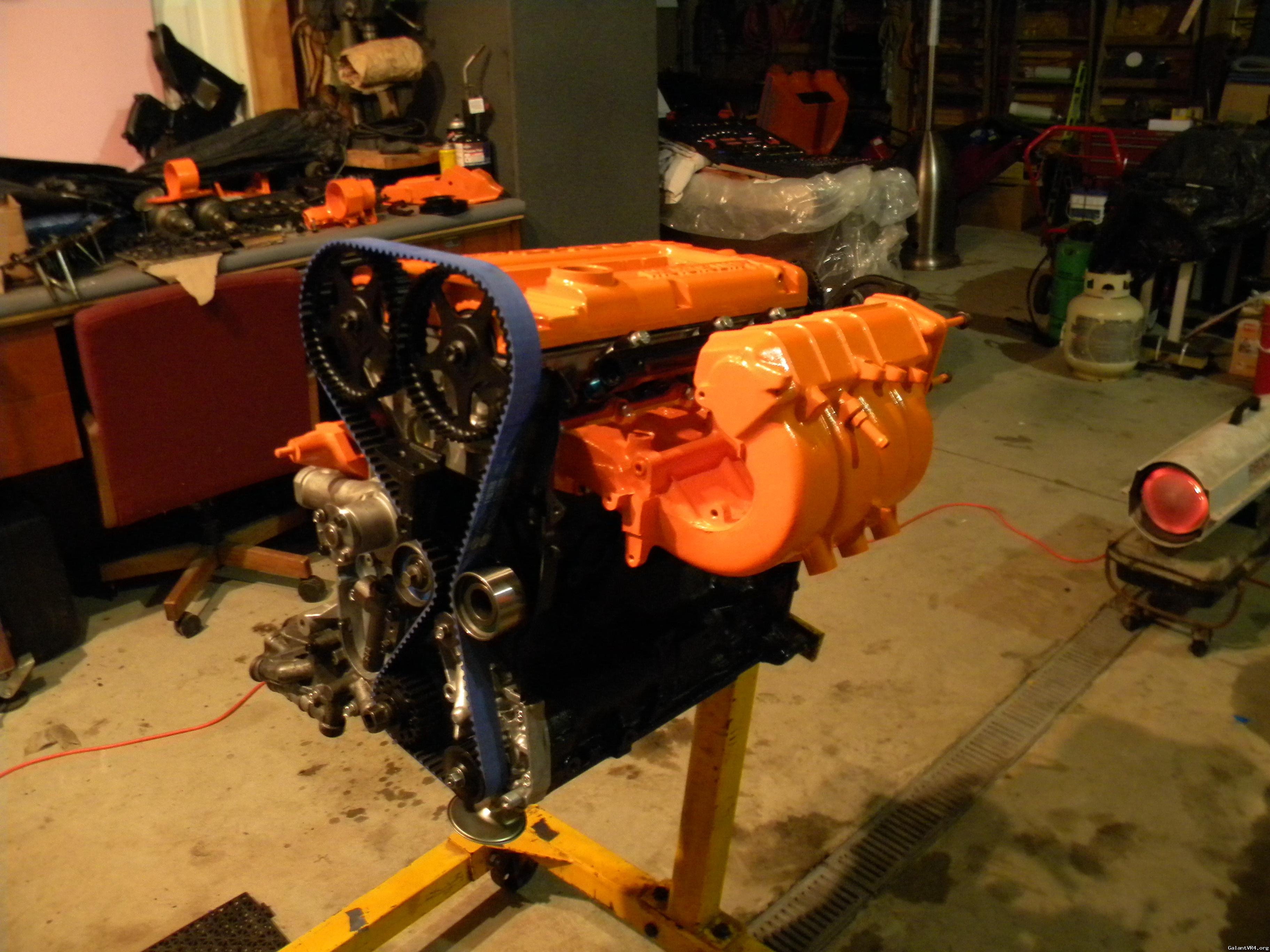

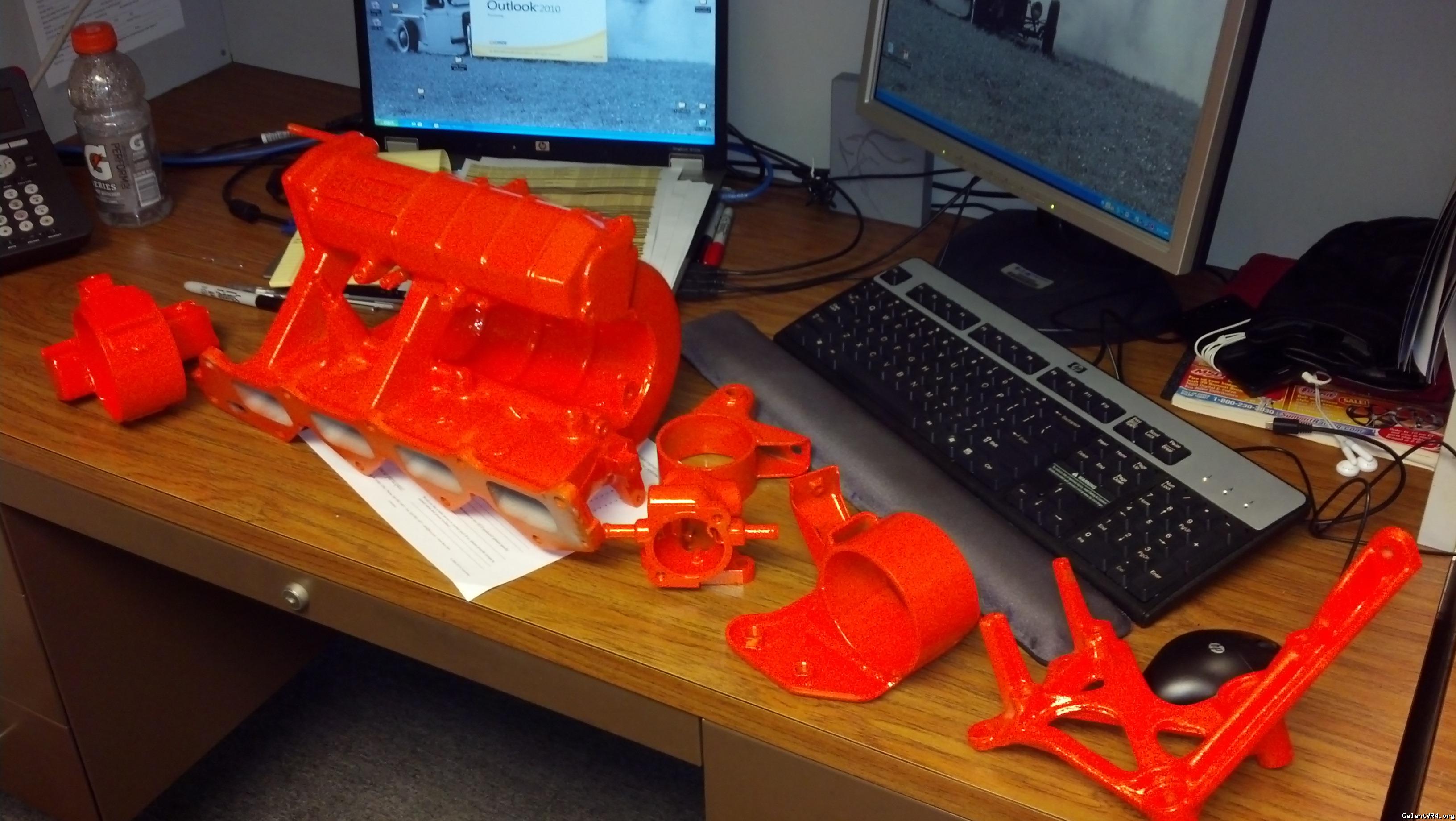

came into work today and found my motor mounts and intake all powder coated and ready to be put on. should have most of the block all back together by the end of the week.

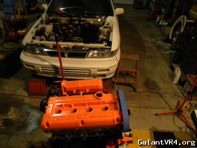

got more stuff on last night. just a few more things and the motor will be good to go back into the car. just need to finish all of the pre-work first.

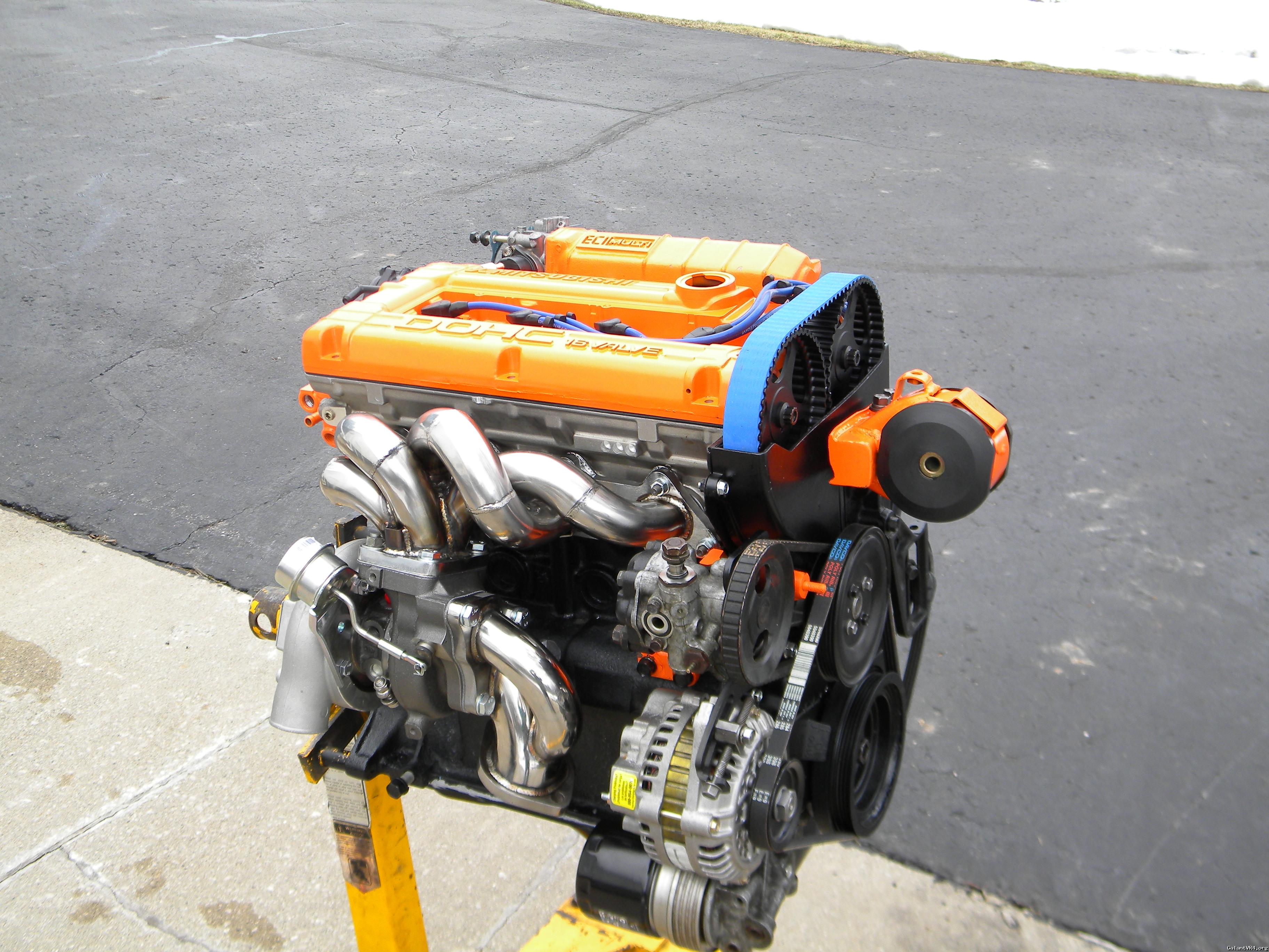

motor is all ready to go in now.
Redwood
Oct 13, 2011
282
Moses Lake, Wa
Quoting GSX_TC:
Setup looks good.
thanks man i have put a lot of time into her to make it look at nice. just got to get the car all ready for the motor to be put in now.

Any updates? I stumbled upon this car at my friends shop? You have a good chance of making the power you want at Force if they are dyno tuning it.
G
Feb 24, 2004
8,896
zompton
Looks nice. You should really ceramic coat that header and o2 housing while you have the engine out. That alternator is going to get fried.
