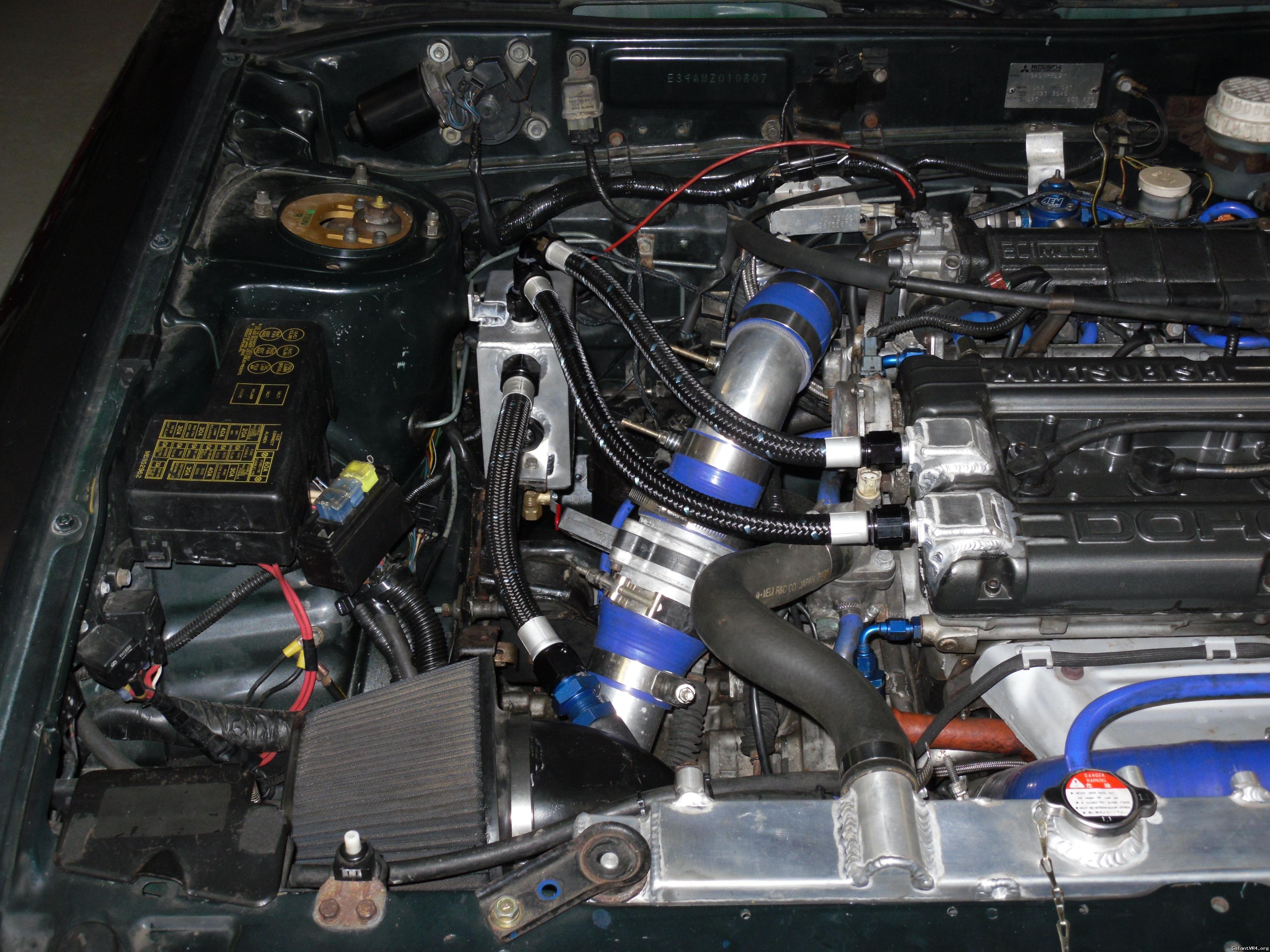

Ok so i know my cars vac lines have not been optimal since i bought it, boost controller is connected to BOV and boost gauge with a couple "T" fittings, most ports are blocked on the Throttle body, and the catch can setup is pretty much useless. so now that i am going speed density and switching stuff around, now is the perfect time to redo the vac lines and catch can
I have:
emission delete
E16g with no nipple on turbo outlet
91-94 TB
matching 1g turbo intake manifold (2 vac Ports)
so which port will be best for each part listed below.
Forge BOV (attached to bigger Intake Manifold port)
Boost Controller to tapped turbo outlet
Boost gauge (attached to "P" port)
Map Sensor (attached to brake Booster line with "T" temporarily)
Fuel Lab FPR (attached to smaller Intake Manifold Port)
(updated to final setup)
The catch can setup that came with the car is pretty stupid. the valve cover vent, is connected to a vented catch can. and that's it, lol
i know you guys have some newer clever ways of routing thins than the old taboo speed shop diagram
Thanks

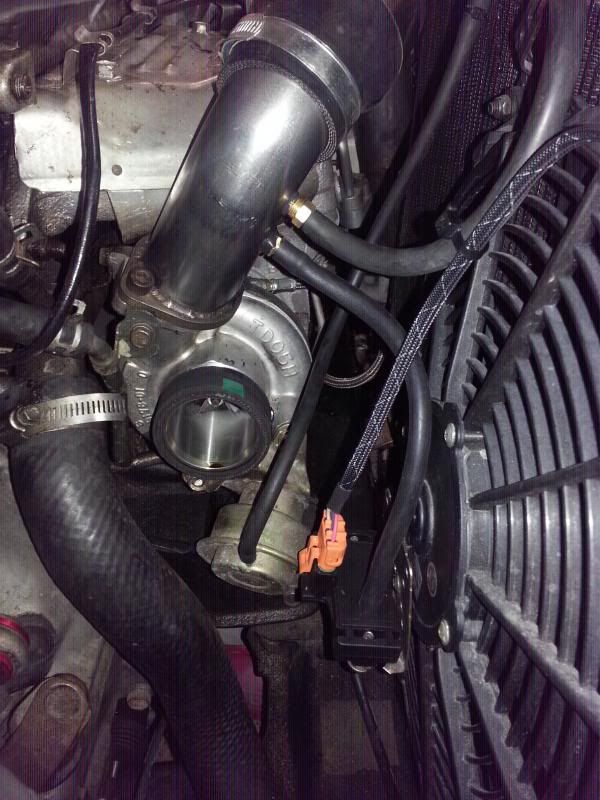

ok so i finished up my vac lines.

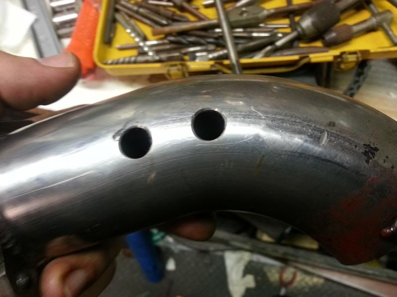

i tapped the turbo outlet pipe with 2 fittings.
1 for the MAP sensor and 1 for the boost controller. i mounted the map sensor on a bracket bolted to my fan for a close install. maybe 6" of vac hose to the sensor.
i think it came out nice and clean.
i am thinking about tapping the Valve cover the same way for the catch can setup.
thanks for the help guys!

MAP. Manifold Absolute Pressure. This needs to measure pressure and vacuum after the throttle plate.
Not pre-intercooler charge pipe pressure. Now you have to plug a hole and move the map sensor if you want your car to run right on SD. No doubt you're getting wildly inaccurate readings with it there. Depending on your fmic you could be seeing a great deal of pressure drop. Regardless, the MAP will never see vacuum there.

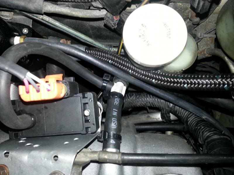

I ended tapping into the brake booster line for the MAP Sensor. i (pulled) off the booster line at the manifold and used a "t" fitting, i also cut off a small 2 inch section of 3/8" fuel line i had to reconnect to manifold, this avoided cutting the factory brake booster line as this is a temporary solution until i get my SMIM.
This option started when I was considering getting a vacuum manifold to solve this problem before, that kind of setup would use the same IM Brake booster port as a source, but i have no need for that many ports to need a vacuum manifold, so after some quick research i found many people tapping the booster line the same way i wanted to. We will see once i start the car hopefully int he next day or so.
No modification needed to the stock parts is the best part of this mod, completely reversable.

So you are still using the factory line from the brake booster to the t-fitting, correct? There is a check valve in that line that needs to stay there so just making sure.
turbophein
Feb 17, 2009
683
mass
absolutely. lessen learned years ago on that. i actually just fixed my buddies sti for that very reason a month ago. he changed out all his hoses with colored crap, and then he wondered why his brakes were not working right...

I would suggest flipping the map sensor upside down, because they are installed from the factory this way, as were my instructions for the Defy Racer Blue's. Reason being, moisture and the fact that it can pool in the sensor the way it stands now. Not knowing if that would ever happen, BUT it's a pretty good reason to keep moisture out of such an important data maker.
