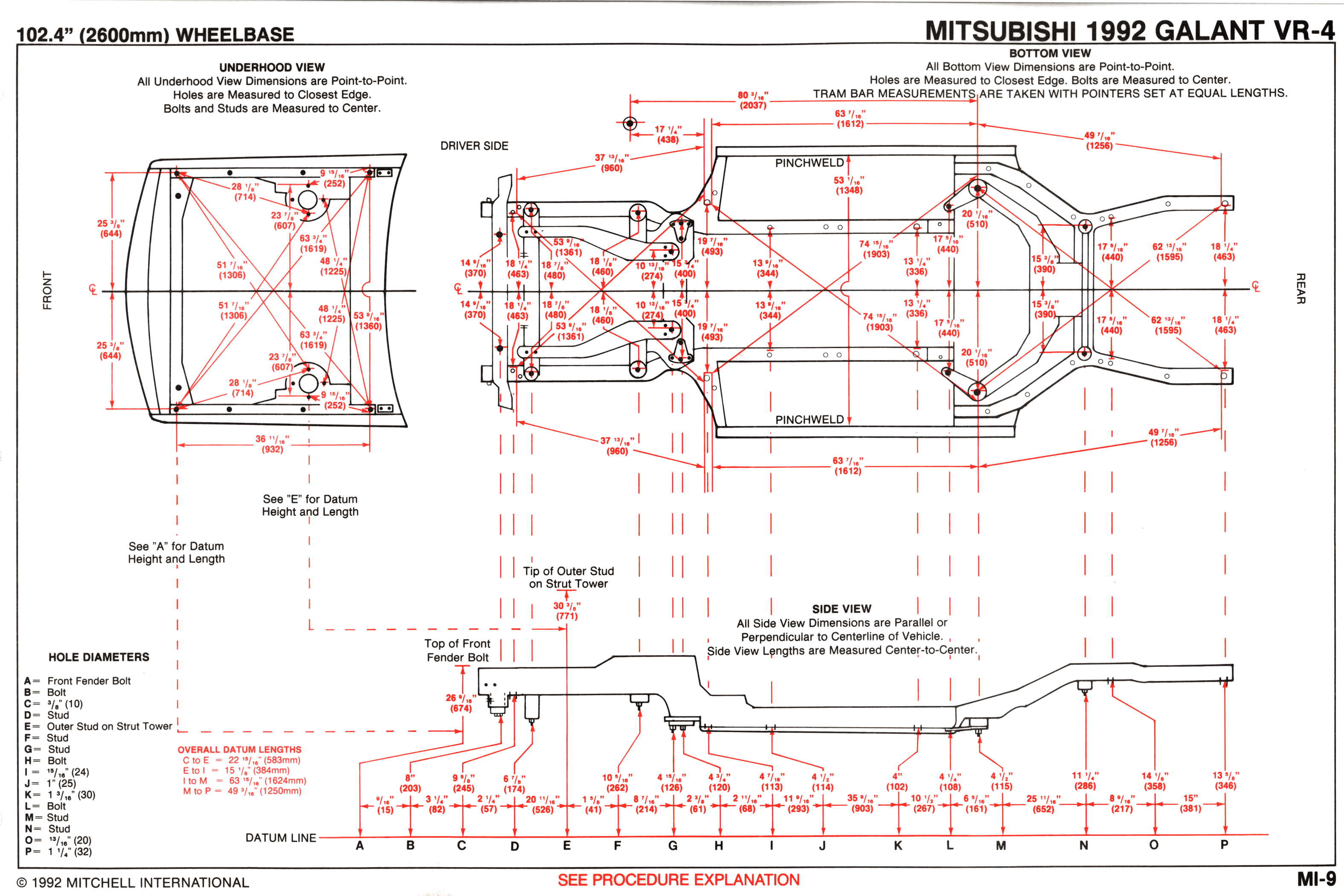

I have searched for these, and trawled through the topics but have been unable to find what I'm after. Maybe my search terms are wrong.
Does anyone have the measurements between the rear subframe mounts, ie between the moustache bar mounts, between the chassis mounts by the trailing arms, and a diagonal measurement between the chassis mount and the diagonally opposite moustache mount.
Metric or imperial is fine.
Thanks.
