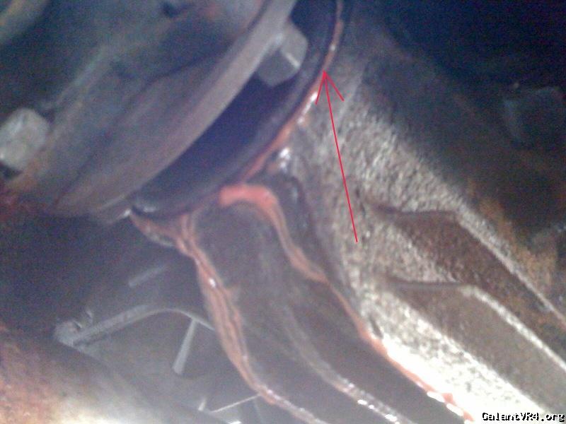

My rear diff started leaking. How hard is it to replace the seal?
Can it be done by disconnecting the driveshaft and taking out that one nut, go through it that way?
Please excuse the phone pic.

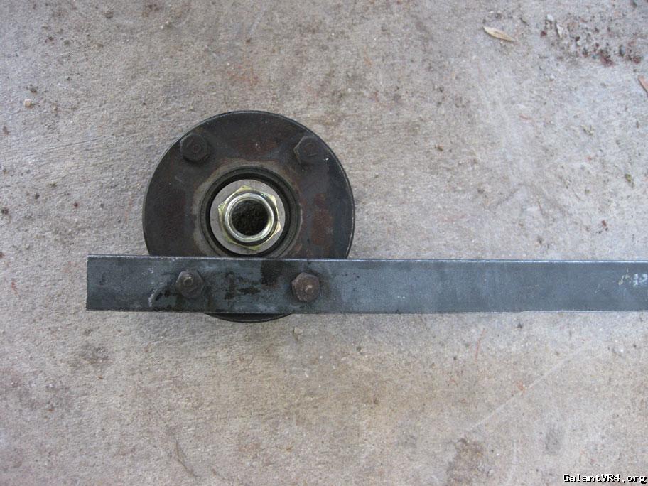

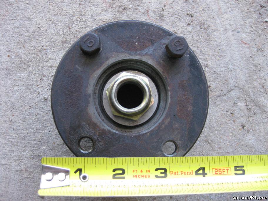

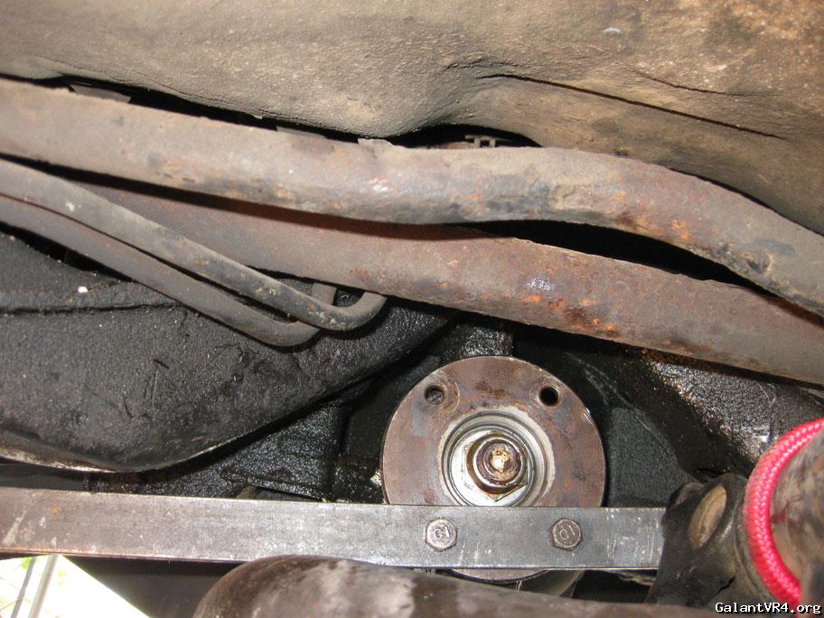

My rear end started leaking a couple of weeks ago also. I finally got a chance to replace the seal this weekend. That nut was tough. I spent a good half day just removing it. I tried the hand brake at first and I didn't like how the force was not being applied directly to the nut. There was still play as I would torque the breaker bar to try loosen the nut. Below is how I did it using the info as was posted above by Mr Toybreaker. /ubbthreads/images/graemlins/smile.gif
1. I went to Lowes and purchased a 1/4 inch thick steel bar.
2. Drill 2 holes to secure the bar to the flange. Use the holes that are 2 inches apart.
3. Tighten the steel bar with the two bolts onto the flange. The bar will brace against the subframe as you apply force to the nut.
**After you install the new seal, simply reverse the bar in the opposite direction to torque the new nut.

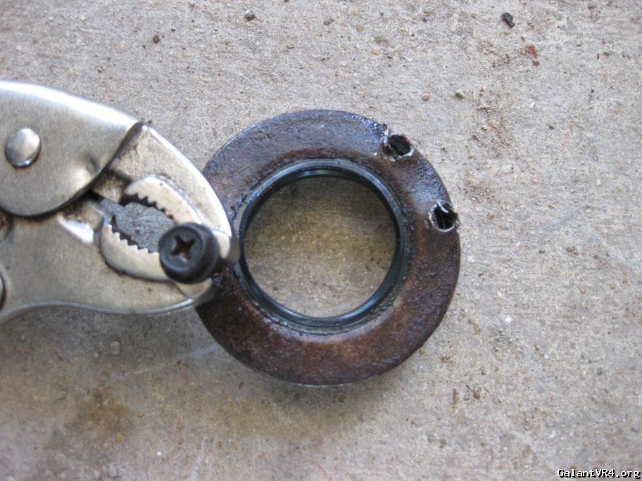

4. Remove the seal. I used the lever/pry aprroach. It popped completly out on the 3rd try. Be careful with any sharp edges and keep the internals clean. DO NOT drill; you want to poke it to start the hole for the sheet metal type screw.
5. Carefully install the new seal and torque the nut back on.
6. Fill back up with your favorite GL-5 gear oil. (.7 liter = .74 quart)
