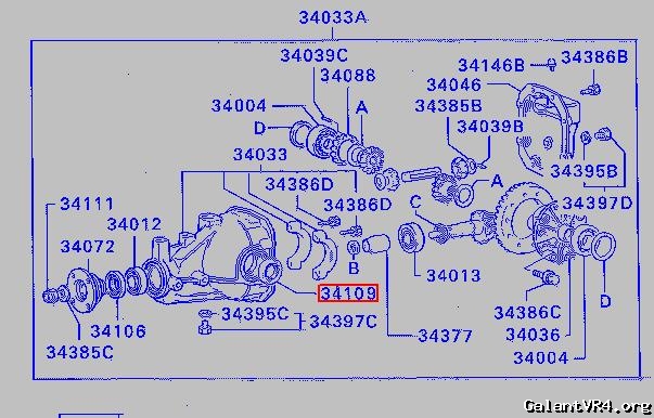

I talked to the dealer and they didn't seem to have a listing for the seal. They listed a dust seal, but no fluid seal. Does anyone have a pn or possibly a schematic of the rear diff?
Looks like I will be jumping on this wagon as well. I need some seals.

Awesome, thanks. Just got off the phone with the dealership. PN confirmed.

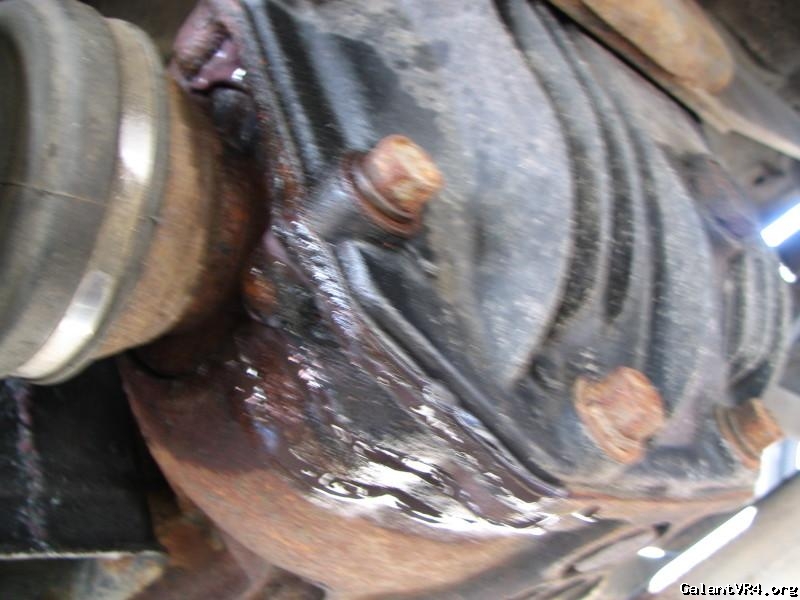

Here's a pic of the problem. This is actually Jason's (Shiskibob) rear diff, but mine looked the same.
I got the above listed seal from the dealership for ~$10. After removing the rear axle (a pry-bar is useful here) the seal came out relatively painlessly. Just get a flat headed screwdriver and get it in behind the seal from the inside. Don't imagine that it'll all come out at once; work your way around and it'll move little by little. It probably took 5 minutes of patient work. The new seal goes in pretty easily. Make sure that it's lined up and start it by hand. Then get a big socket that is just a bit smaller than the outside of the seal so that the force is directed to the hard molded part. Then tap it in gently with a hammer. I actually didn't have a socket big enough so I just used the rubber side of a dead-blow hammer going slowly around the outside of the seal and tapping it in place. The socket method is preferable though as there is less chance of fouling the seal. Now leaky all gone.

I'm chiming in to say that it was all done in car, pretty painless. Jack the car up, remove the rear struts, unbolt the outer axle flange nuts, pop the axle out. Reassemble in reverse after the seal swap.
Well, painless for me; I just watched. /ubbthreads/images//graemlins/grin.gif I bet the whole job could be done in 20 minutes if you know what you're doing and don't run into any SNAFUs. I'm a nervous nelly though, so projects always take me longer.
