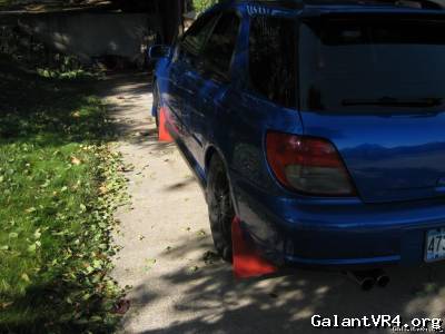

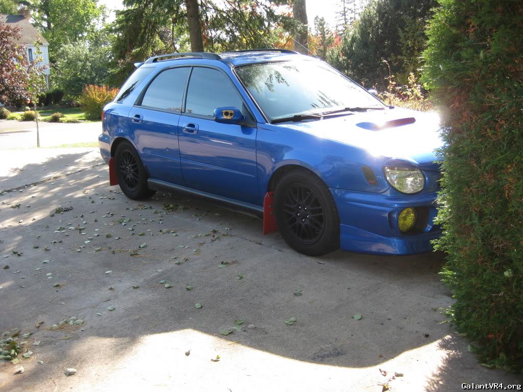

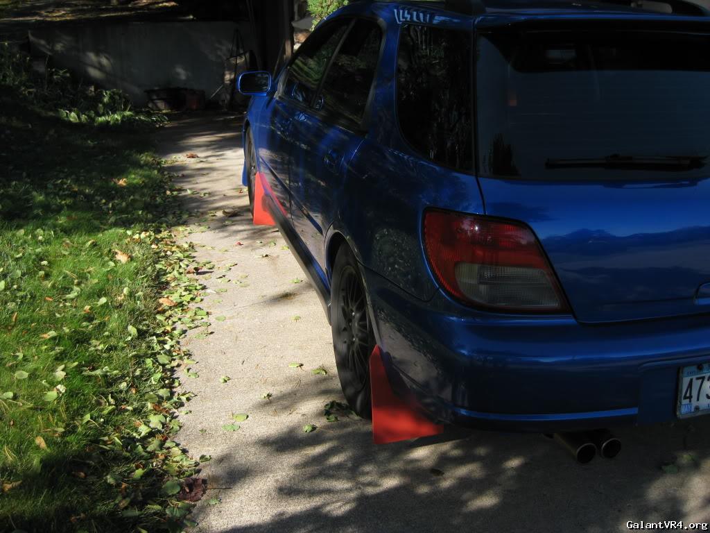

They are really easy if you have all the oem stock mounting tabs. What I did was get a set of the GGSX front doglegs with molded mud flaps and used them as a template. I pulled the mounting tab from those and mounted them to the new mudflap with rivets and painted those to prevent future rust.

Those are super nice, but damn they're expensive.
A lot of the rally guys I know either buy pairs of semi mudflaps at the local truck stop (for like $20 or so), or buy raw sheets of HPDE or similar, and then cut them down. Of course, the rally guys I know are probably tougher on mudflaps than the usual street car.
Be sure to post pics when you get em installed. I'm interested in seeing them on a Galant. My plan has always been to snag a couple pairs at a Mitsubishi Fuso dealer so I might be able to get a Mitsu logo on at least one of them.

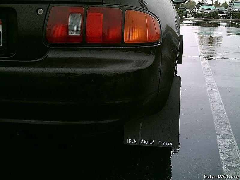

Might just be a subaru thing but I heard that you can cut up Ikea cutting boards and the look great and work even better.
wow those look bad. glad i live in florida /ubbthreads/images/graemlins/uhh.gif

LOL. So looks like a cutting board. I guess it makes it convenient if you need to cut up some fruit or veggies if you are on the go

I can't tell the difference between the ikea rally ones and the rally armor ones, really.
