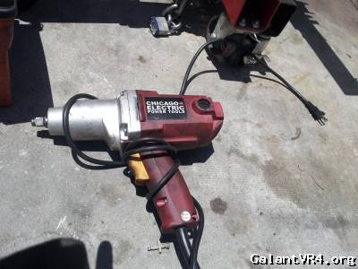

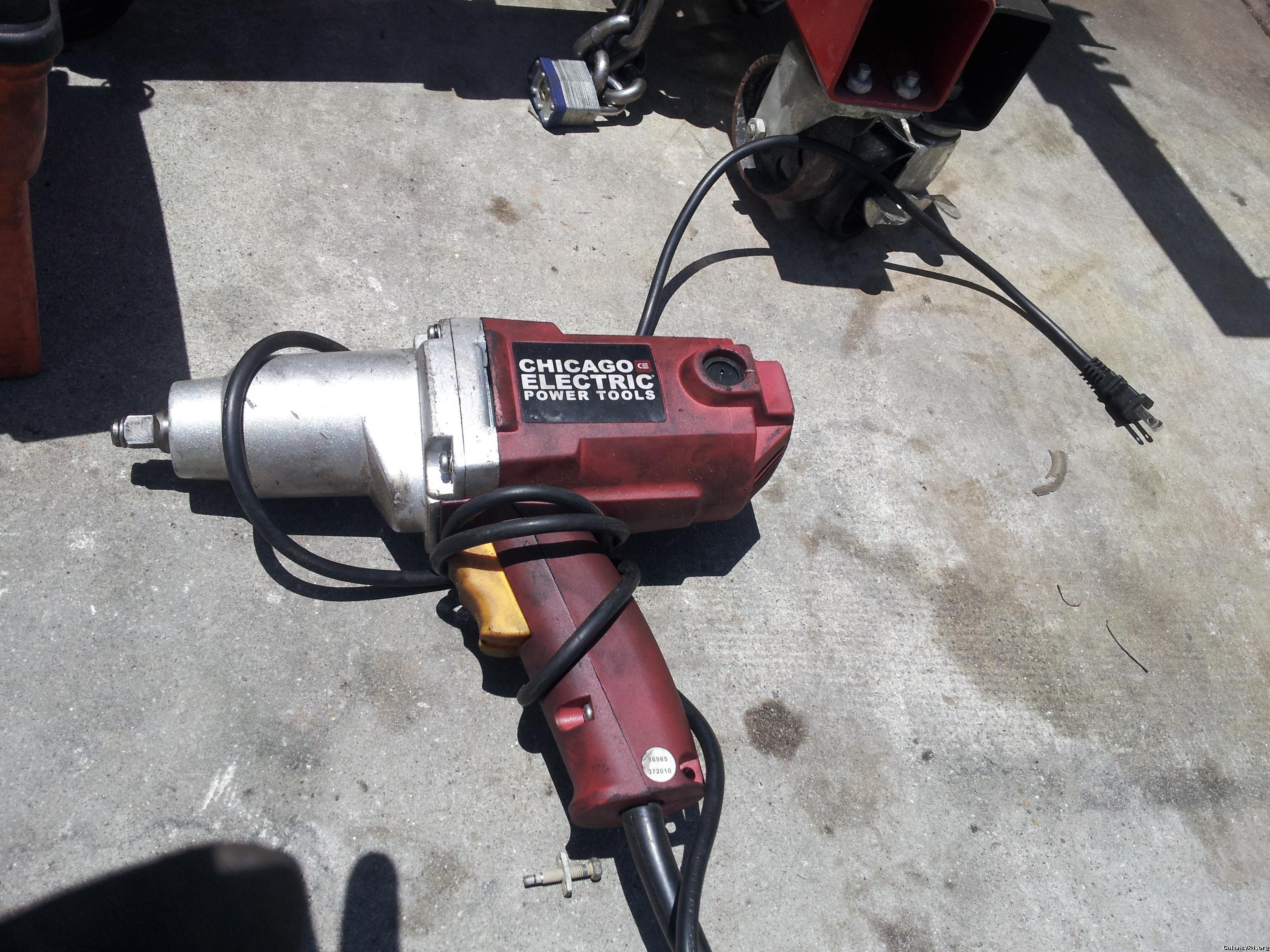

Yea used to have the same problem its kind of a pain without a impact gun you should invest in one of theses there like 30 to 40 bucks at harbor and work great I break fly wheel bolts,crank pulley bolts with out a problem
