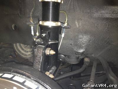

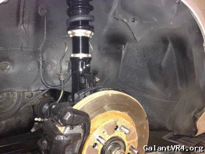

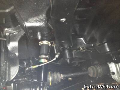

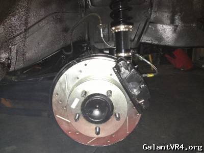

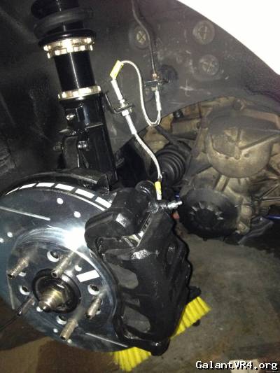

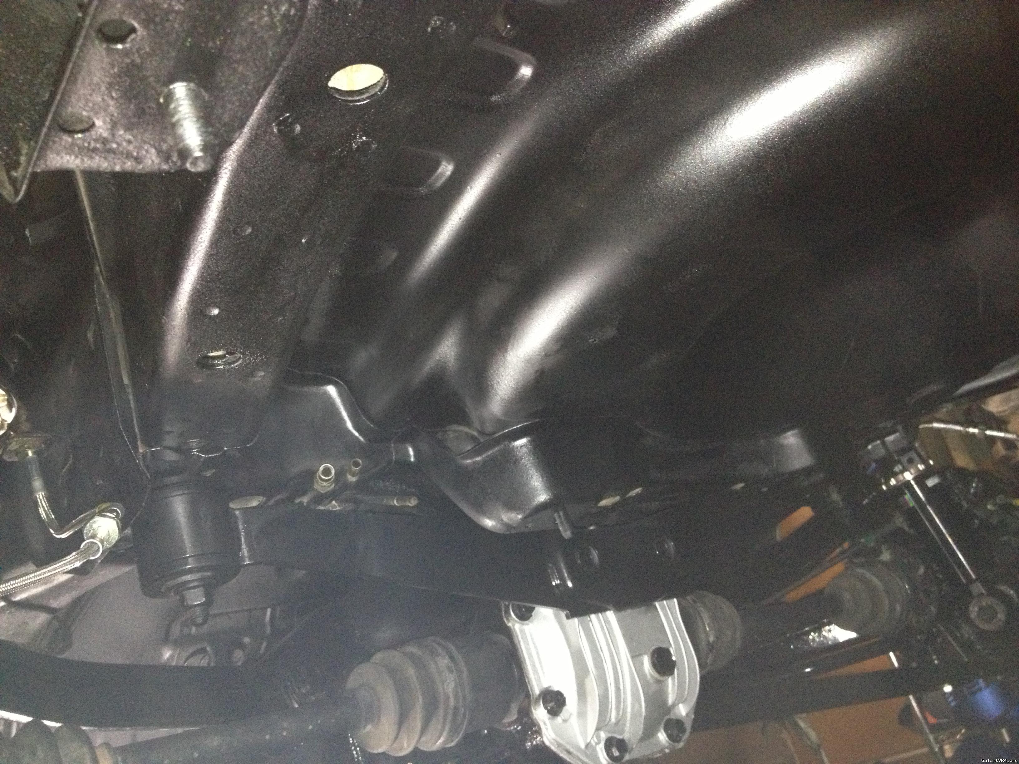

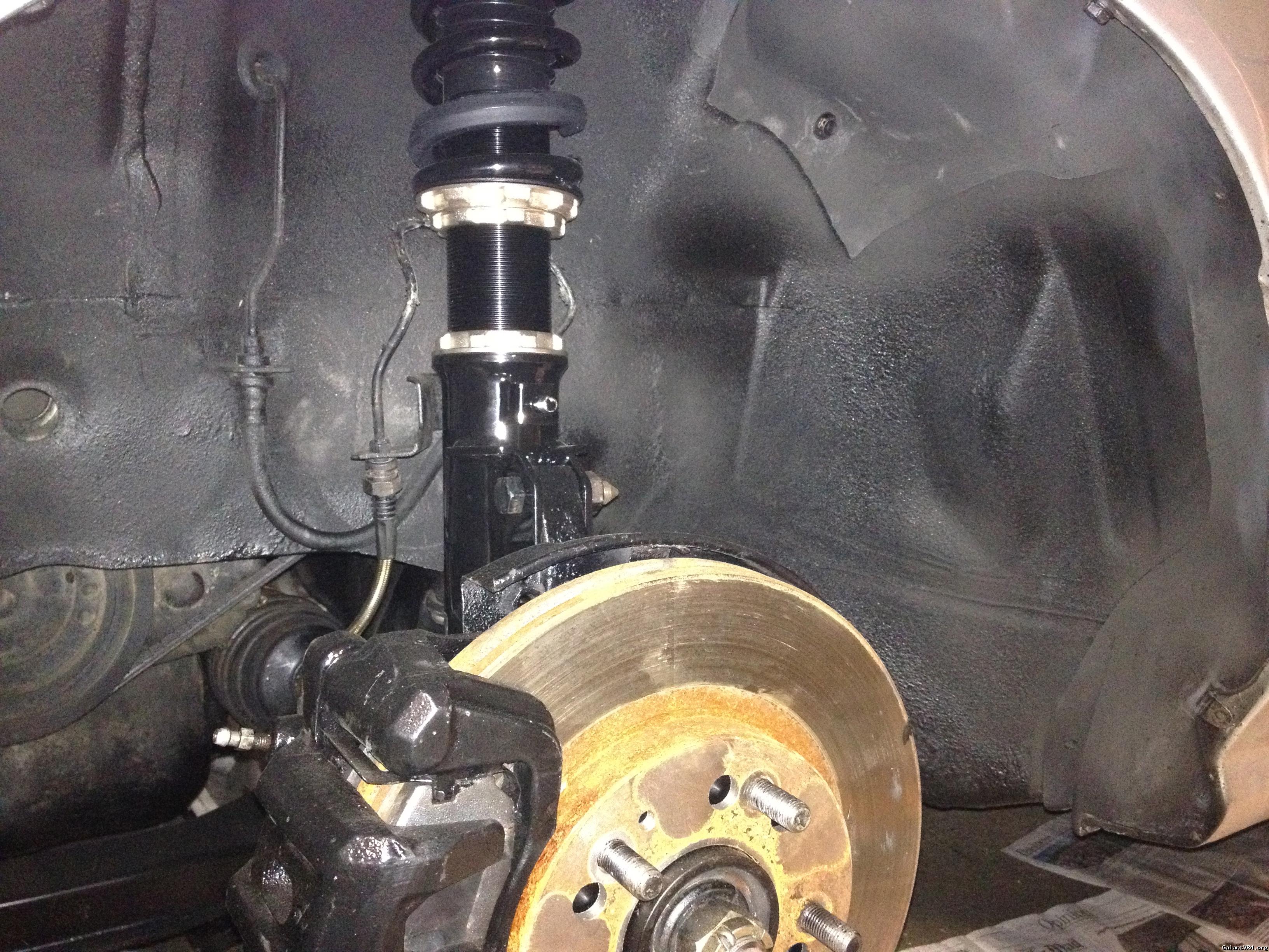

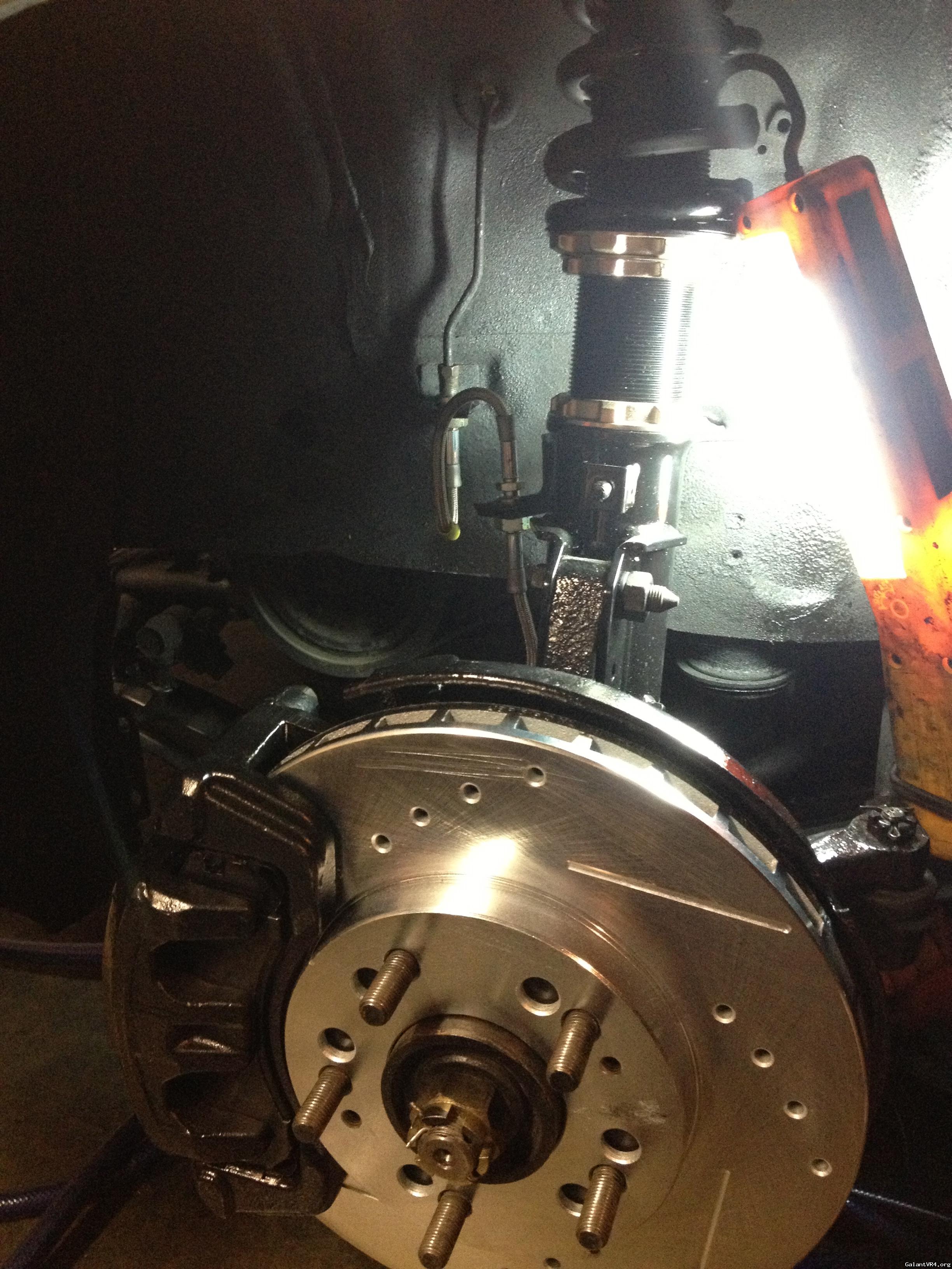

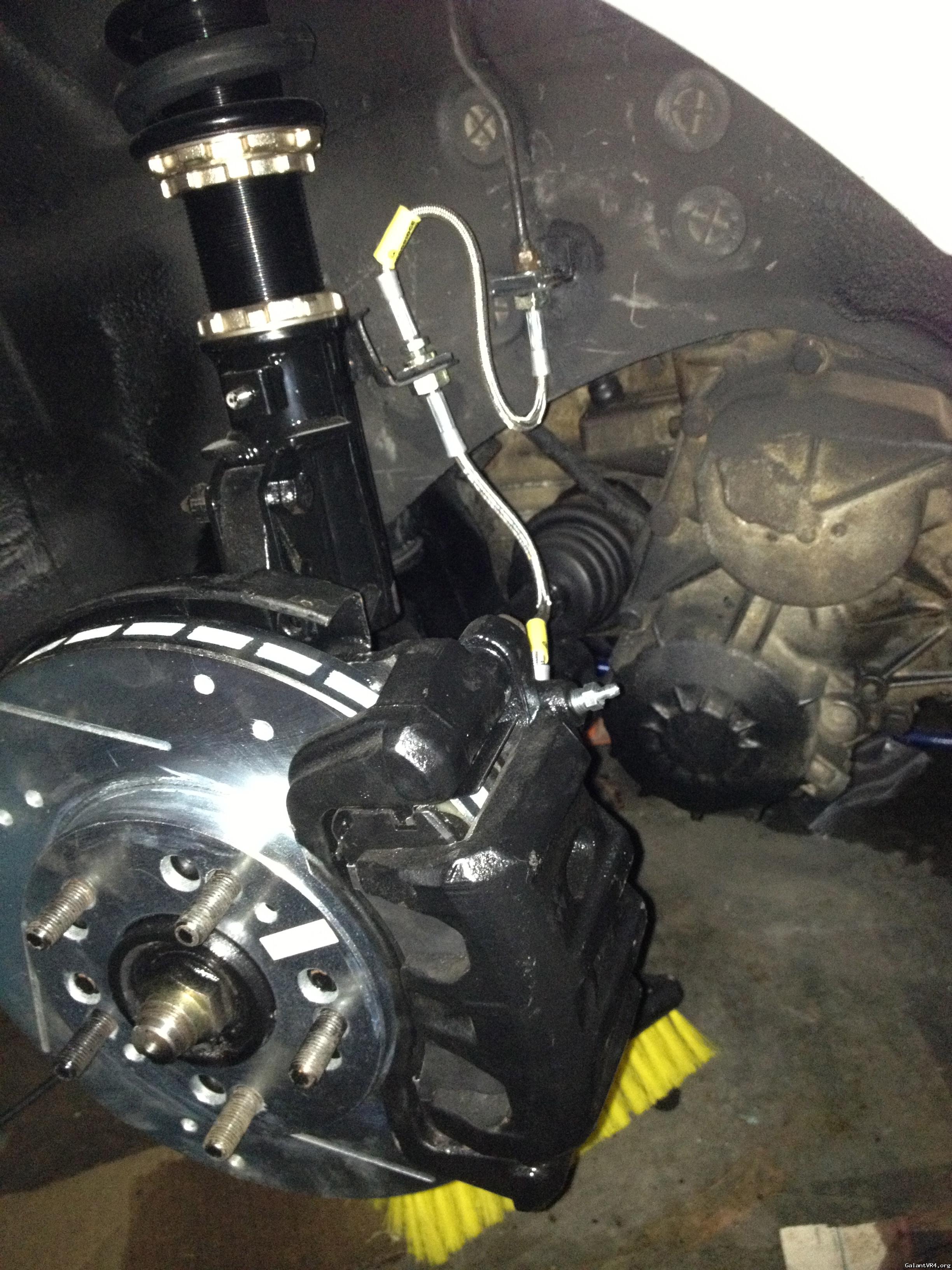

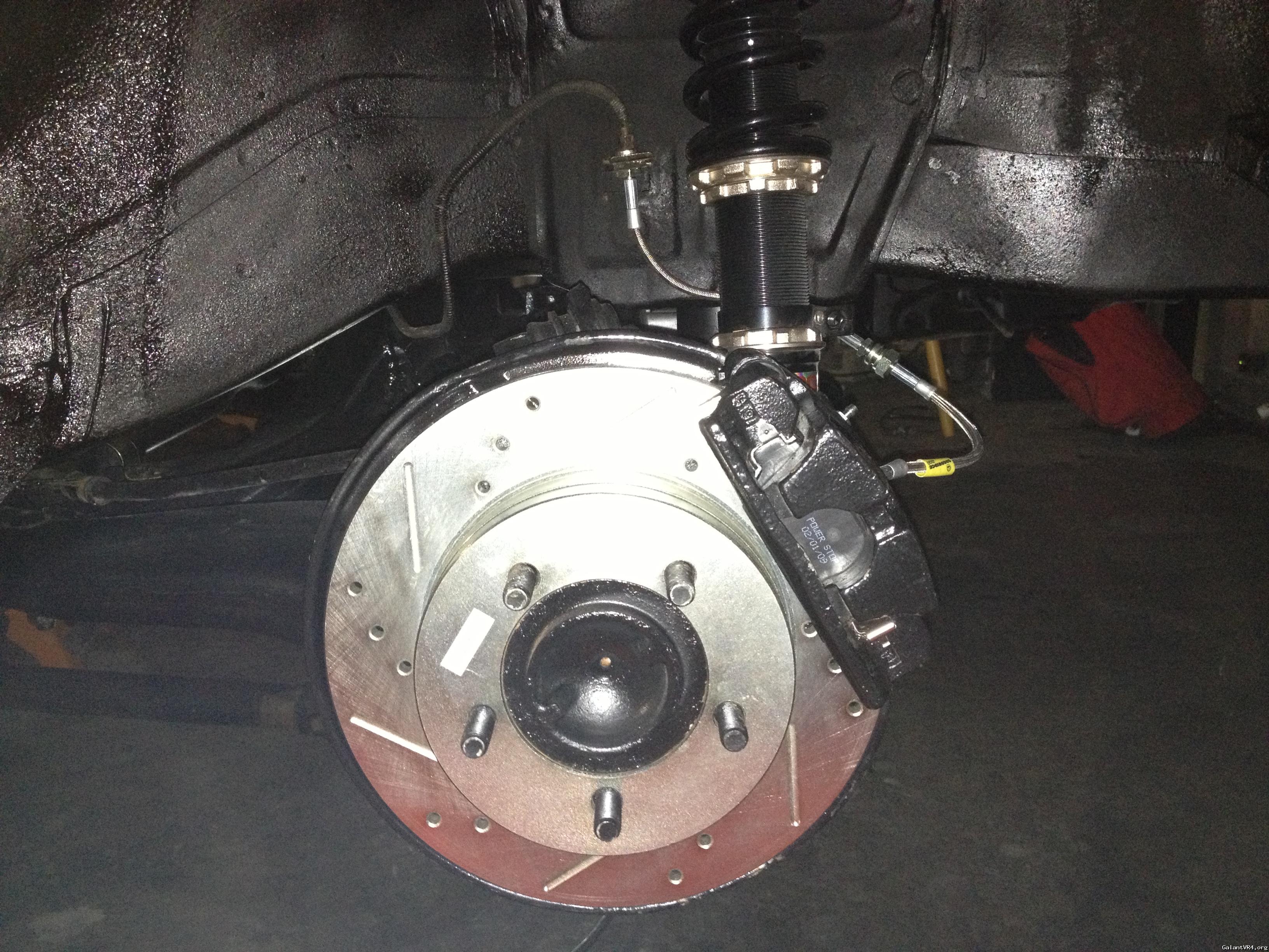

With Old Brakes back on:

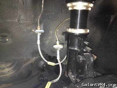

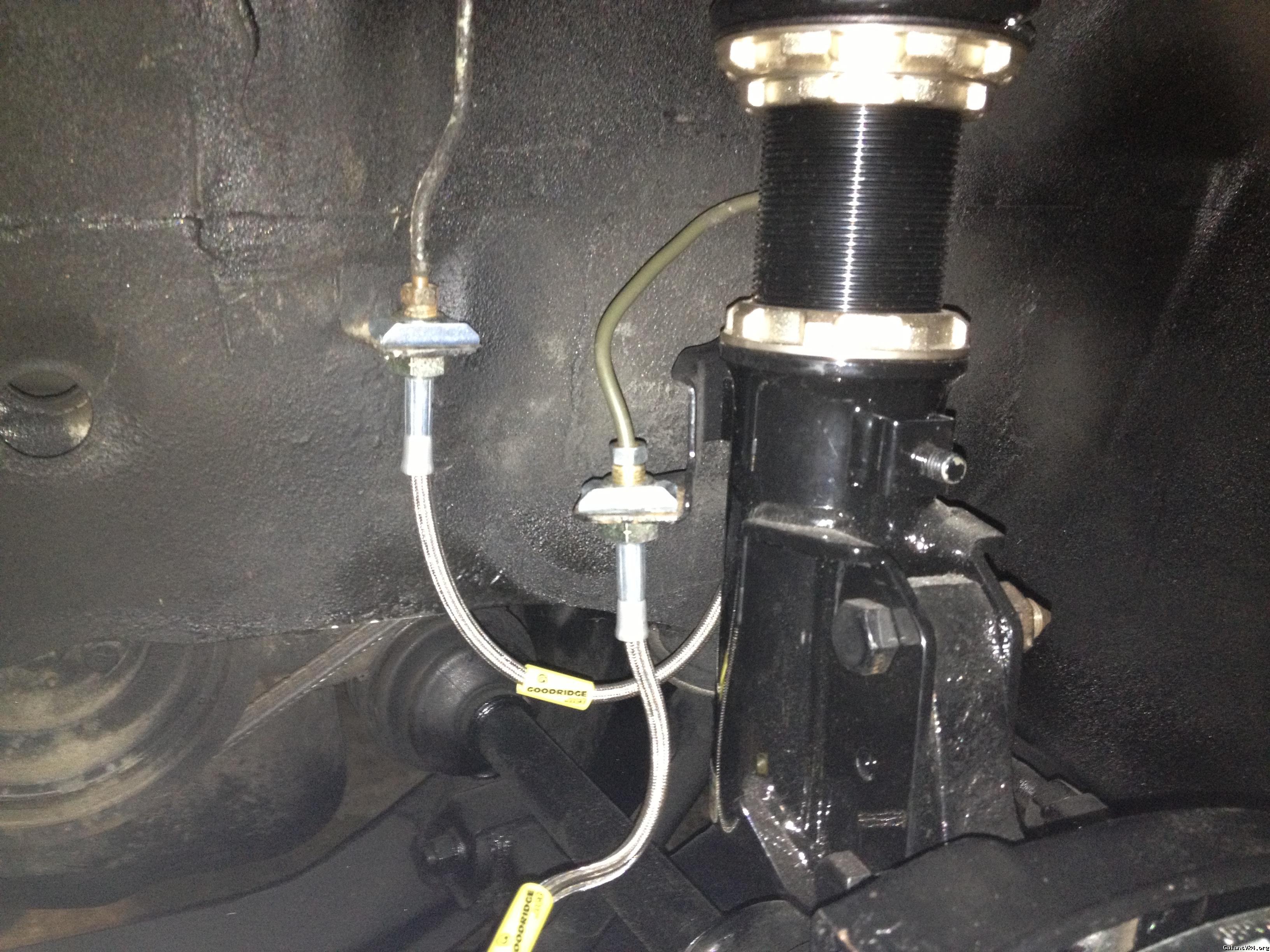

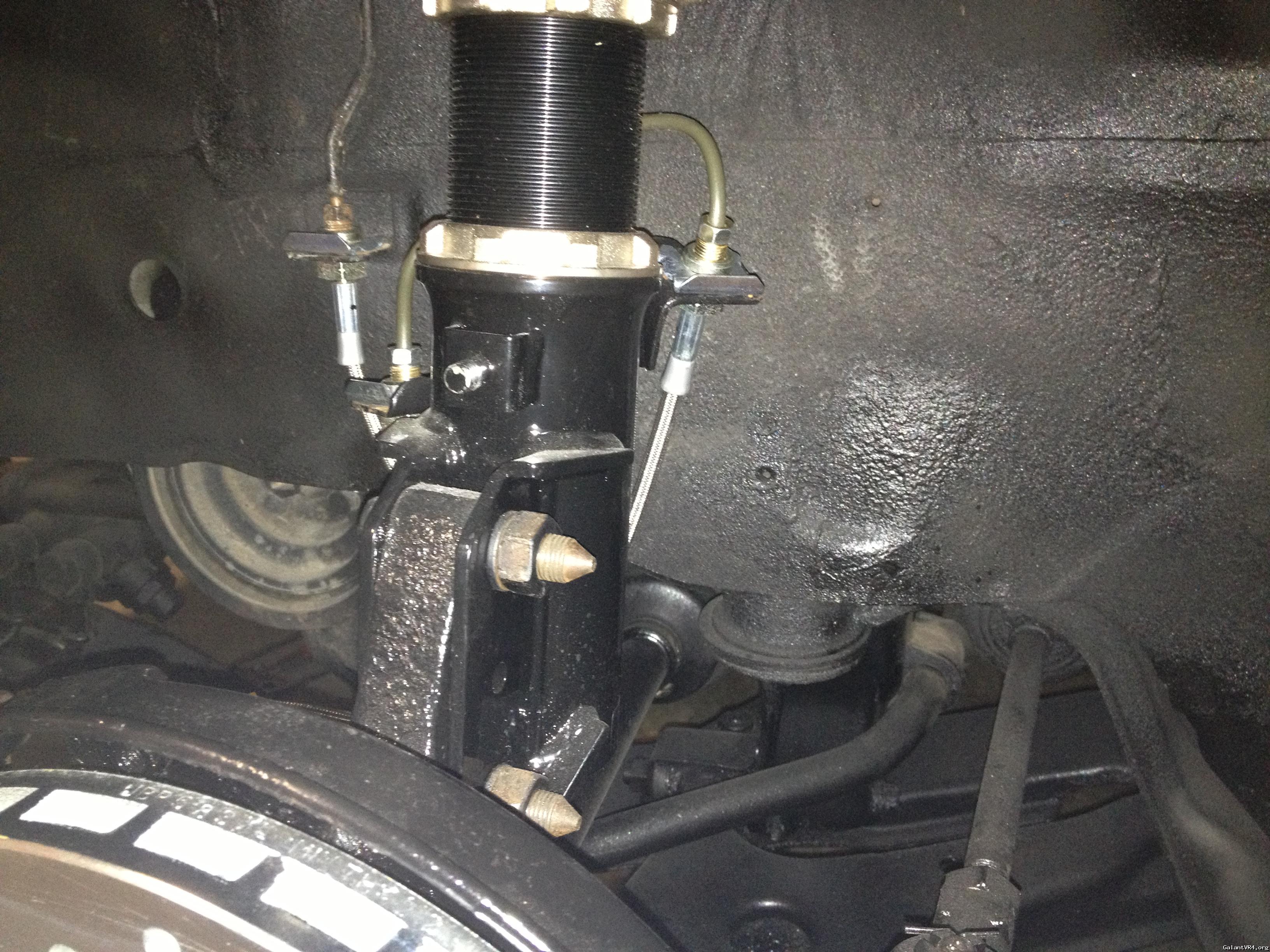

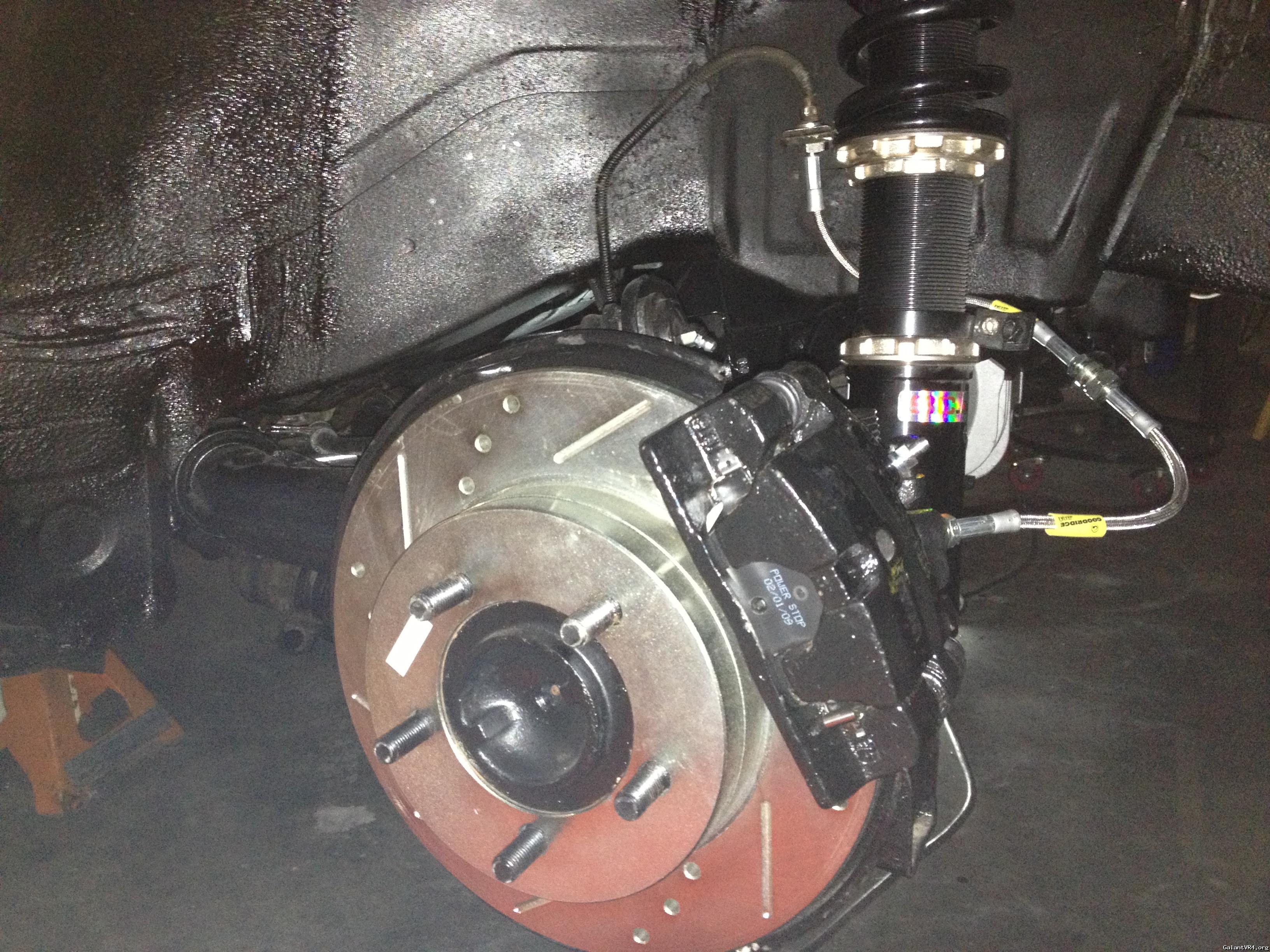

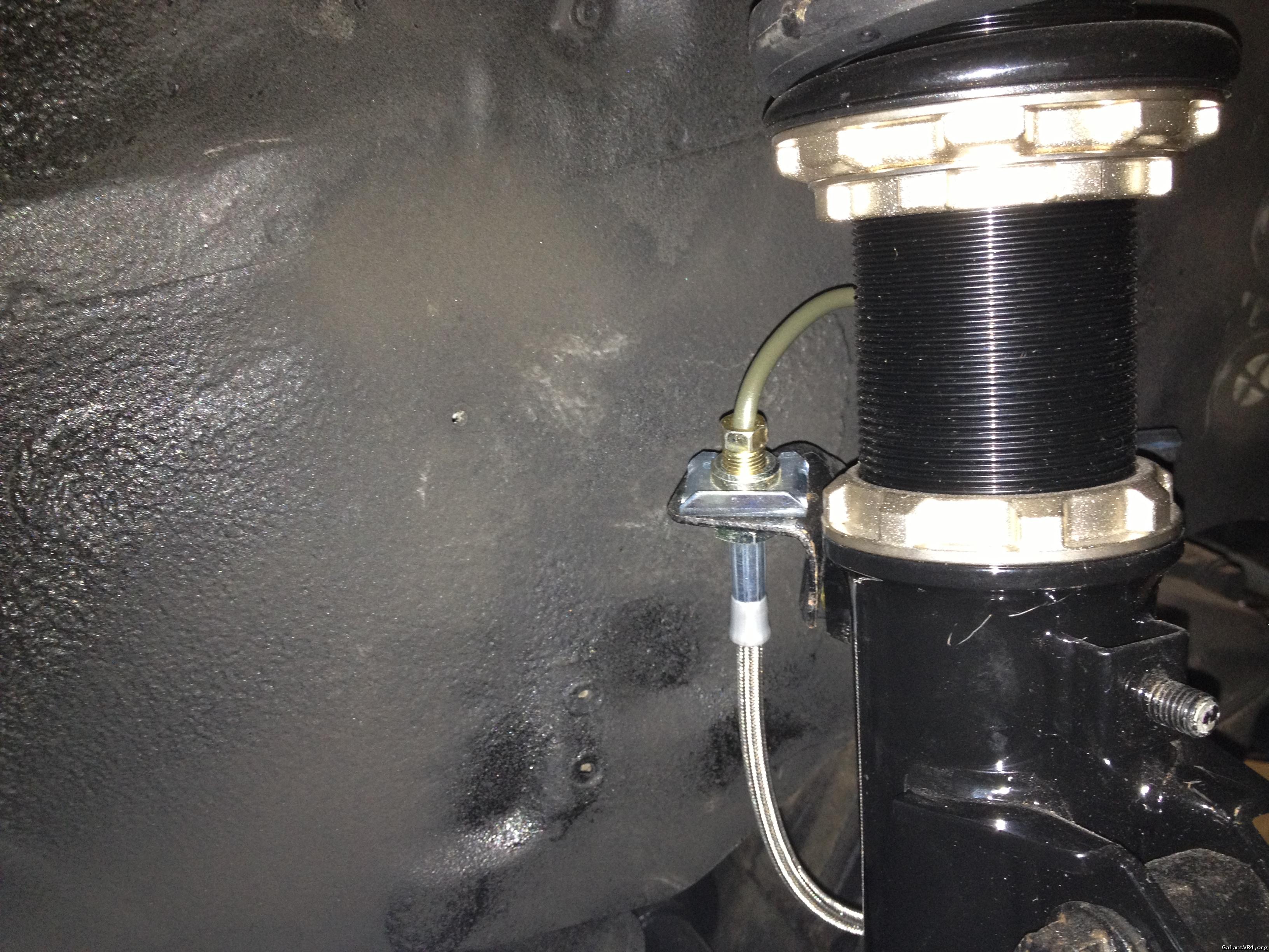

Later with new rotors and goodridge SS lines
Had to use new hardline to allow the lines to get full movement in steering

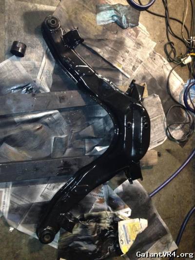

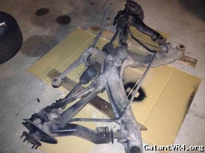

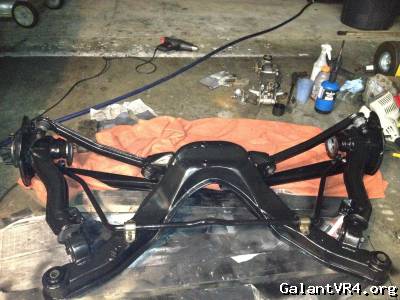

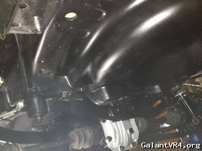

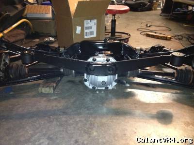

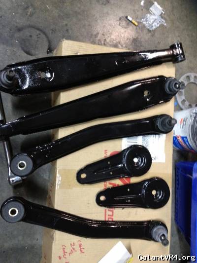

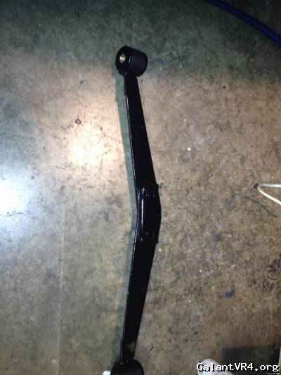

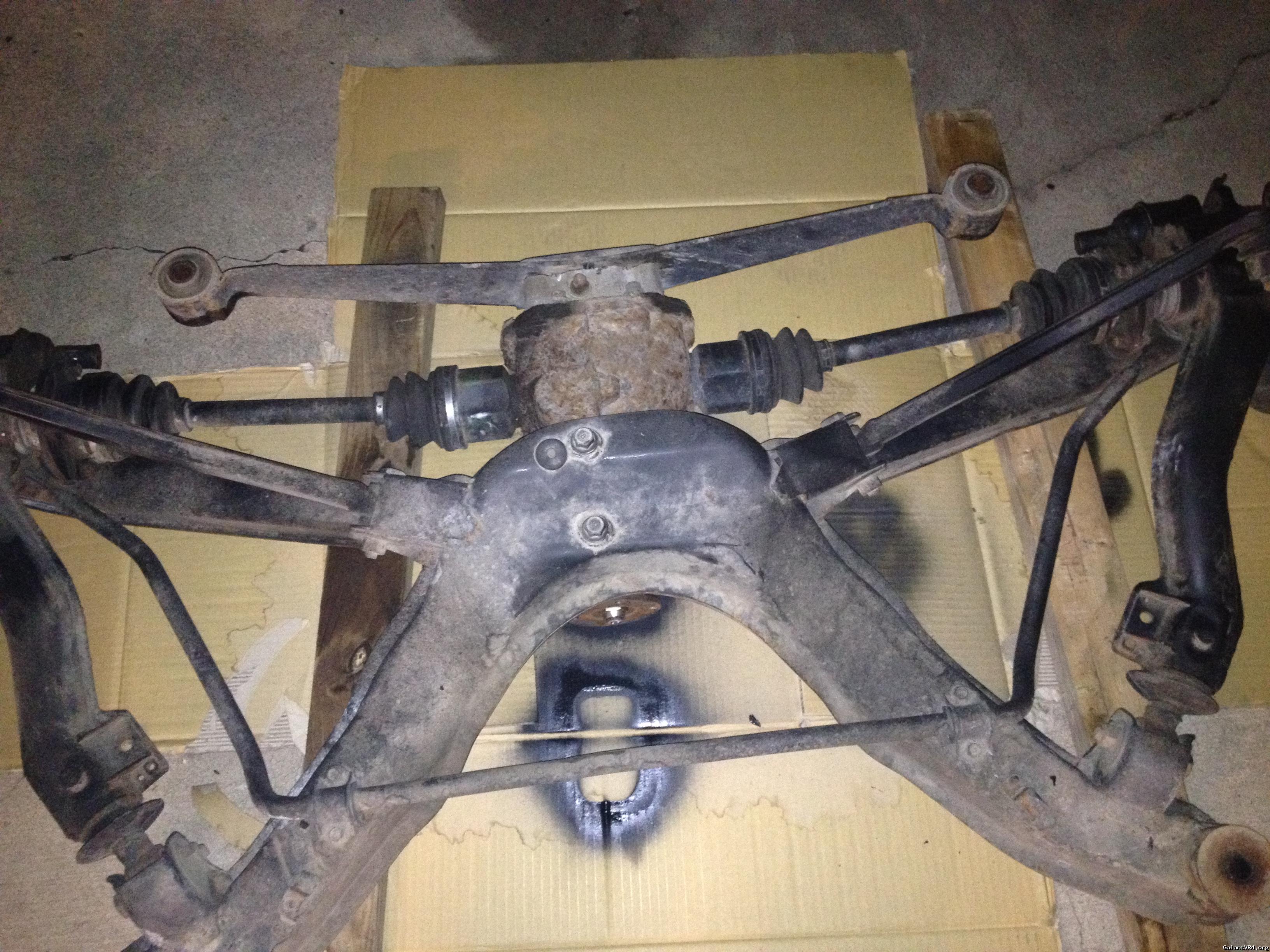

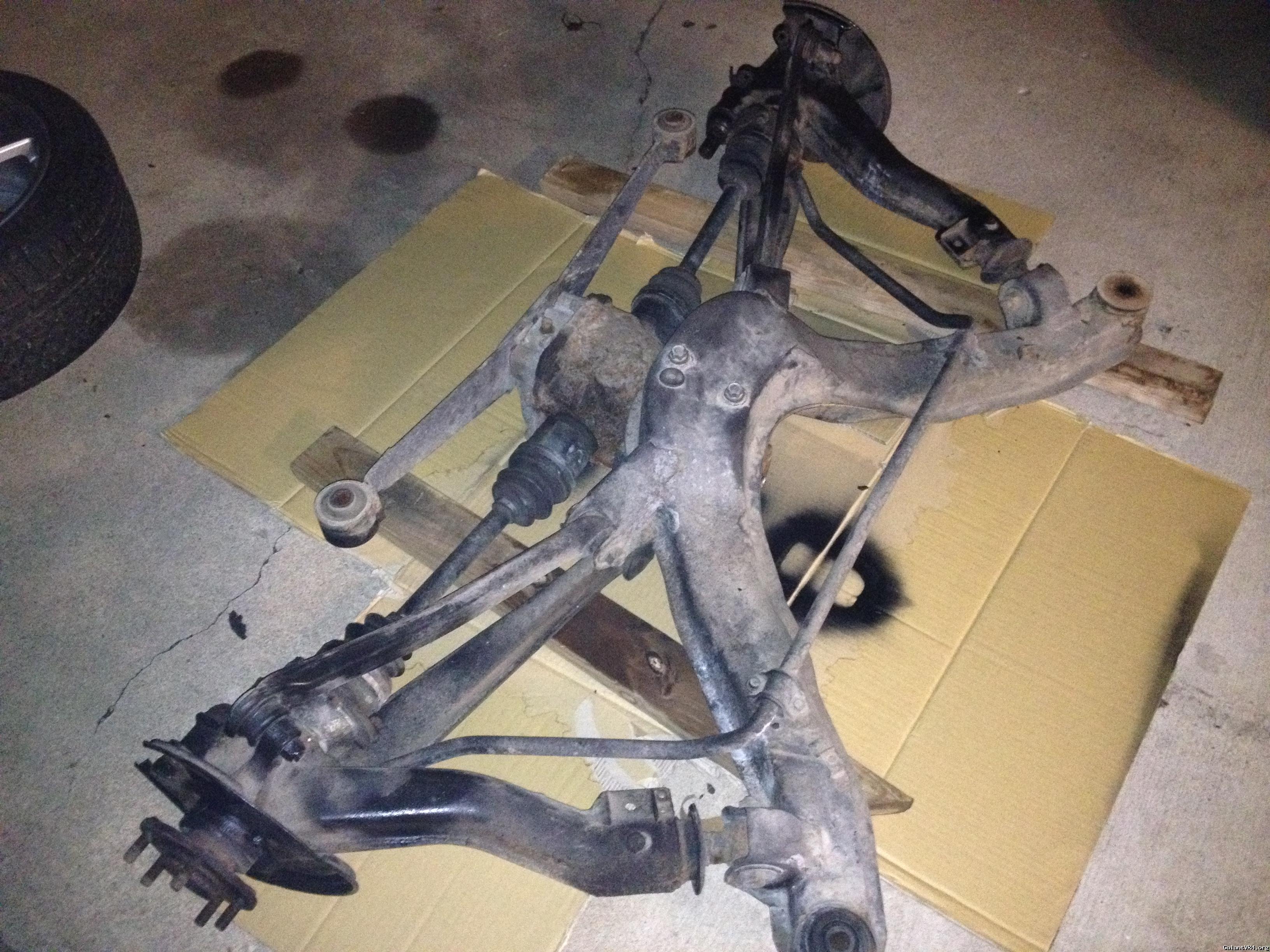

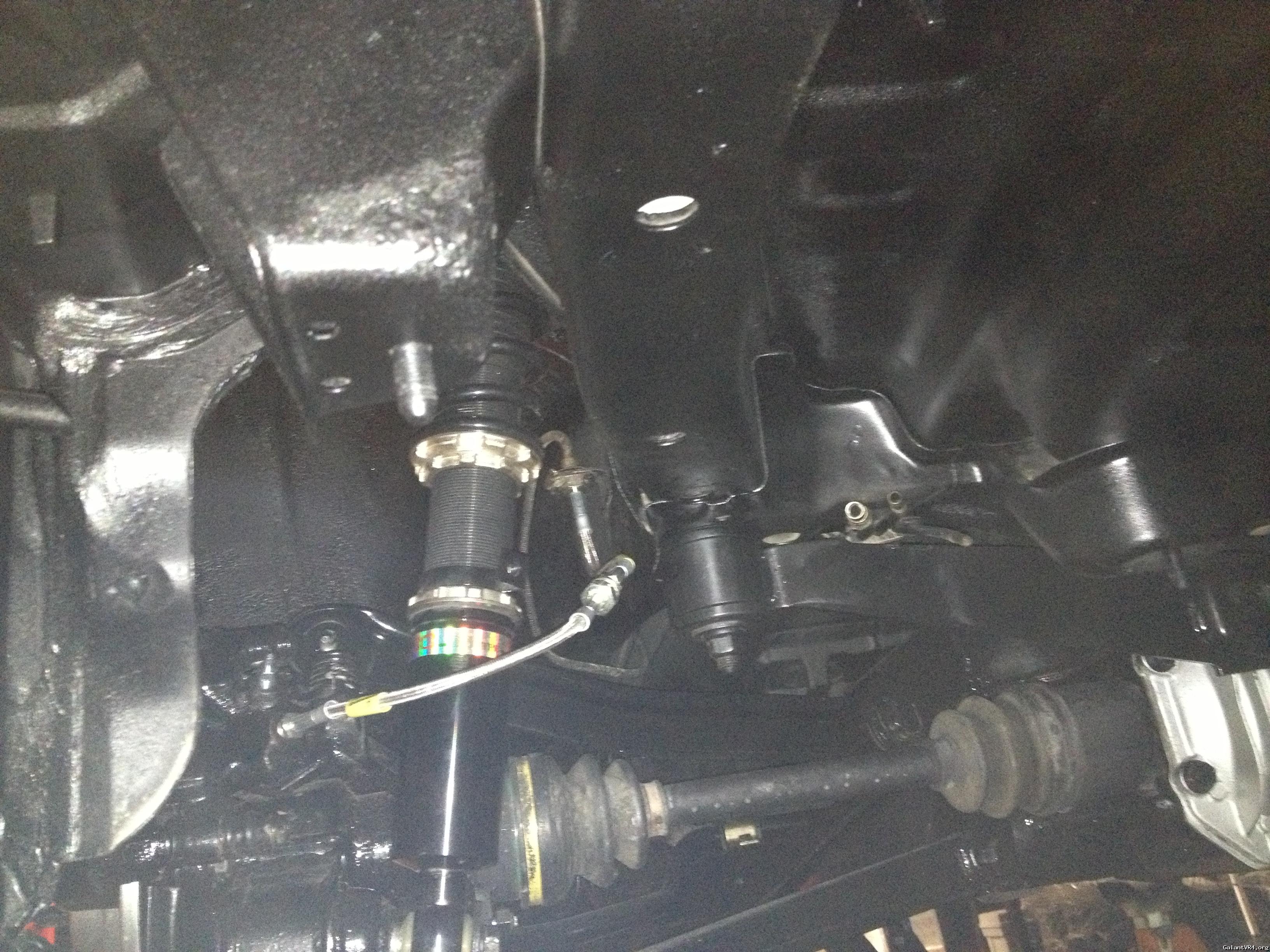

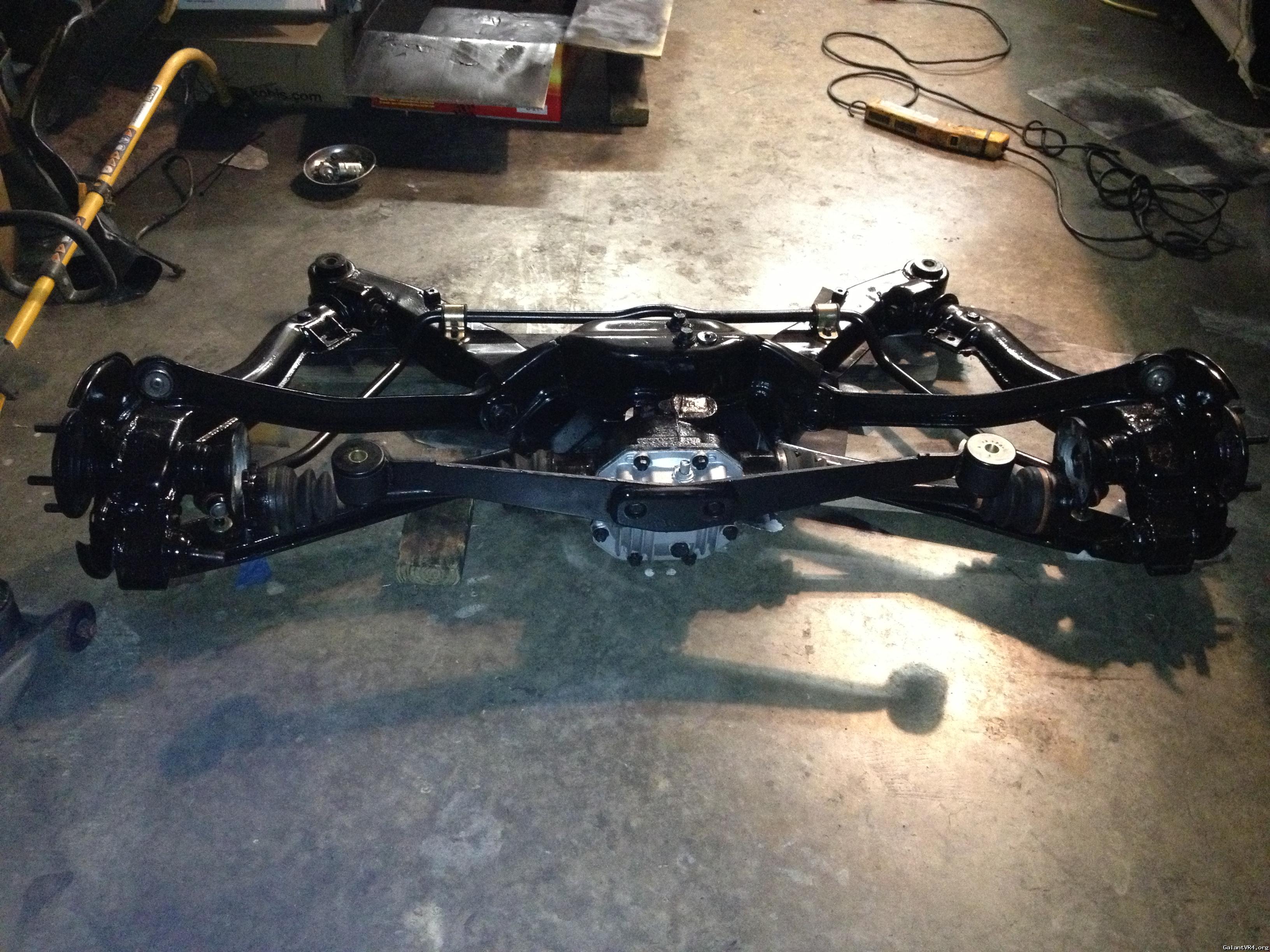

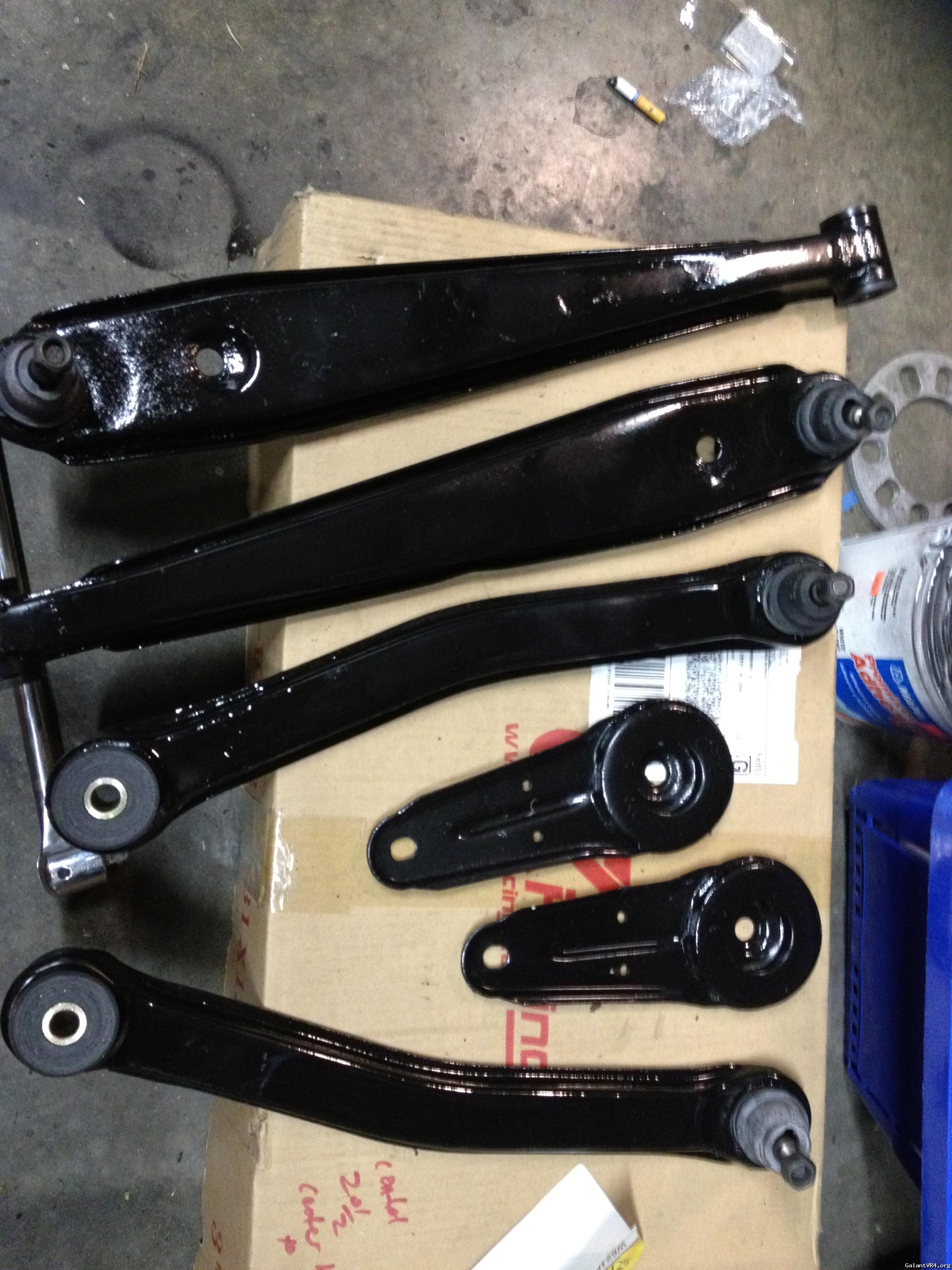

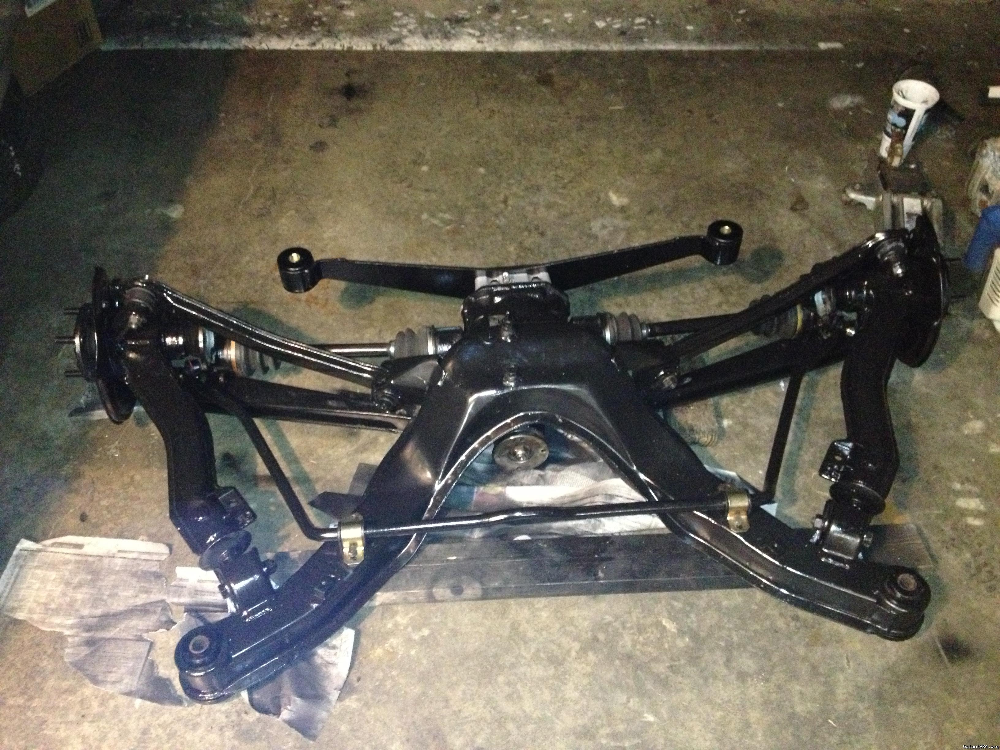

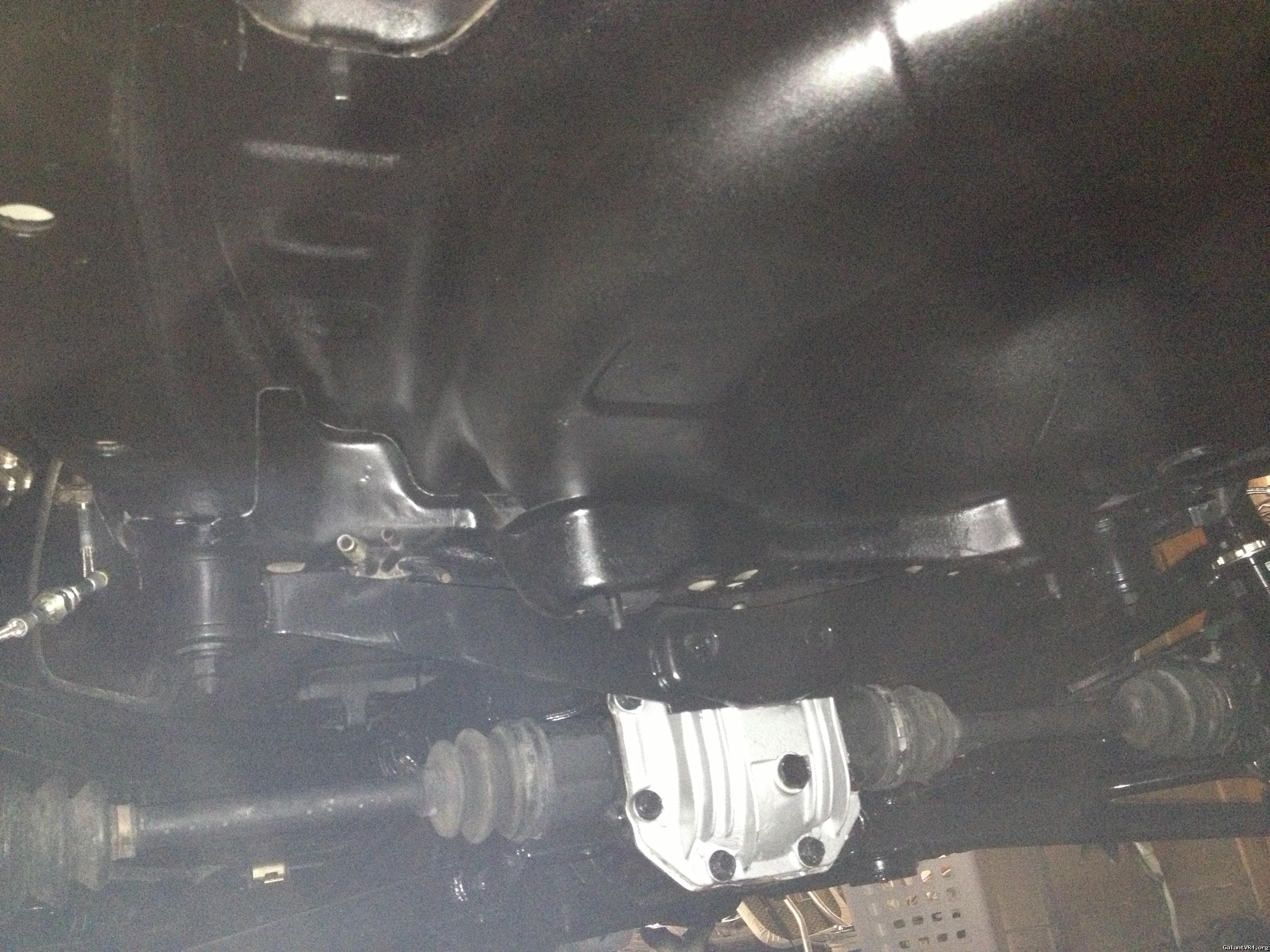

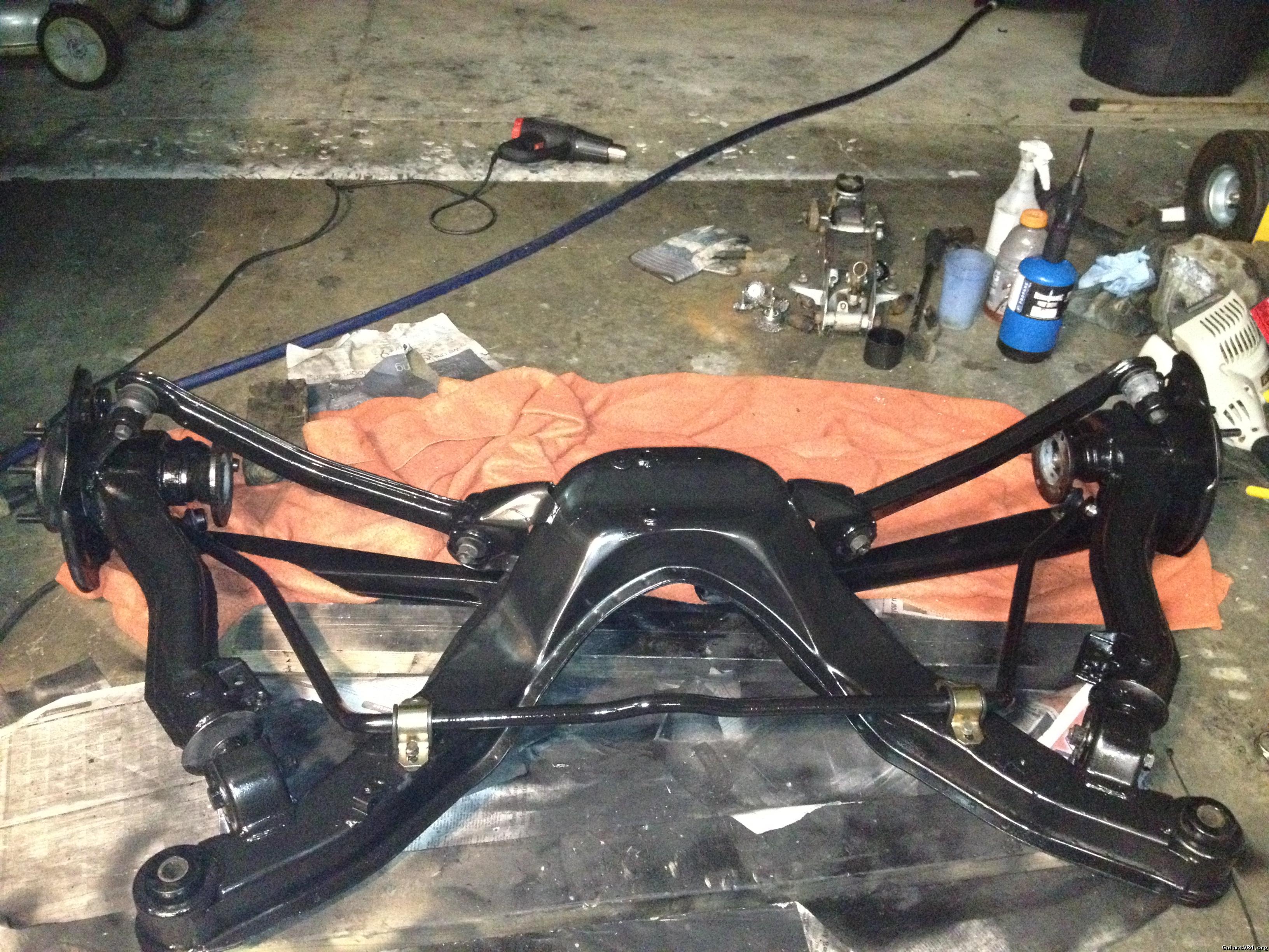

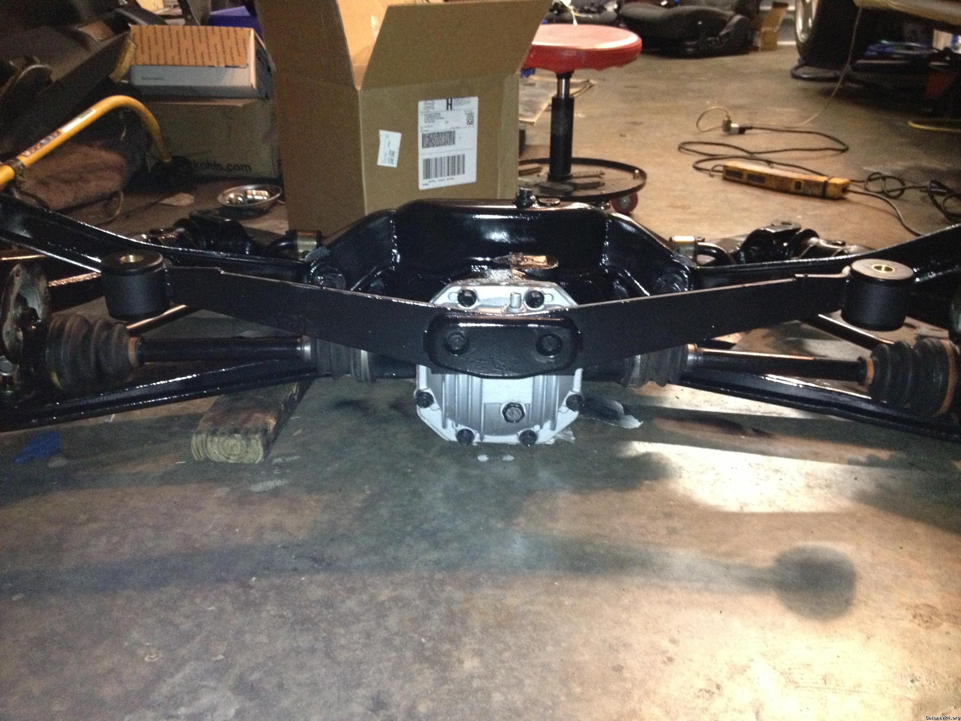

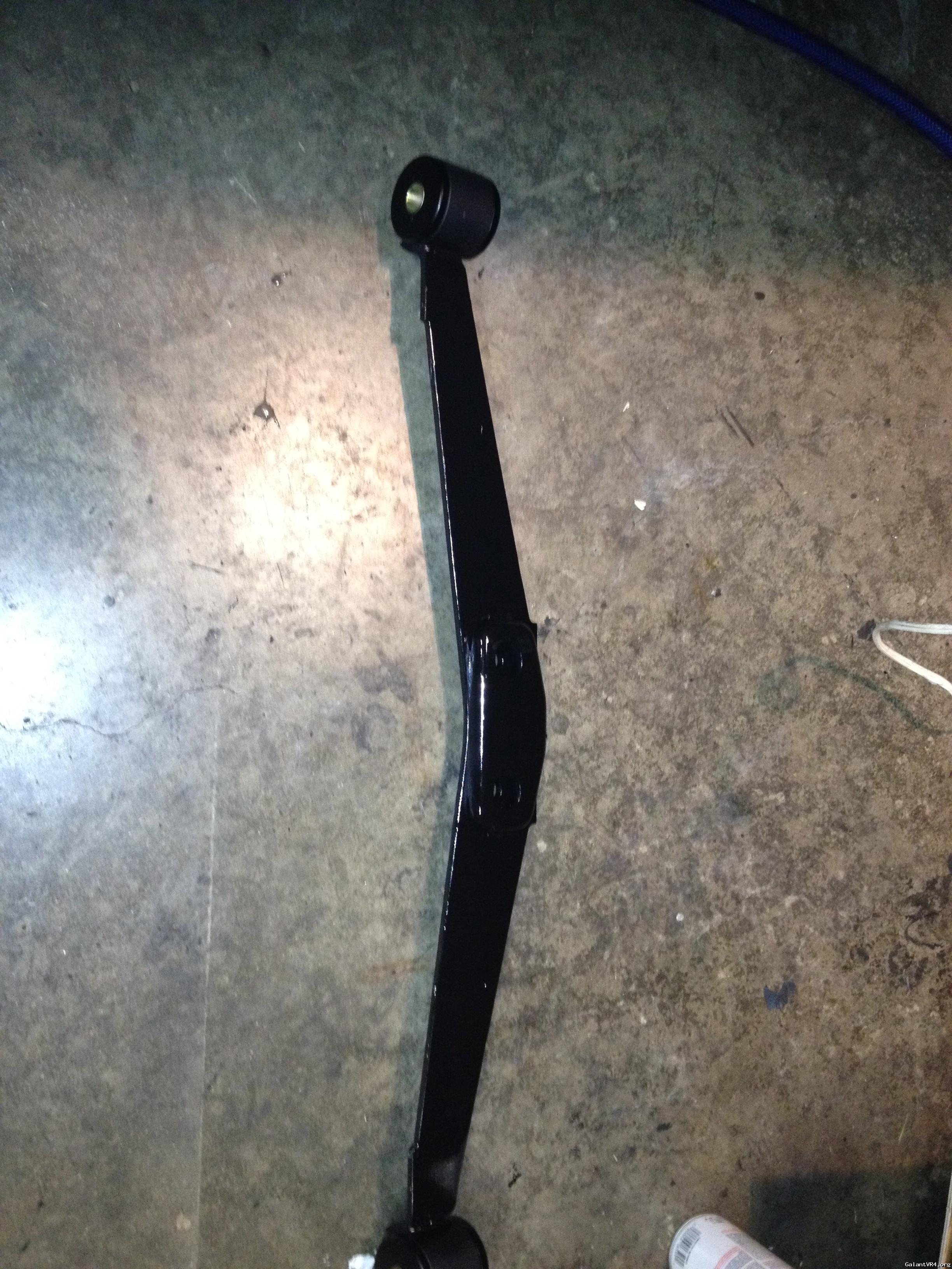

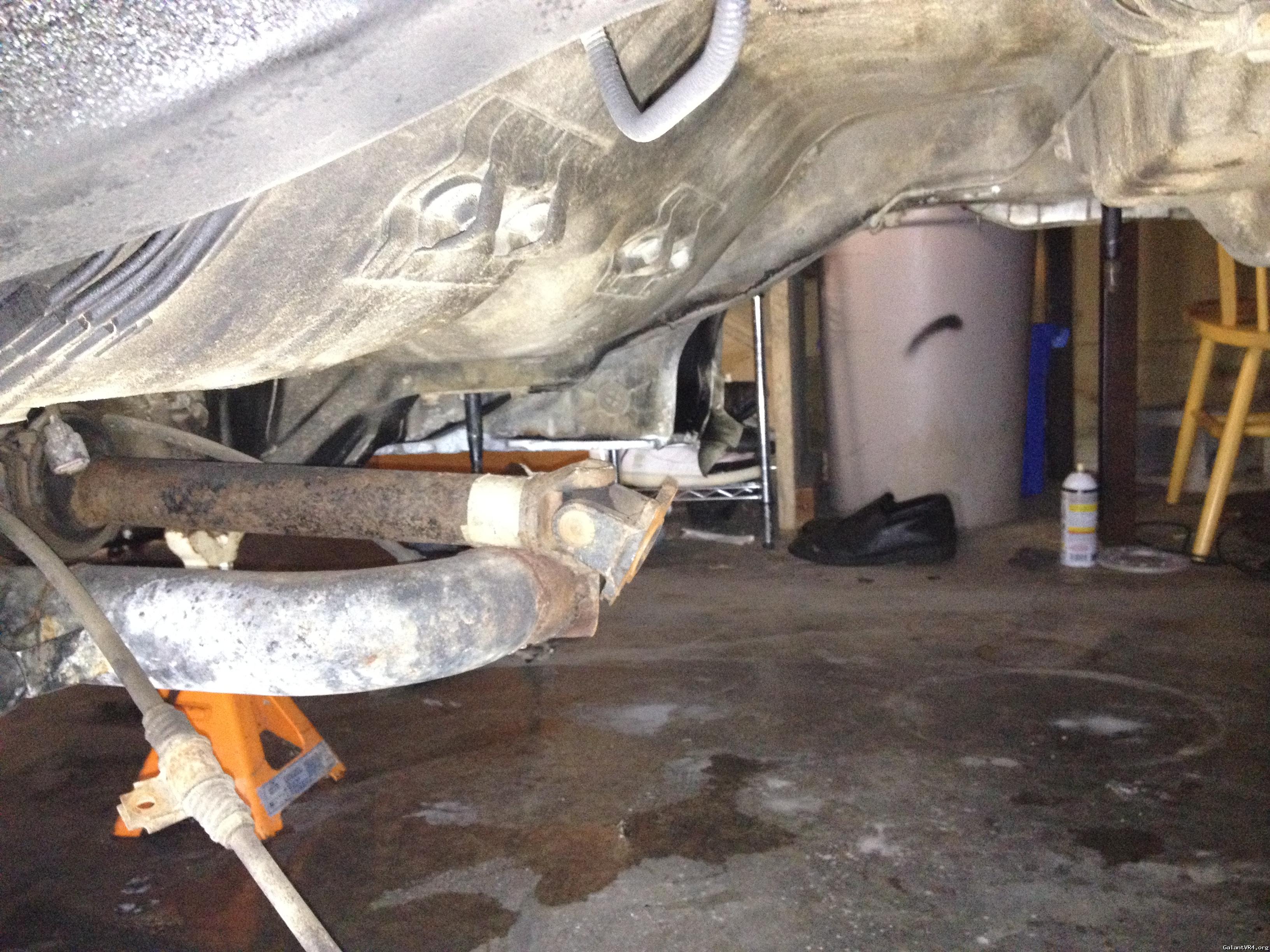

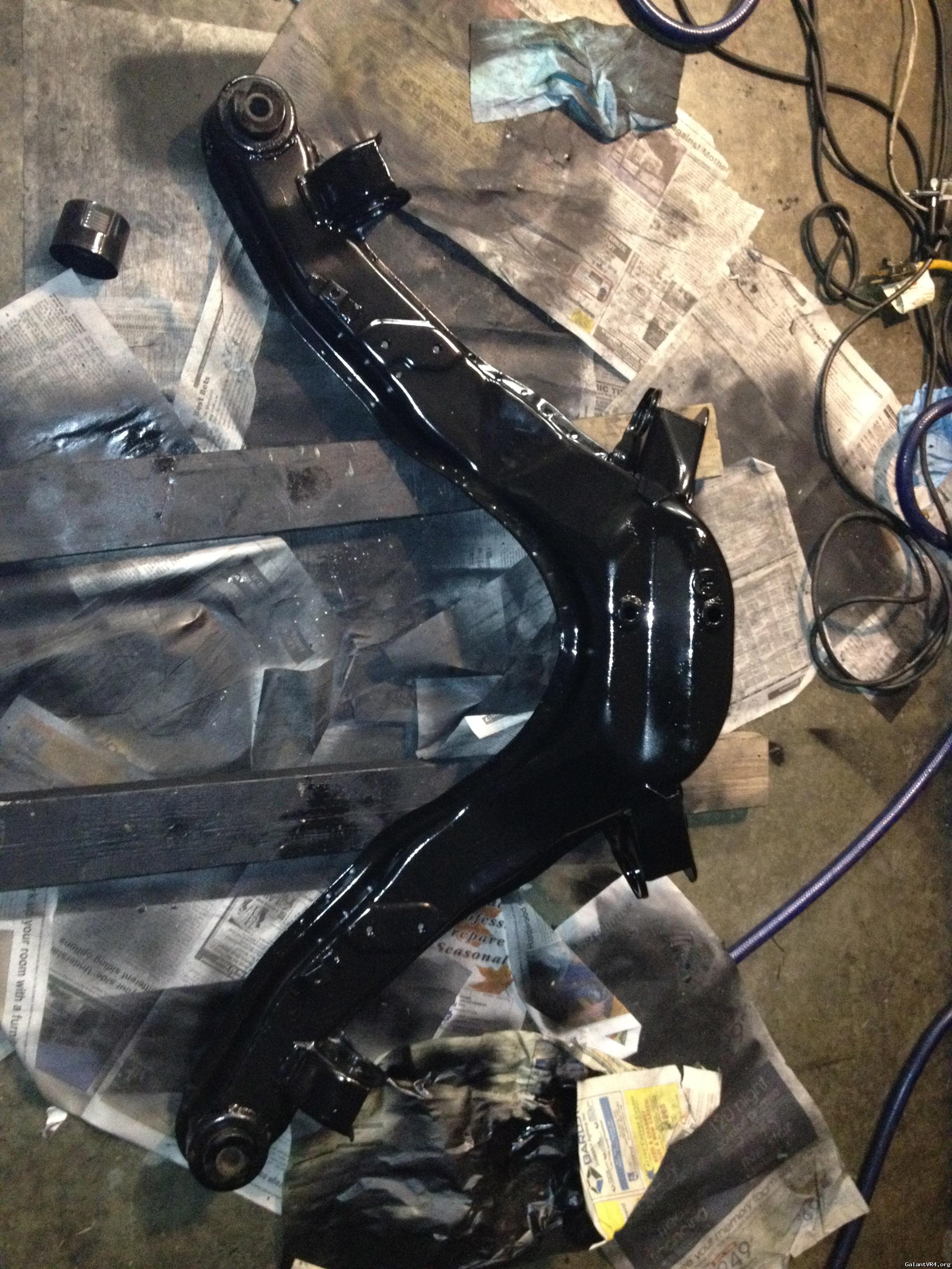

Rear End was completely stripped cleaned primed and painted along with all other rear end hardware
All ball joints and all new poly bushings installed

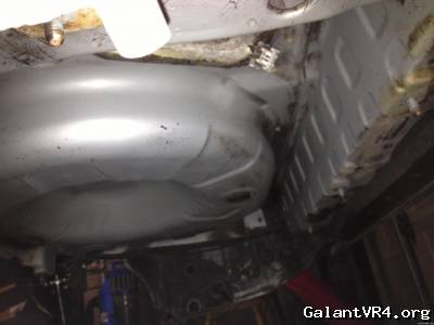

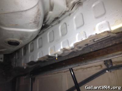

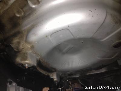

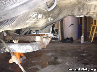

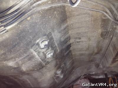

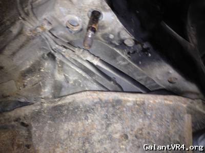

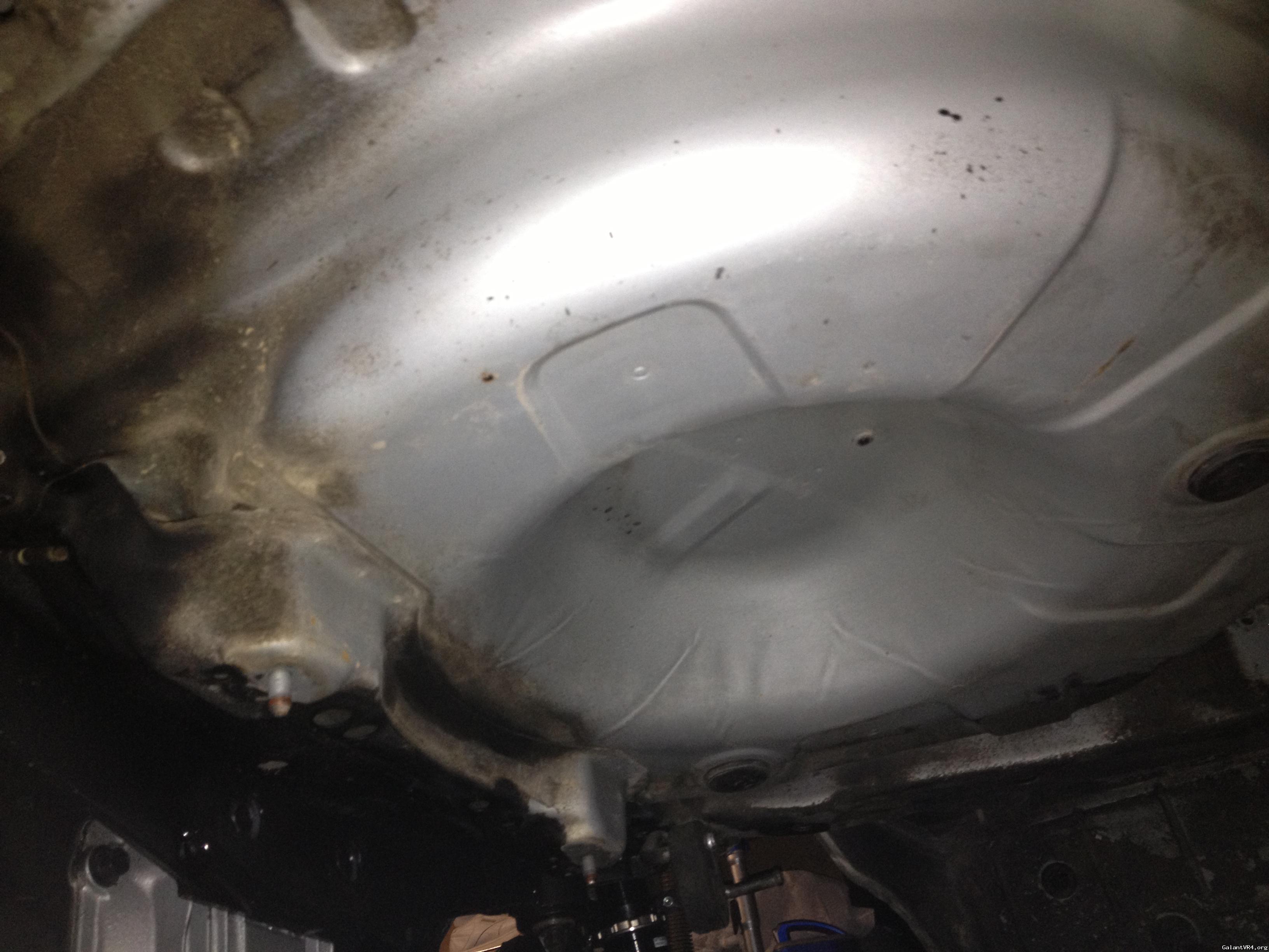

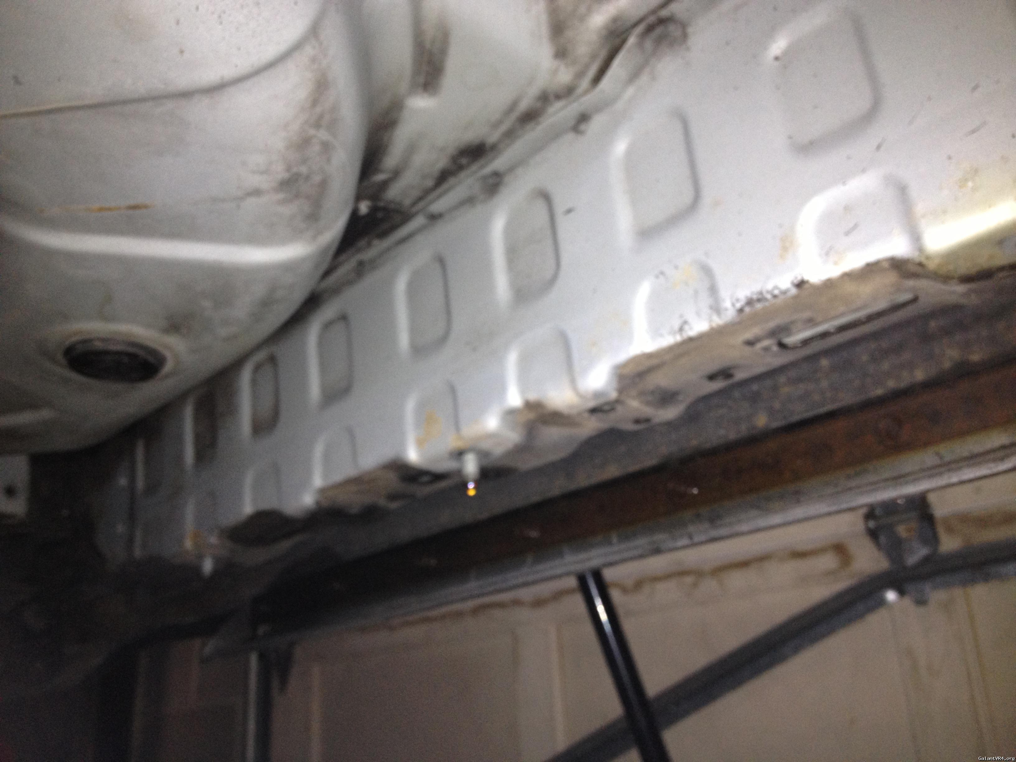

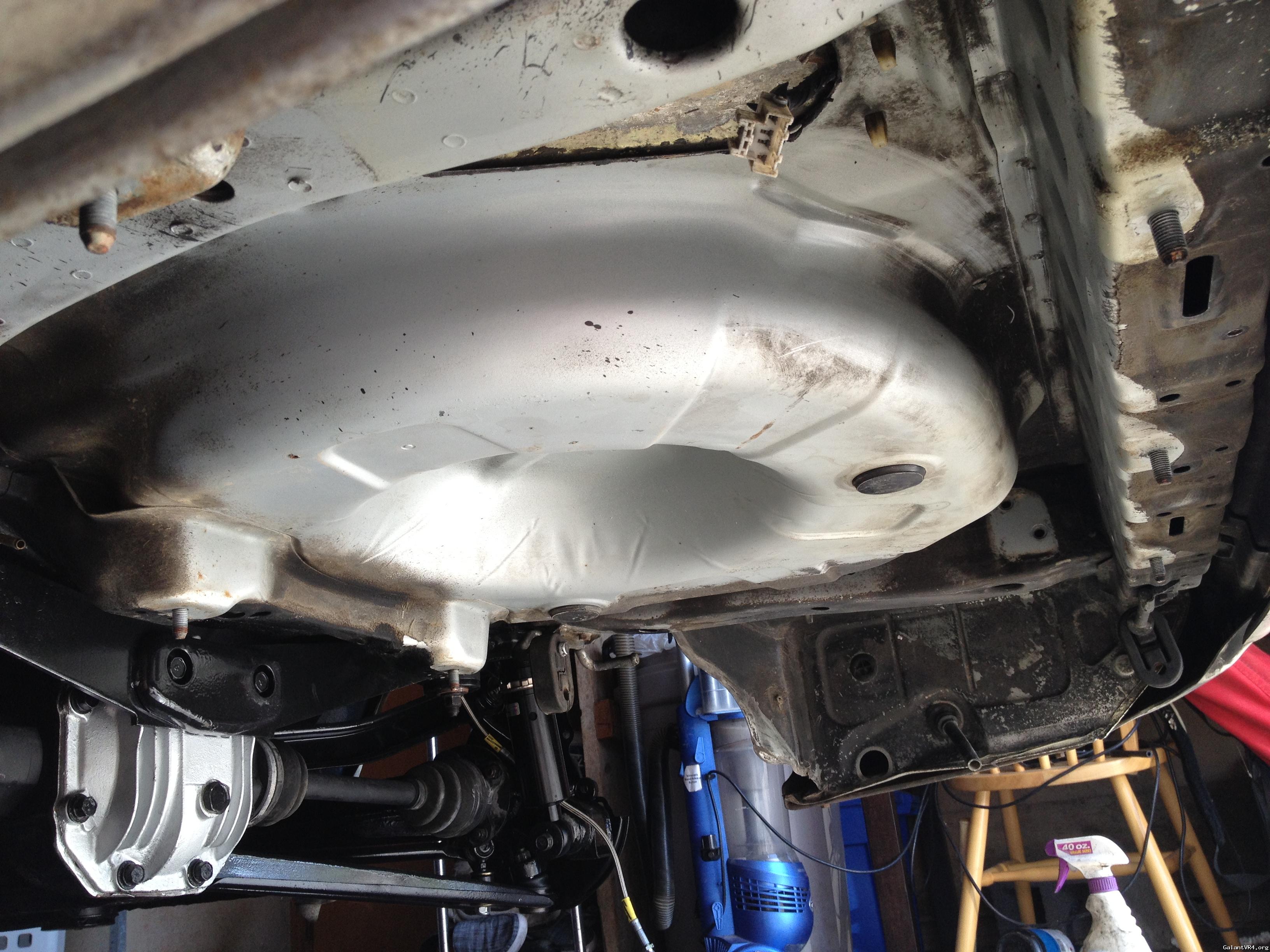

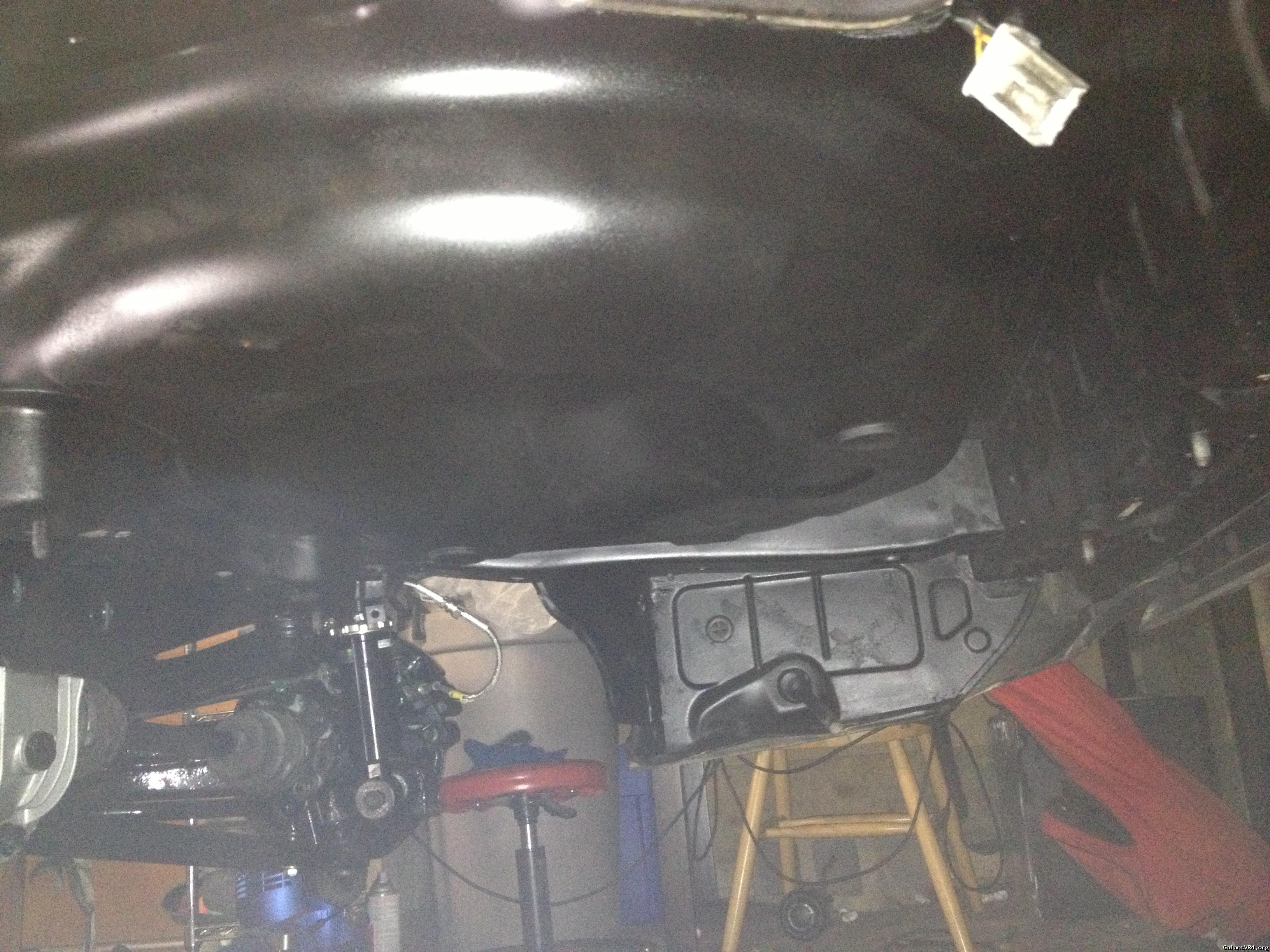

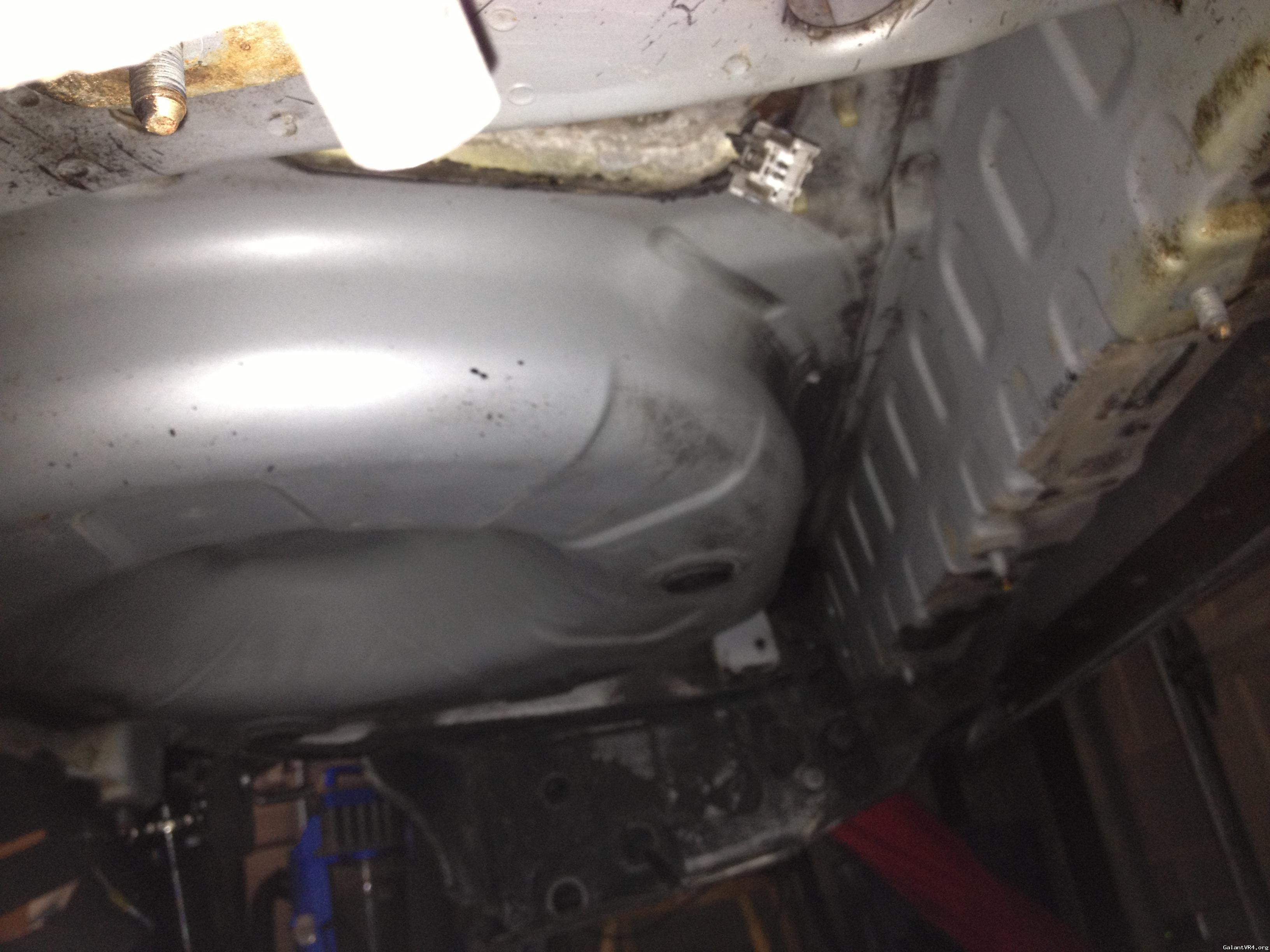

Removed Rear Gas Tank (Switching to Fuel Cell and custom lines) Didn't want to hack up a really nice sending unit and tank so they were sold to good members on here. Cleaned and prepped everything for truck bed coating
IncorpoRatedX
May 28, 2003
5,593
Arizona
daaaaaaaamn! that's unlucky. I drove that thing everywhere, i'm lucky it didn't leave me stranded somewhere! I had a spare short block in my garage that I kept around just in case something happened between my two Galants. Had I know that issue would arise I would have just swapped it out, instead I wound up putting the spare engine into my wagon.
Build looks great so far, the previous owner was out of Iowa and lived on a dirt road, that might explain the dirt/dust/rocks, previous to him the owner was from colorado, could further explain the dirt and rocks as I don't think they use salt in CO, just dirt.

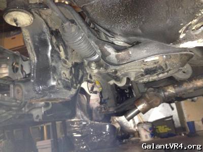

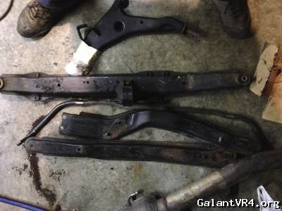

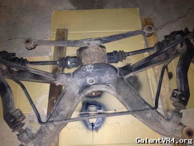

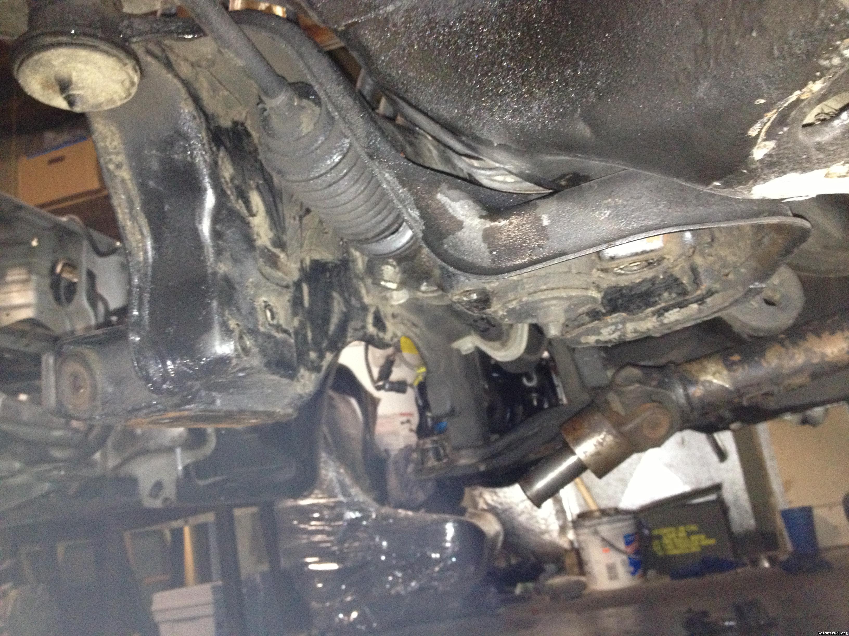

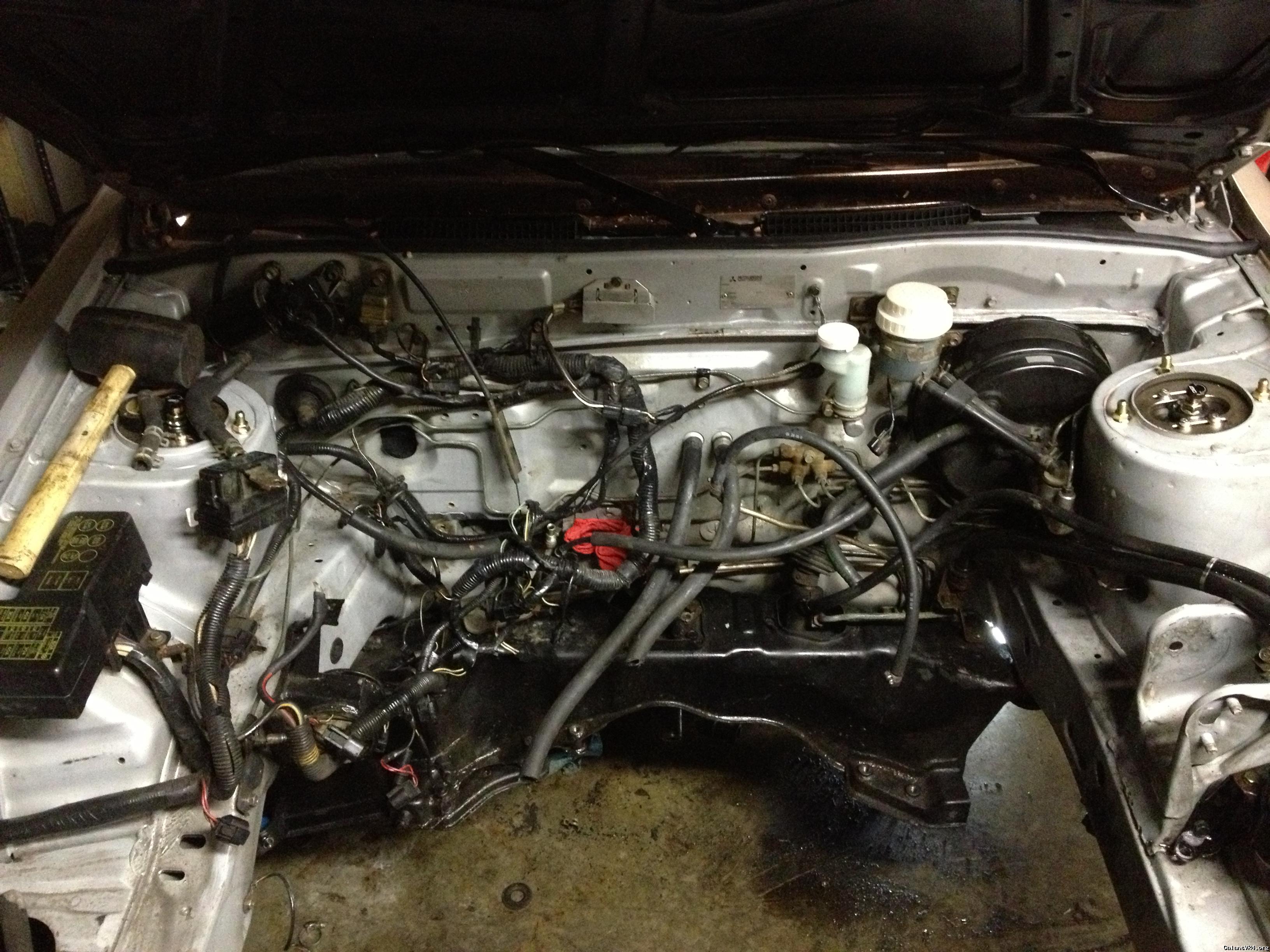

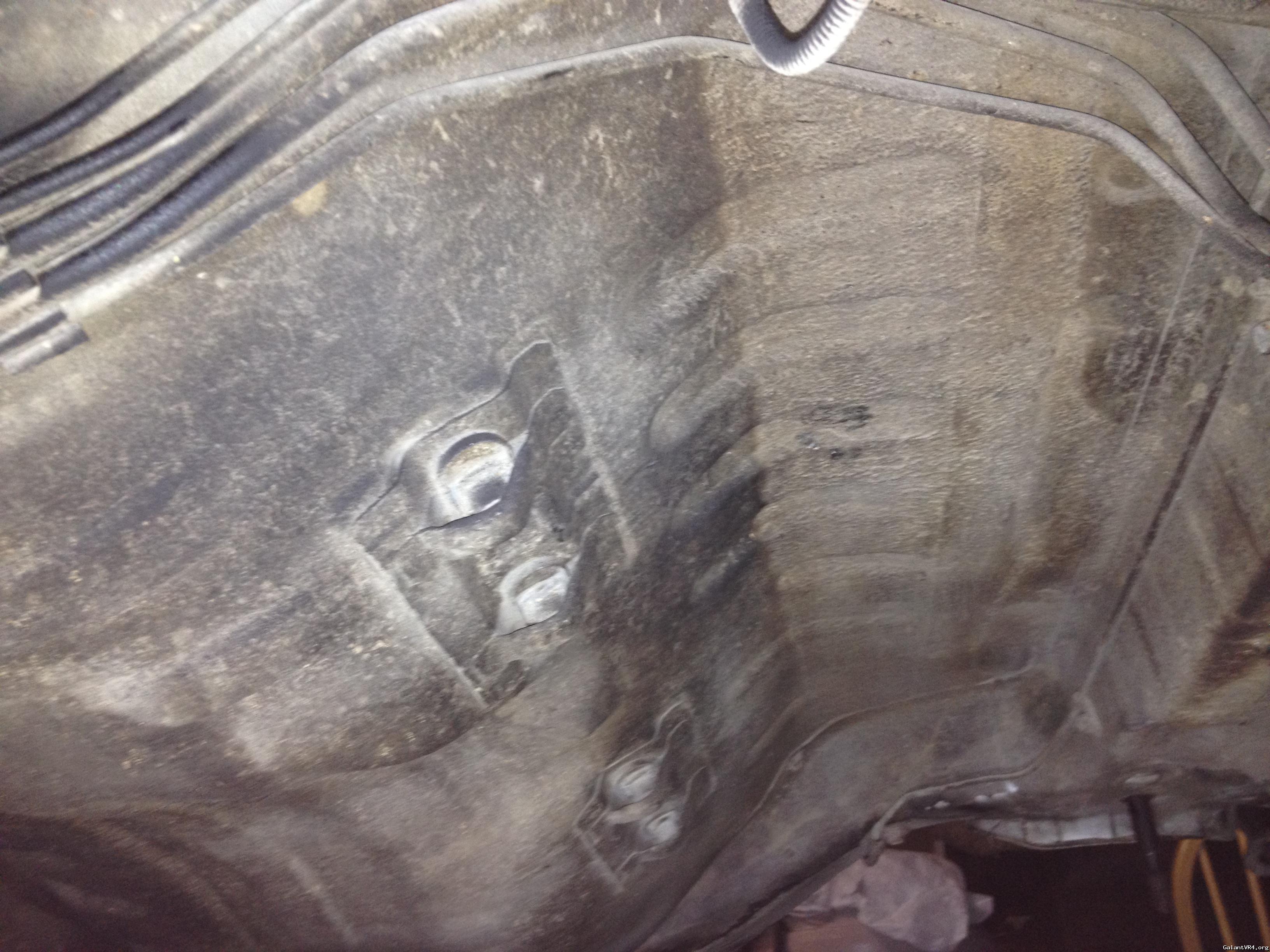

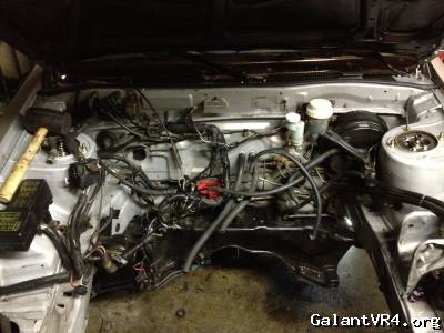

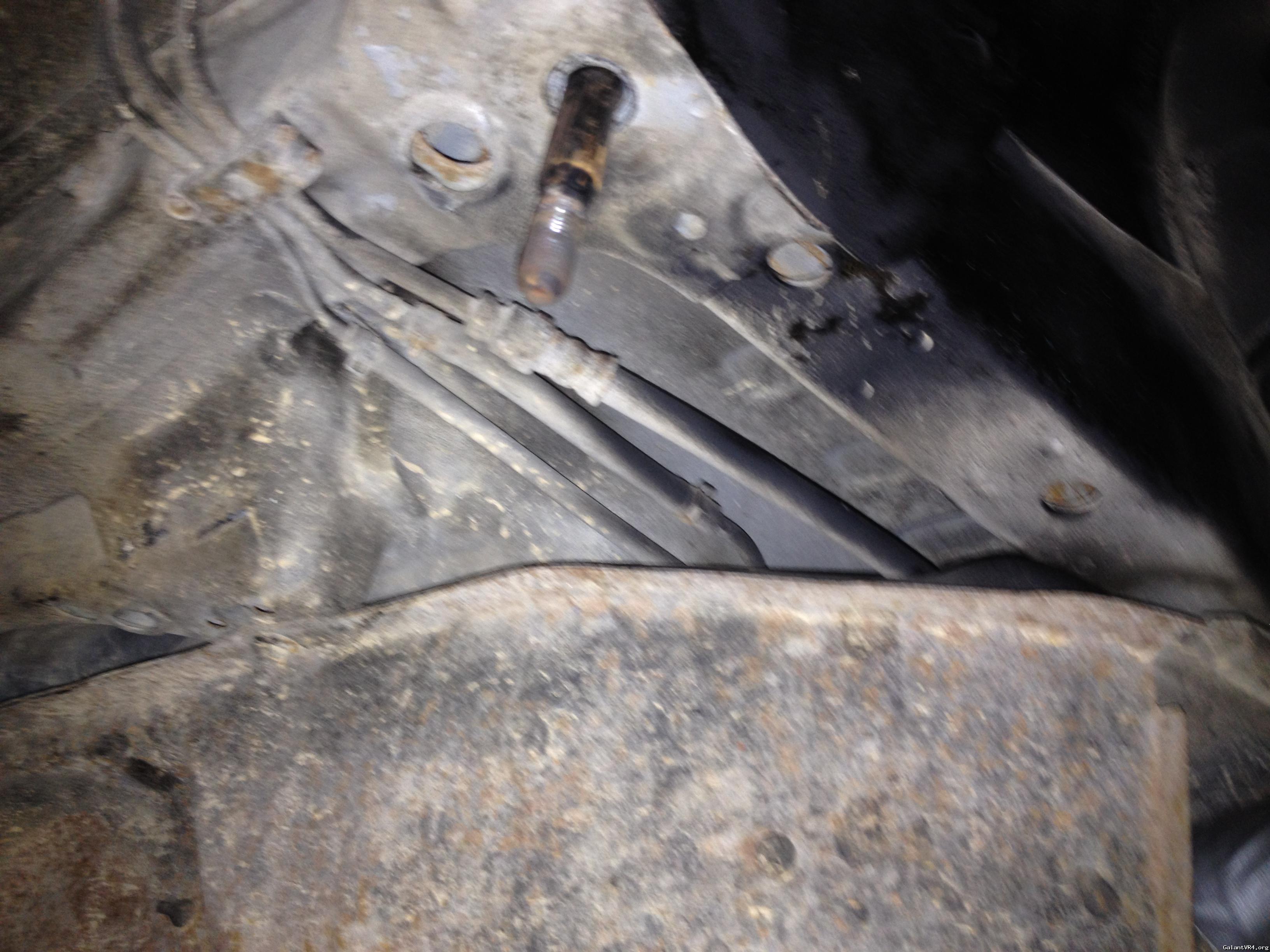

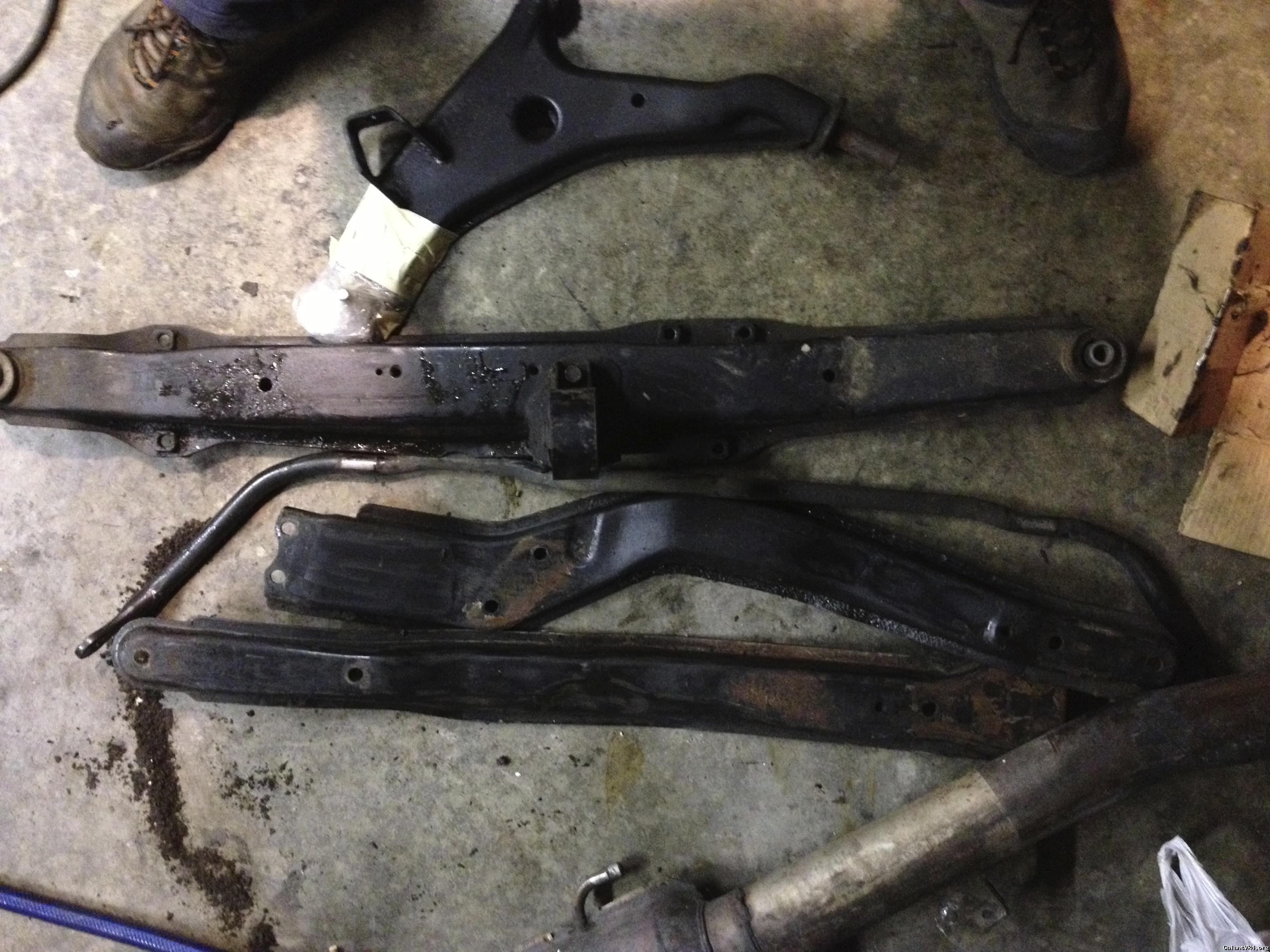

After engine was pulled I started on engine bay and front end rebuild
Cross Members removed
Front A Arms removed
Underneath the front subframe lots of dirt oil etc
