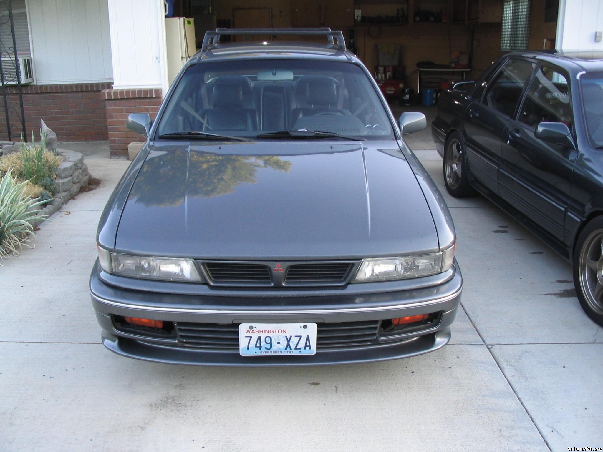

A rattle can will look just as good as the 17 year old paint a lot of these cars have. I'm pretty anal about the paint on 1051, but when I did the bumpers with a color matched rattlecan on 503, it turned out good enough to match the rest of the car and look decent enough that people say "you did that with a rattlecan?!". Everybody that's seen the car in person thinks it looks great.

Quoting turbowop:
Just be advised, it WILL NOT look good with rattle can.
[age]https://www.galantvr4.org/img.php?id=85940&width=400[/img]
Well it looks like I stand corrected /ubbthreads/images/graemlins/smile.gif
I have never seen a decent job come out of a rattle can, but going by the picture that actually does look good.
I am REALLY picky, so I have a hard time with anything less then near perfect.
