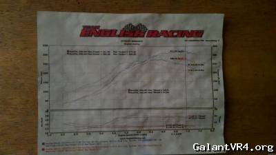

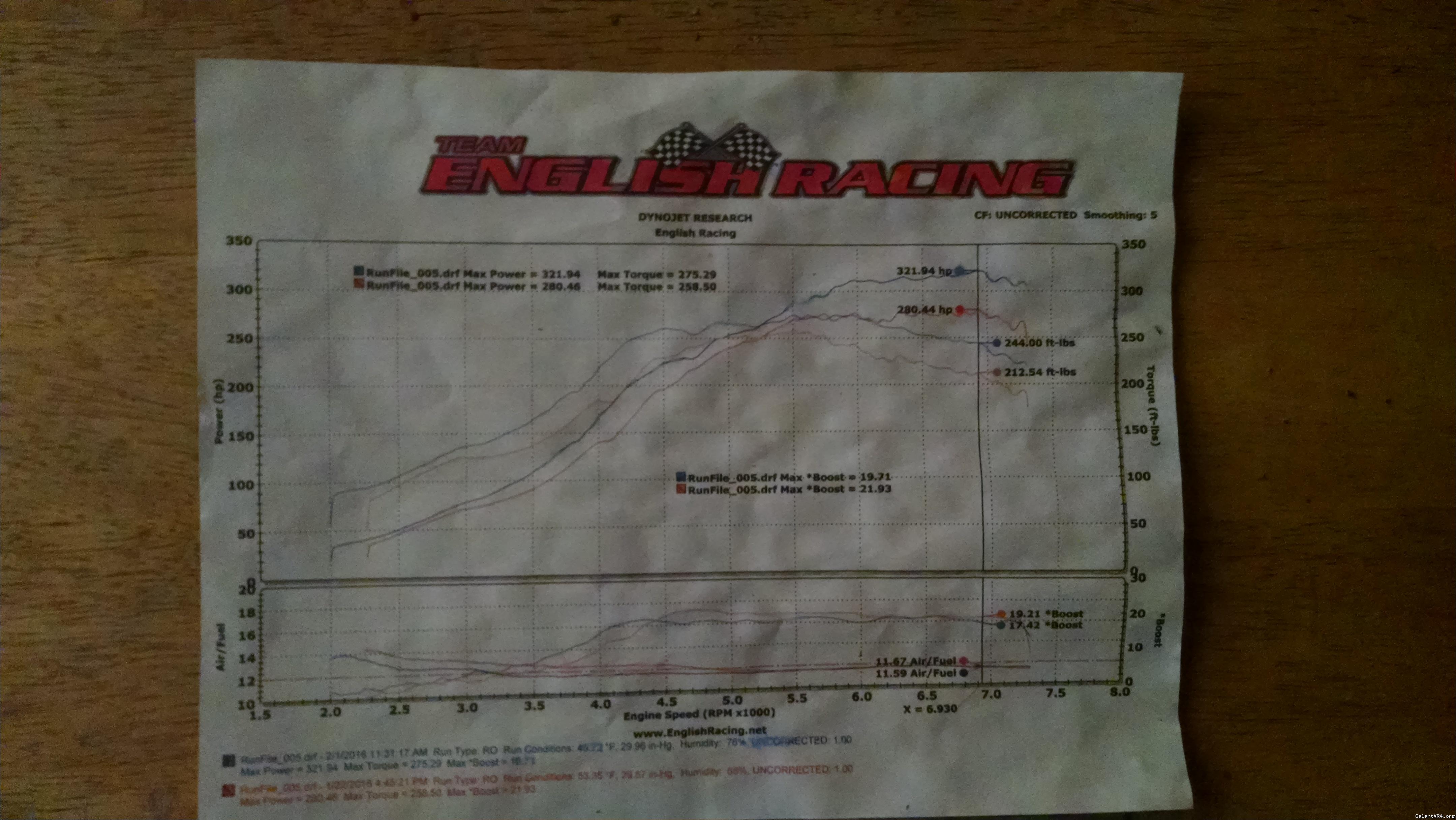

I just got my car back from English Racing.
Intake: ER SD kit
750 injecters
GSC Evo 1-3 DSM1 268 Cams
Forced Performance 68HTA (big16G)and manifold
DSM link and regrettably I have No wide band gauge or wide band run fuel management but affordable alternative fuel management system and already regretting not getting the 73HTA or their 20G. /ubbthreads/images/graemlins/banghead.gif
two figures are 2.5" and after 3" exhaust pipe and still waiting for Flowmaster muffler. /ubbthreads/images/graemlins/dunno.gif
