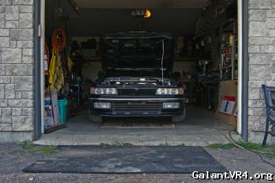

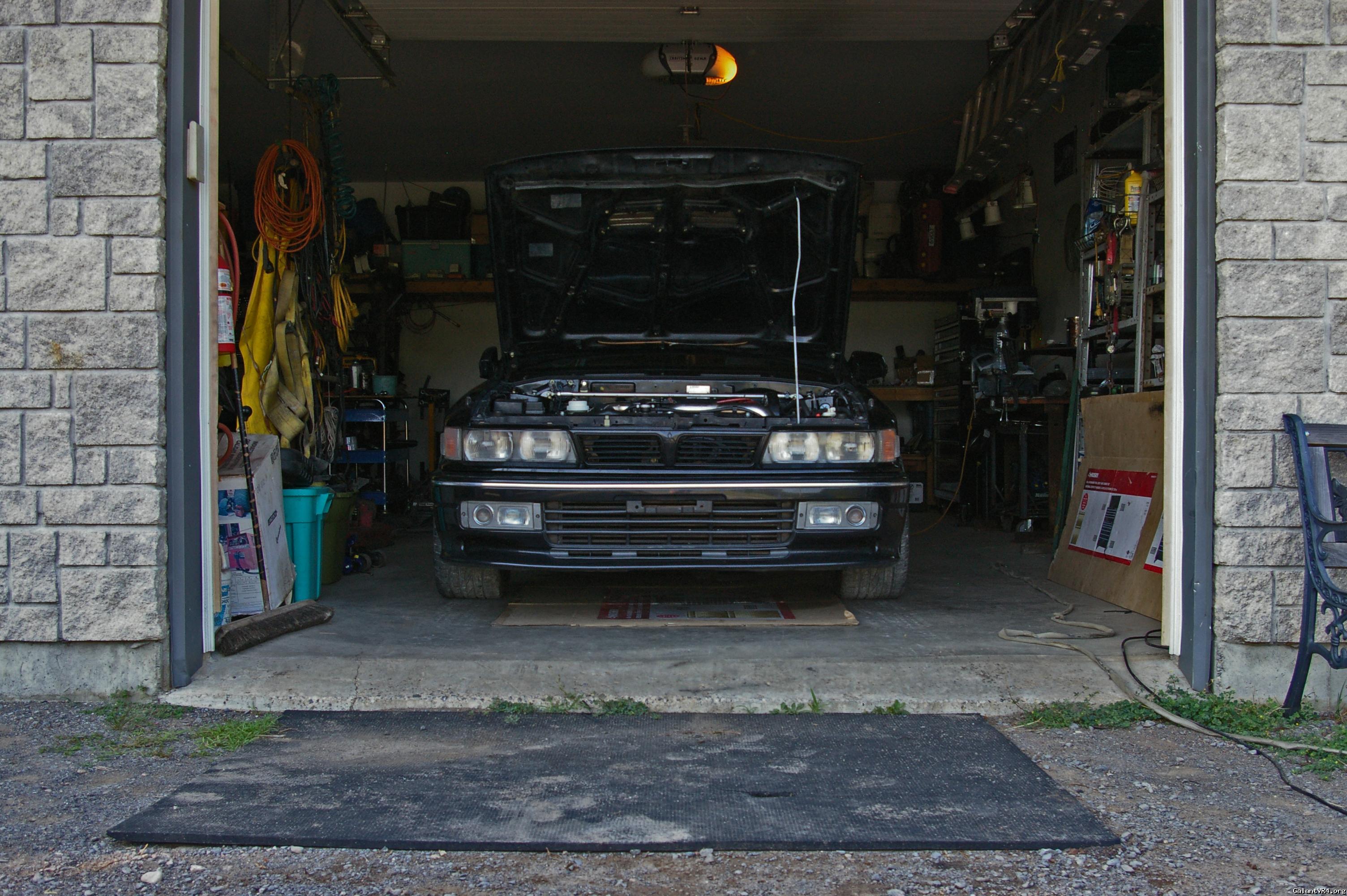

i was going to paint my intercooler...
but as you can see, you need to be up in there looking to see it. and that is a 4" thick core. you dont need anything close to that.
