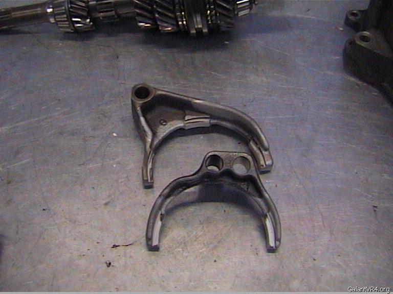

If your lucky enough to get an evolution galant gearbox
they didnot have the wear pads they are a solid steel version of the stock alluminuim.
But they were superseded to the rubber pad type later evo 1,2,3.

here are the shifter forks out of a vr4 rs evolution, they had done around 120 000 kms
dont know much about them just that they are steel and dont appear to have any pads.
had the pics so i thought i would post them up
