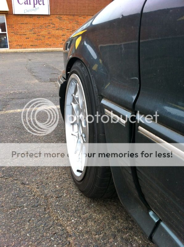

It can be done, 28-30mm offset sorry for the photo bomb
Looks real nice so what's your setup 17x9+?(offset) and what tire size? tires look a bit stretched but I like the way it sits looks good man..... /ubbthreads/images/graemlins/devil.gif
dc_style
Sep 4, 2003
534
Saint Paul, MN
This is with a +28 offset on 205/50's... I'm glad you like it, it is indeed stretched but I would consider it mild by "stancer" terms.
Wow so its 17x9+28 with 205-50-17? Nice I like lol /ubbthreads/images/graemlins/ooo.gif /ubbthreads/images/graemlins/ooo.gif /ubbthreads/images/graemlins/ooo.gif

check out my thread 808 from mn, there are more angled shows there, it'll need an alignment to bring it flush with the car but it looks to fit quite nicely.

big wheels with tires too small /ubbthreads/images/graemlins/hsught.gif
Shouldn't you have bought a volkswagen?
raptorWagon
May 17, 2007
2,829
Oak Harbor, WA
^+1, They just look small because they are a 205 stretched onto a 9" rim, If it was something more like a 225 or 235 it wouldn't be as bad.
dc_style
Sep 4, 2003
534
Saint Paul, MN
in this case, i had the 205/50's for my 17x8's but these wheels popped up for a great deal. this will be my daily, and quit honestly, i would hardly consider that too much of a stretch if you compare to the vdubbers. personal preference but i think it'll look quite nice once i get an alignment to get everything "hella flush" /ubbthreads/images/graemlins/grin.gif hater's gonna hate!
