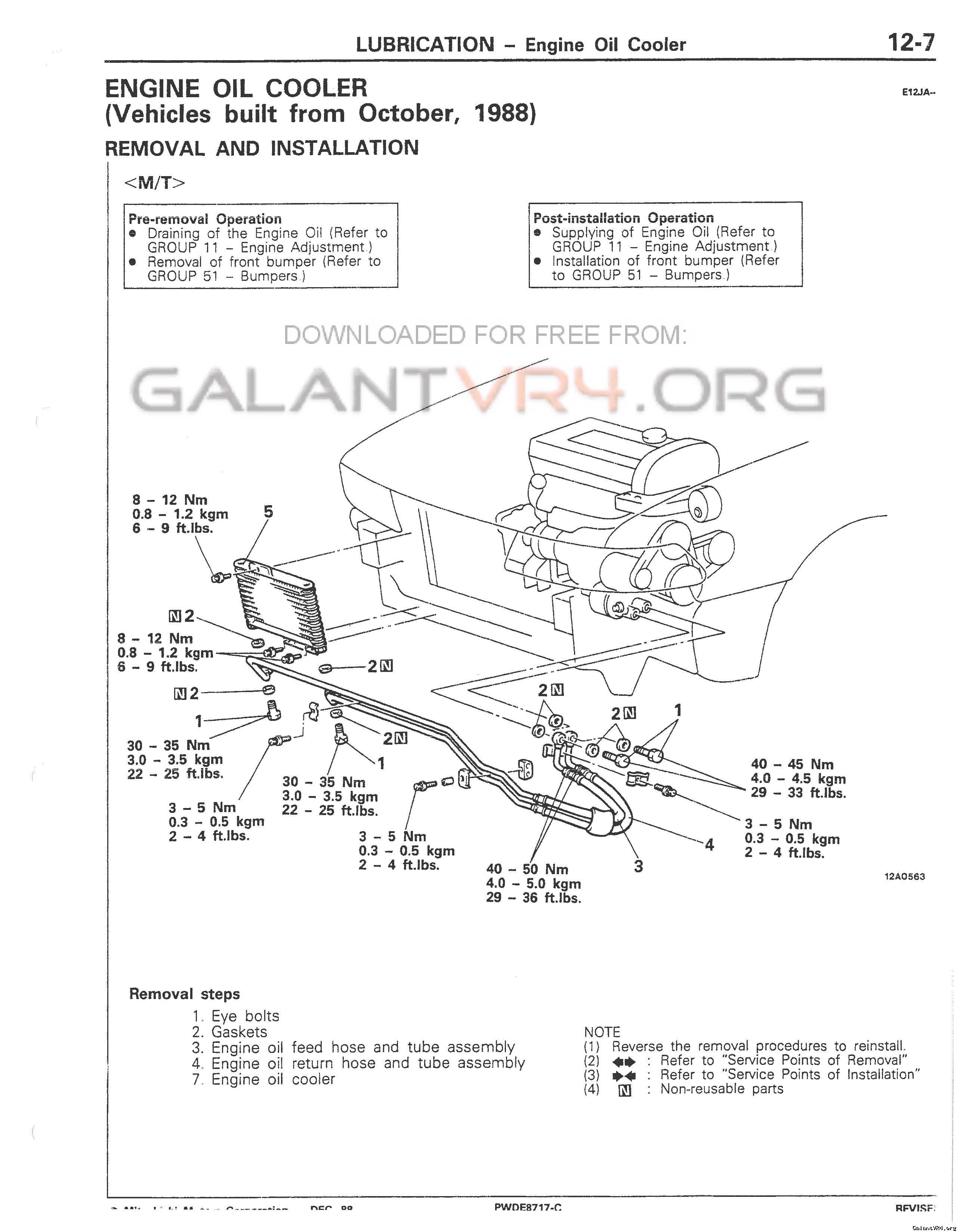

Isn't that how the factory oil cooler mounts?

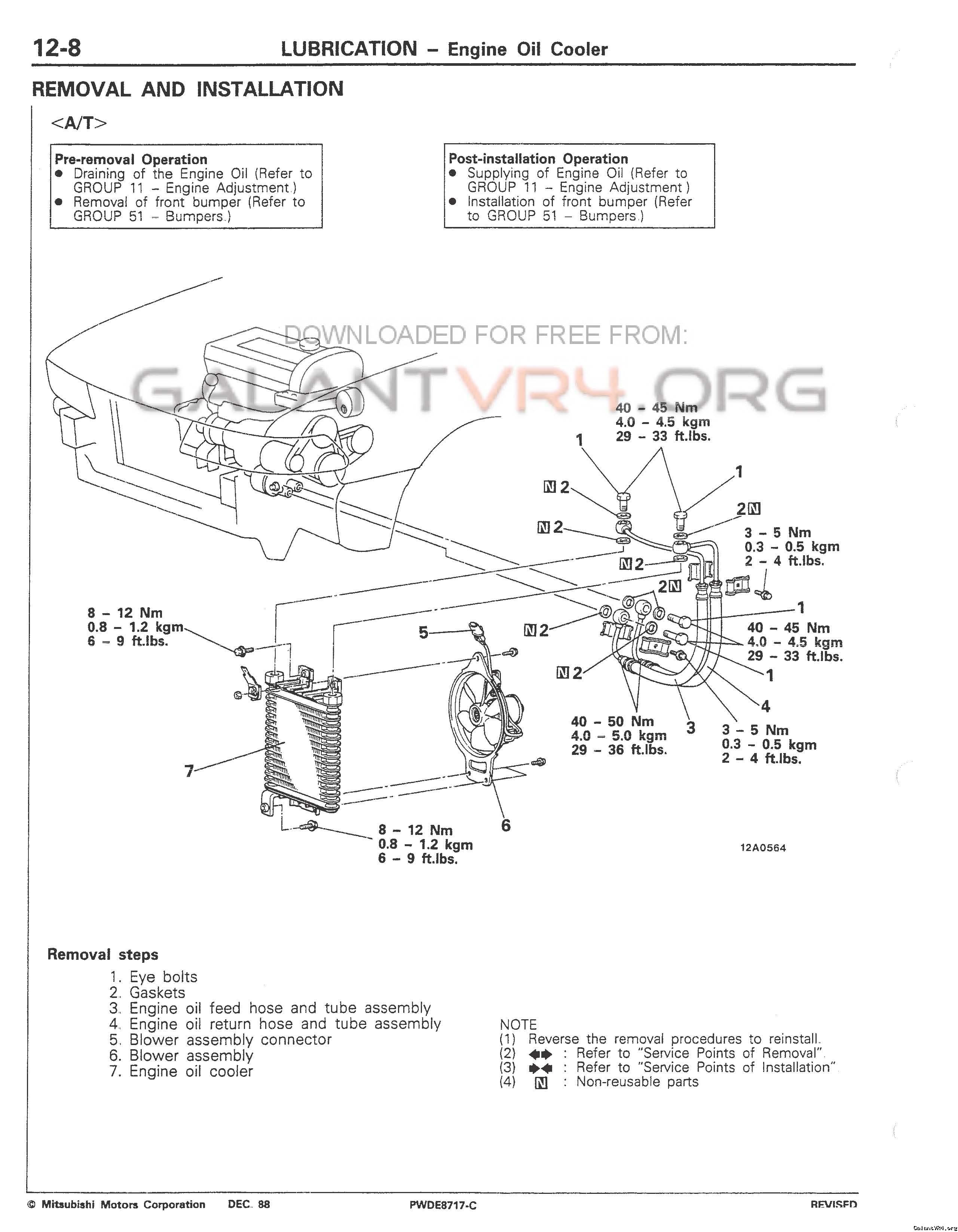

One other thing is the autos came with the cooler mounted in the wheel arch (where the abs pump would otherwise be with a fan on.

Quoting misterfixit:
Yes .. exactly! It was the first thing I looked at after seeing this thread.
One other thing is the autos came with the cooler mounted in the wheel arch (where the abs pump would otherwise be with a fan on).
Now that is good to know. So some new lines and I could have a factory configuration installed oil cooler if/when I delete the ABS. Would seem to make more sense having a fan on in Hong Kong too with all the stop and go traffic and would leave the stock location free for something like a diff or transmission cooler.
