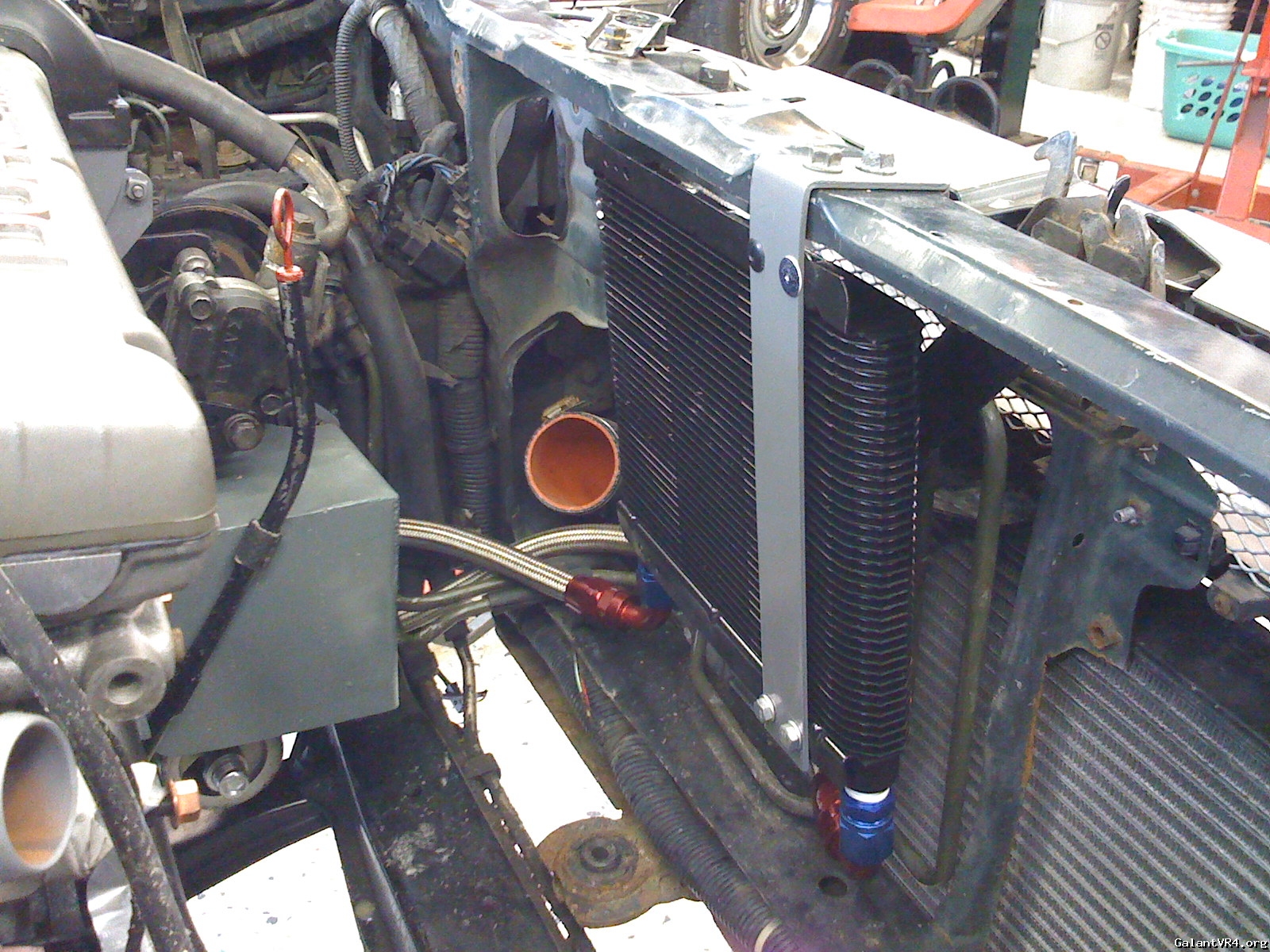

I installed mine in front of the radiator using a 90 housing. I'm not doing anything crazy yet with my car but I wanted the piece of mind.

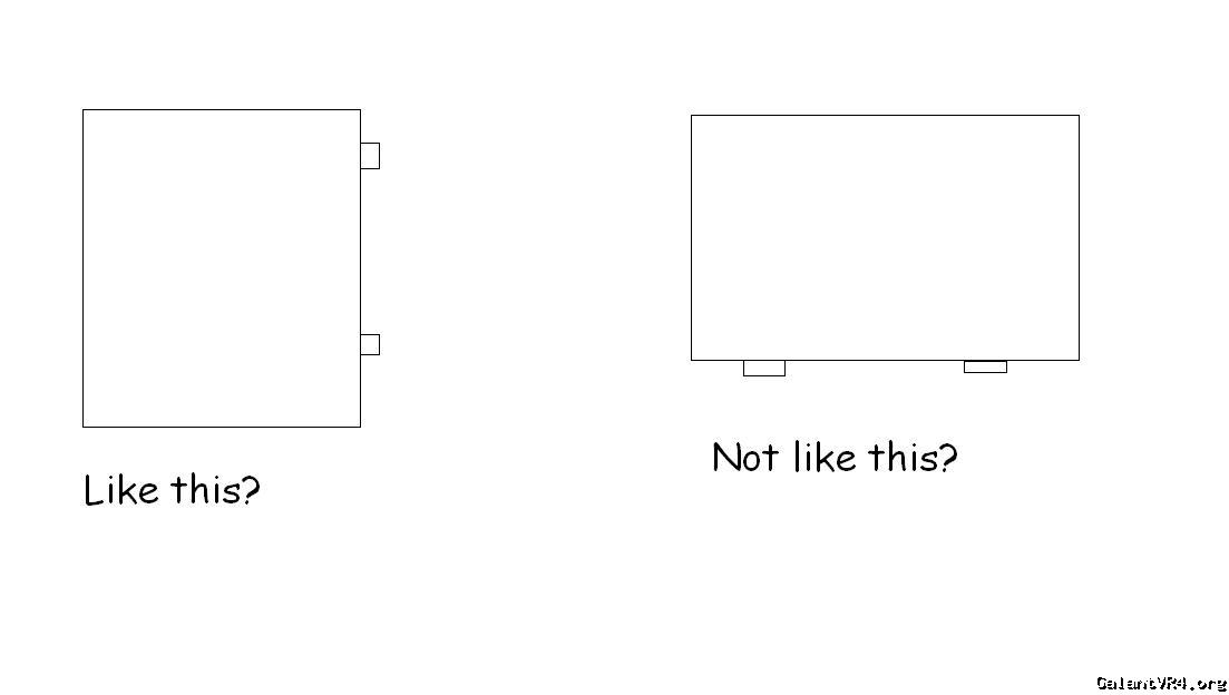

I did mine similar to CarRacer but Toybreaker told me I did it wrong /ubbthreads/images/graemlins/frown.gif.
I have been told that you want the feed and return ports vertical not horizontal. If the ports are vertical, the oil is not filling the whole core and utilizing the complete cooling capacity. The top of the core could be empty and I wonder if that air space could cause air bubbles into the oil.
I have to replace my core so I am going to move it into the fender where the ABS pump was at. I am going to be using a cooler that has a fan so it is not super critical to have the core directly in-line with incoming air flow.
If I ever get it done, I will post pics. But with vacation in a week, it will be awhile.

Mine is setup that way so it will FORCE oil through and drain back out. I don't want it to leisurely pass through and not push all the oil out.

The way we both have ours set up we are able to have fresh oil in the cooler at all times. And this configuration lets the motor dictate the flow through it. Fresh flow through the entire core. No wasted space, no stagnant oil.

I am intrigued by the comments by Terry that Toybreaker made. Having the ports at the bottom could conceivably create a pocket of air (albeit compressed) at the top of the cooler that blocks that portion of the core from being used.

I can see the merit of Toybreakers idea because there is nothing keeping the oil from flowing up only far enough to flow across and down. There may be unused space in the core not coolong the oil up top.
I don't know, but I will be going with Toybreakers idea.

It's my understanding that our housings have a built in thermostat, so until the oil warms up the cooler isn't even in the system. Does anyone know which is the inlet and which is the outlet for the housing? If you were to orient the cooler fittings to be horizontal, you'd want the flow to be top to bottom to avoid any possible air pockets.

Aren't these under pressure (when running) though? I don't see how orientation would make a difference in that case /ubbthreads/images/graemlins/confused.gif

Yeah, it's under pressure but it'd be like not bleeding your coolant system. The cooler I have is at the top of my oiling system, so it's possible that there's air in it and it might not be able to bleed out naturally.
