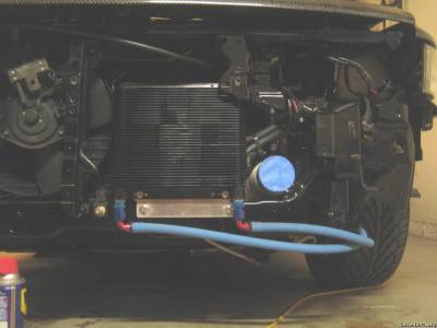

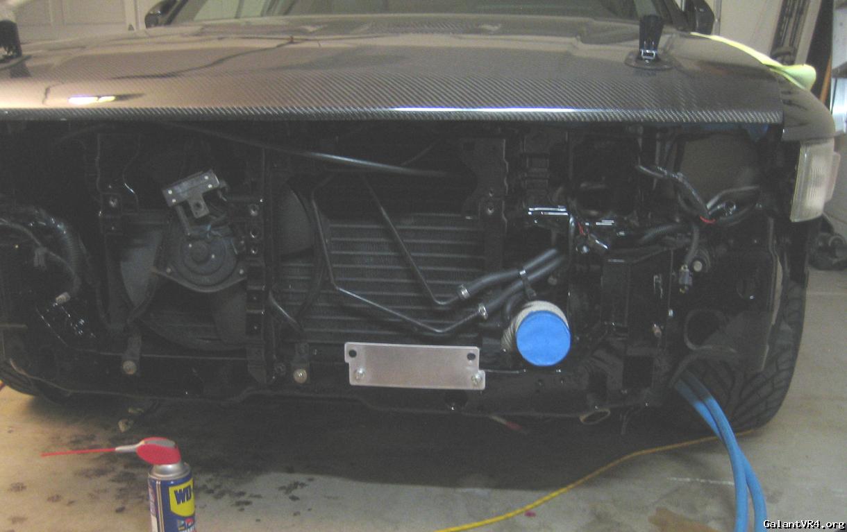

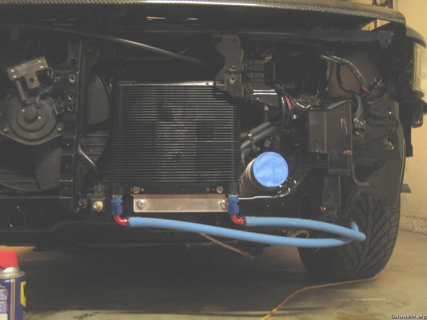

I designed this plate that moves the oil cooler up so the oil lines do not dangle below the frame. I wanted to lower my chances of snagging them if I happen to not be able to avoid road debris. They will get zipped tied up as well.

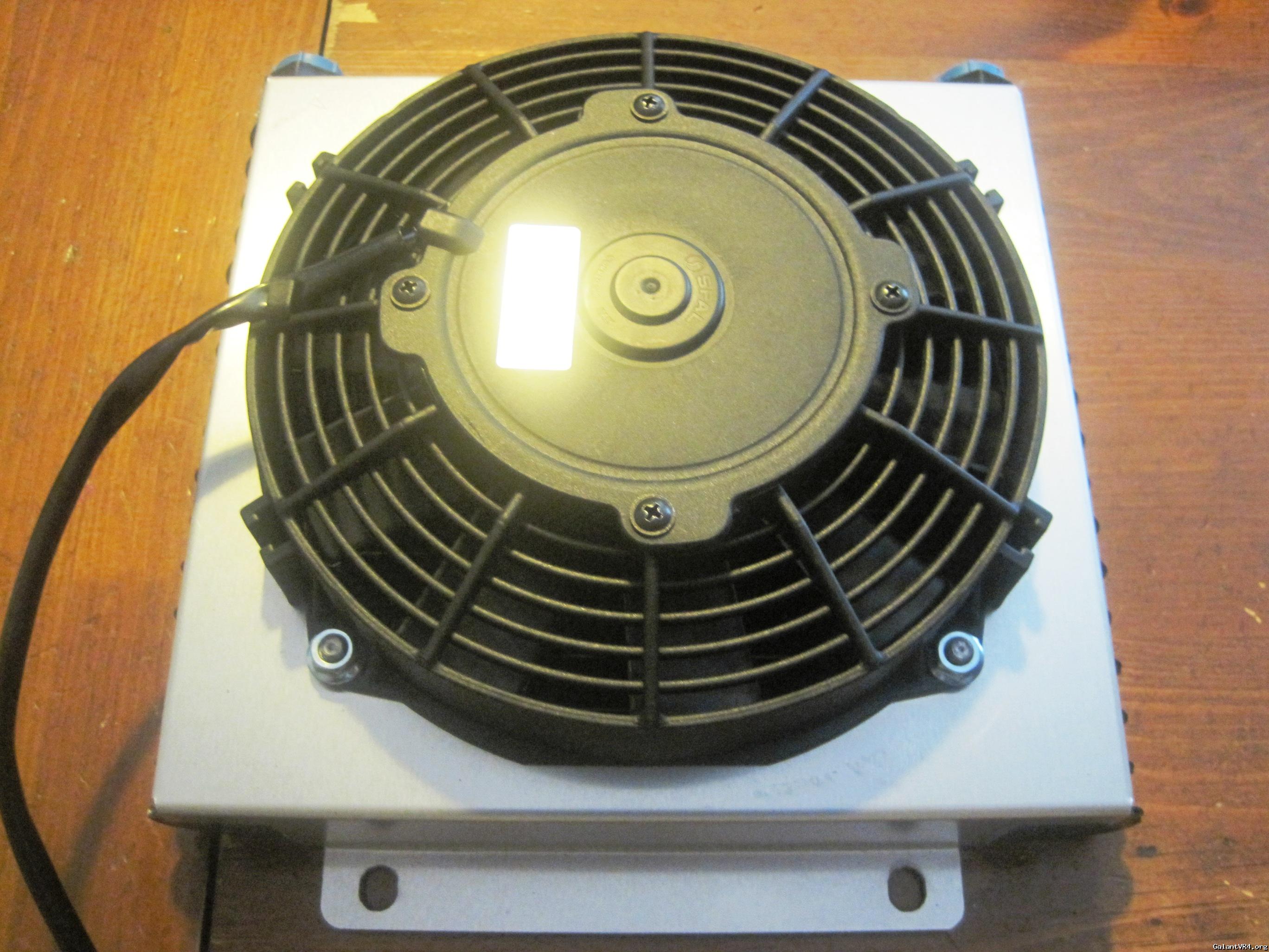

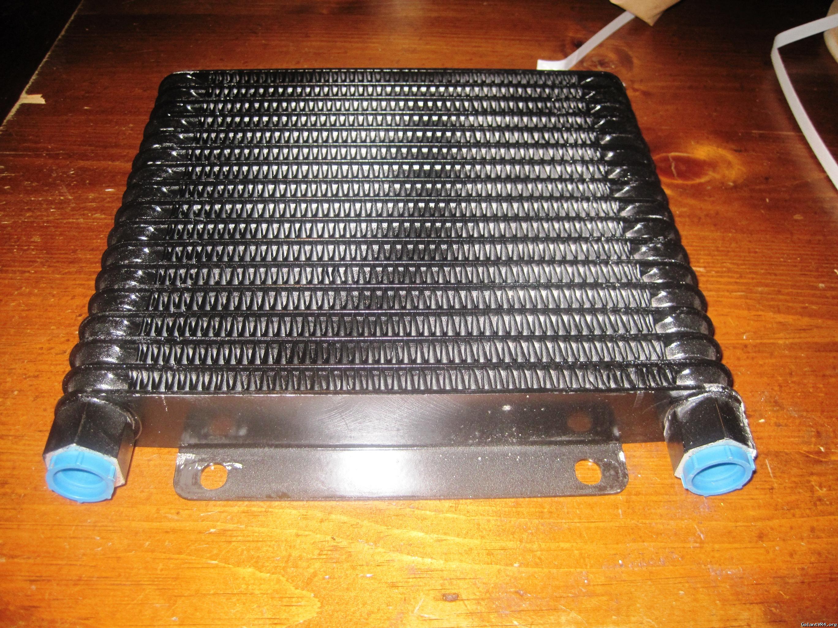

Here is the cooler I just bought. web page They have plenty if you want one. Looks to be approximately the same width but taller as the stock 90 cooler but it has 1/2" ntp female ports.
I also bought two steel 10an to 1/2" npt male fittings for $8 off of ebay to allow me to use my 10an hoses.
As I said earlier, I plan to mount in the fender where the old ABS pump was. But I will have to see just how it fits once it all gets here.

This thread is really messing with my thinking on how oil coolers should be mounted. I don't understand how it would be correct to have the inlet and outlet both on the bottom. Any oil flowing through the cooler would only flow through the bottom passages. With the inlet on the bottom and outlet on top, the oil would be forced through the entire core, or if both the inlet and outlet were on top, same deal. This doesn't make any sense to me.

I suppose that way would work as well Mark. I am not saying the way I did it was correct. The logic in my mind told me this is how I should do it. But, when was the last time you saw an oil cooler with inlets and outlets that way?

I think it may depend somewhat on the internal design of the cooler, but you have to remember Mark that pressure is equal everywhere. 70 psi of oil coming in to the cooler is going to be 70 psi everywhere in the cooler, not just dribbling in at the bottom. Think of air pressure in a balloon.

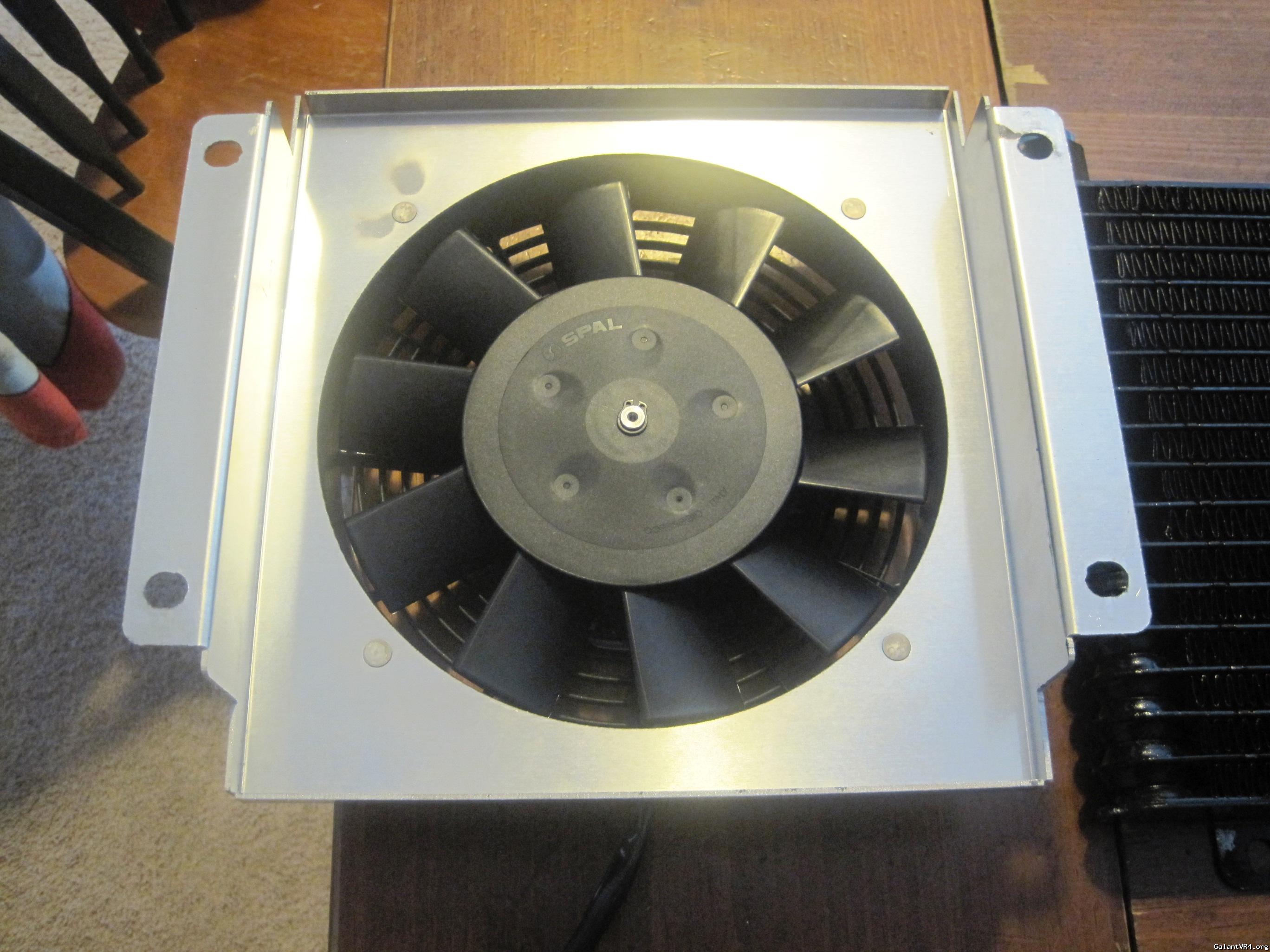

This is a really nice cooler. Spal fan and quality aluminum shroud. Basically the same as stock but taller and 1/2"NTP fittings. For $110 shipped, very good value.
