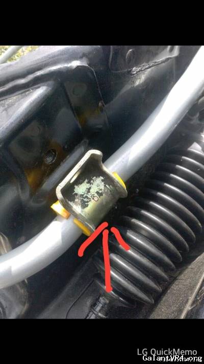

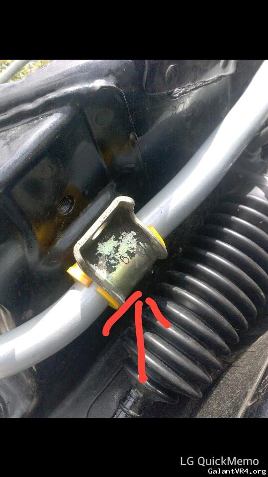

You reuse your preexisting stock sway bar bracket. Whiteline only offers the bushing with their swaybars. I would encourage you to lube the bushing with grease that also is supplied with the Whitline swaybar or off the shelf grease as getting that bracket snug and bolted tight can be challenging.
