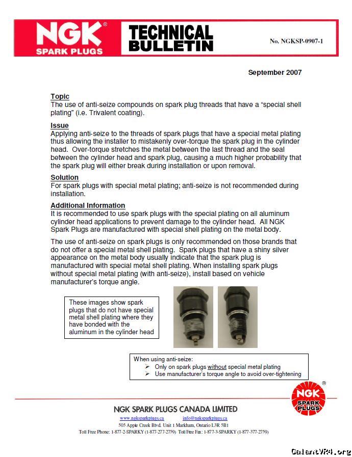

NGK Factoid
Saw this Technical Bulletin for NGK Plugs here, NGKPlugPro.ca
I personally didn't know about not putting anti-seize on NGK plugs when torquing to spec. Looks like it is more detrimental to aluminum heads.

Oops. I'll keep this in mind next time I swap plugs. I hate pulling sticky plugs, but my car gets the once over often enough Im sure it wouldnt be an issue.
Every since I snapped a plug in my Justy, Ive always been AS happy with the plugs.

I'd trust this more if they said what their "special metal plating" was. I'd expect more of a technical bulletin. I always apply a copper anti-seize, and have never had an issue removing spark plugs. I understand an anti-seize will make the static torque lower, by providing lubrication, but what about their "special metal plating" is supposed to prevent seizure? I'd rather risk over torque than a seized plug.

I've never used AS on my plugs and never had an issue removing them either...including on my old Justy. /ubbthreads/images/graemlins/dunno.gif

Back to AS useage... use sparingly, guys.
Quoting Muskrat:
They do say /ubbthreads/images/graemlins/wink.gif
Trivalent Coating:
Now, what is Chromium? Basically speaking Chromium is a metallic element that is used to harden surfaces and it also causes the surfaces to become resistant to corrosion. Chromium is made naturally and it is also used in the making of stainless steel and other such materials. Therefore with that being said, let me condense it.
Trivalent Chromium Process is a combination of compounds used on surfaces that have the potential of rusting; thereby hardening the surface and helping it to become corrosion resistant.

I have almost always used NGK, at least in all my Japanese vehicles. I have never used anti-seize and have never had a plug stick,

I'm not sure where I put it, but in my Pocket Reference book, it has a percentage torque chart depending on lubrication. I.E. If you are using anti-seize you use 60% of the stated(dry) torque value. I'll try to remember to post it when I find it.
This way you could use anti-seize when you want, but not over torque things.

There should be no risk of snapping a spark plug with or without antiseize if you're only tightening to 20ft/#s.
