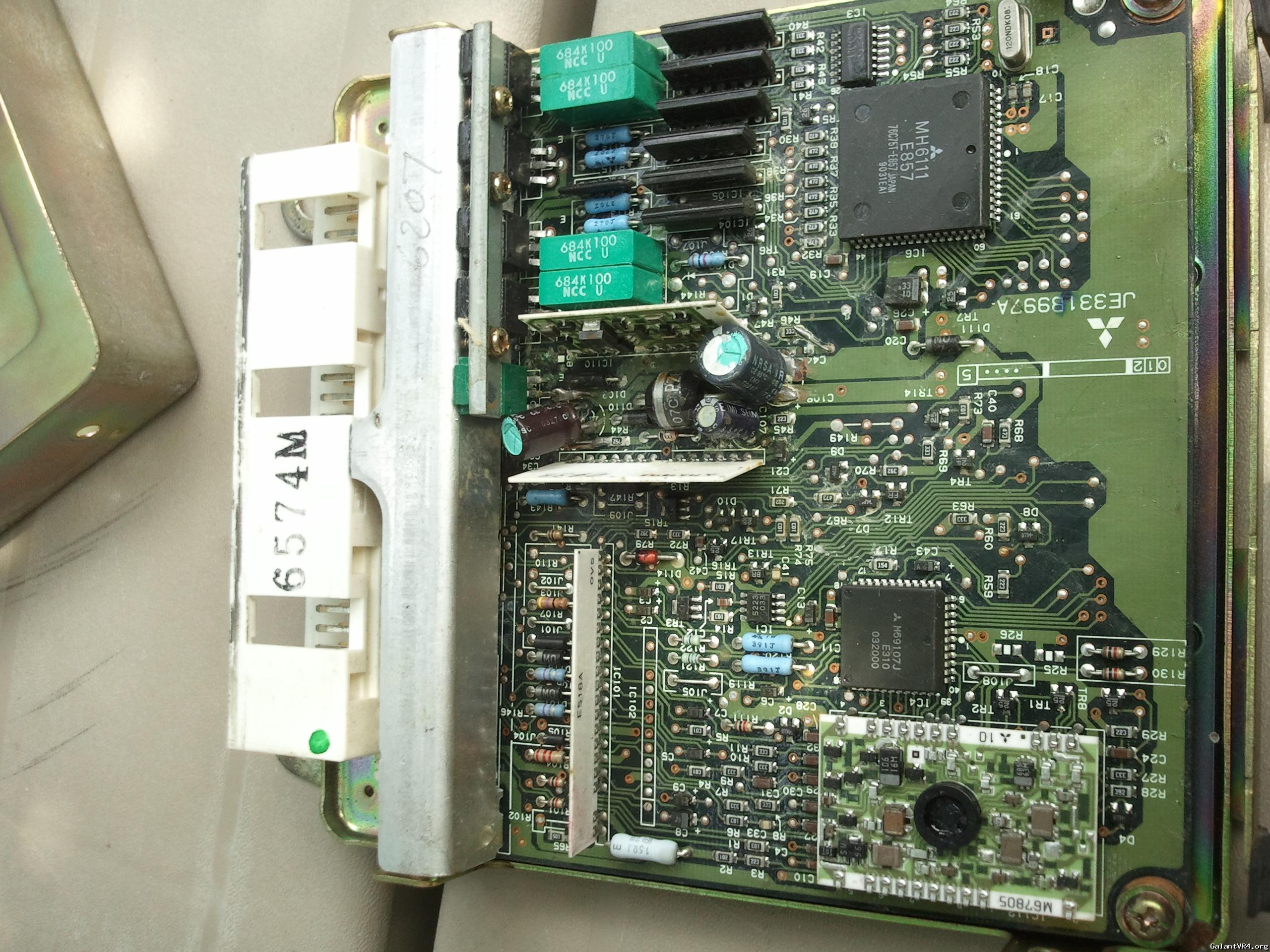

So I thought to myself "Hey, why not check the ECU cause you've been putting that off since forever."
So I did.
Heres what came about.

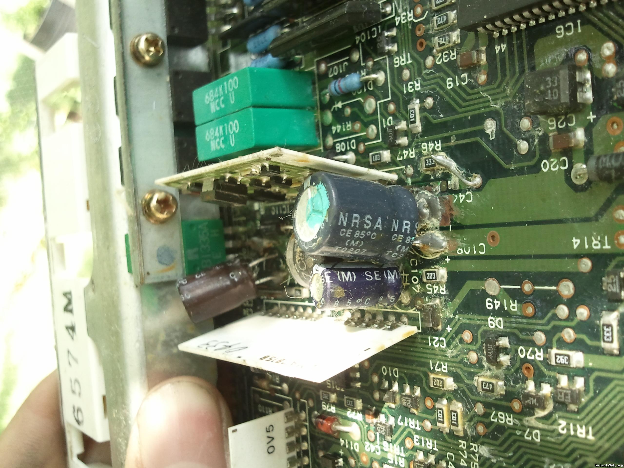

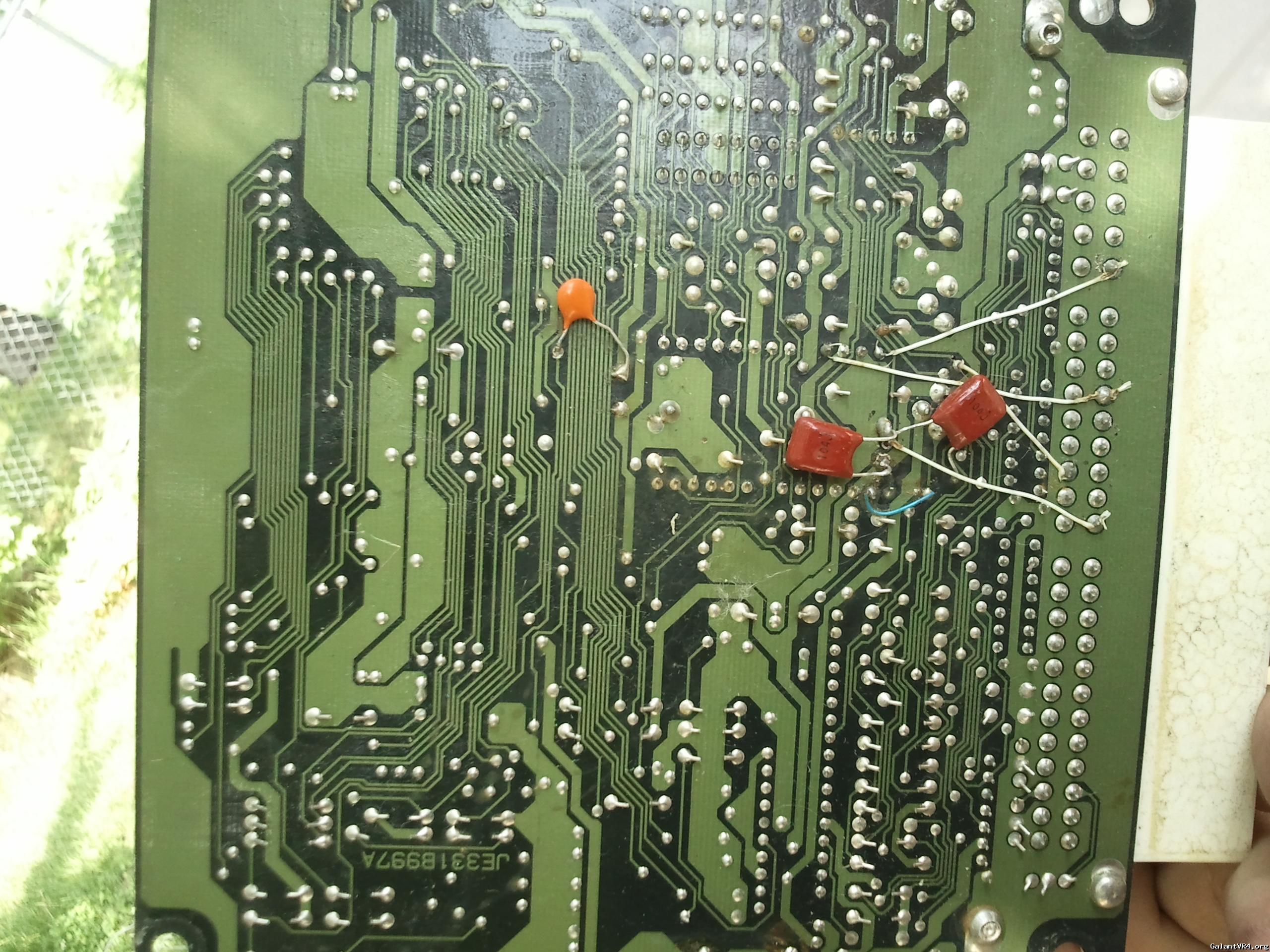

Looks like minor acid damage?
I dont even know wtf all this crap is.. can someone explain??
And of course, non-eprom -_-
Im thinking this could be the cause, does anyone else have any input?

Looks like omeone repaired acid damaged board (and replaced caps). If the acid wasn't cleaned up and continues to etch the runs, the situation could deteriorate such as you're experiencing. (that's a non-eprom by the way) It would be quickest if you could swap in a known-good ecu. WIthout that option, I would check that the plug wires didn't come off the coil. [A thought: I can't recall, but I think there is something in the coil pack or power transister (can't recall that name either) that can kill two cylinders.] Check compression...a head gasket blown through between 2&3 could drastically kill power from both cylinders since when one is on compression stroke the other is on exhaust stroke (no compression).
