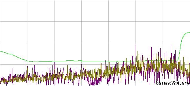

Currently I am running BPR8ES plugs. Attached is a log file from over the weekend, which shows my knock. I am getting between 2.3v-2.5v of knock when it spikes. I am wondering if running a non projected style plug will clean up some of this knock.
Currenlty running the car at 25psi on California 91. Car makes about ~450whp. I would love to run more timing on the car but the knock is already at about the max I feel safe at. AFR's are well within limits also. Peek Torque Timing = 5.5, and max RPM 9. If I could get 1 more degree of timing at peek torque it would pick up tons of torque.

So the initial shows a slight improvement in the knock. I would not say that it is awesome, but it is better. Just looking at the two graphs back to back, knock has lowered. Now this was not by a huge margin, however I think that I can get away with some more timing and maybe some more boost. I would love to get away with 30psi on California 91 pump gas but I am not sure that is possible. I will also give a set of the 7's a test and see how they preform.
The only downside that I saw to these plugs, was when I first started the car it was a little harder to keep it running, and it did not idle as smooth once warmed up.
I have the plugs gapped at .024. I am going to open up the gap to .026 and see if that helps, I am also going to remove my filter from the car, that might be where some of my issues were coming from /ubbthreads/images/graemlins/smile.gif.
