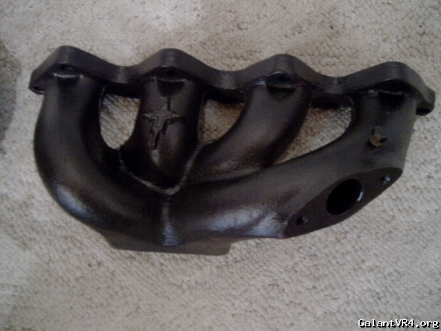

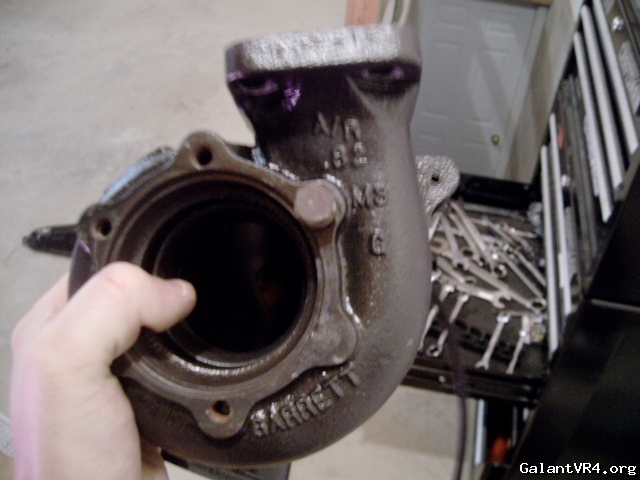

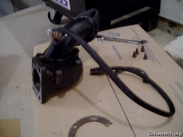

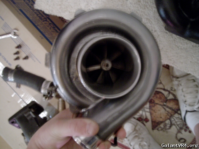

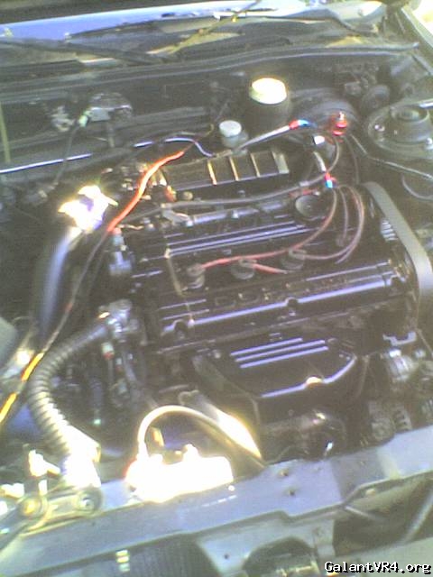

After having alot of problems with the last turbo setup i bought a T3 Setup. Turbonetics T3 Manifold with a Buschur 57 trim. I bought the setup off Zach which was from Bean's from turbotrix's turbo setup off his recent car which he just parted out. I also bought a set of HKS 272's from his as well. Here is what it looks like now, took it apart to clean out the runners cause its been sitting on the self at the shop for awhile. Everything is cermanic coated and the compressor cover was done in Black Chrome.I also re-wrapped the o2 sensor wiring so it covered the whole length with flame retardant line. Wednesday im going to JNZ and Josh is gonna fab a wastegate setup for my Tial 40mm cause there isnt enough clearance to run it straight off the runner.Waiting for a o2 gasket so i can put it on. Anyways here are some pics

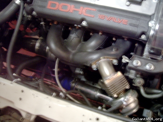

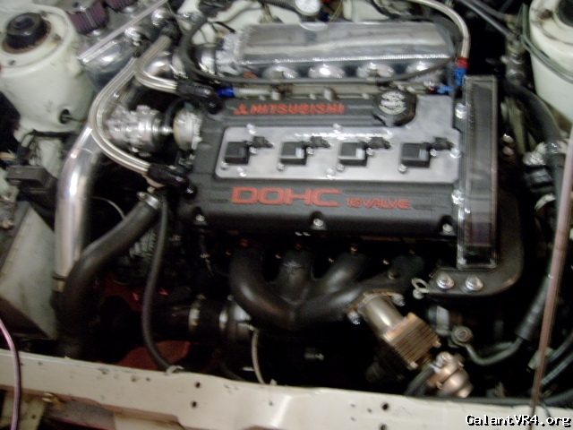

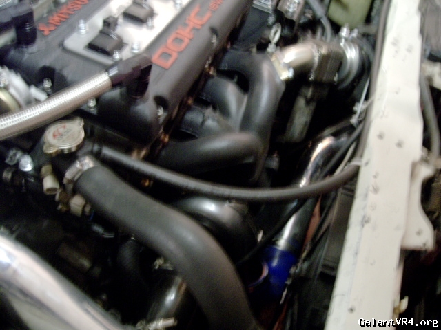

got the new turbo installed monday and today i had jnz weld up a Tial 40mm flange to the manifold. Sorry for the crappy pics, not much light in the garage.
Looks good!
Get a civic radiator, and cut that silly Drivers-side engine mount-down. /ubbthreads/images/graemlins/worthy.gif
BoostedAWD91
Mar 1, 2007
2,937
Danville,Pa
whats with everyone pushing the civic radiator /ubbthreads/images/graemlins/dunno.gif thanks for the suggestion but mine works perfectly fine and i have plenty of room
I think the only reason they are pushing it is because with a larger turbo, you require more space fir the compressor housing and it makes running the intercooler piping easier.
11,992
I don't have any issues running a larger turbo with a stock radiator. /ubbthreads/images/graemlins/dunno.gif Fits fine with the FP3052 and even fit with my old FPgreen setup that had the external wastegate angled towards the radiator off the O2 housing.
IMO, most all the Civic radiator installs I've seen look like garbage. The upper mounts always look cobbled together like the one pictured above.
BoostedAWD91
Mar 1, 2007
2,937
Danville,Pa
Quoting Airmail96:
not really, there is still plenty of room to use a stock or stock size radiator with a bigger turbo
