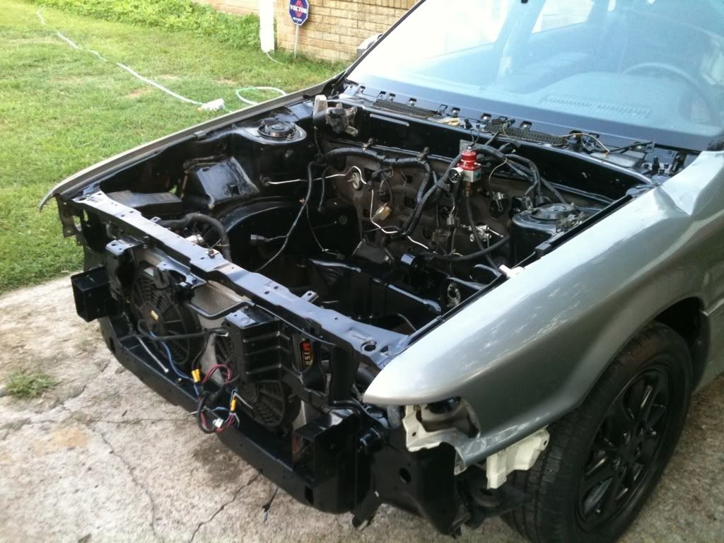

Here is what it looks like now. More to come.

Stripped down.
finished up with paint. Time to start to reassemble with all my auto parts.
gotta love silver and black.
What's the benefit for having the radiator fans in front rather than behind?
Did you sand blast the engine bay before you painted?

The benefit of running th fans in front is room. I'm going to run a holset WH1C. I need all the room I can get and also the radiator is centered as opposed to how it is stock more towards the passenger side. This way I can run my fmic straight through the core support like on a dsm.
