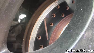

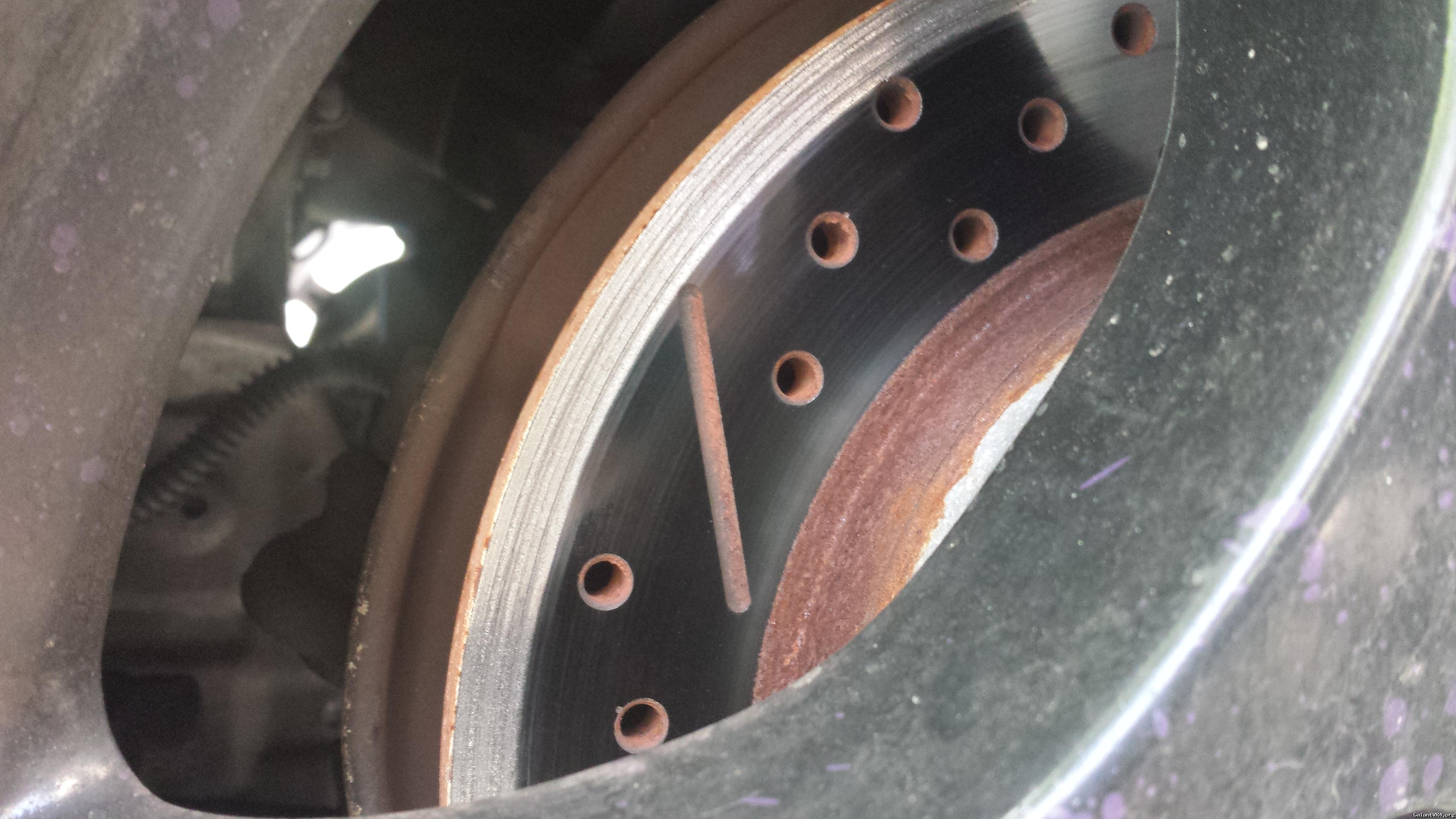

No sorry. Just trans and a few other bits. The brakes came with the car unless Shane changed them.
navajo49
Jan 30, 2014
22
reno, nv
Alright thanks he said something about them being off a 93 gsx possibly I'm trying to find some rear pads and the parts store was saying there's a different part number depending on the month
Jesus_Negros
Jan 7, 2012
2,349
USA
I don't know if any rear brake upgrade during 93' but I'm sure someone here knows.

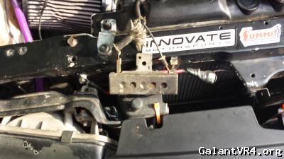

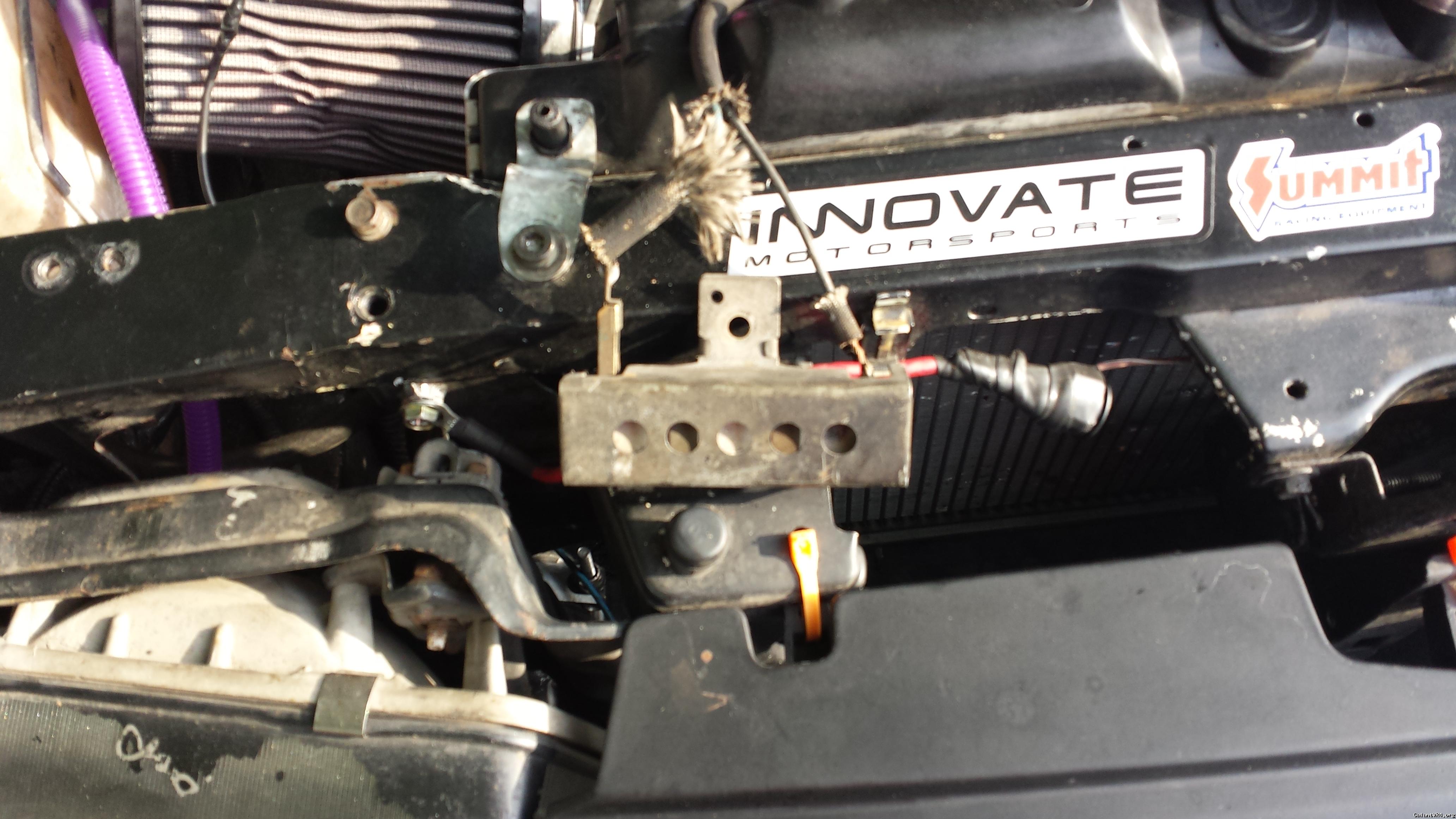

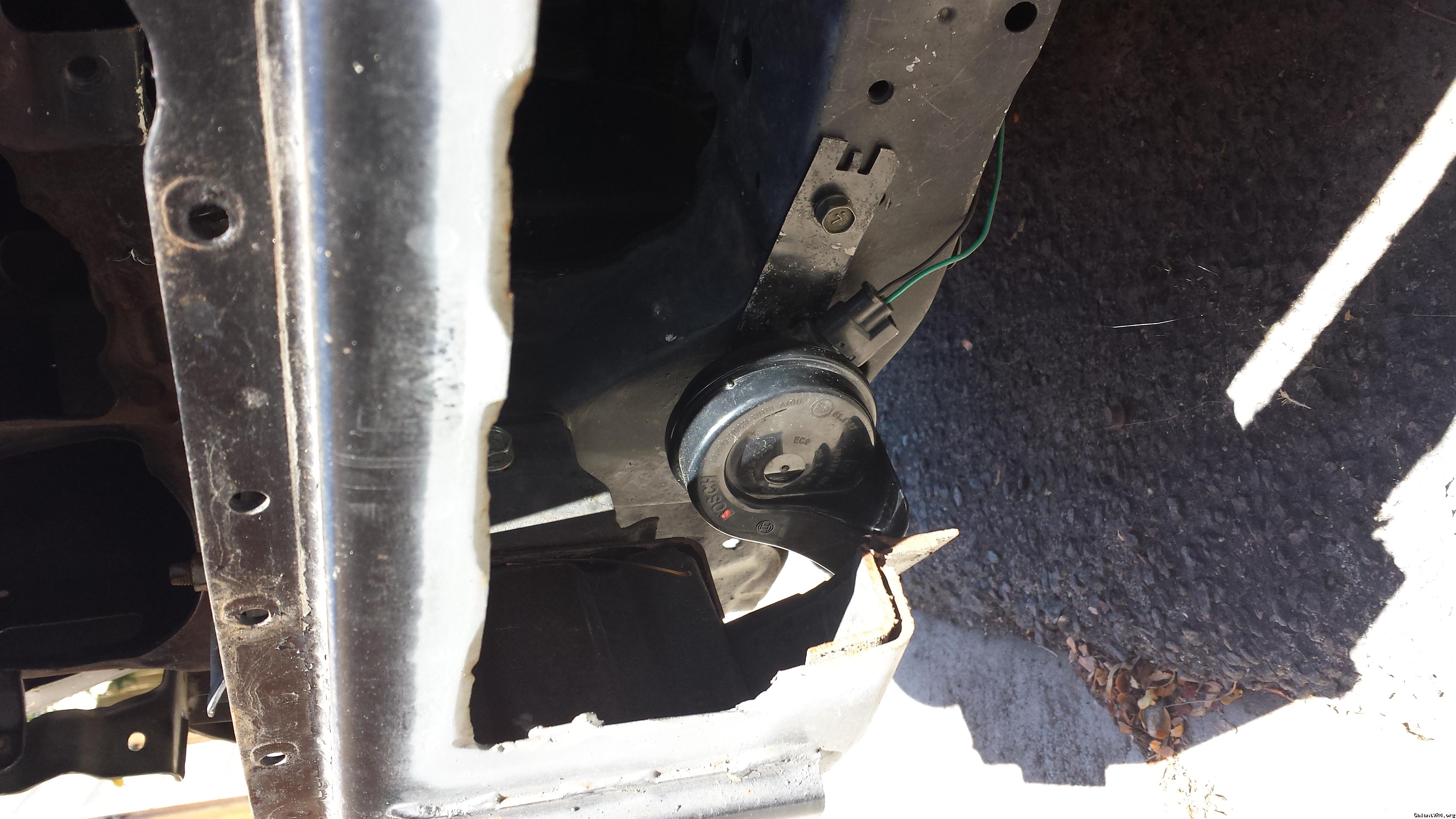

So for the million dollar question what part is this
navajo49
Jan 30, 2014
22
reno, nv
What does it do? It's ground is bad and I think might be the reason for my fans not coming on any part number?
navajo49
Jan 30, 2014
22
reno, nv
Ok moving along I did a repair on the resistor next I've gotta hit pick n pull up for some relays and hopefully that will fix the fan problems they seem to only work when I turn on the a/c
3,479
The resistor on the cooling fan allows it to operate at 2 speeds. In the stock configuration, the cooling fan uses a low and a high speed relay.
The low speed relay is activated by the thermo sensor located at the bottom of the radiator just below the cooling fan. When the thermo sensor sees 185 degrees, it completes a path to ground for the low speed fan relay and activates it. The low speed relay then supplies the fan motor with a path to ground through the resistor, causing the motor to turn at low speed.
The high speed relay is activated by the engine coolant temperature switch which is located on the water neck. When the switch sees 215 degrees, it completes a path directly to ground, bypassing the resistor. This allows the fan motor to turn at full speed.
The easiest way to test the fan circuit is to jump the terminals that plug into the thermo sensor located at the bottom of the radiator. With the ignition key in the ON position, unplug the connector and jump the terminals together with a wire or something. This will simulate the thermo (fan) switch operating. The fan should kick on. If it doesn't, you probably have a wiring issue.
