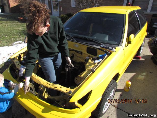

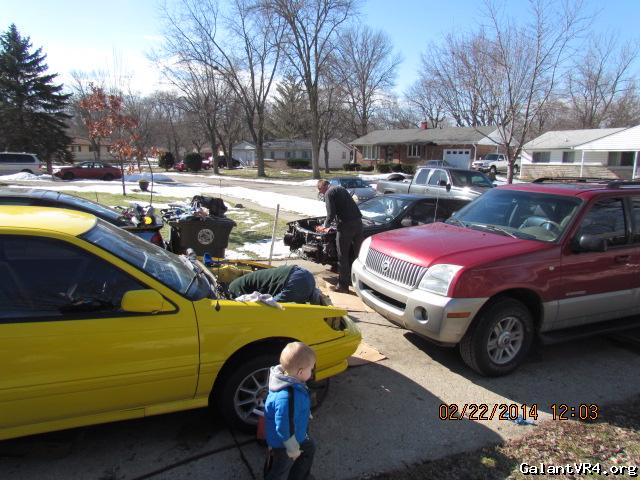

That's how you do it. Heck, I not only put the wife to work (in the winter, in the driveway), I get my little grandson out there too!! Best thing is when the volunteer. lol

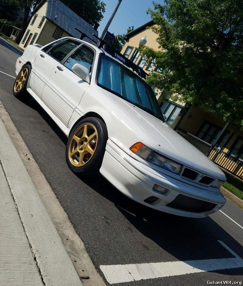

Yeah, my wife is awesome. I remember way back when I picked up 820, I would joke with her that I bought the car for her. As the build progressed, I actually started including her in on some of the stuff I was doing. Eventually, I was getting her feedback on how I was building the car, and letting her help pick out parts and such. By the time the car was getting close to finished, she was really taking an interest in it.
Now, she loves the car. She drives it to work every so often (when it's not JSB). She's driven it to Cars & Coffee, and even 14 hours to the Shootout and back. She's a trooper!
She took this a while back:
