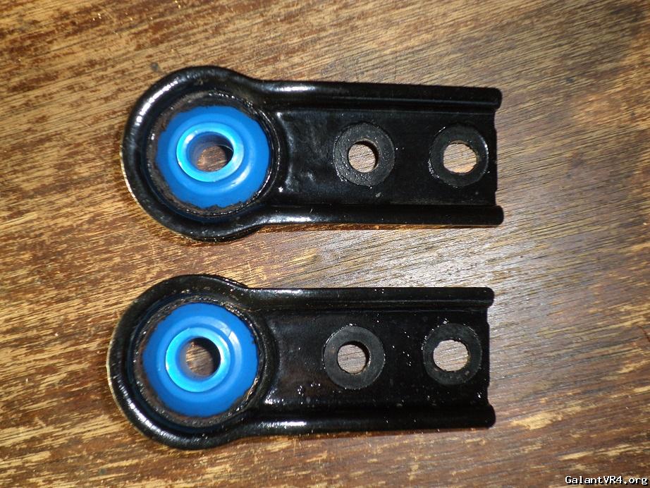

Replaced the dry, cracked rubber bushings with blue poly ones. Could have done a better job shucking out the old bushings though. At least they look good and the radiator doesn't jiggle. Thanks to Wizardawd for conjuring up this idea.

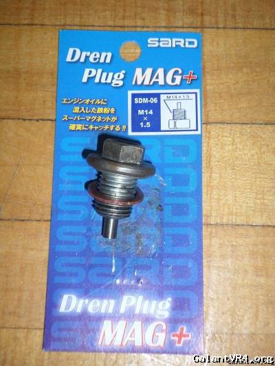

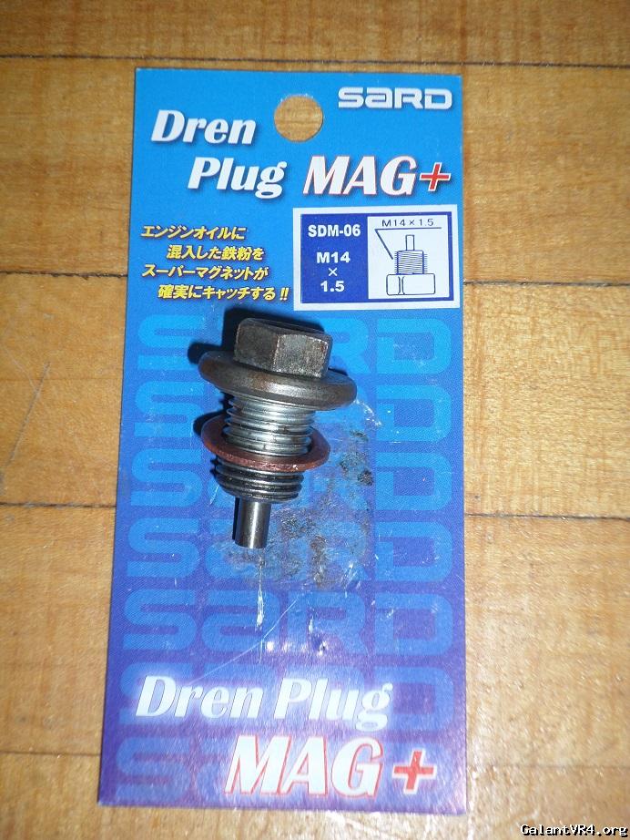

SARD magnetic oil drain plug. Thanks G.

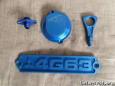

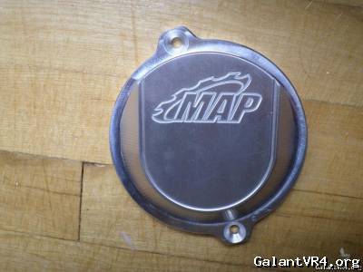

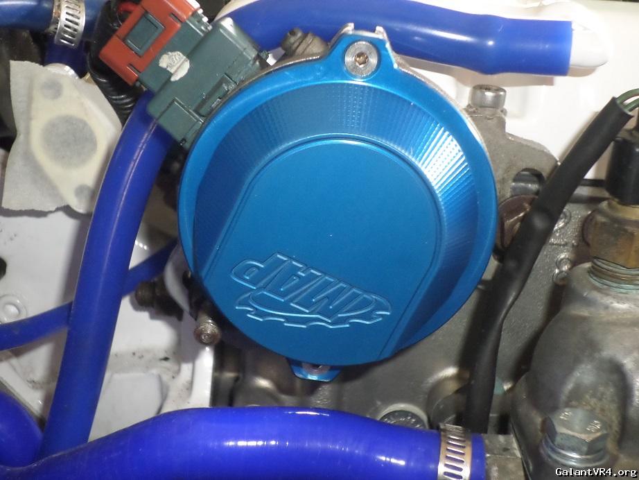

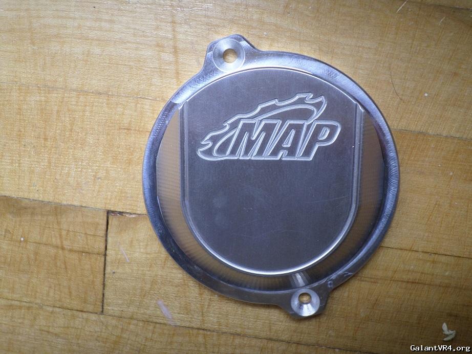

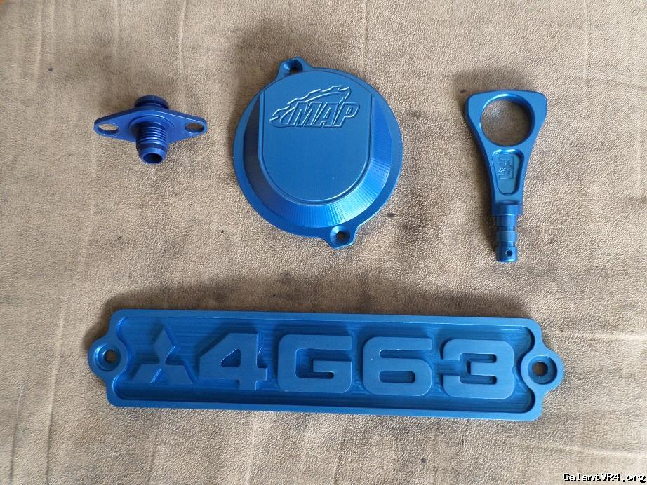

MAP Green-top CAS cover. Will be anodized blue.

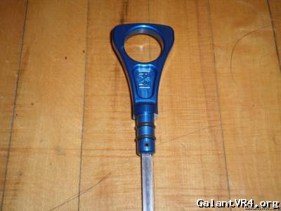

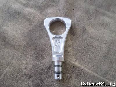

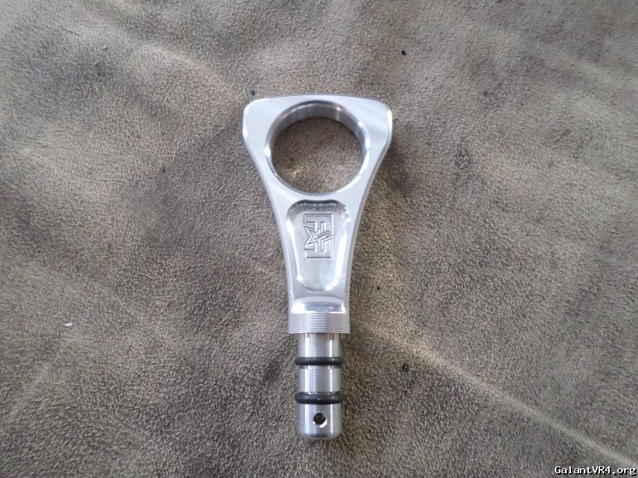

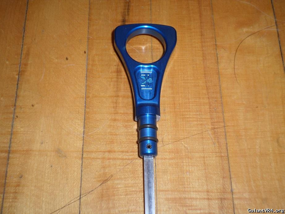

Frontline Fab 2G dipstick handle. Will also be anodized blue along with a few other goodies. I had to buy a new 2G dipstick and knock out the roll pin to separate the handle from the dipstick. Already have a new 1G dipstick, but the handle is riveted onto the dipstick. FF supplied new Viton o-rings and a new roll-pin to reassemble the dipstick.

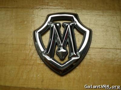

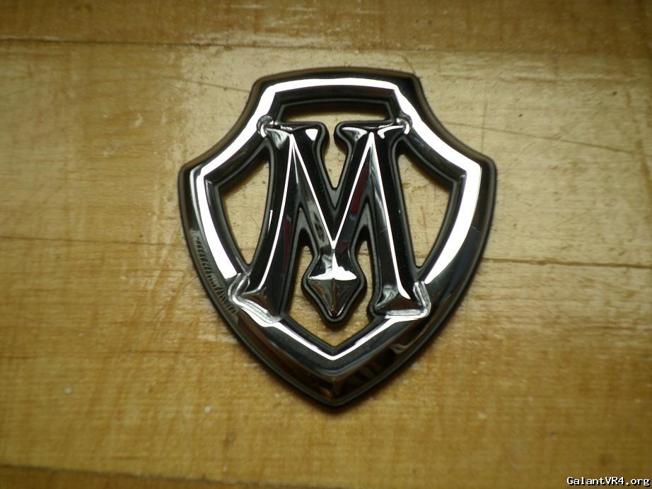

Starion badge. Thanks G.
Mirage badge IIRC. Thanks G.

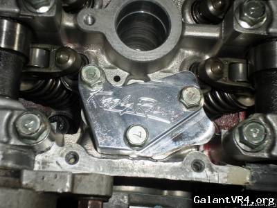

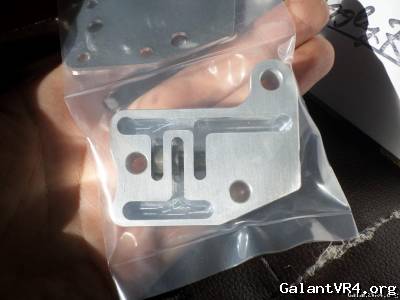

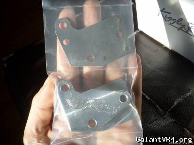

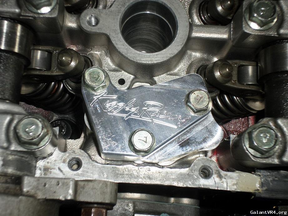

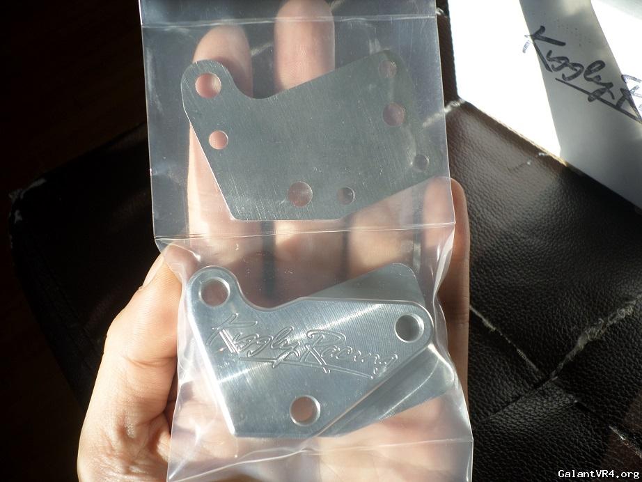

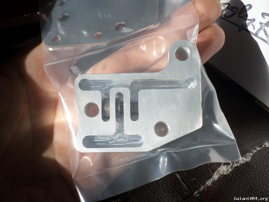

Kiggly advertised on tooners that he had a bunch of HLA's ready-to-go, so I jumped at the opportunity. Plus it's a good, functional investment. Should be a cakewalk to install.
The set screw has been "factory adjusted" to keep a constant 15psi on the lash adjusters. No gasket or sealant is needed between the regulator body and distribution plate either.
Waiting on more goodies and stuff to get back from the anodizer. I shipped the 18G out to my buddy to have a look at too.

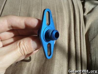

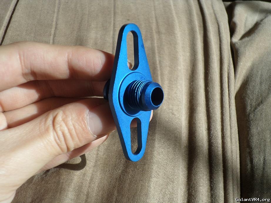

Got some parts back from the anodizer. They did a decent job, but forgot to send my fuel rail outlet fitting back. Should hopefully be getting that back soon. Must have been huffing a lot of fumes.
Had a tough time getting at the lower tamper-proof screw on the stock CAS cover with stuff in the way, but finally got it.
Got the new dipstick attached to the handle. New roll pin installed too.

Was "warm" today, so I decided to install the HLA since it only takes a few minutes. Torqued to 9ft.-lbs. I wanted to take the stock HLA apart to show internal comparison pics, but the screw holding it together is on very tight.

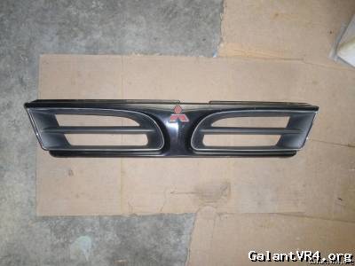

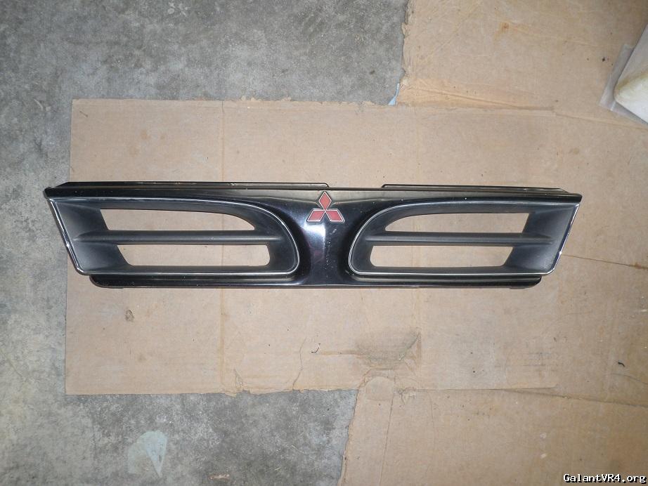

Forgot I had this '93 "pig-nose" grille. Won't rock it too often, but I will probably have it painted with some of the other grilles when the time comes.

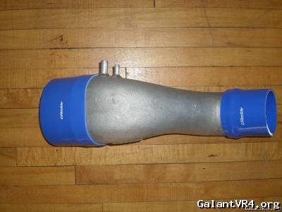

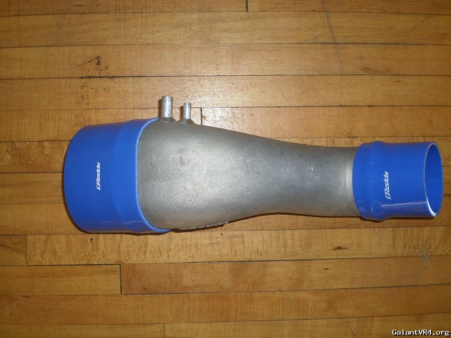

Not too much action, but finally got new GReddy couplers in from Japan. They are both straight couplers, 100mm for the MAF and 80mm for the turbo inlet. The logo is smaller on the new ones, but they are high quality for sure. Will probably need to do some trimming to get the best fit, but I have the old couplers to mock off of.

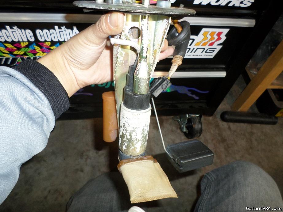

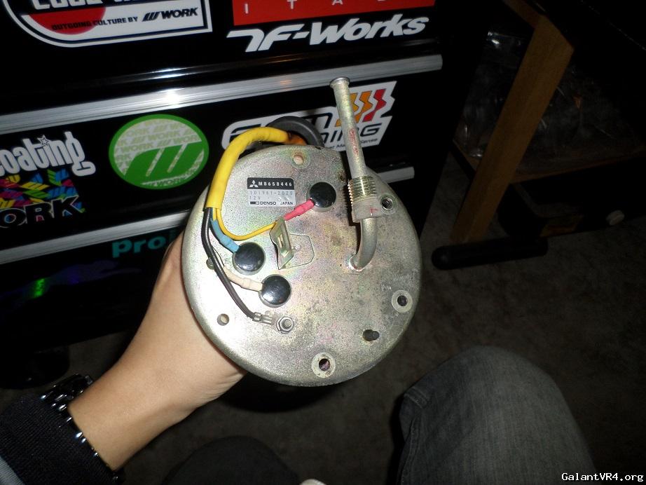

I bought this nice condition VR-4 fuel sending unit off of Evan Hale. Thanks again.

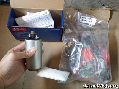

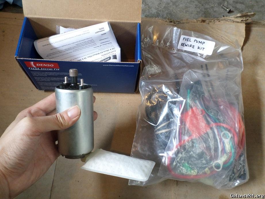

Had my friend Matt G. who works for Denso get me this Supra TT fuel pump with his employee discount. Thanks buddy. Also got the install kit and fuel pump rewire kit. Still hunting for injectors to finish off the fueling system.

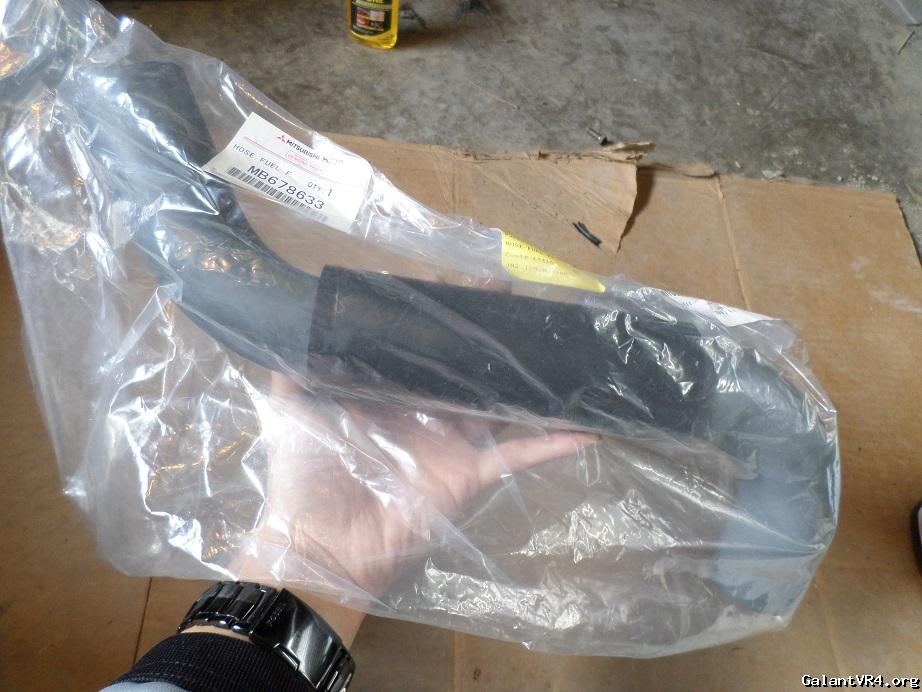

Got one of the last few fill hoses from JNZ.

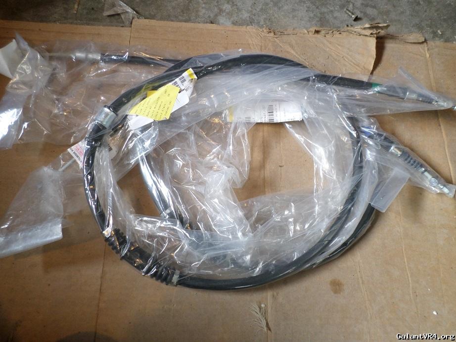

New parking cables from JNZ. PO said they were replaced, but the e-brake still doesn't work. Plan on getting all new calipers because I believe one of the rears is sticking.

Anodizer lost my fuel rail outlet adapter, so I had to order another one. Coated for free of course.

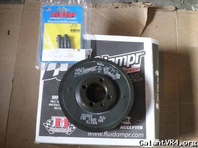

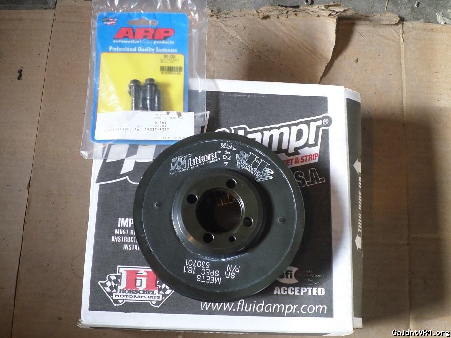

New Fluidampr pulley. Since I don't have balance shafts, I figured this would be a good investment. This is the revised version with the proper length ARP bolts.

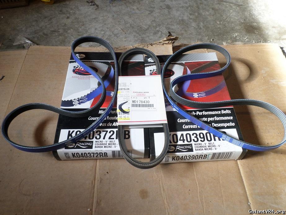

New OEM power steering belt, Gates A/C belt, and Gates alternator belt.

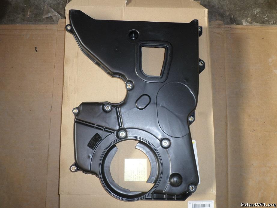

New lower timing cover. I got all new OEM bolts to go with it too.

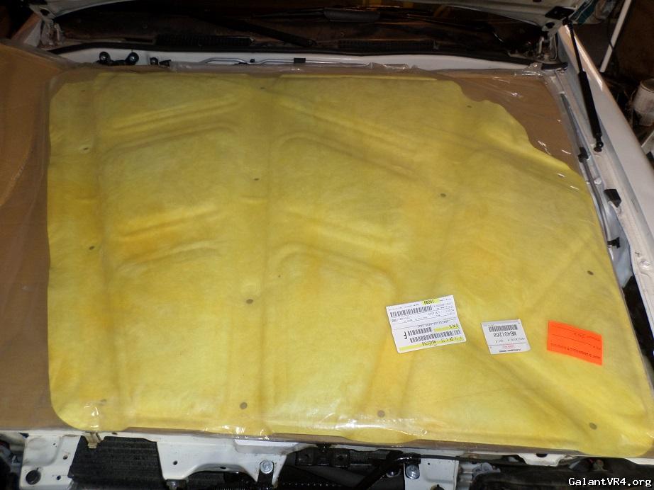

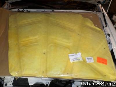

New hood insulator. My car didn't come with one. If I end up getting a JDM hood, I will probably sell this.

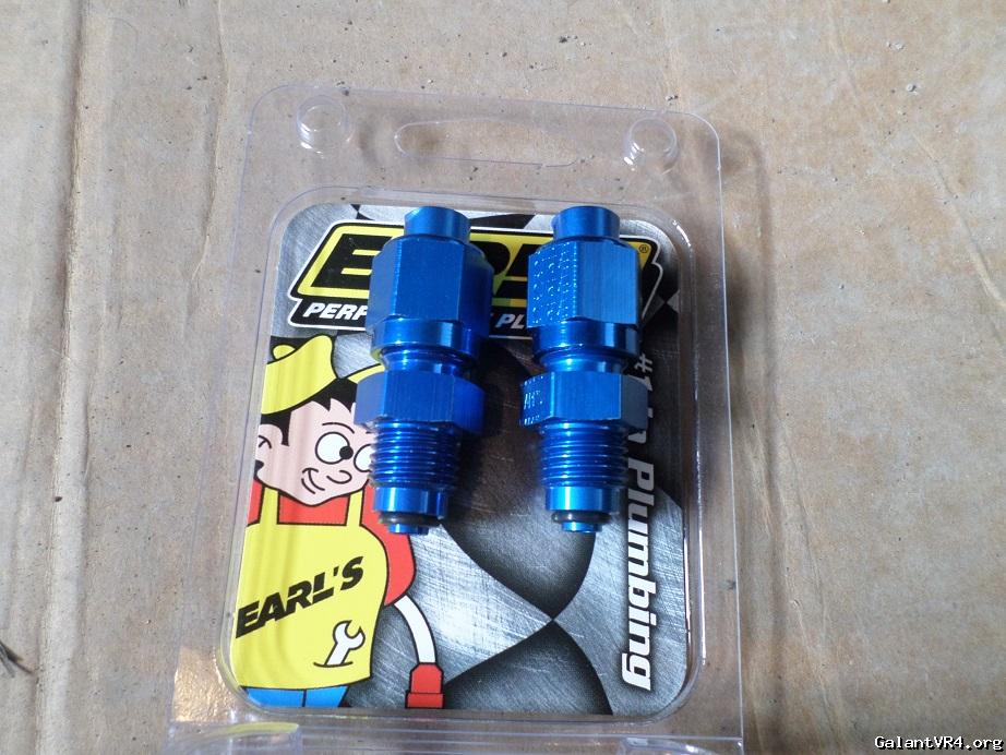

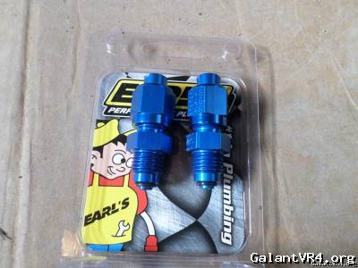

Earl's -6AN adapters and -6AN caps to block off the rear lines on the front rack.

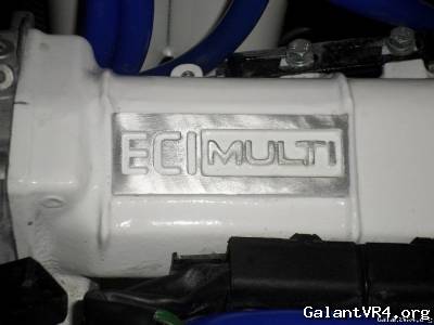

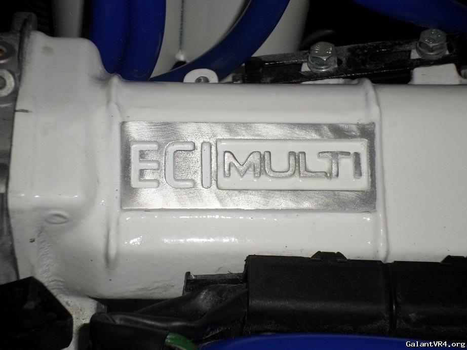

Finally got around to sanding off the powder coating on the intake manifold letters. Looks a lot better and matches the valve cover now.

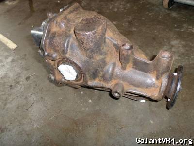

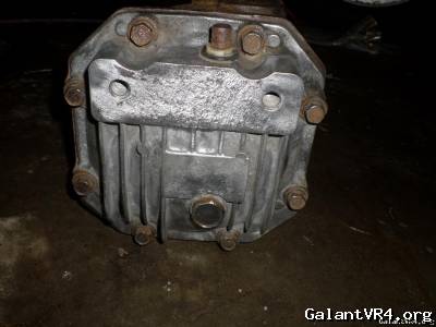

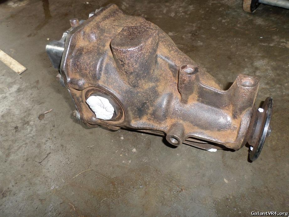

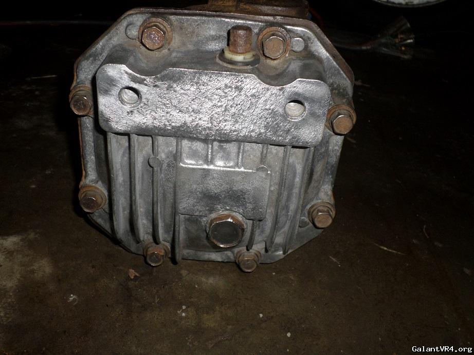

Got this 4-bolt viscous LSD from PolskiVR4. He was a gentleman and cleaned it up for me. Thank you!
Not in bad shape at all. Could use some black paint though.

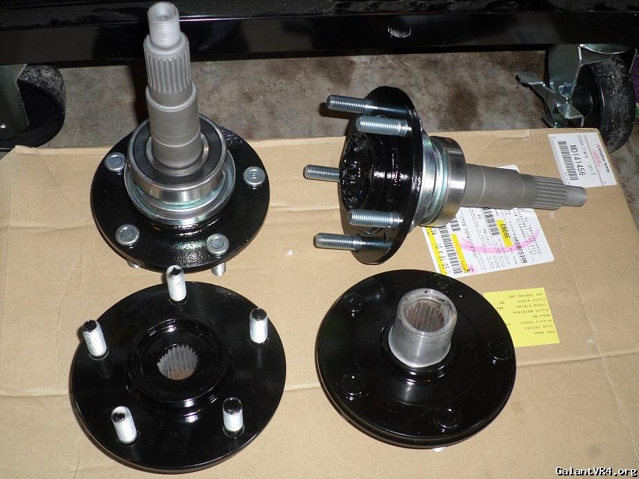

Here are the 5-lug hubs I will be using. JNZ coated the hubs for me and installed mostly everything for the rears. New wheel studs too. Still trying to find new front knuckles, but not sure if that will be possible.

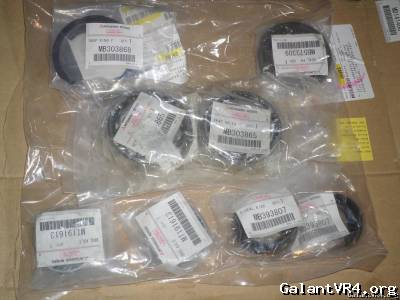

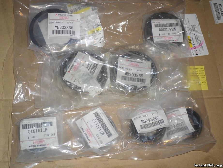

New OEM seals, bearings, etc. The fronts still need to be pressed in.

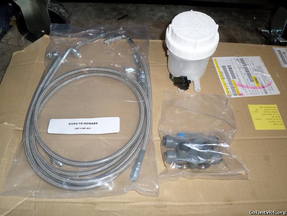

JNZ ABS delete kit with stainless lines for the front, new OEM non-ABS prop valve, and new OEM non-abs reservoir/cap.

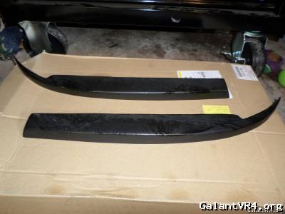

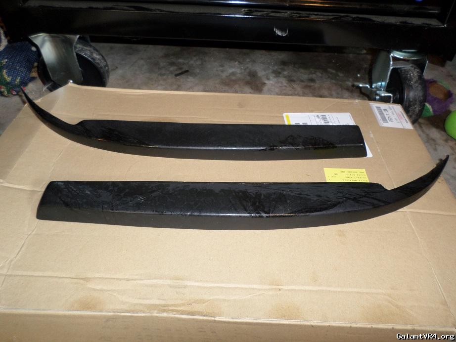

Eyelids from Nameka. These don't fit on USDM lights because of a nipple on the glass. I may decide to install these on my Curtis-spec lights. The '93 lights have a nipple on the glass too, but Curtis will be grinding them down for me. Not sure if I want to do these in black or white, but not important at the moment.

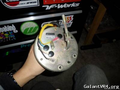

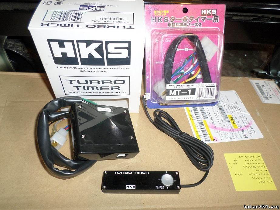

Had Archer Racing order me this HKS 35th anniversary edition Type-0 turbo timer since they are somehow still a HKS dealer. Was walking around the shop and found this 1G harness just sitting there. Saw some lingering HKS stuff sitting around the shop like cams, filters, filter cages, etc. Pretty cool for a shop in Duluth.

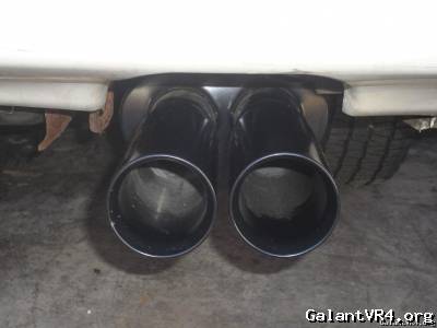

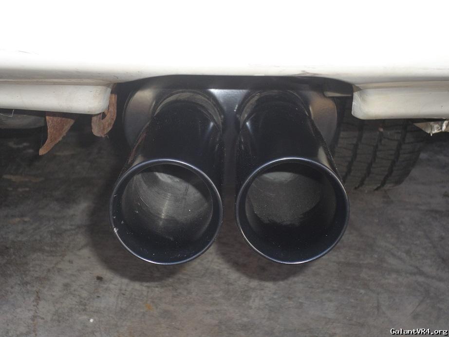

Installed this back in September 2013. Certified Muffler 3" stainless TBE. I'm kind of a tree-hugger, so I put a Magnaflow high-flow cat on there. Decided not to go with a resonator because I'm hoping the cat will quiet it down some. If it drones too much, I may have one put on later. True dual outlets too. Had the muffler and tips powder coated flat black to stay under the radar. David was awesome to work with and the install went pretty easily. I did mention earlier that I had a bung installed to get the wideband setup hooked up.
